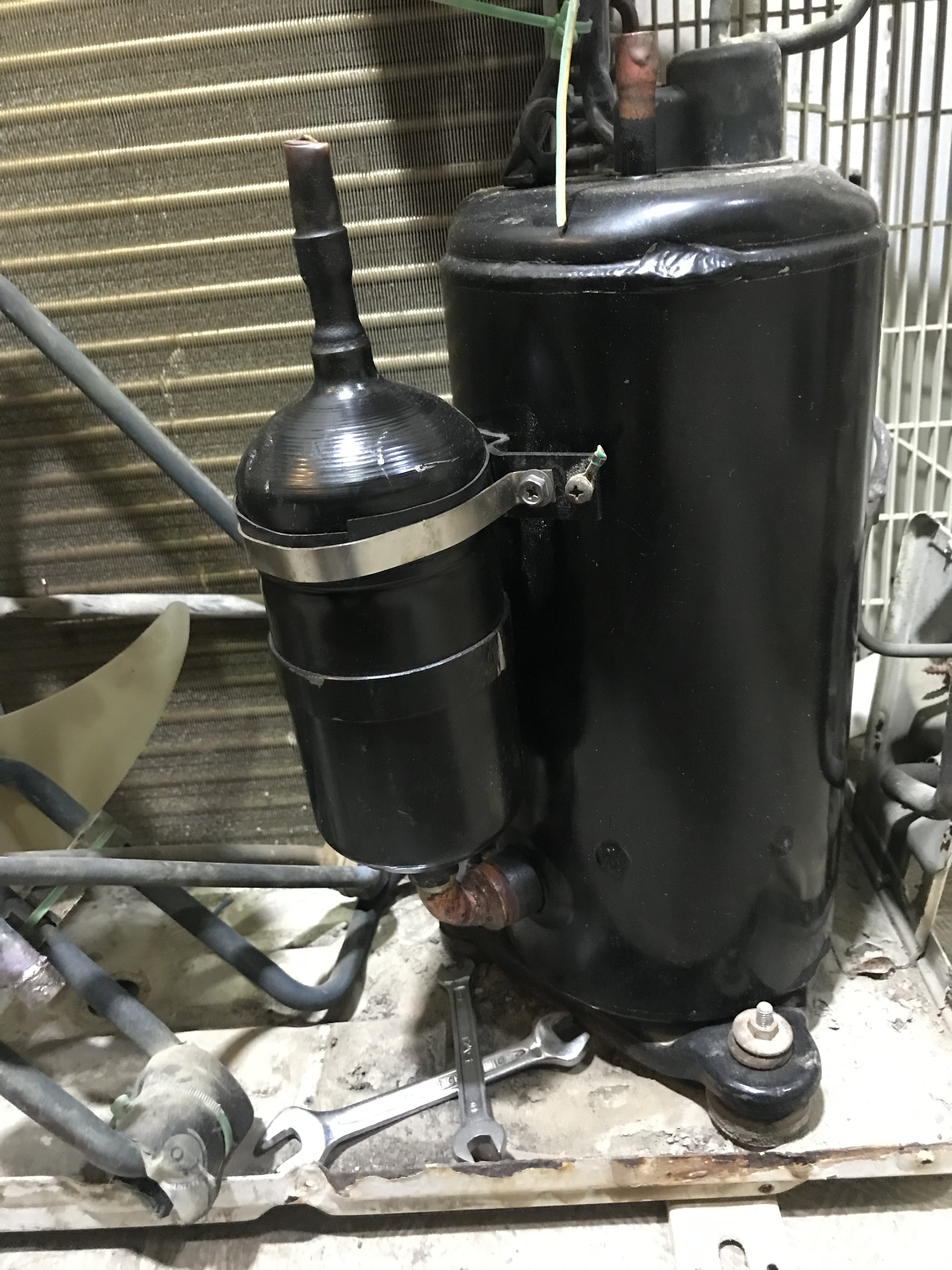

When installing a new accumulator, the whole unit, including condenser and compressor is vacuumed out to boil out the moisture.
If your mechanic is so stupid as to assume that the units own compressor can fully vacuum itself then he should sell his tools and look for another job.

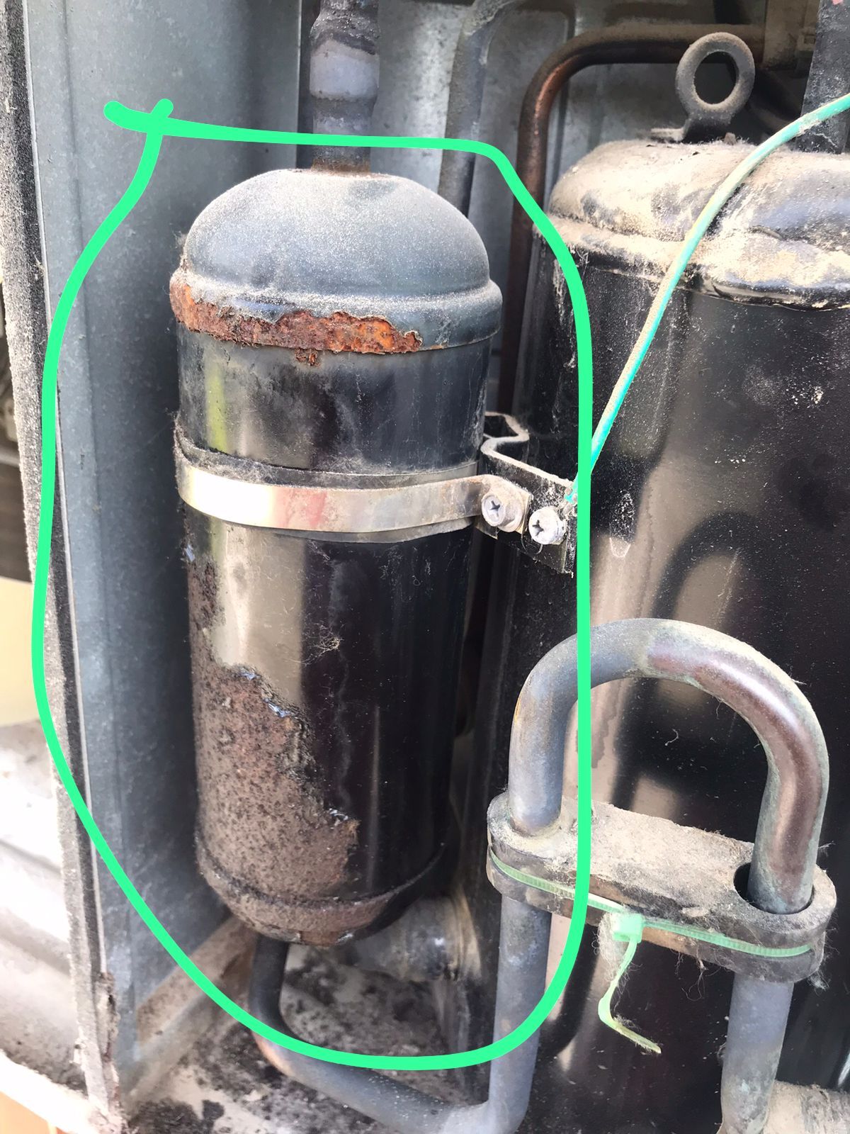

Replacing these mufflers is common practice, all gas is lost from this leak, after welding in a new item, the whole unit is vacuumed with a dedicated multistage vacuum pump (ideally to less than 300 microns).
Otherwise you will be facing this again in a few months and during those months will have very high energy bills.
Precis…. Dont hire dumbasses to work on your stuff.
