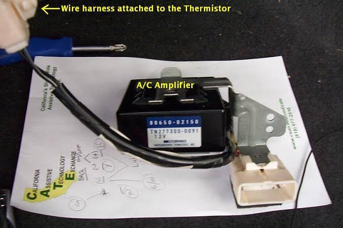

Yes. Best is to get amplifier as well. And wire everything according to 1nzfe.
Like this
@Hassan1991 Sorry for asking again and againWhat is amplifier works in car ac.
Feel free to ask.Ac amplifier controls the all operations of ac.It's like a separate unit with which thermostat and other sensors are connected. Further it communicates with engine ecu.
@Hassan1991 kya es se ac tripping ka masla hal.hojayega?
For sure ... desi thermostat mai usually ye issue ata hai ... get this AC amplifier (called AC kit locally) ... get it wired up correctly & you are good to go.
Yes. It will work correctly.
