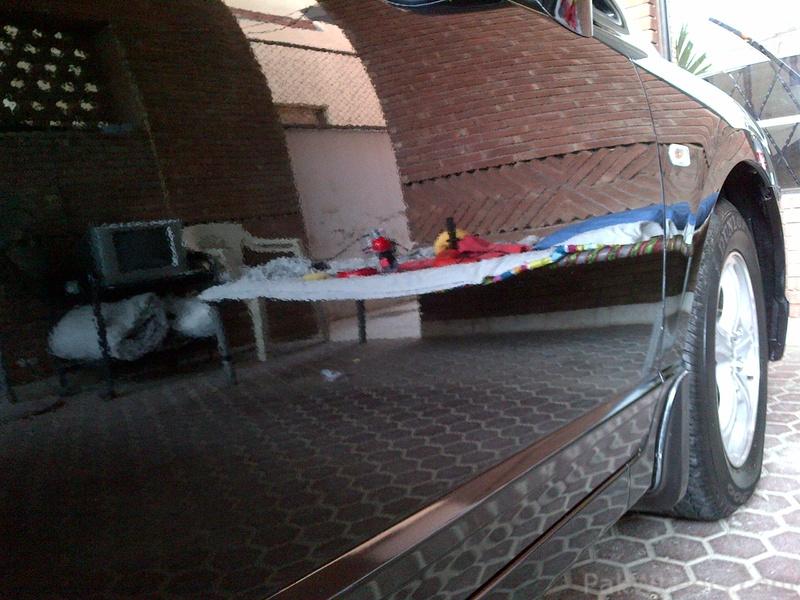

Salam all.. Had the longest detailing session of my life with my civic.. Started at 6am and got done by 1pm... Washed the car with mothers wash and wax shampoo.. Then came the most important part, Claying.. This was my first time experience with a clay bar, and i wanted to remove the paint over spray.. It worked like a charm, i never expected the clay bar to be so good. It took me 2 hours to clay the whole car but at the more than 95% of the over spray was gone.. The supplied instant detailer finished at the rear bumper so some spot's are still present on the bumper.. Then waxed it with mother's synwax and pure carnauba wax.. Topped it with mother's reflections top coat.. Will upload the pics in a while...

Awesome work! What did you use for swirl removal?
Somthin good is on the cards I presumeeeee................waiting for pics bro!!!
the reflections gave away its secret, i see a buffer in this reflectiongood idea indeed sir jee, a high end wax with a buffer
he posted them already, badaam time
Thank you. I use swirl x...
Sorry for th late reply bro, was away on business. After seeing the original shot yes this is definitely the best that could be done, n yeah if thers filler being exposed then u cant do much. Gr8 job bro. But u can give it a sealant finish to increase the clear coat depth for future. Lets say this ride accumulates the same number of swirls in another 1.5 years so that will be into the sealant finish rather than its own clear coat which wud mean one buff session with swirl X at that time will again bring this car into the bling bling state again.
Thats the mothers powerball for paint. Used it on my city. I have never used a powertool on my civic, i assure you..
