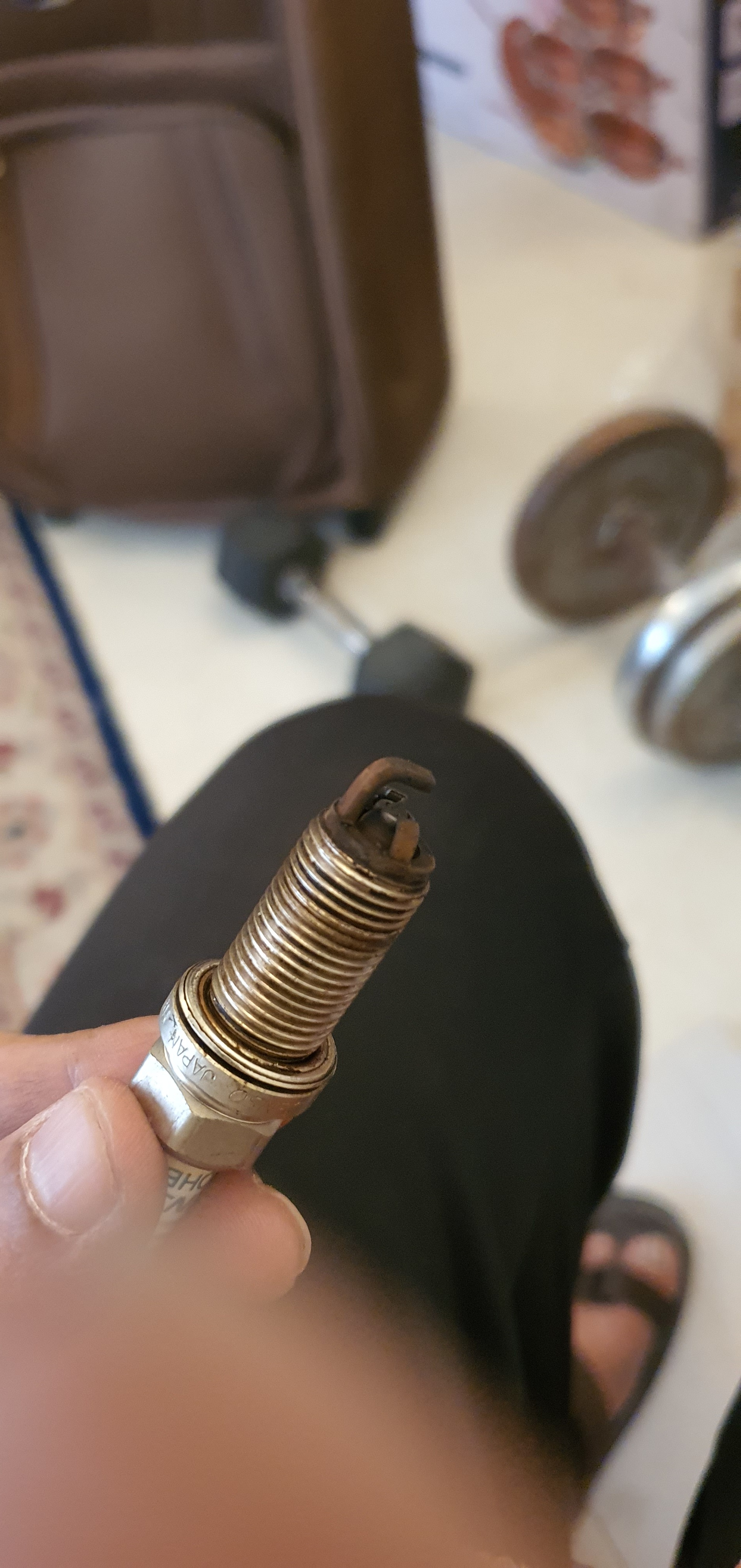

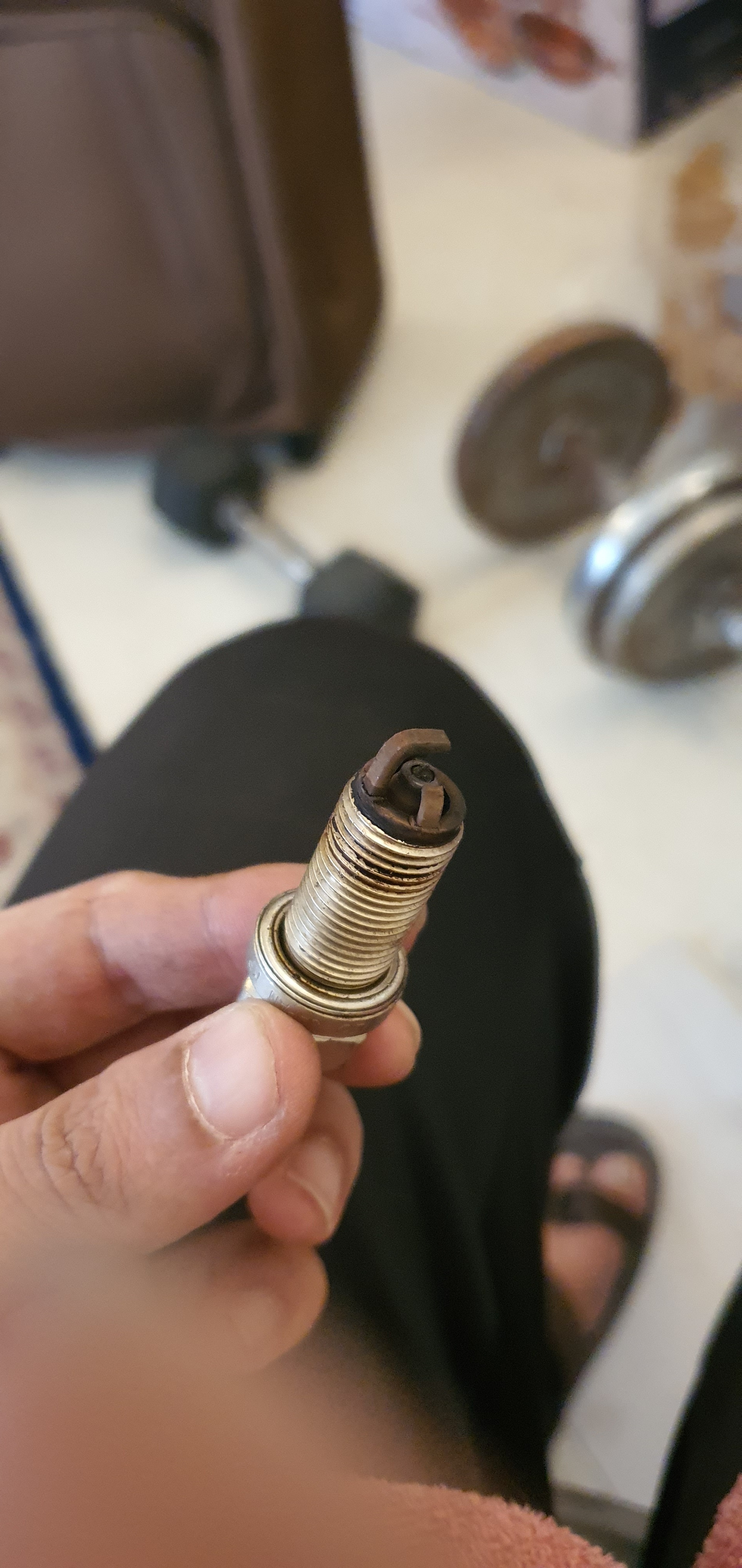

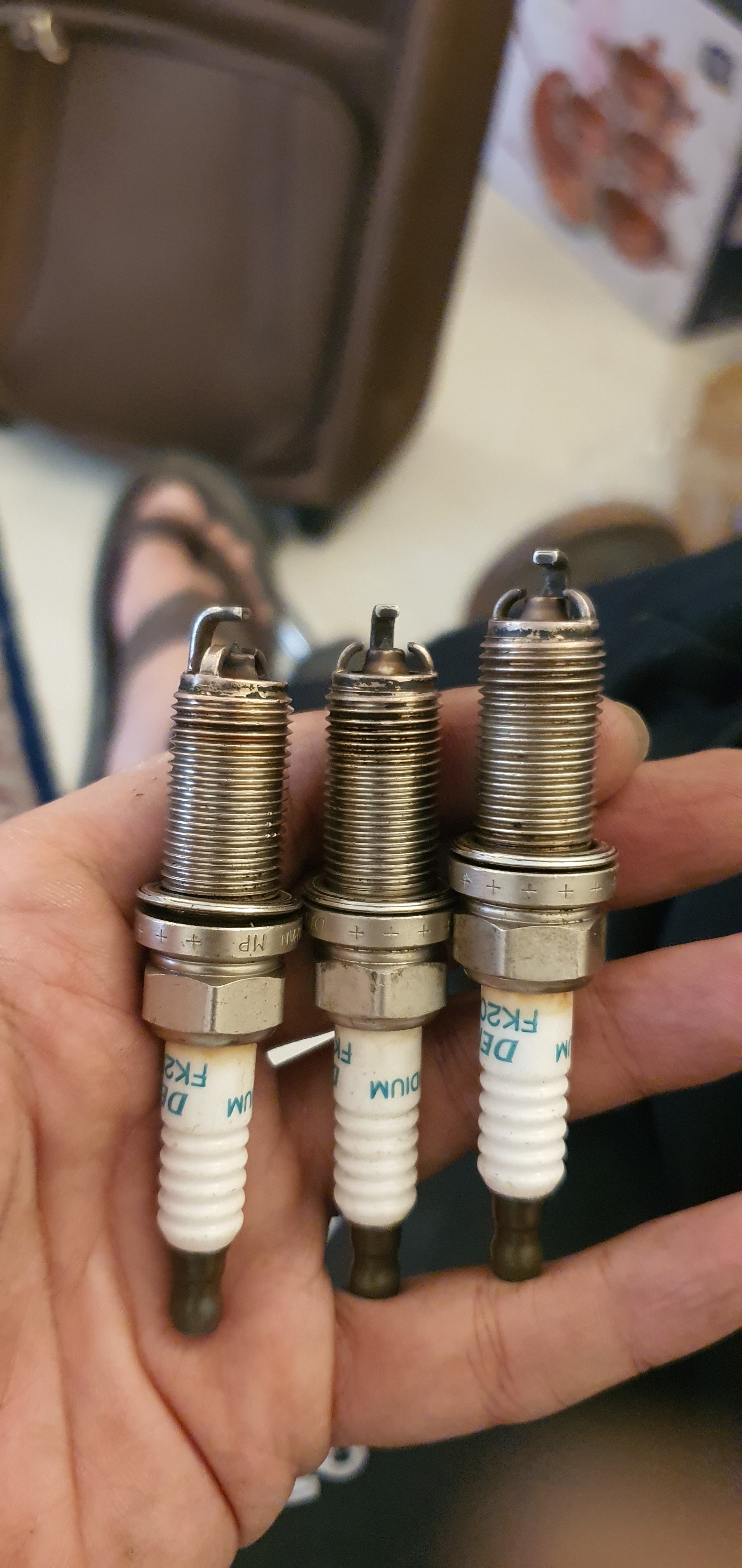

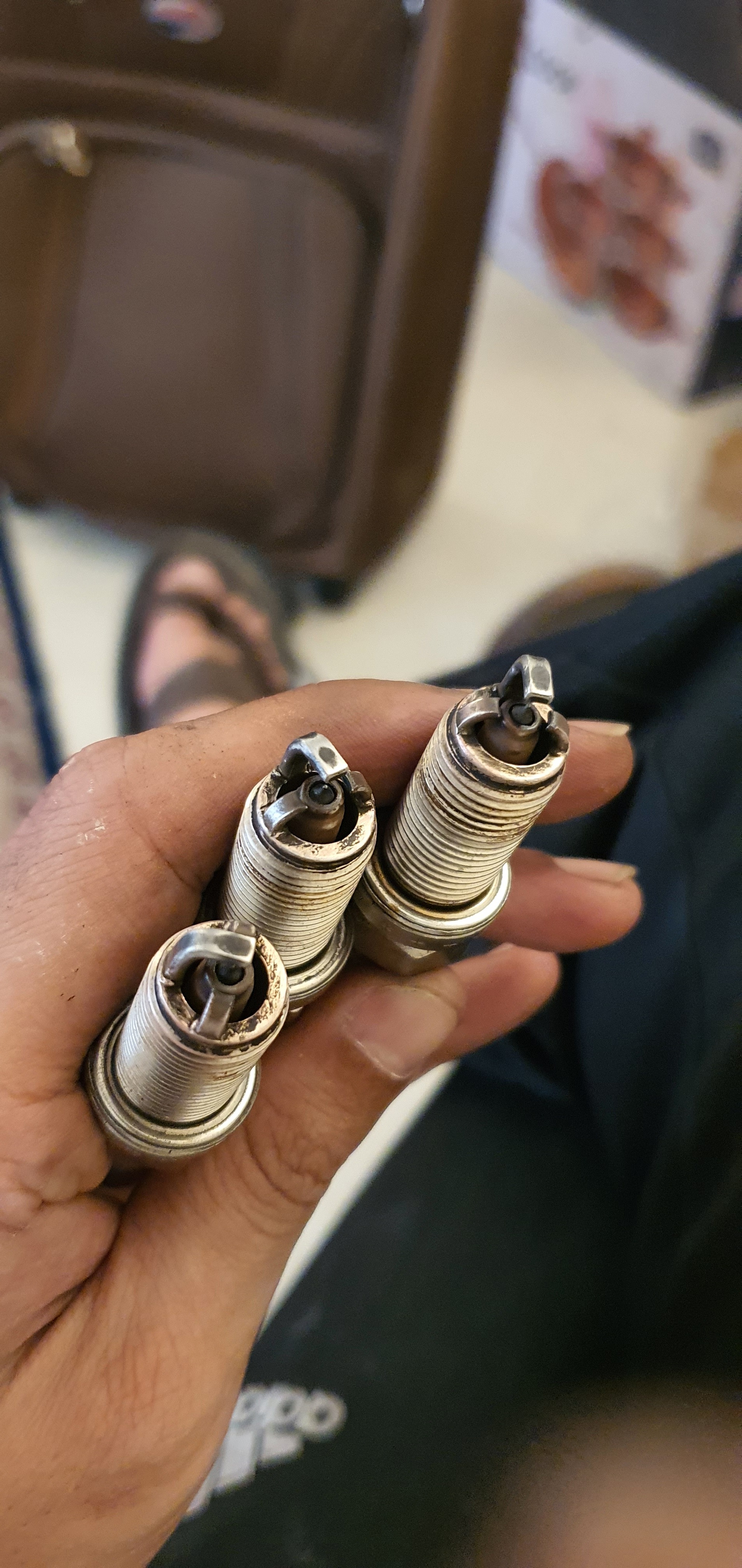

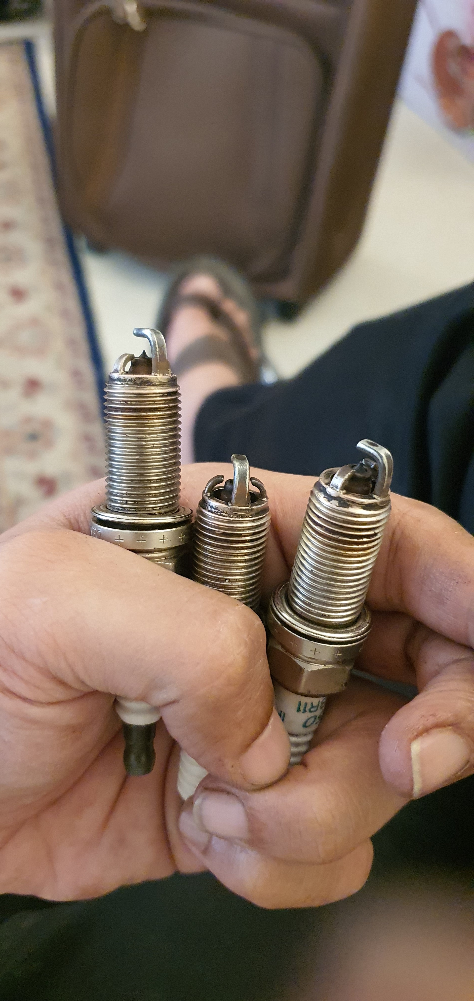

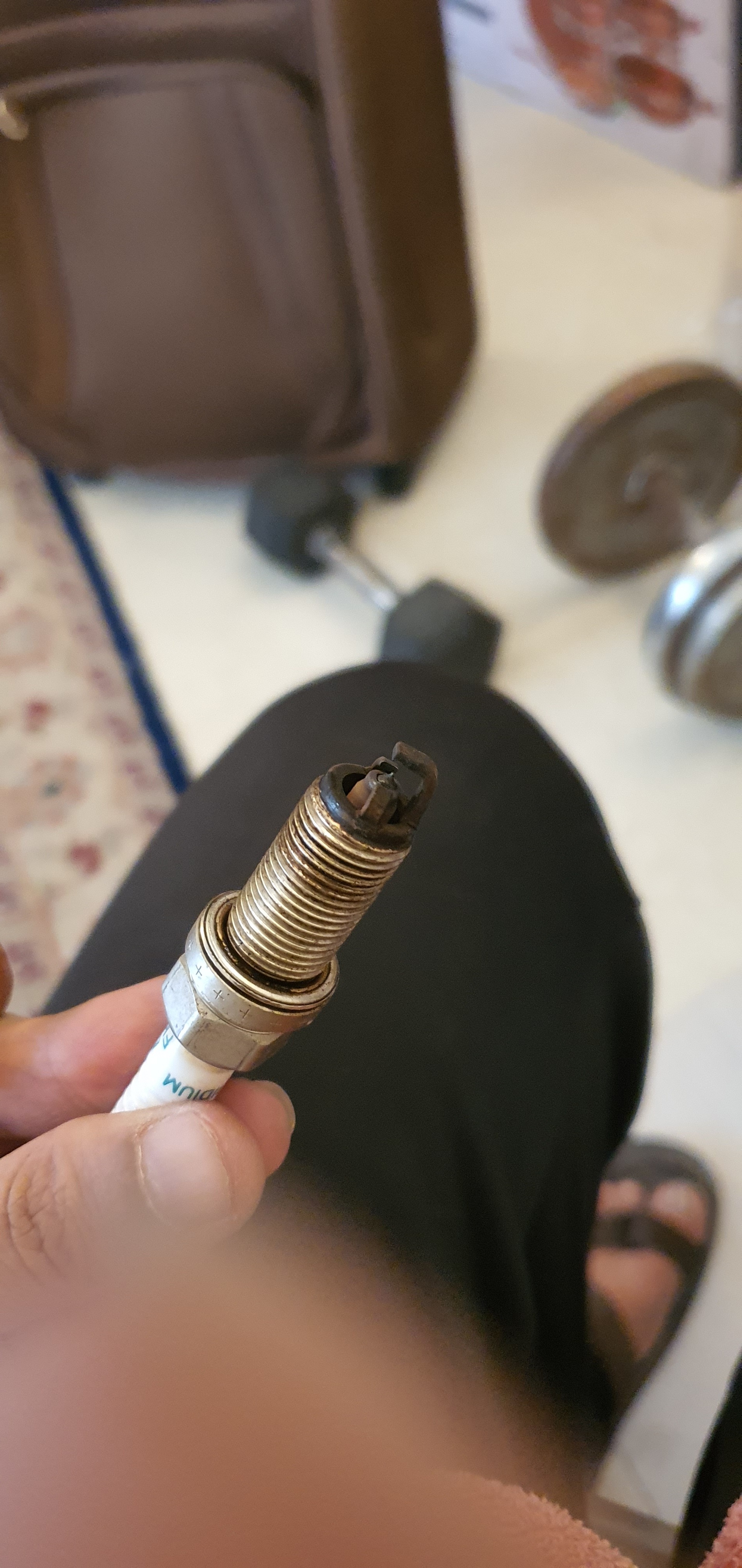

Btw i changed the o2 sensor and the CEL for it is gone plus its working as it should but the car hesitation is still there, when flooring it car hesitates, it drives ok if i drive with low throttle at low RPMs. there is no CEL now. The fuel trims for Bank 2 are ok but for bank 1 its still running rich, if i keep the rpm low and at a constant speed then the fuel trims get normal around 0to5+- but when stop and go or floor it the fuel trims mostly the bank 2 go a negative 22.
I swapped a maf sensor to see if it gets better but no luck. i opened the sparkplugs and they were a bit black so cleaned them and took a test drive but problem is still there. Also at cold start after the car is parked whole night and the next day i start it, it makes a strange vibration plus the hesitation but as soon as its warmes up the sound is gone and i can drive it around at low throttle.
Any idea of what can be wrong?
