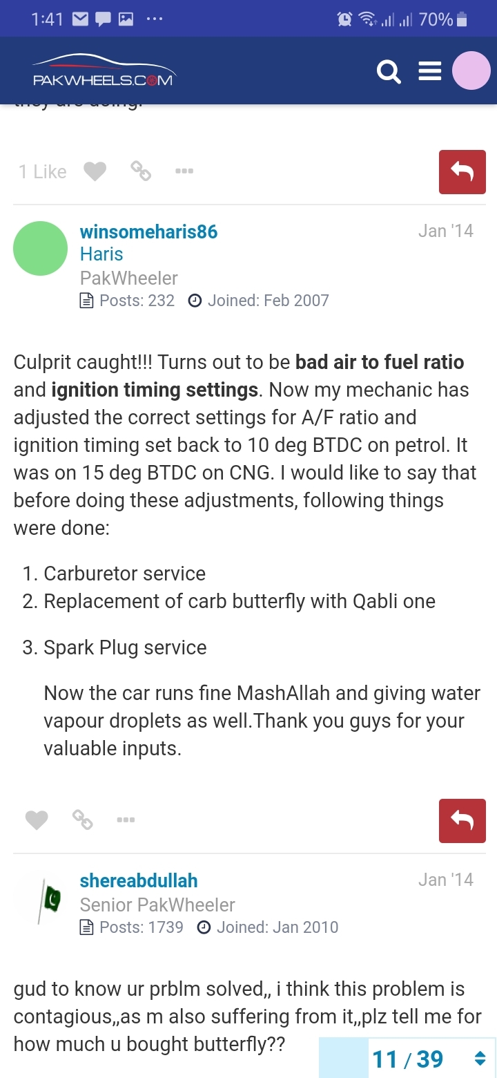

Because car runs on CNG but because of Cng not available now a days its been converted to petrol. I think distributor is set to Advance Timing.
no that may cause knocking, but no black smoke.
This was taken from PW i dont if he is right.
