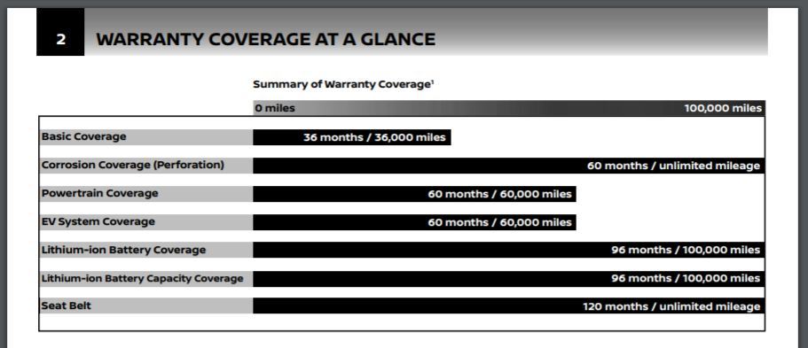

Batteries in Nissan leaf are air cooled, unlike tesla and some other brands which use liquid cooling, yes liquid cooling is better than air cooling, but air cooling is certainly not “terrible” in any way as you belive, for example Nissan gives a warranty of 100,000 miles or 8 years on its new battery pack, it can be claimed if battery becomes “useless” as you mentioned or capacity of battery is decreased below 90% within said tenure.
For the sake of discussion if we assume your claim is right, then why people who own these vehicles throw in crushers and what stopped them from claiming warranty and getting free battery replacement, or we haven’t heard any news of recalling Nissan leafs due to bad battery.
Here is Nissan warranty leaflet,

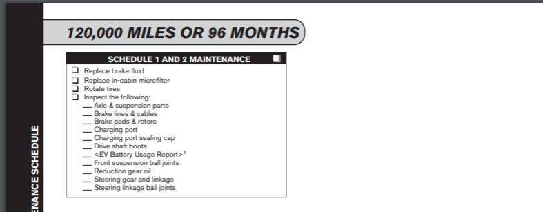

Let me remind you again, transmission is not installed in Nissan leaf, so no need to use ATF fluid dexron VI, plz use some synthetic gear oil like GL-4 etc in reduction gear, it has long life , even company says in its manual , it is to be checked on 120000 miles , no need for replacement if it seems ok.

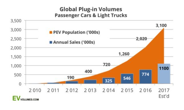

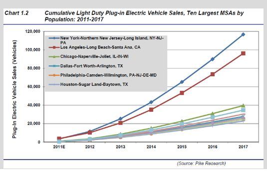

Dude let me share some sale data of EVs during past years, which shows sharp sales rise due to their usefulness, I cant say whether these Goras at US Uk Japan China are fools or EV opponents are ignorant, they are drinking Lassi or we r sleeping after having Sattu.
