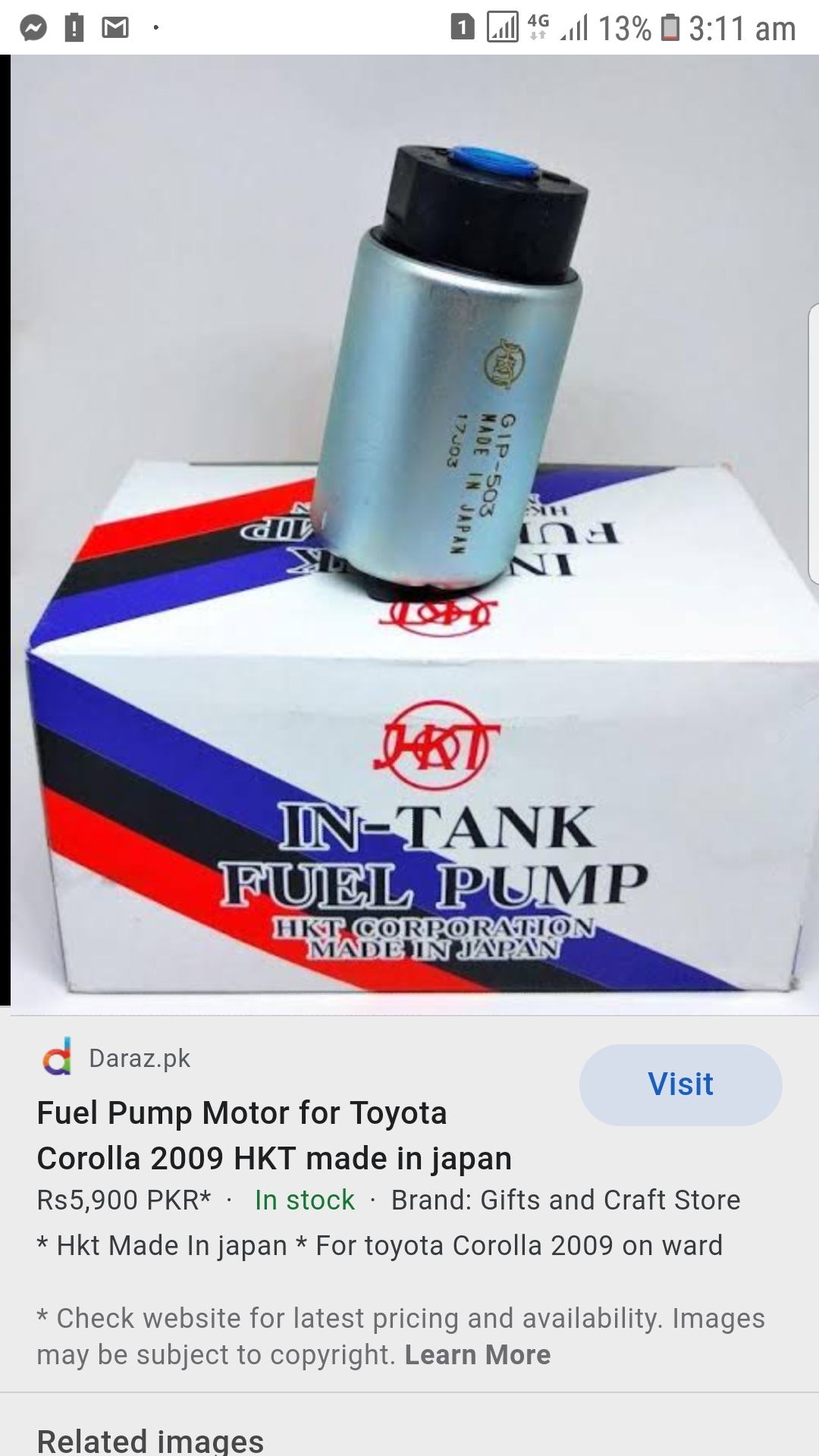

Kya ap bata sakti ho kay ye kasa china hay ya orignal
If this is original hkt pump, then it is made in Japan and good. As far as I know there aren't any hkt fakes in the market.
Orignal ju pump hay os say ye hkt kamzor hay ye log nahi lagati
Then get the denso pump. That is the same as original Toyota.
