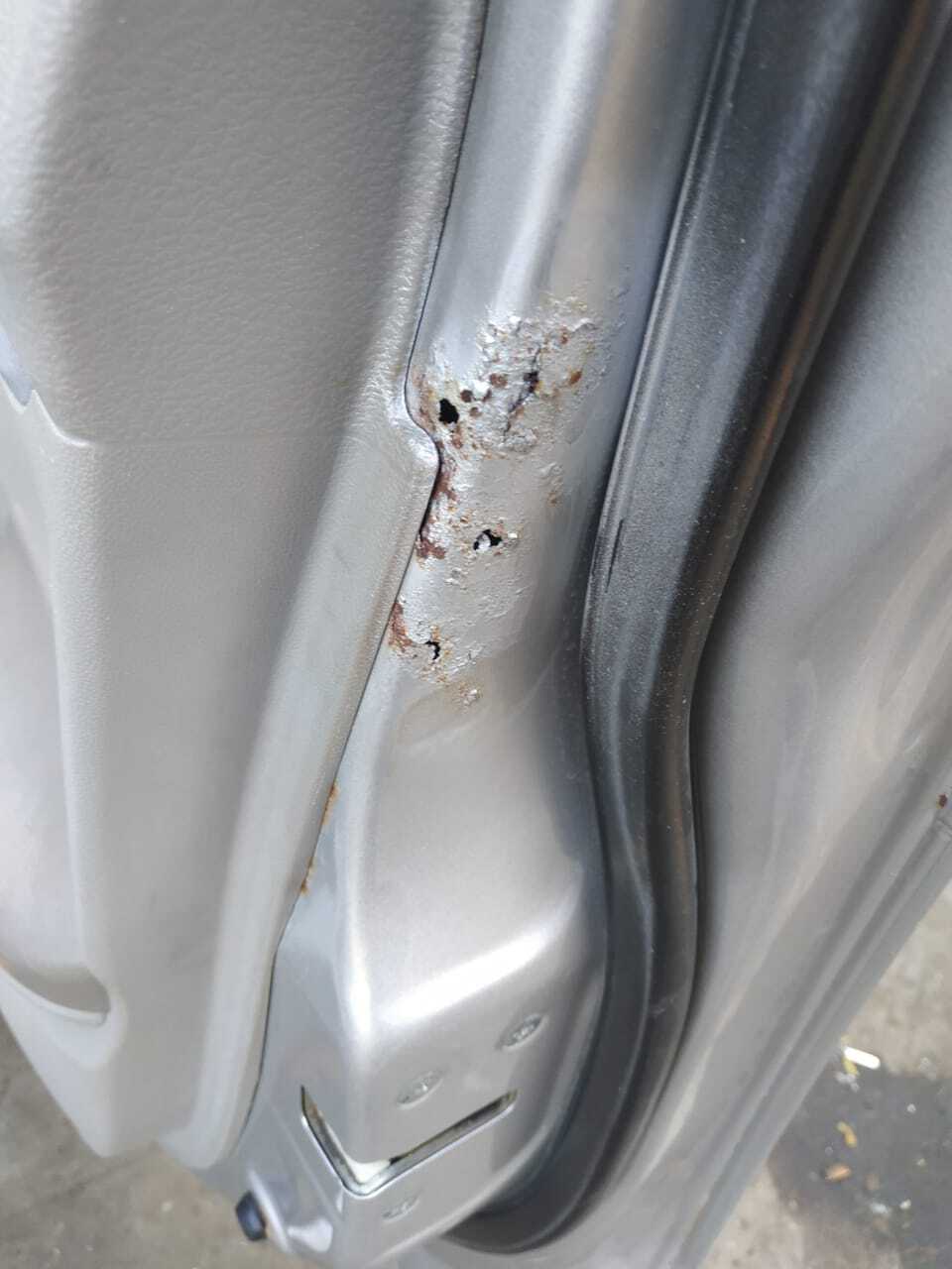

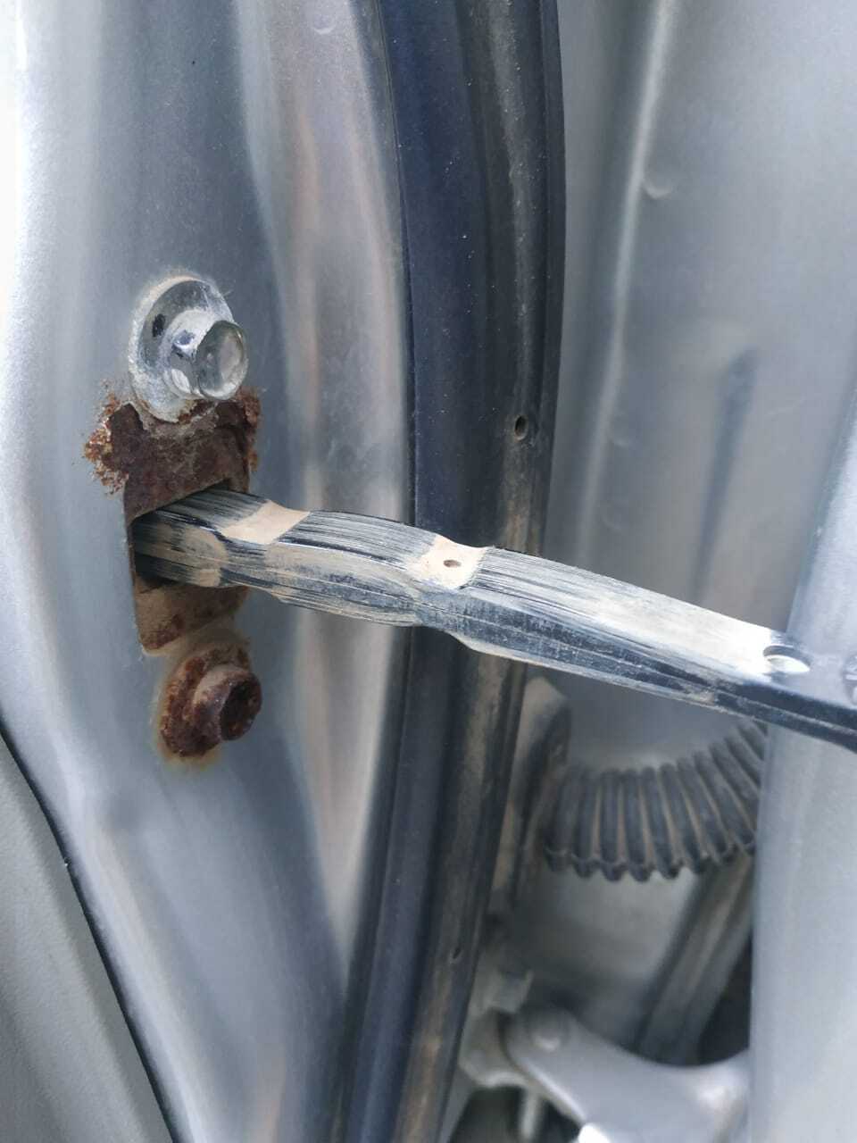

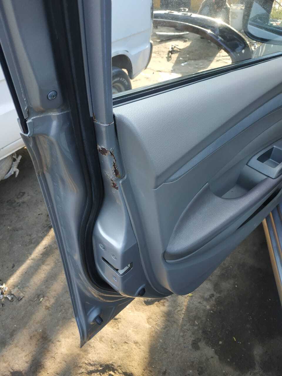

posting here for the first time so please go easy on me. I recently got my first ever car and I am looking to get it maintained and in shape inshaAllah. The first thing I need to immediately address is rusting in and around the car frame:
Any good denter/painter in Islamabad who specializes in above? Also where can I find rust neutralizer here?Please I really need your guidance

for time being, you can buy rustoleum anti rust spray from adenwalla.org. use creative skill to cover non affected area before spraying the patch.
Seems like the whole car is repainted and that too very poorly after a major accident. This is not a rusting problem at all. Take the car to a workshop and get it done properly.
