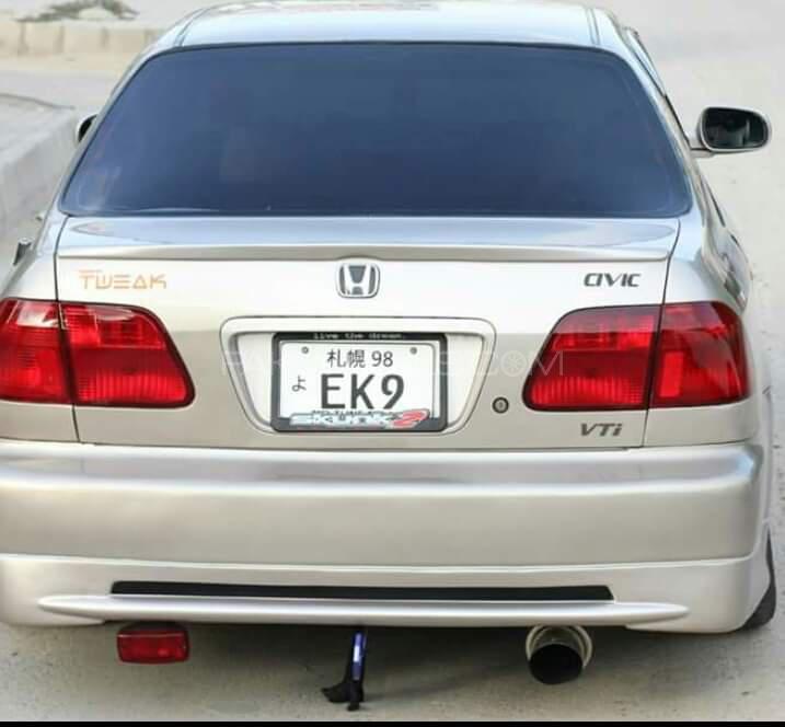

I own a 2000 civic vti oriel (Manual transmission) with a D15 engine.
