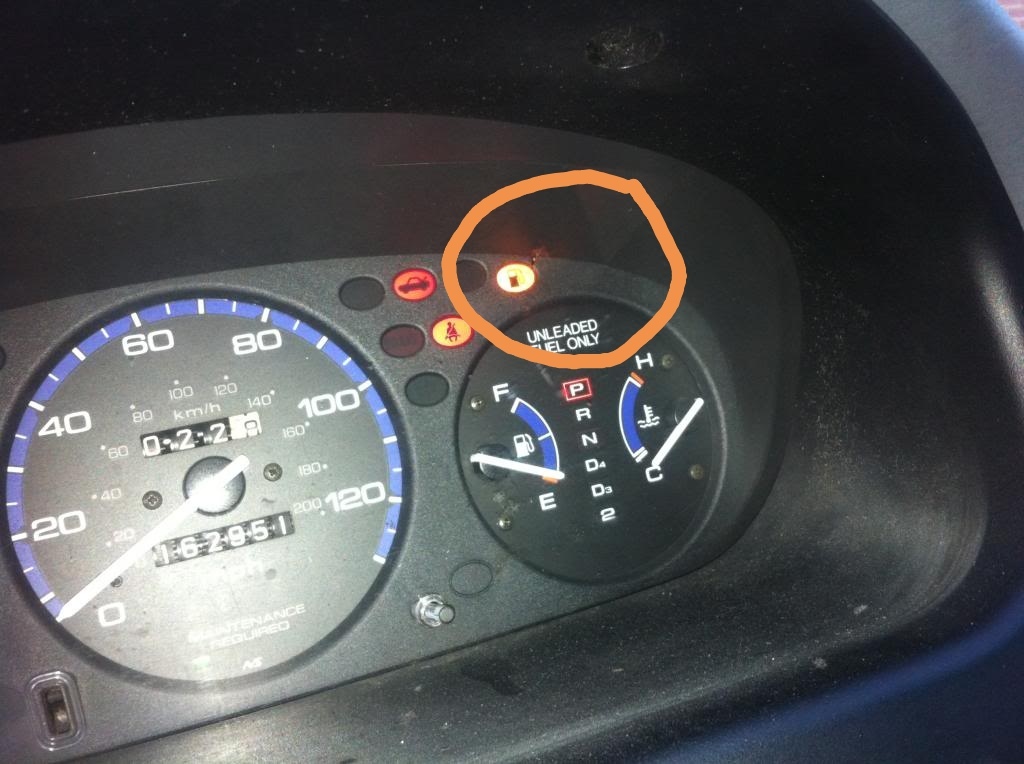

Is there any fuel reserve indicator in Civic 99? I mean except from fuel gauge. Some cars show up a light.
Yes it shows low fuel light below is sample,
Mine has stopped working
Thinking about getting it checked for so long

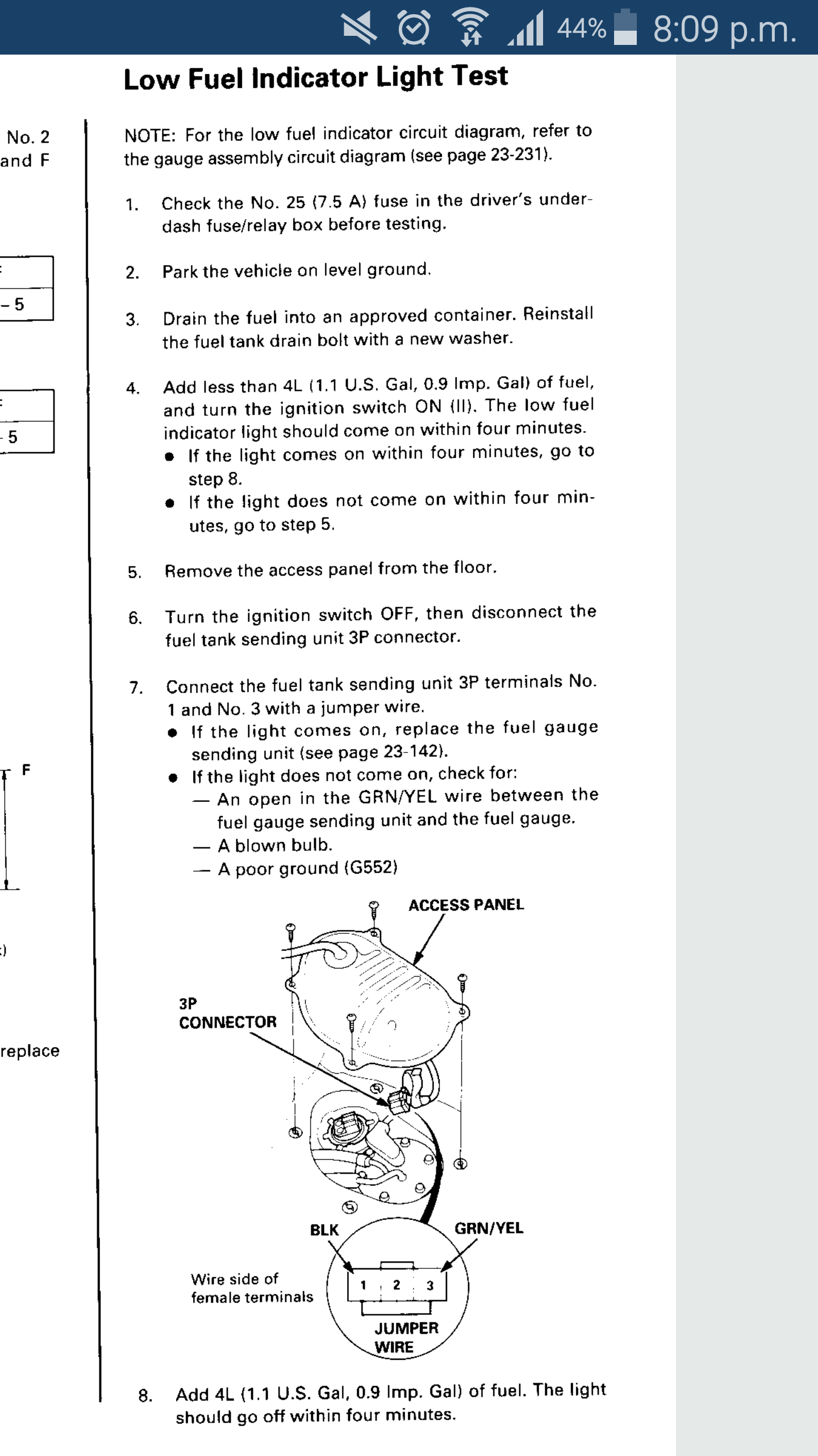

Mostly thermistor gets bad in the fuel Guage sending unit. Mine is also bad. But I may replace whole sending unit. Very easy to diagnose exact problem
This is not Pakistani version. The gauge is in miles.
Bro image is just for reference lights are same except gauges
I doubt it because seatbelt indicator is also not available here.
This is picture is taken by myself My car is civic 2000
This is to check if your bulb is bad or fuel Guage sending unit is bad
I need to test mine then.

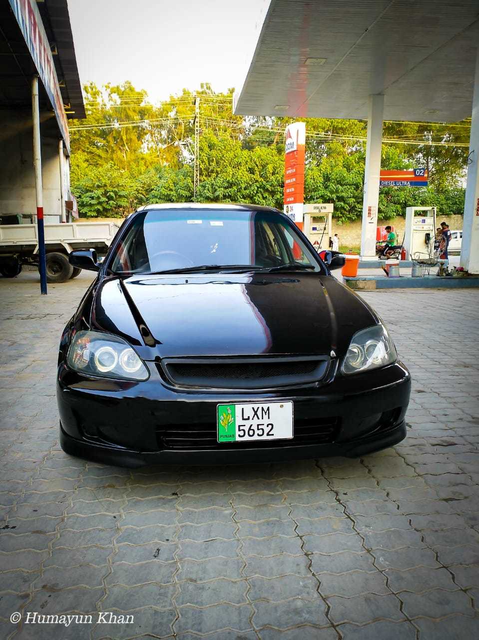

Anyone here using after-market projector headlights in their civic?
Yes sir
How is the light output compared to standard headlights?
I mean, are they just for looks or do they perform better too?
I am thinking about upgrading to aftermarket projector headlights
Aftermarket projectors add good look to the car obviously. The light totally depends on the bulb you are using. But if you swap in the original you will feel the amount of light to be lesser. The projectors limit the throw of the light ona specific area hence the feel of low light. Most of the people recommend to install good quality LED bulbs in projectors to get the better result.
Thinking about buying these headlights
