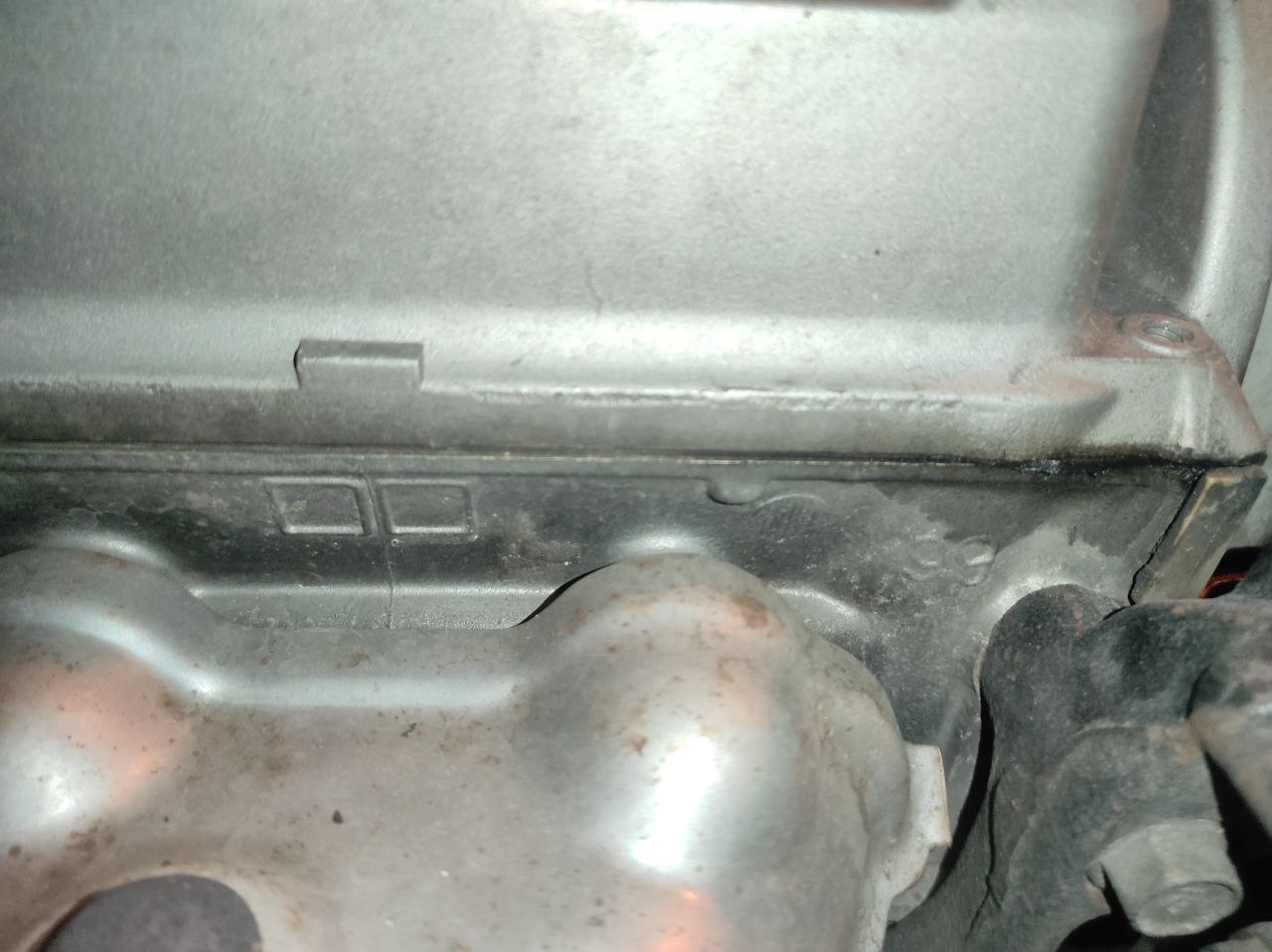

I need some information if you have this EK As you said its 3 stage d15b I need know the head casting code
The head code is p2j
Can you take a picture of it?
P2j 1 2 3456 ? And year code also
Ye likha kahan hota he
Engine k front per jaha exhaust manifold ka cover hota hai us k bilkul opar
