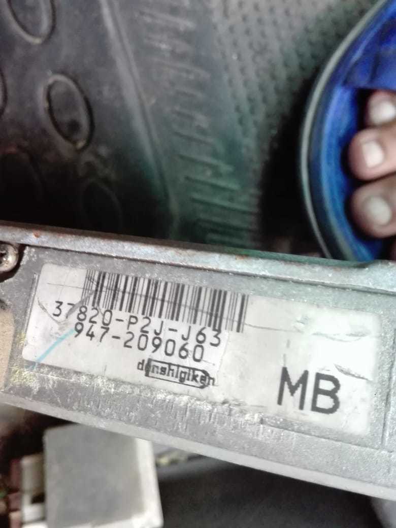

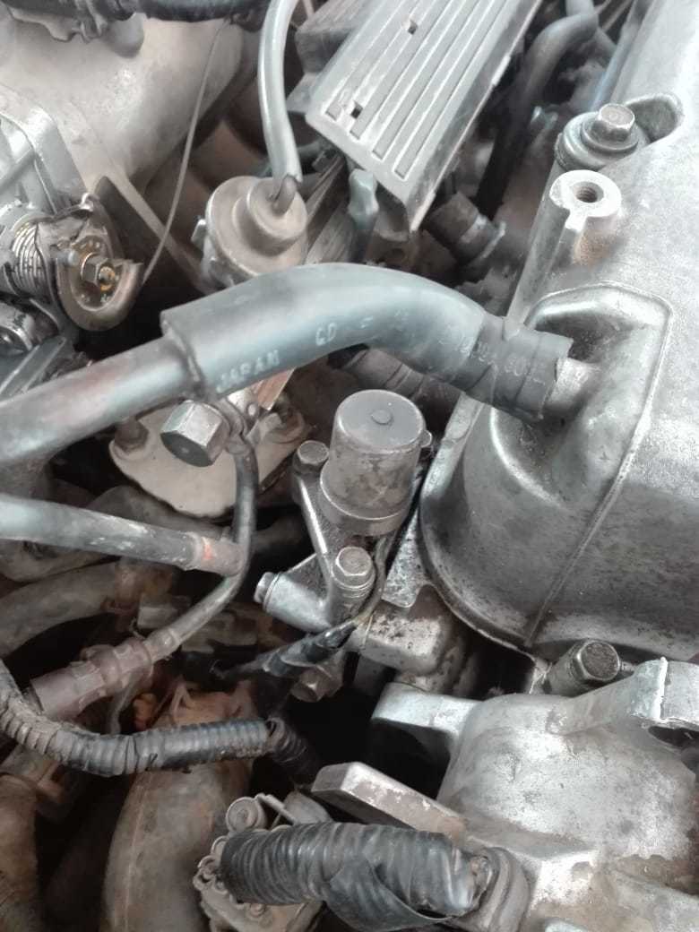

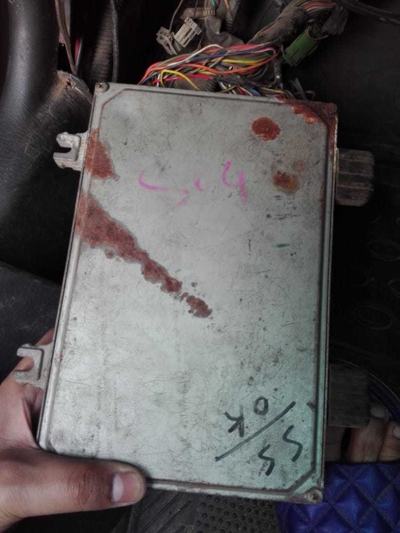

@Ahmed bhai and @Hassan bhai I ll send the complete picture of the engine in the morning. I got my car checked from yet another mechanic
He drove it and said that it seems to be timing issue or faulty fuel pump. Since while getting the car tuned the day before yesterday the mechanic told me that he had adjusted the timing belt, the fuel pump seems to be the culprit. Is there a way I can check it before getting it replaced. Ye na ho ke change bhe krwa lon and faraq phr bhe na pare. Also do you think that it could be caused by faulty pcv valve?
I noted the following things today:
1. Even without ac the car is too lazy to pick up speed. Instead when press the throttle hard it gives "ghoon" sound.
2. With ac turned on the poor thing hesitates alot. After delay of 3 4 seconds it starts to accelarate. Also gives jerks with ac turned on.
It seems that engine is exterting power but something is blocking it
