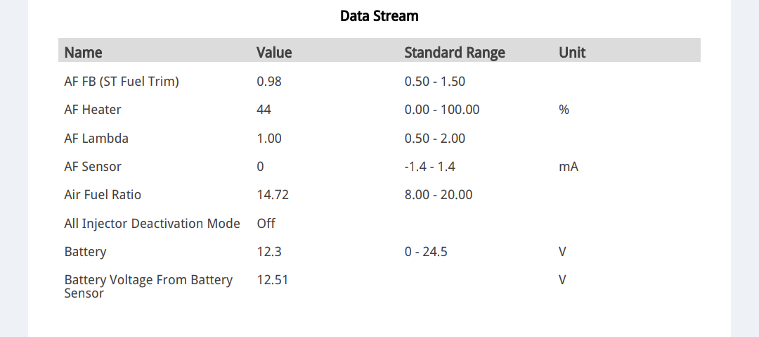

There are no error messages displayed, nor have any issues been detected by the scanner.
@Xulfiqar Bhai your guidance is needed.
