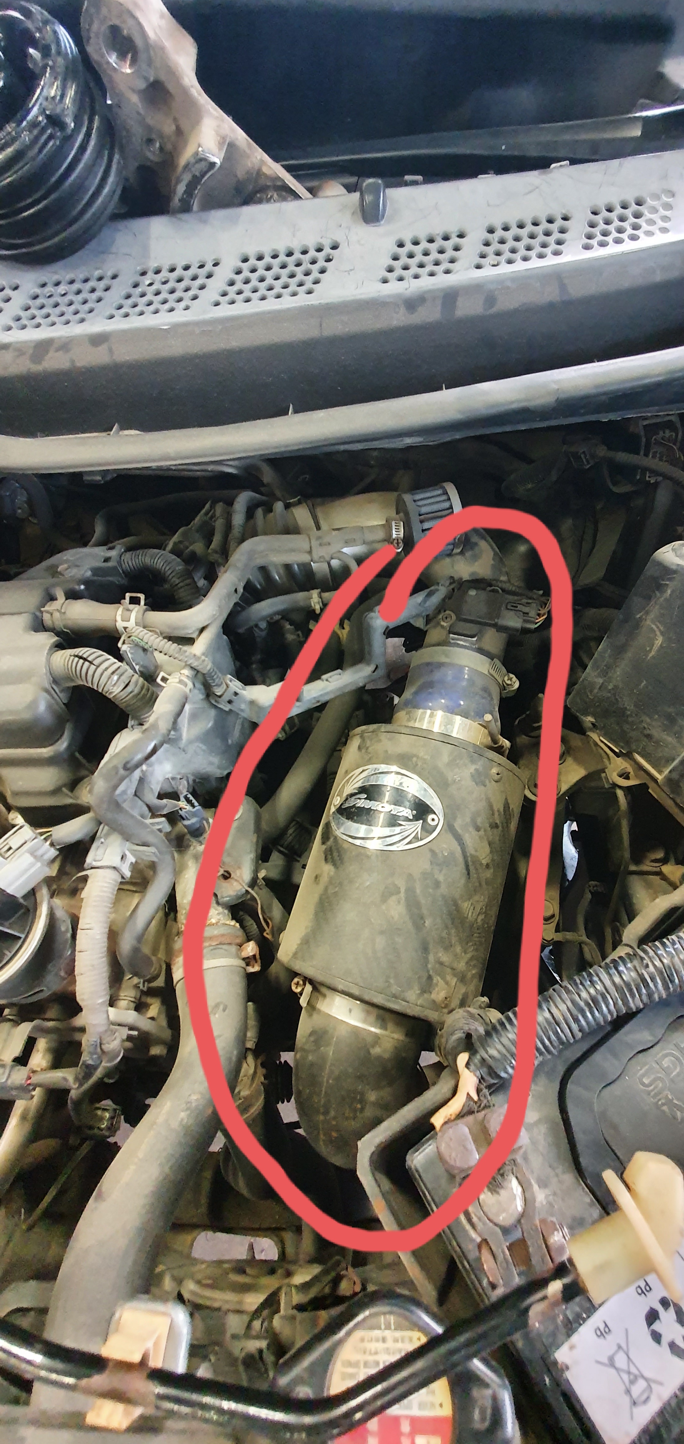

This is a Simota cold air intake kit, someone actually bought a proper bottom breather (albeit cheap) kit for this car like it's supposed to. Most people just stuff in an air filter cone in the engine bay that sucks in hot air instead of cold.

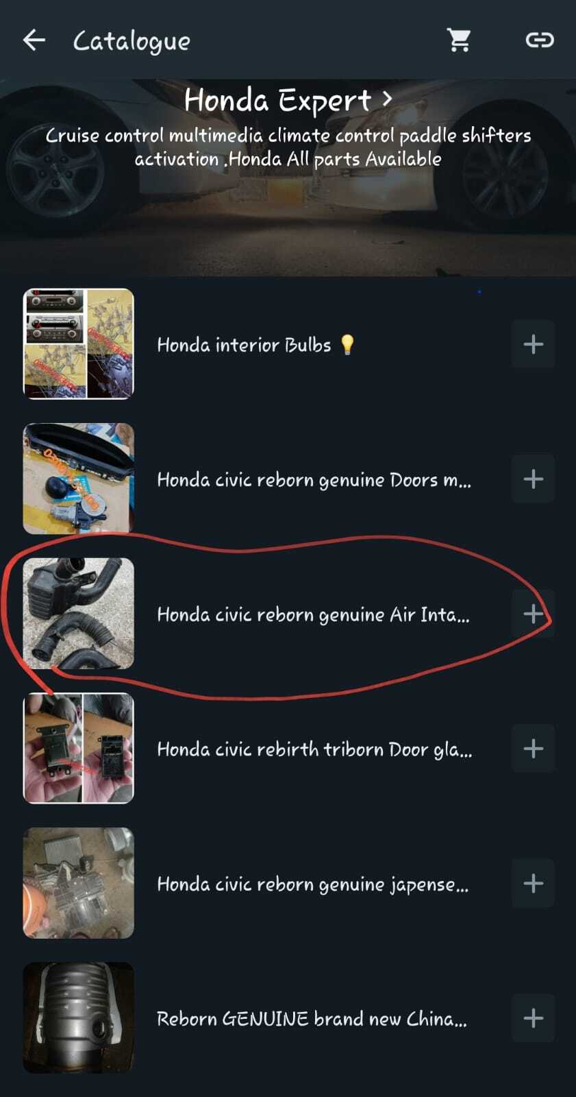

Without tuning, this air intake kit is pretty useless. Revert back to the stock air box, go to a parts shop and ask for reborn ka original air box complete assembly with filter.
