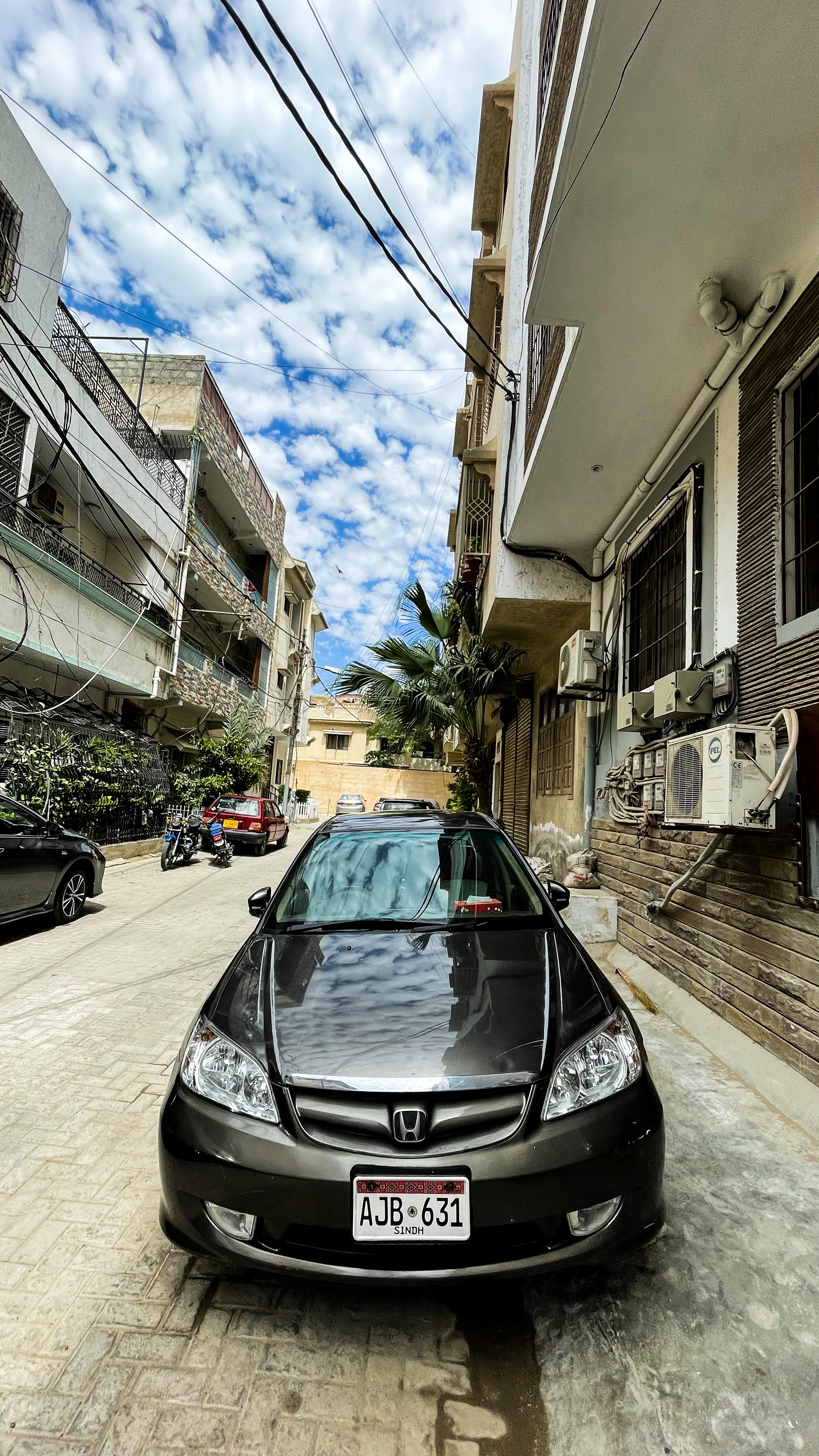

This is my beauty

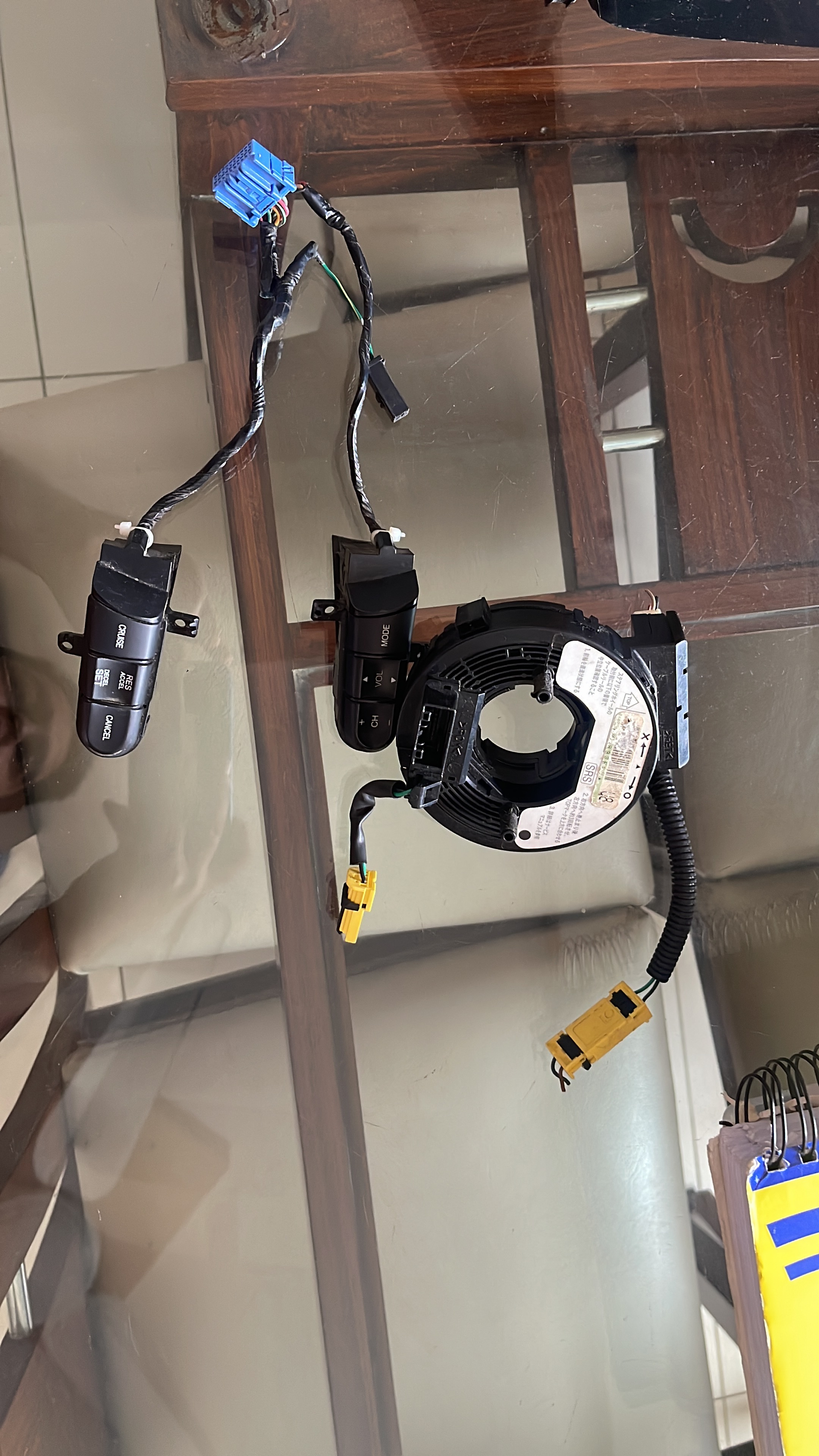

Will be getting Cruise installed in the next week or two @zunny made history by doing the first one

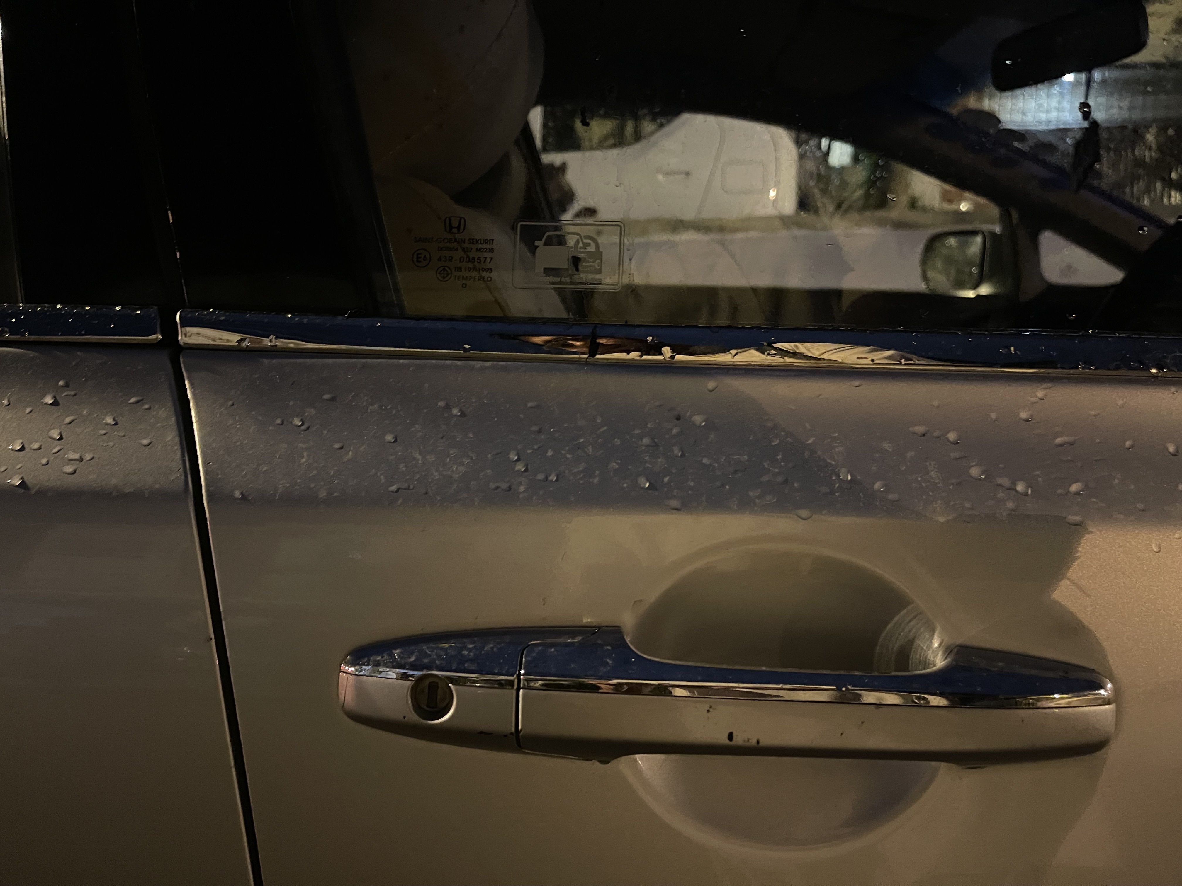

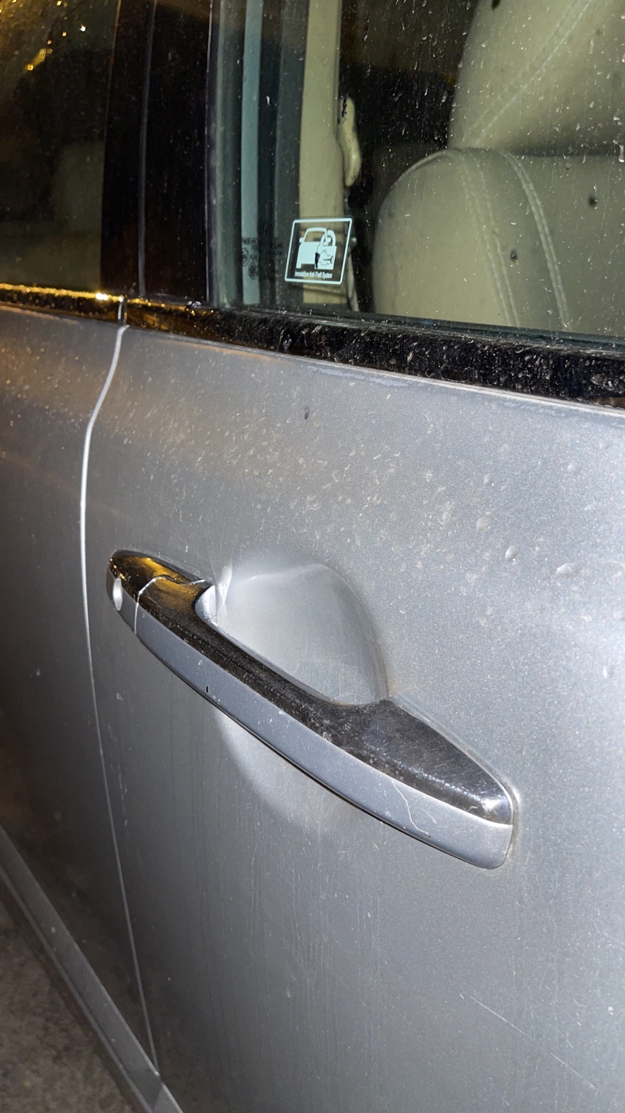

I also went ahead and bought kabli set of door handles from the hybrid version which are half chrome , got them for a steal at 1200/piece color matched

Interior trims have been wrapped with 7D carbon fibreCruise control installedRims have been buffedWill be sharing pics soon

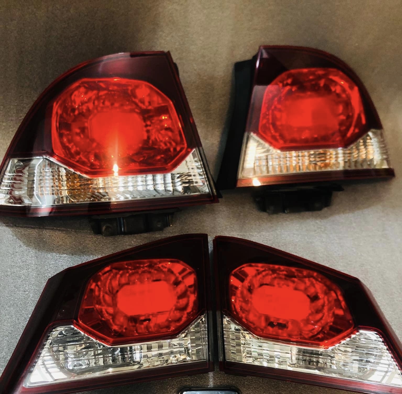

On the hunt for hybrid taillights and alcantara/suede steering wheel cover

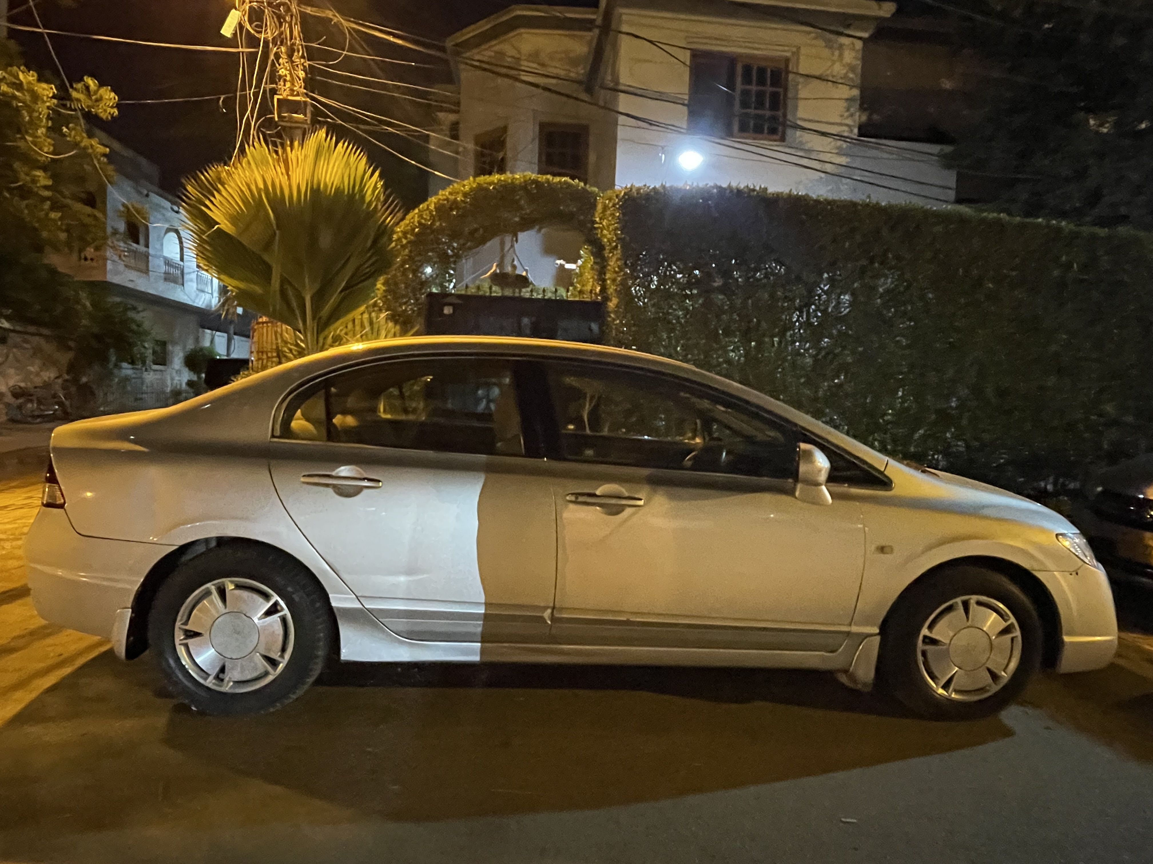

Logged in after 2 years , have been daily driving her since .Getting around 15km/l with 30km of motorway and 30km of city driving . Rear shocks are busted . The car needs plugs and filters . The adjuster bearing may have started to go out as I can hear a little squeaking . May have to check one of the engine mounts and get the bumpers a fresh coat of paint . She survived the monsoon got me home safely even with a high water level . Every day I start her up and she is ready for the journey ahead . I am grateful to Allah for such a car . I am saving up money for a exterior type R conversion and a top notch paint job . Hope to add the digital climate control and remote trunk unlock options from a jdm model
