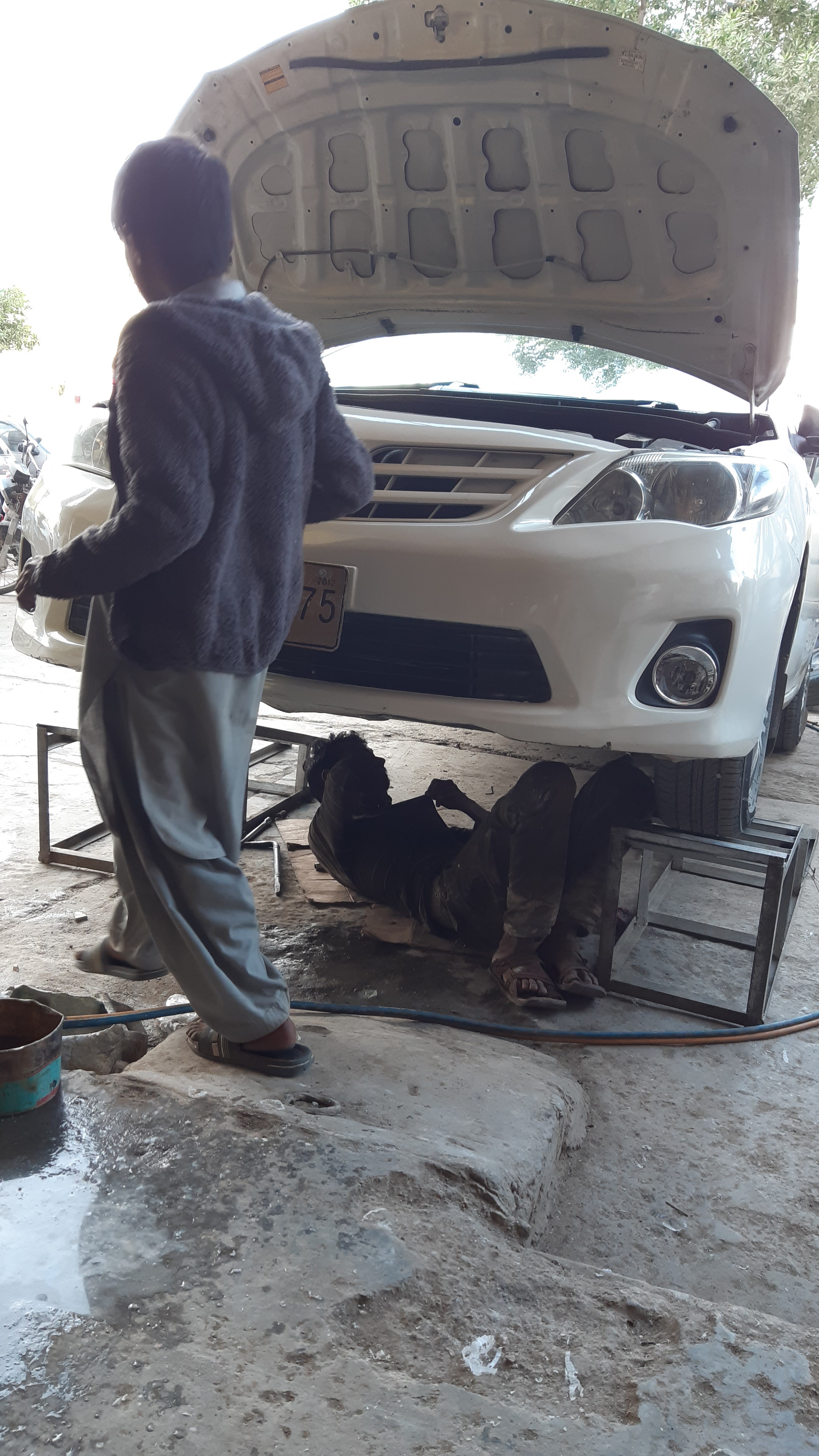

Went to the silensor guy he took off the exhaust pipe till the dholki

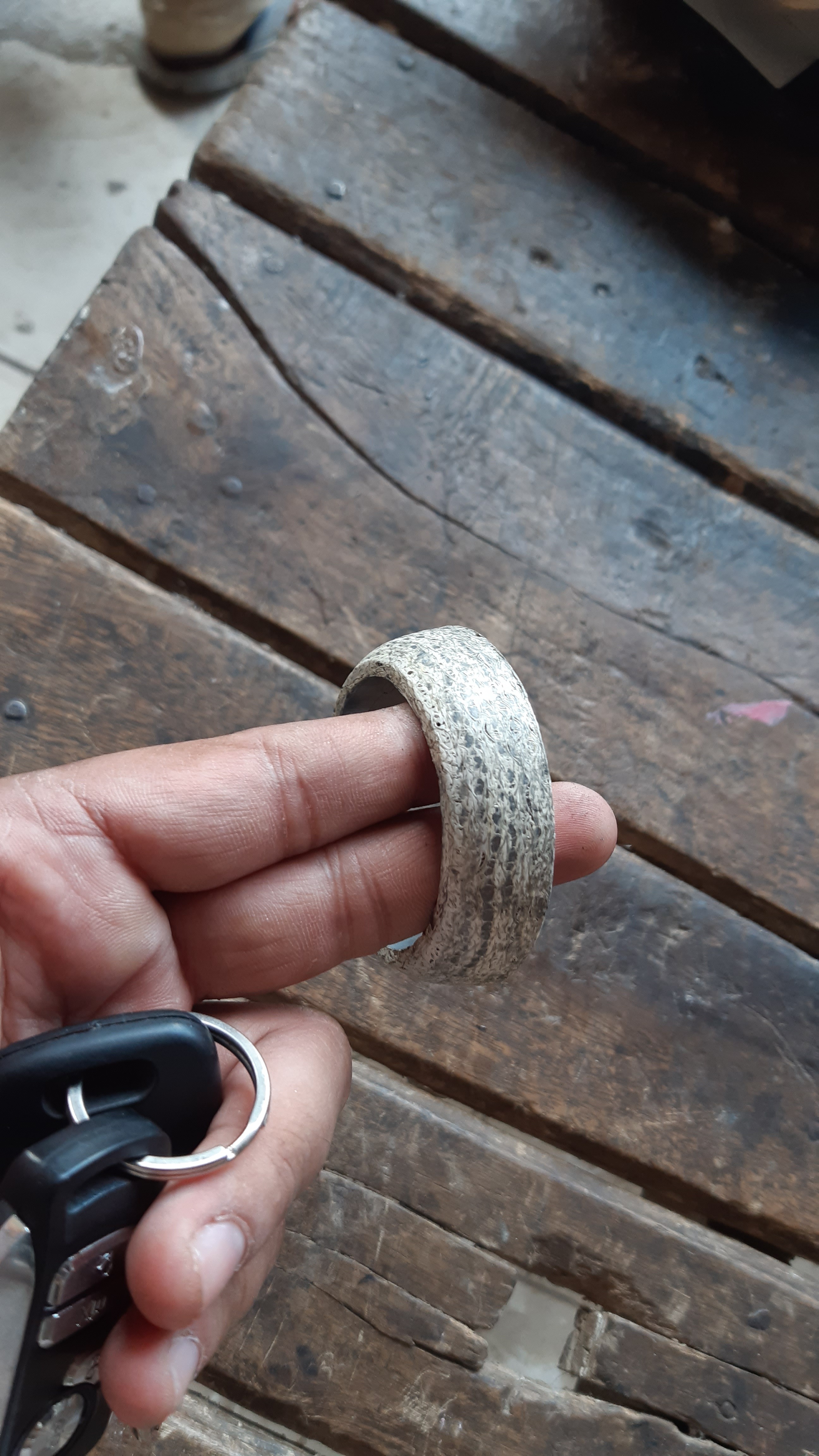

He then tapped the pipe from both sides and a rattle sound was coming from the secondary cat
Then after a couple of days i went to another shop he took off the cats and did his some kaarigari but the sound didn't go away
The i told him to he heat up the cat housing and press it with a hammer so maybe it gets press a bit so it gets a bit tight
But the guy again did his karigari and made approx 2 inch dents in the cat housing
