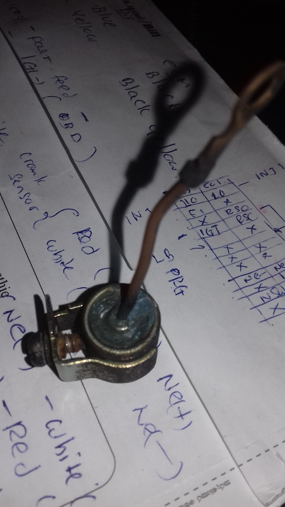

Yes after push start car is normaly running. I can drive it without stop engine any distance i want.
I check Ne signal with multimeter. When i crank the engine Ne signal voltage is 0.2v - 0.3v Ac.i think its ok.
Yes ecu has STA pin. How STA pin important for car start?
Yes starter fine bro. Working normally.
