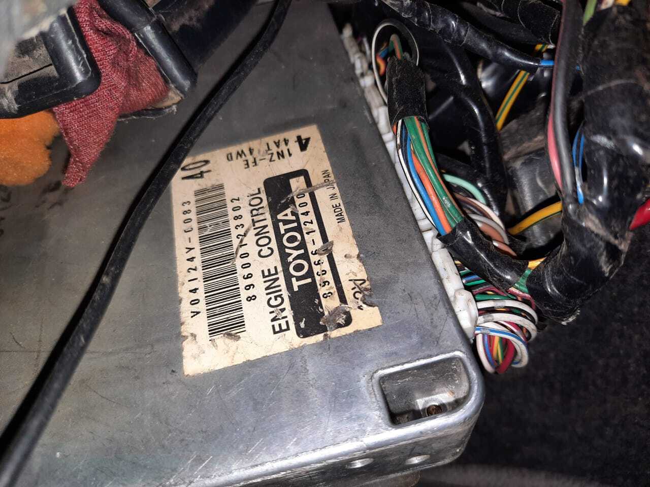

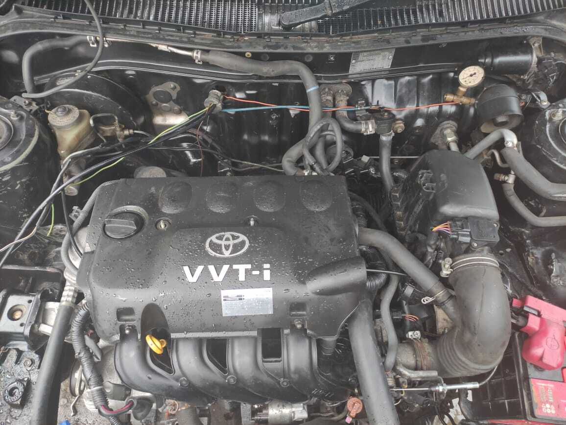

enjector which came with engine and ec is 1nz-fe 4wt-AT

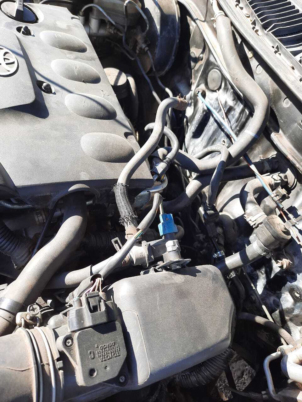

4wt-AT? 4 wheel drive!There is something wrong. Share the picture of injectors. Also hook obd2 scanner and share pictures. It is on auto fan? And thermostat is installed?
yes fan is auto recently throttle body cleaned and install iridium plugs injector color is green gear also have 5 seed when drive can feel the shift of gears till 5th
You need 2 wheel ecu. Which engine oil you are using?Yes green color injectors are stock. Have any picture of scanner?

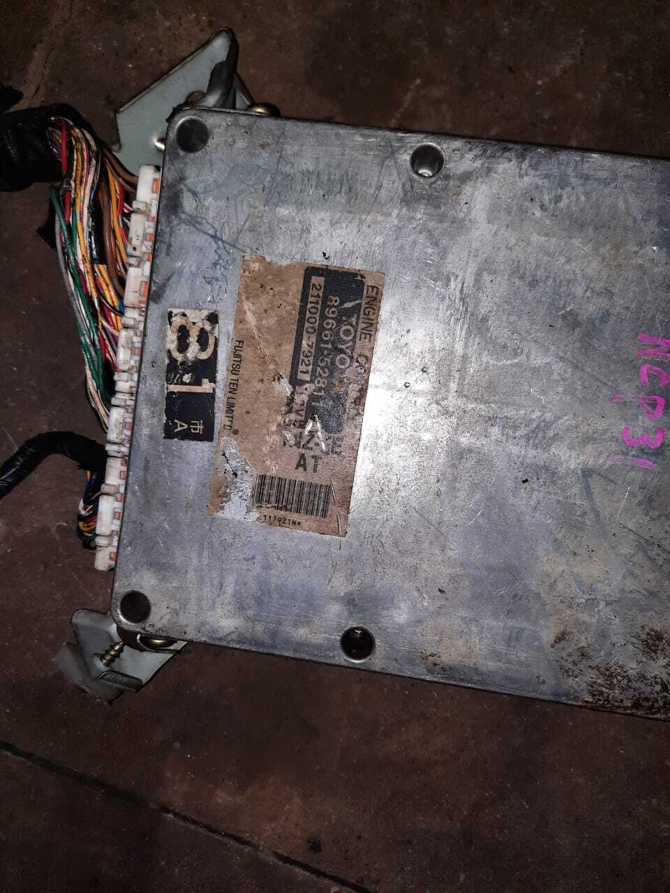

recently change the first oil kixx 10-40w before this ecu the one have give jerk in shift and did not shift after third to 4th or 5th the pic of old ecu is
when we attached Gscan2 it give no codes also no engine icon in in meter but when i plug out any sensor engine icon appear seems all ok
I will recommend 5w30.I want to see other logs. Like fuel trims etc. Which transmission you have? You still not need 4 wheel drive
