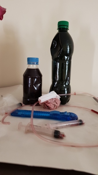

So I took out about 700 ml of oil from the dipstick tube, which i think is a huge quantity of oil. and drove the cars for some time. now the oil level shows at point B in the above picture (when cold). see the huge quantity that I have extracted as shown in the pic below
