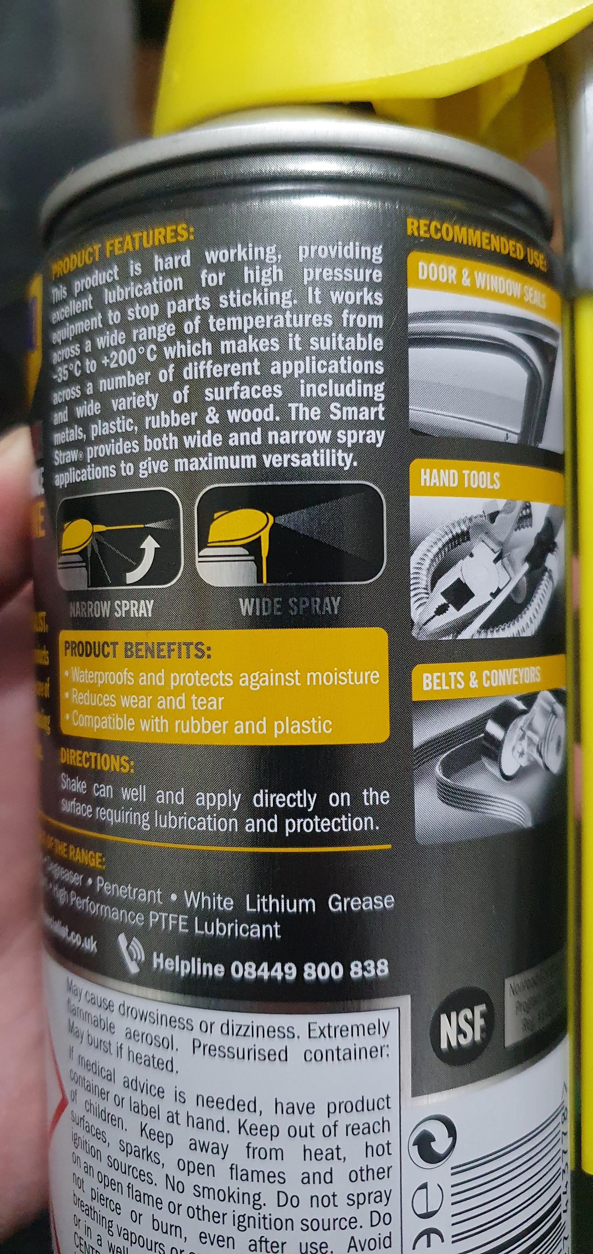

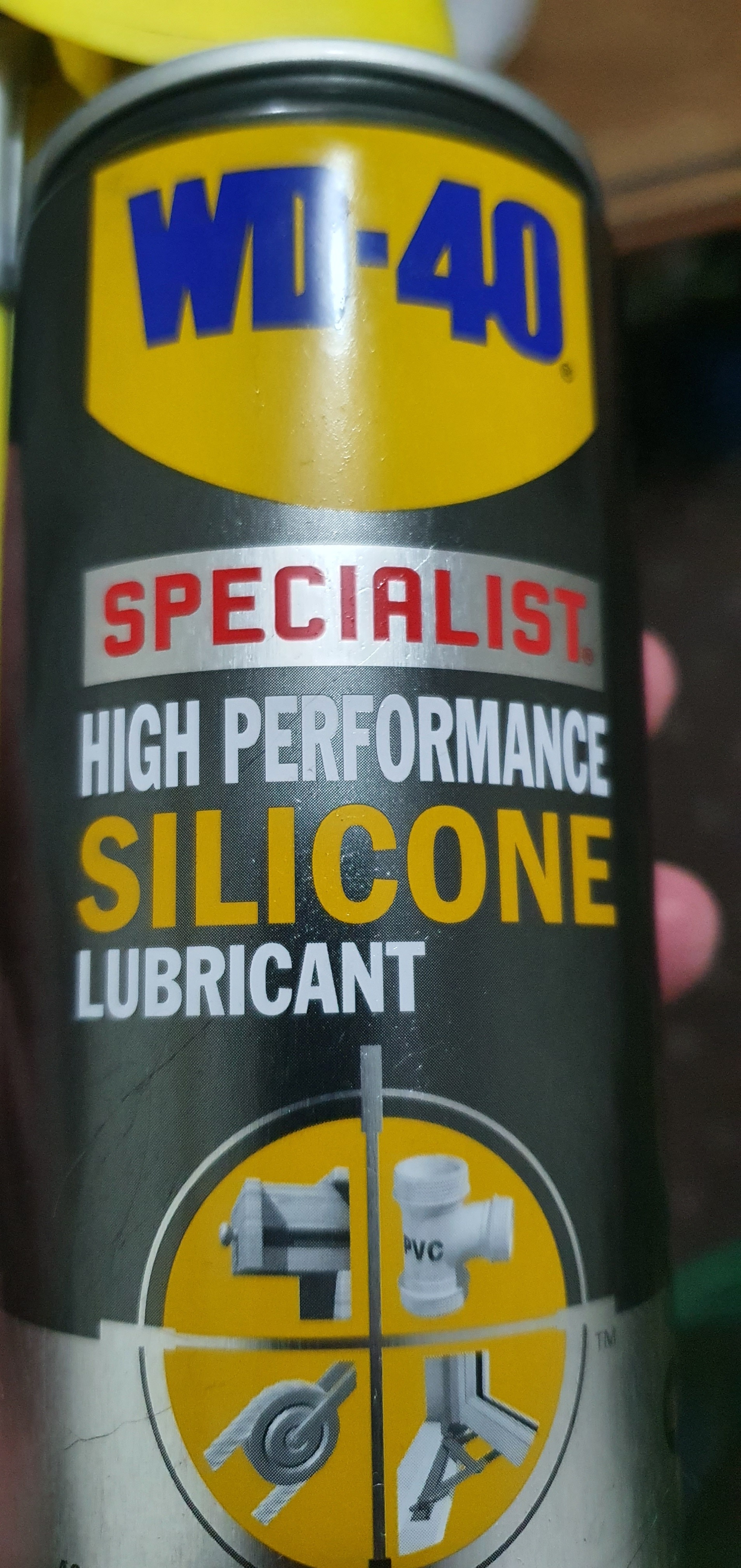

They're the common culprit here. As fellow pakwheeler suggested, try applying silicone spray to stabilizing bar bushes. Just to give you an idea stabilizing bar have bushes in the center. It joins the lower end of one side Z link to another side.
