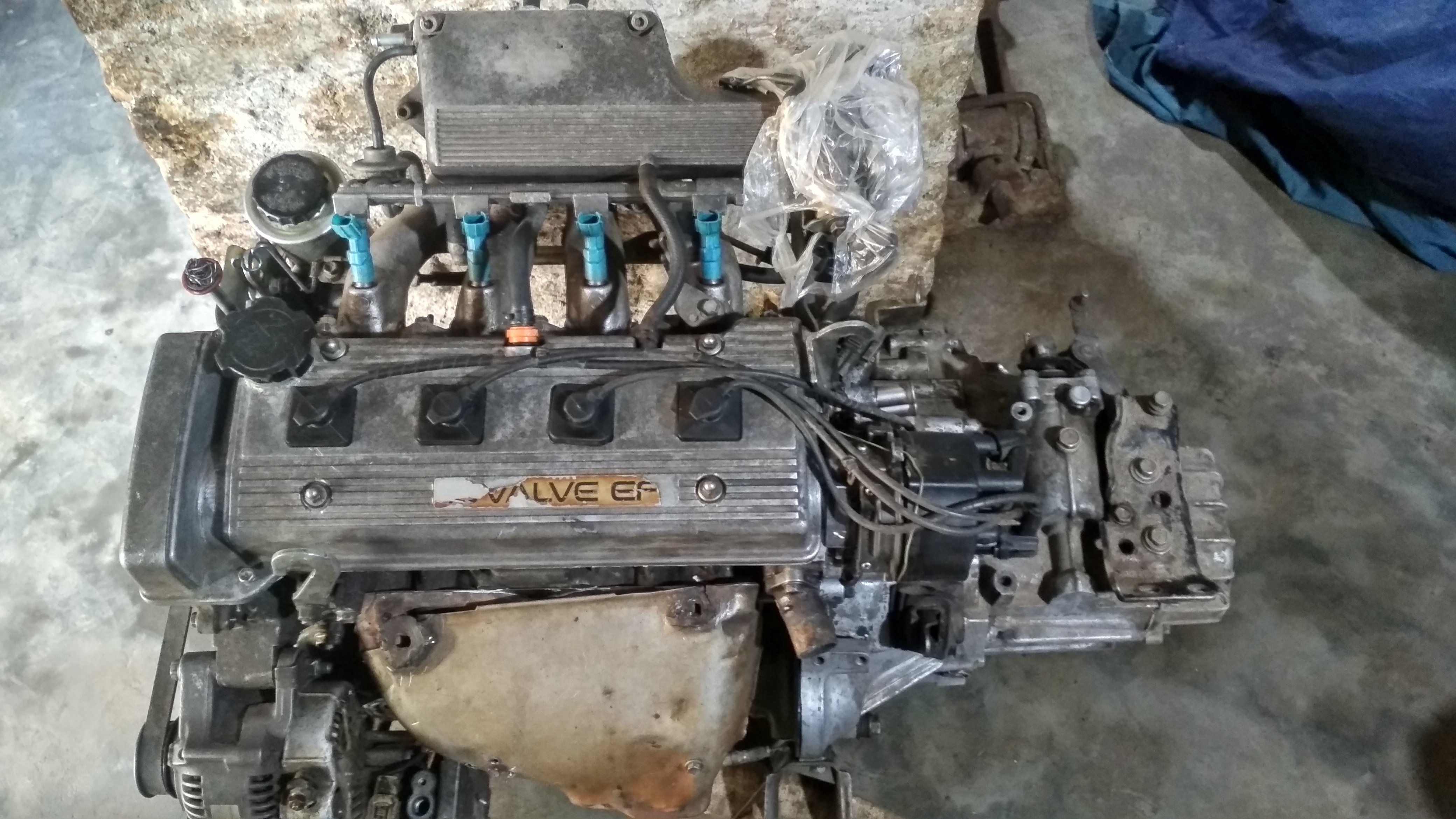

As stated above the engine had it's fair share of rough time.
It was taken out by the mechanic on 2nd or 3rd day. Upon inspection when he opened up the complete engine and transmission we got the clear picture.
Everything was a complete mess. Bad pistons, oil rings, valve seals you name it.
The mechanic was of the thought that the engine was already overhauled and to some extent I agree with him.
The transmission was also from another world. During the test drive earlier it would sometime popped into neutral from 5th gear and sometimes didn't went into 2nd gear. This sneaky little manual wanted to be like a automatic when it grows up
When opened this was because the 2nd and 5th gear synchronizer ( if I am correct) also called garari by local mechanic was broken.
Although the clutch pressure plate and disk was 9/10 reason it was changed recently by the owner.
The trans fluid was twin brother of mud.
So in the next 2-3 days we bought the complete rebuild kit. The mechanic and khairadia started their work.
The engine and transmission was completed and put together in last week of July and since then it is resting in mechanic place safe from all dust and dirt.
