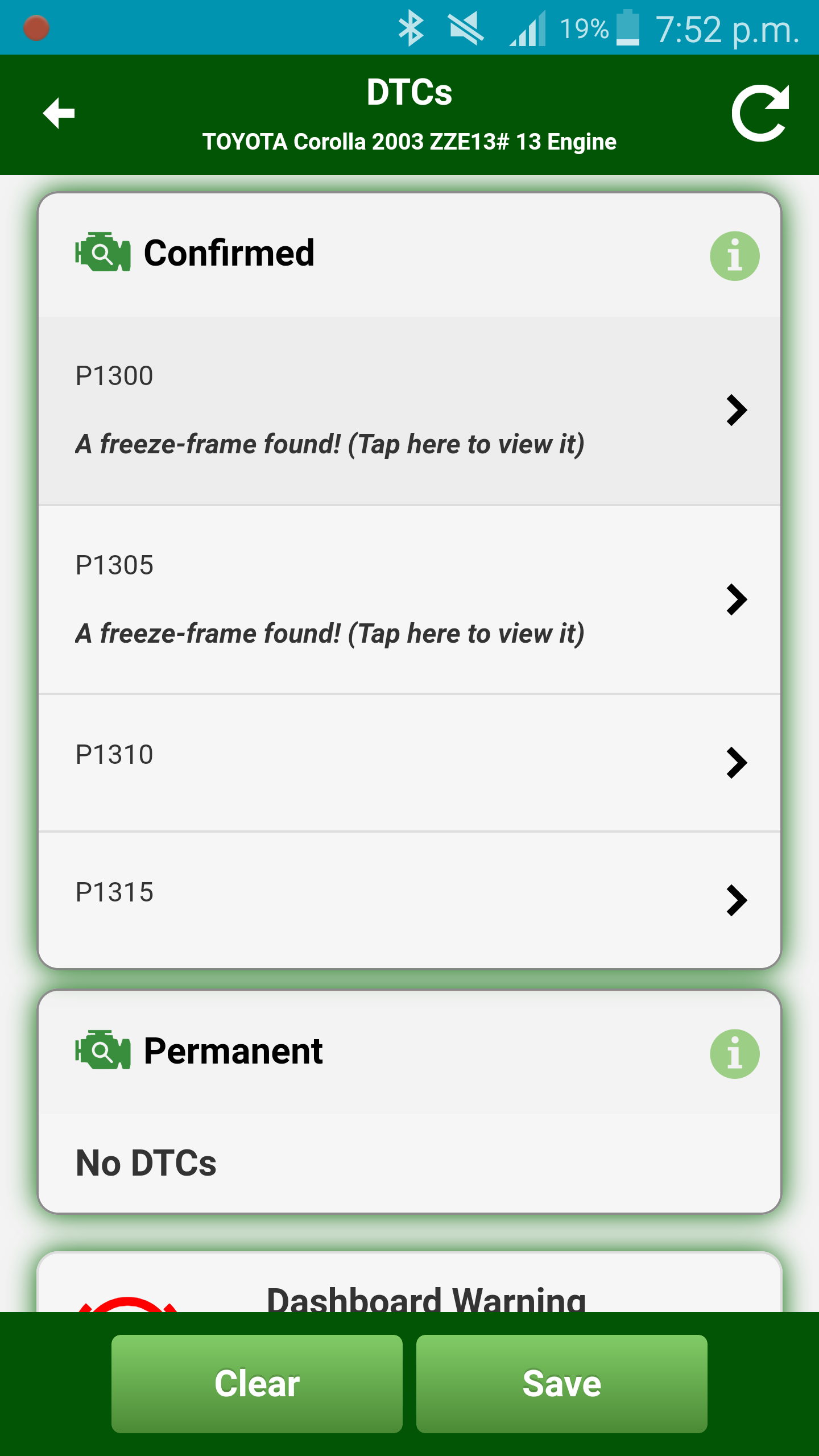

So now the latest situation:
Sometimes there are problem arising and then they vanishes. Like last week when car starts it burbs for 30 to 60 seconds and then normal. This problem automatically vanishes this week and from last 2 days difficulty in starting the car sometimes and hesistation on starting.
2 things are constant: coolant loss and oil loss
One thing to mention that acceleration and everything is smooth.
So today I went to the mechanic car starts fine. He opened the radiator cap and start the car there were bubbles coming. So he said head gasket is blown but this engine needs to be change now because of its sound. I further question him he said that crankshaft is sounding bad. I insist him to do compression test. On the first cylinder when the spark plug was remove it was submerged in oil. He attach the gauge and it shows 160 so he didn't perform it on other cylinders.
He is saying to put in a kabli 2nz or 1nz
Or if I want 3zz fe so only assembly should be placed I insist him that complete wiring and ecu should be placed as japanese 3zz fe has different ecu and vvti enabled and O2 sensor. So he said better go for 2nz or 1nz complete
For now if there are no major problems I will be running it with this stock engine and push it to its limit. Odo is almost 160k kilometers
Please give your suggestions
