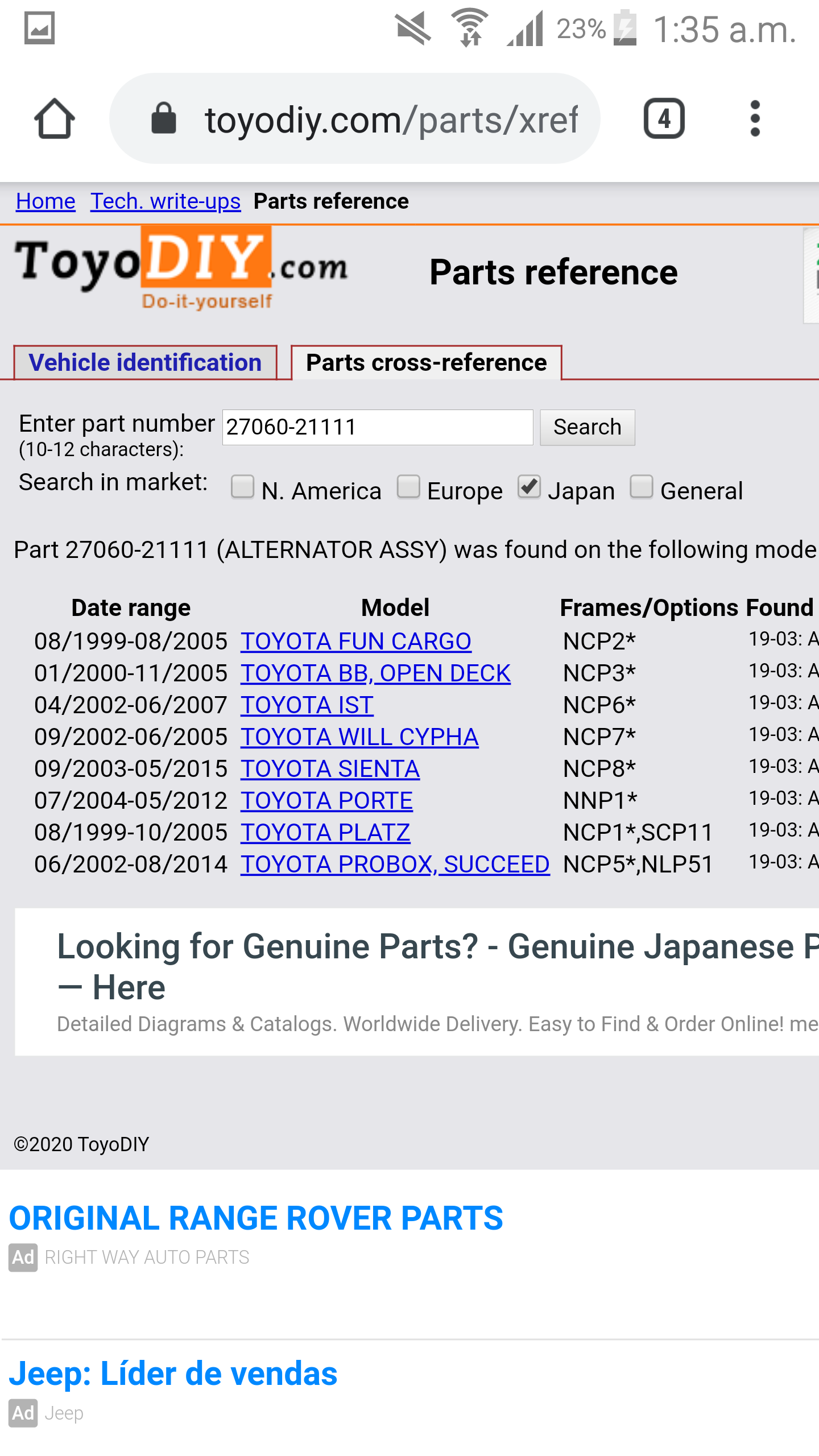

Check this: I searched the alternator part number attached to my new engine and it shows what cars and years this part is applicable
click on this model code at the bottom then go to option 2, then go to option 2 again transaxle or transmission gaskit. then you will see in TRANSAXLE ASSY, AUTOMATIC
YA you can actually use this link to know about car parts etc. keep clicking on them and it wll also tell about parts. click on the part code number it will direct you with the suggestion on google with picture of the part and where to buy online and price etc.

I want to find any unique part number from the engine or trans that may get me close to which model and year the engine is from.
start searching for vitz 1st gen engine to get closer.
the yard engine came with U-340 it is from a new gen of vehicle.

Its from Vitz first gen basically 1999-2004.
Not only vitz this engine + trans came in many other models also. I have searched on the given link by @def3nder
Bro toyota makes several similar parts for many cars.
So that's why I am saying it is not fix that it is from vitz. It can be any other car also. If you are saying this because of engine code then it's another story
