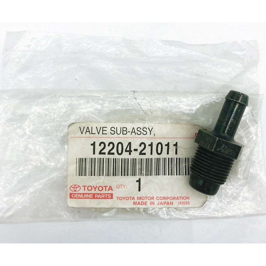

Mujhay lagta hai aap ka use itna nahi
PCV valve say kuch nahi hota main change kr k dekh chuka hun 2200 ka import krwaya but no change in oil consumption
Kis cheez ka?
Ager kharab hai tu wo oil consumption kerta haiBaqi at the end rings hi kharab nikaltay haiBut this much consumption is ok and I am not worriedAlso how to import pcv valve?
If u shake the pcv valve and it rattles then it's ok.otherwise it,s bad.New one will be available with dealership maybe
Se saloon ka
Parts Central or Hamza Younus
Almost 4k kms drive ki hai 4 months mein
PCV valve is a very commonly available item at part shops.
Original nahi mil raha thaa buhat try kiya Plaza may bhee dhoonda China ka mil raha thaa
NoIt's not availableBecause people here love kabli

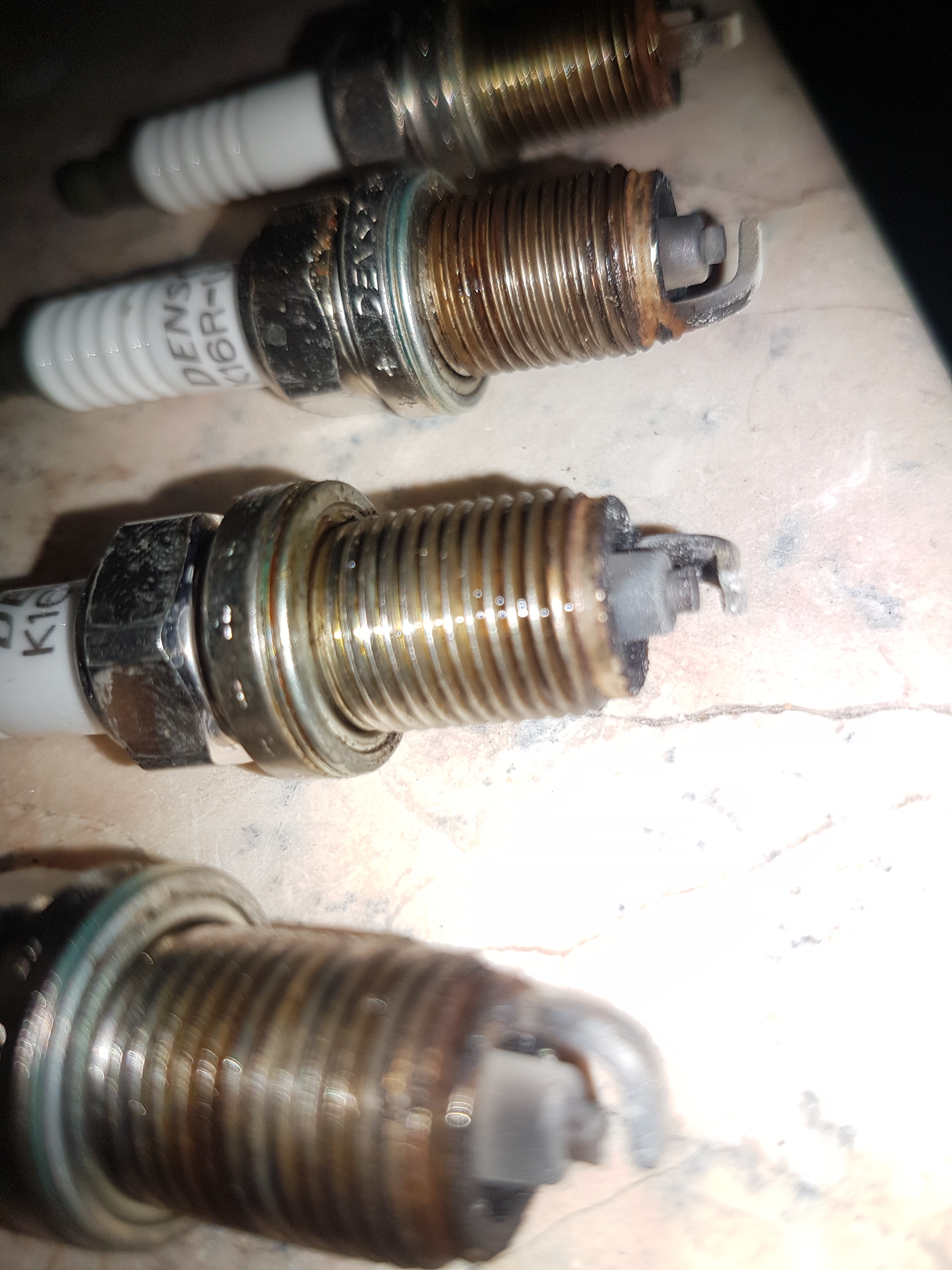

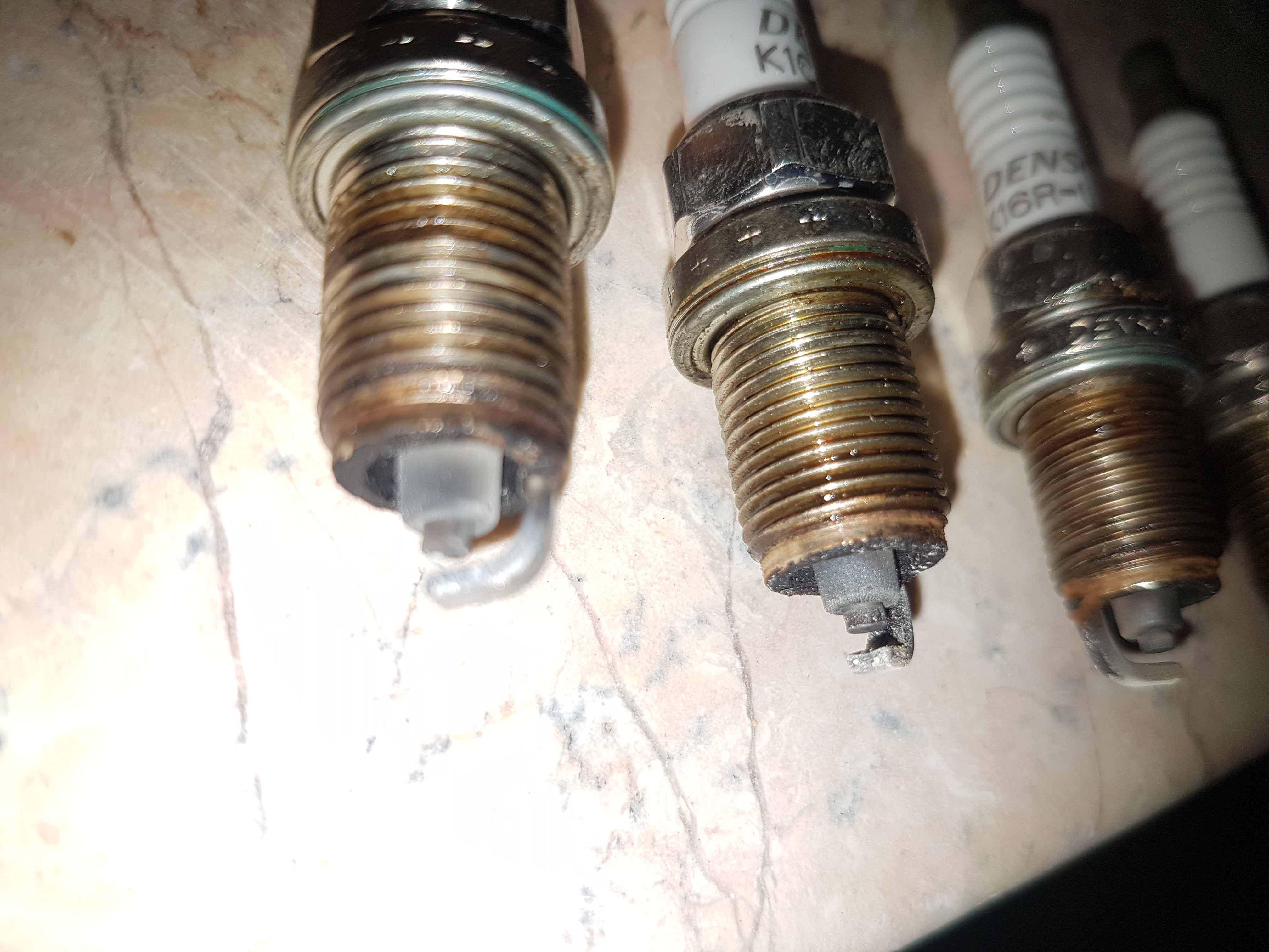

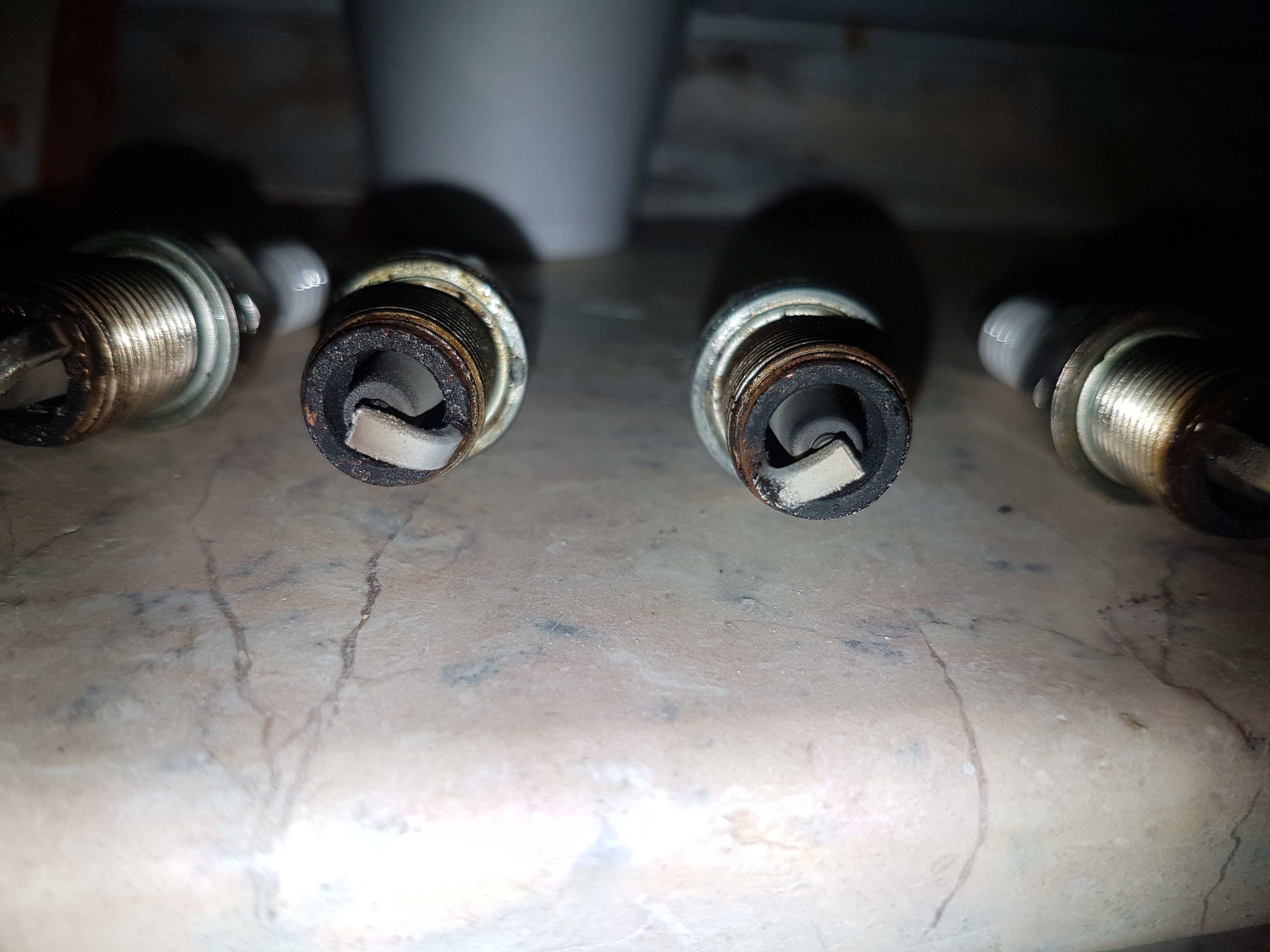

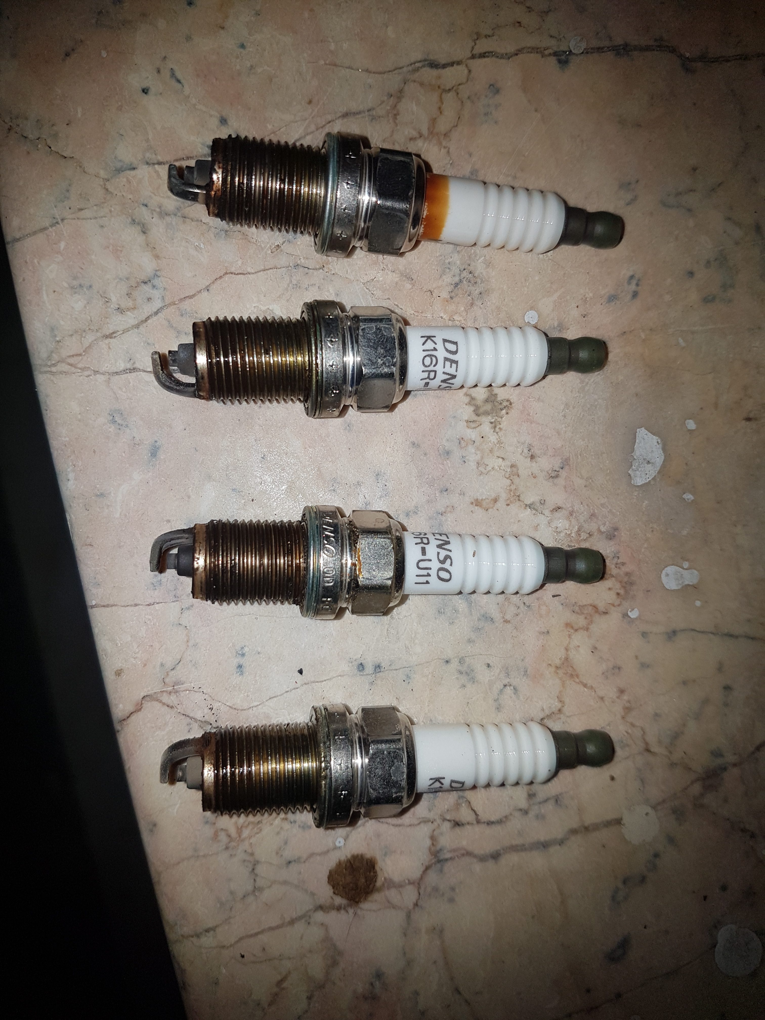

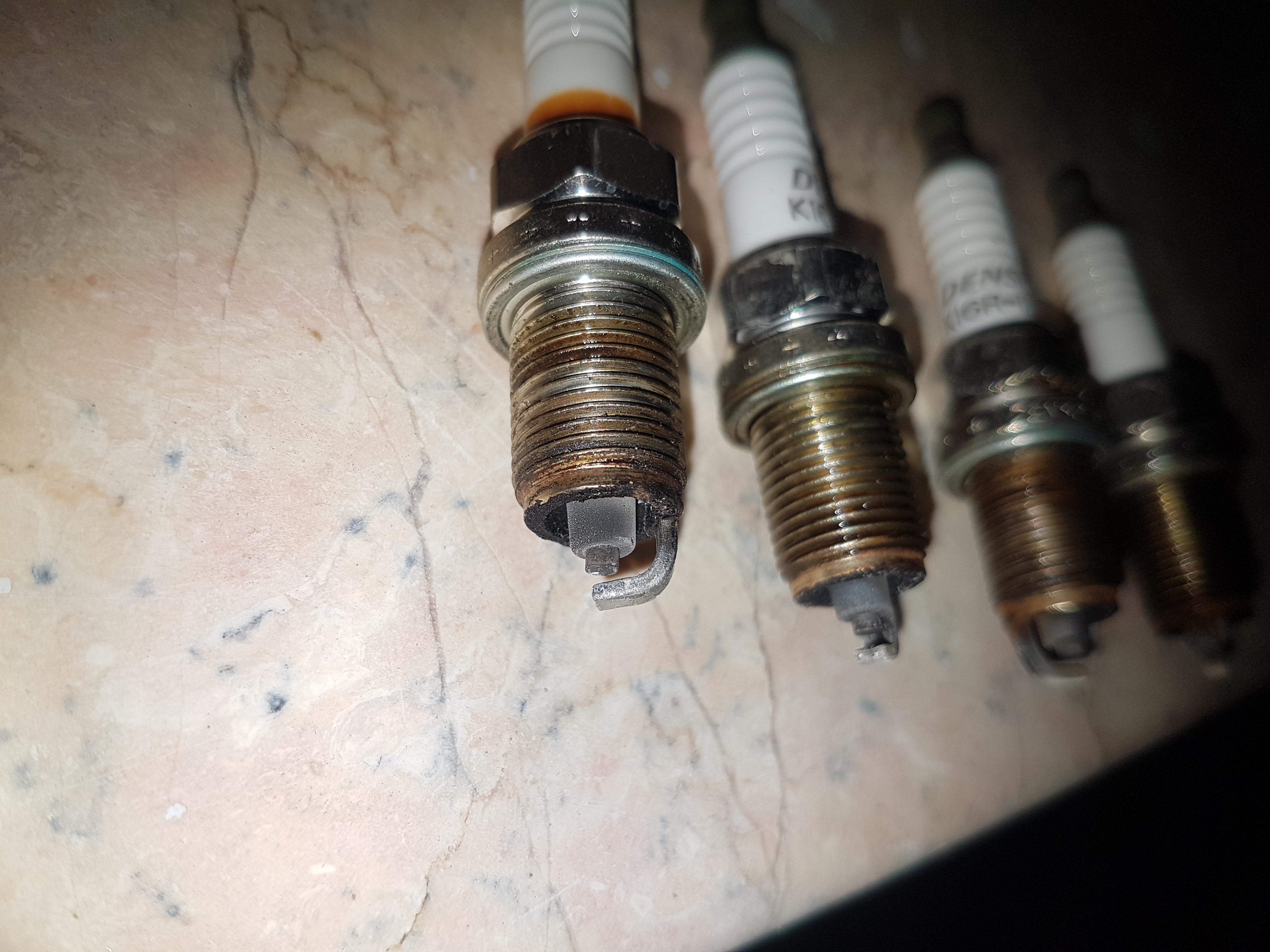

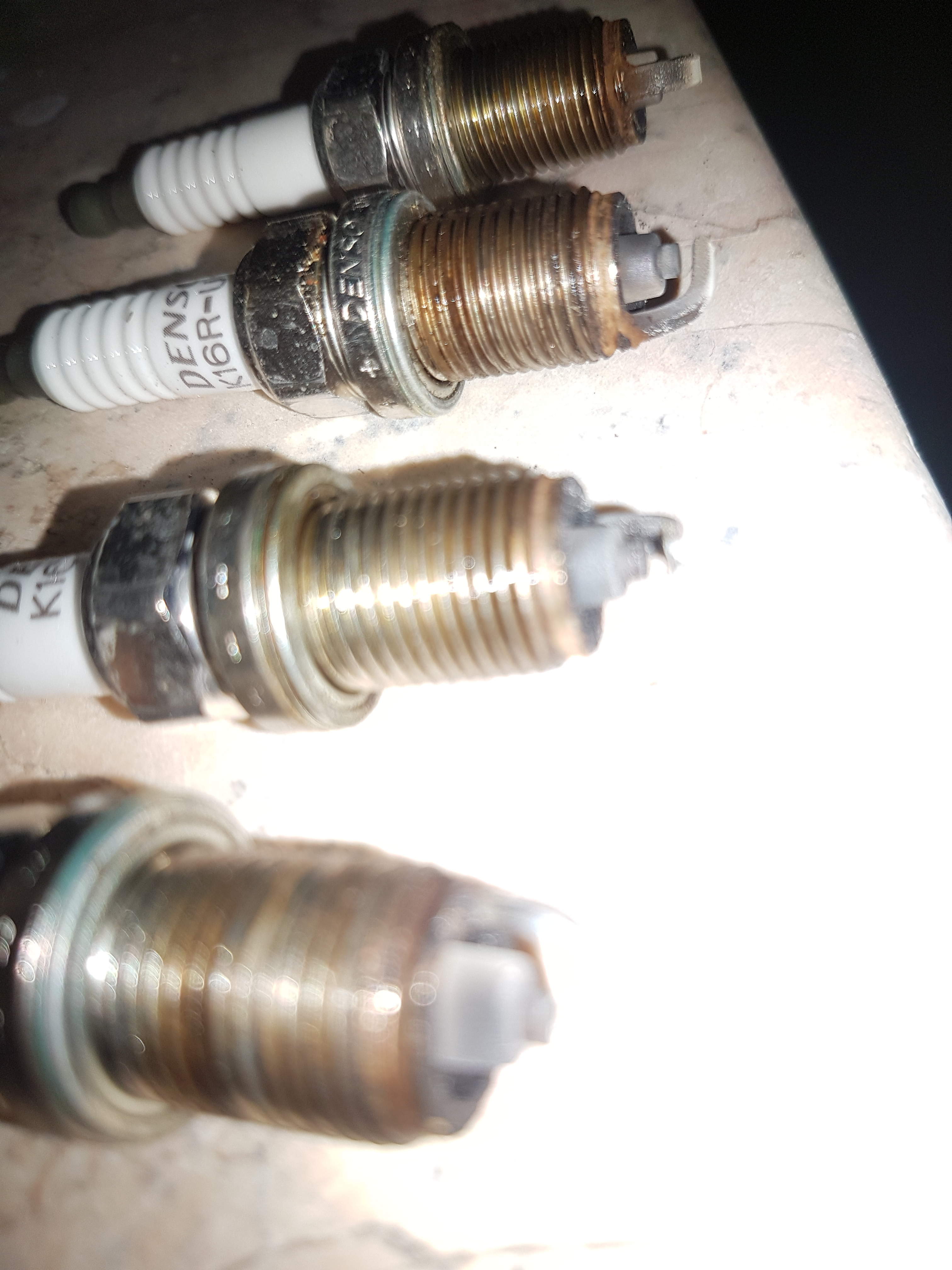

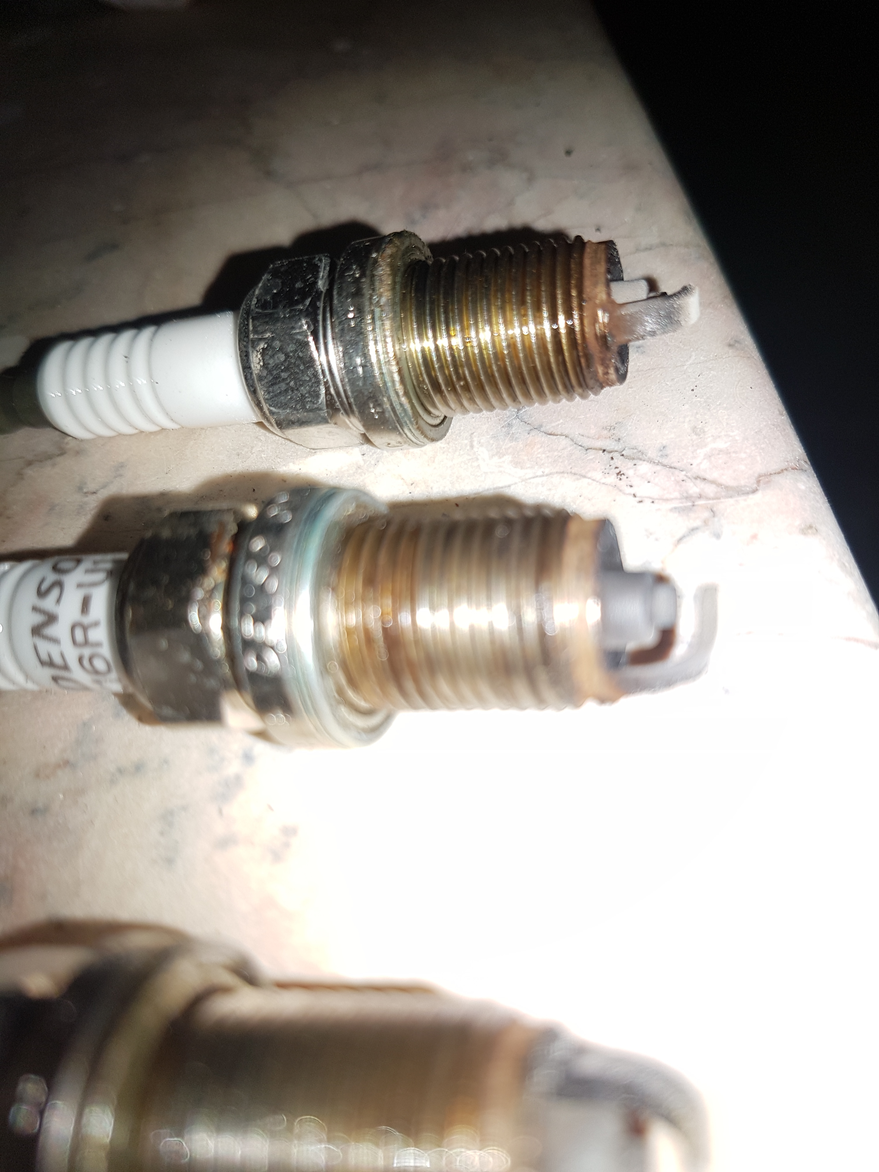

@capsat @xenerking @Xulfiqar @Hassan1991 @mohsin-212 @rajaatta @babarhyd @dayrider First Spark plug tip was mistakenly cleaned by my hand
seems oil consumption
That's a issue but it only lessen the oil to 25% mark b/w full and low at around 3000 kmsBut I posted because of bad fuel average
please check ur MAF sensor operation using compatibale scanner
What you want to see? Last time I checked it with launch scanner and didn't find any problem
Seems ok to me. Oil combustion in your engine is normal.
