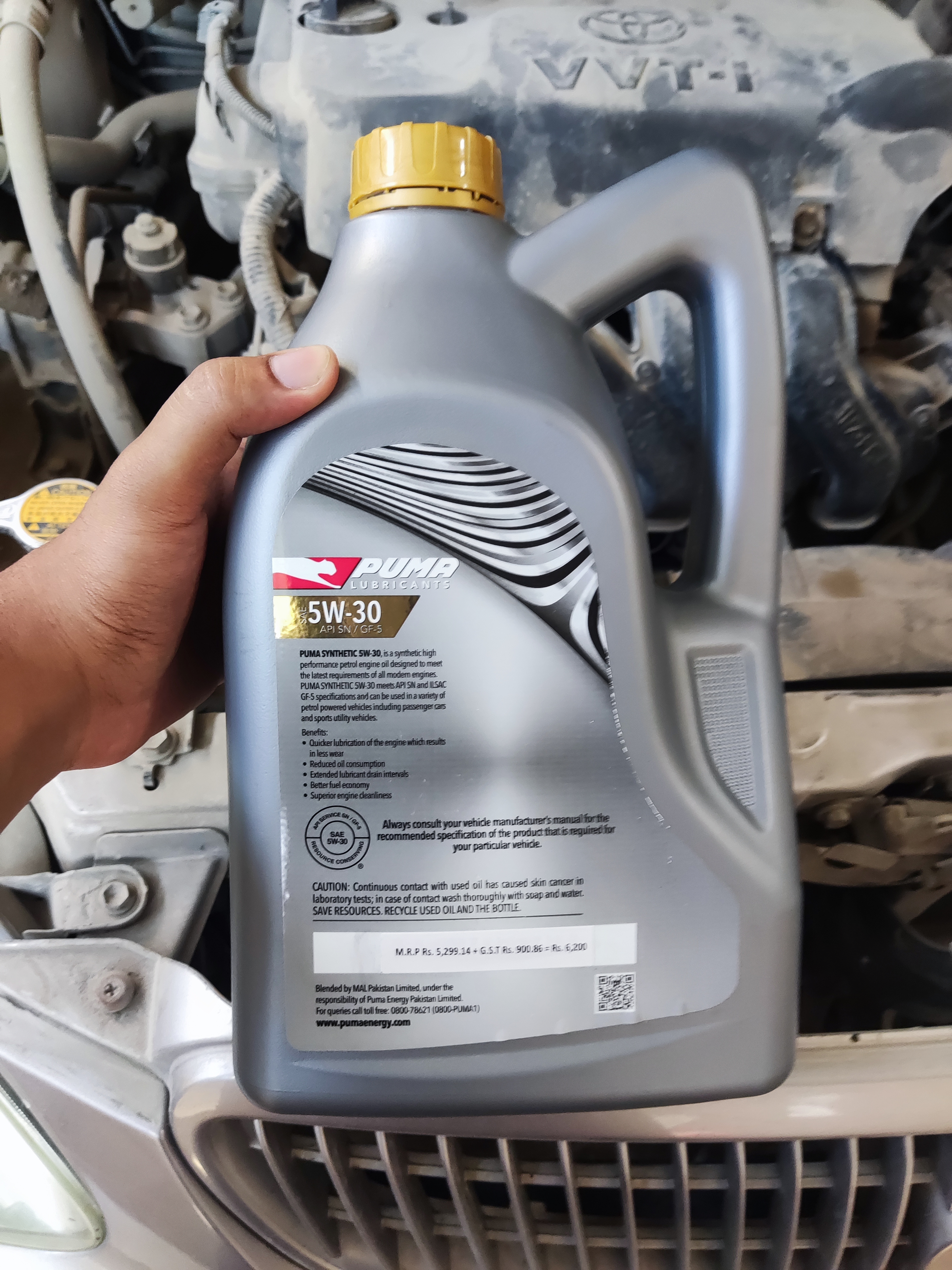

to me the plugs are covered with grey ash residual from oil burning, a bit similar to 2 stroke engines.

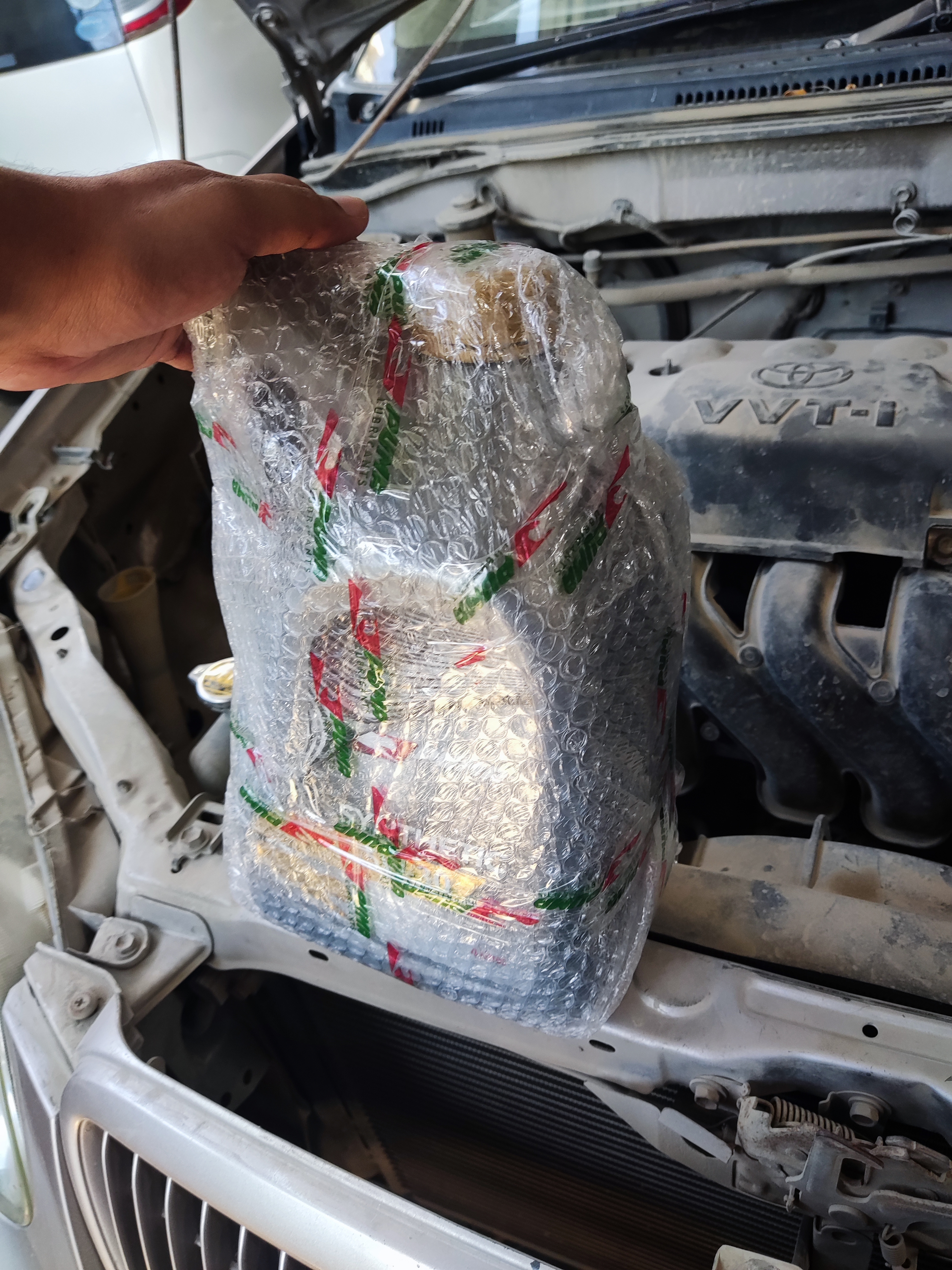

which oil are u using? u can try changing sources to confirm the authenticity of the oil.
frankly, i feel its a bit on the higher side, oil consumption within the tolerable limits dont leave such residual/
wat is ur current fuel consumption figures?
