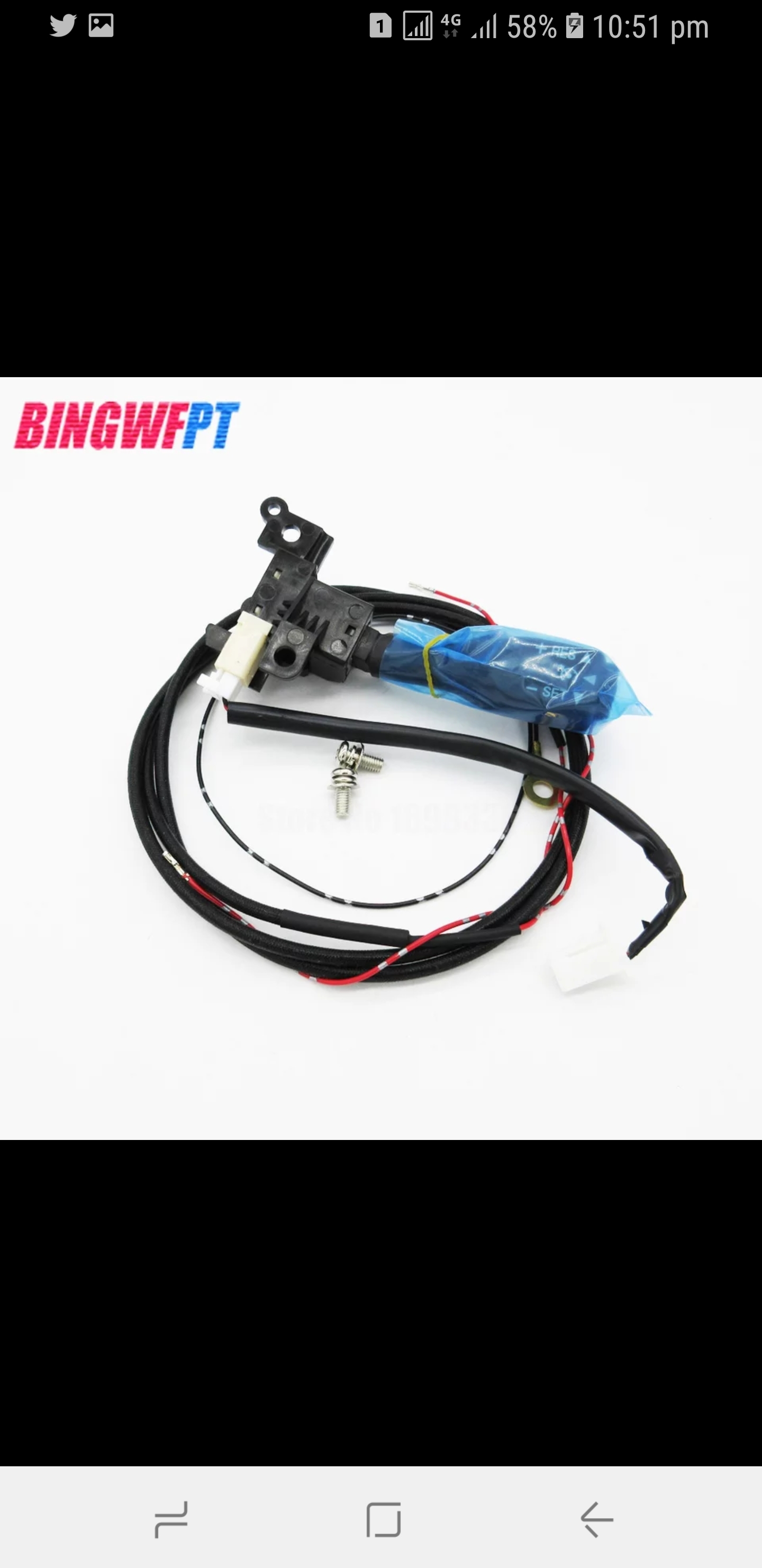

This specific meter does have light for cruise control and its SET light and even maintenance required light and fog lights indication light but no idea if the circuitry is present in PKDM Corolla. It could be that just wiring is not present which sends a signal to the meter to turn on the light or that there is no LED on the circuit or even the chips that are required. Corolla cruise works on resistance so there is a single wire to the ECU which tell if its SET or just ON and Cancel button was pressed and same goes for the meter that same single wire is sent to the meter. I have tried to find the wiring diagram for this meter but no luck. If i had the wiring diagram i would repin the connector to add a new wire in that specific pin and see if the light turn on or not.
Cruise i have checked it works. You have to add the signal wire from cruise in pin A39 i think of the ECU and the using Techstream i checked that ECU recognized that cruise was present and all functions of cruise were working as they should. Only problem is the meter i would not like to use cruise without the indication in meter as that can dangerous.
I have send a message to a lot of these people from Youtube if they can identify and tell me at which pin is the wire from cruise sent to on the meter but no luck, no one responds
