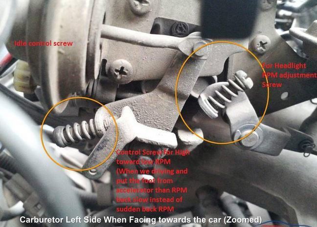

If you are facing the car from front then check at the left side of Carburetor you will see two adjustment screws one that is towards firewall that is for dashpot adjustment and the other that is in front is for Electrical load idle adjustment. There would also be a plastic screw at back that is for idle rpm adjustment.
