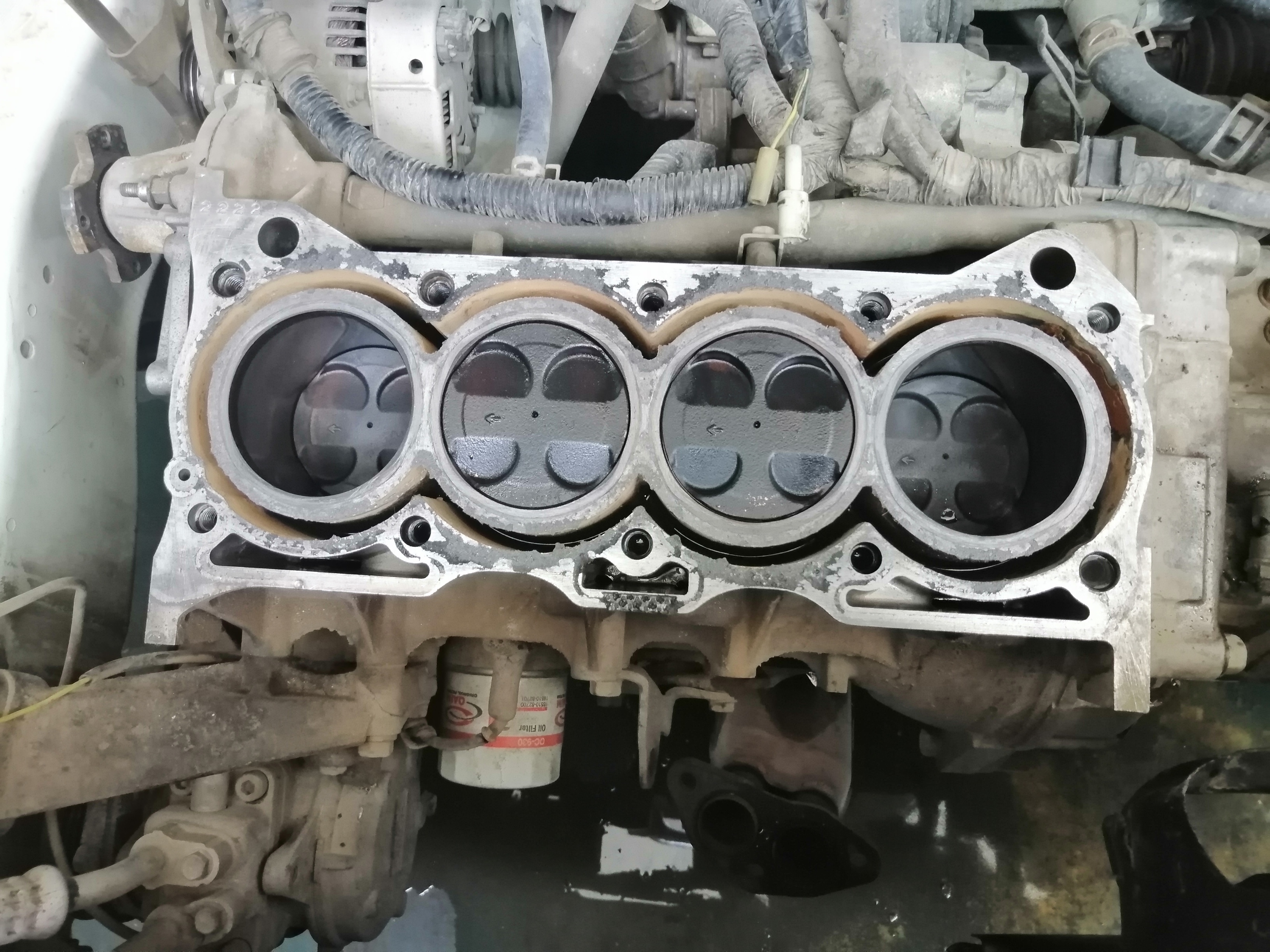

I have cultus 2010, it was super fine then it went to some idiot hands.
He forgot to put radiator cap, water evaporated on long drive and car heated up and he didn't stop, untill the car stopped by itself.
He made some fixings from the motorway workshop, returned back and handed over the car to me.
I didn't knew all this. I kept on driving, radiator fan was direct, and water was reducing even at few kilometers. After all that I came to know the issue.
Now I'm at Suzuki workshop. They suggested full engine repair, gasket issue, water body leakage and pistons replacement(Play in pistons), I'm almost noob to all this, The estimated bill is about 70k. and they also mentioned that all new parts would be local. What should I do?
This is the current condition.
Someone suggested me to get a "qabli" engine, should I consider that?
