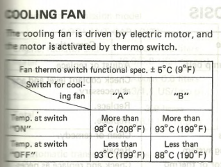

gents do i understand correct that even if 2/4/6/8 channel radiator is installed with high coolant capacity, the engine with thermostat will operate at the very same say: valve opening 88 / 92 C switching automatic fan on/off at 98 /93 C ??
