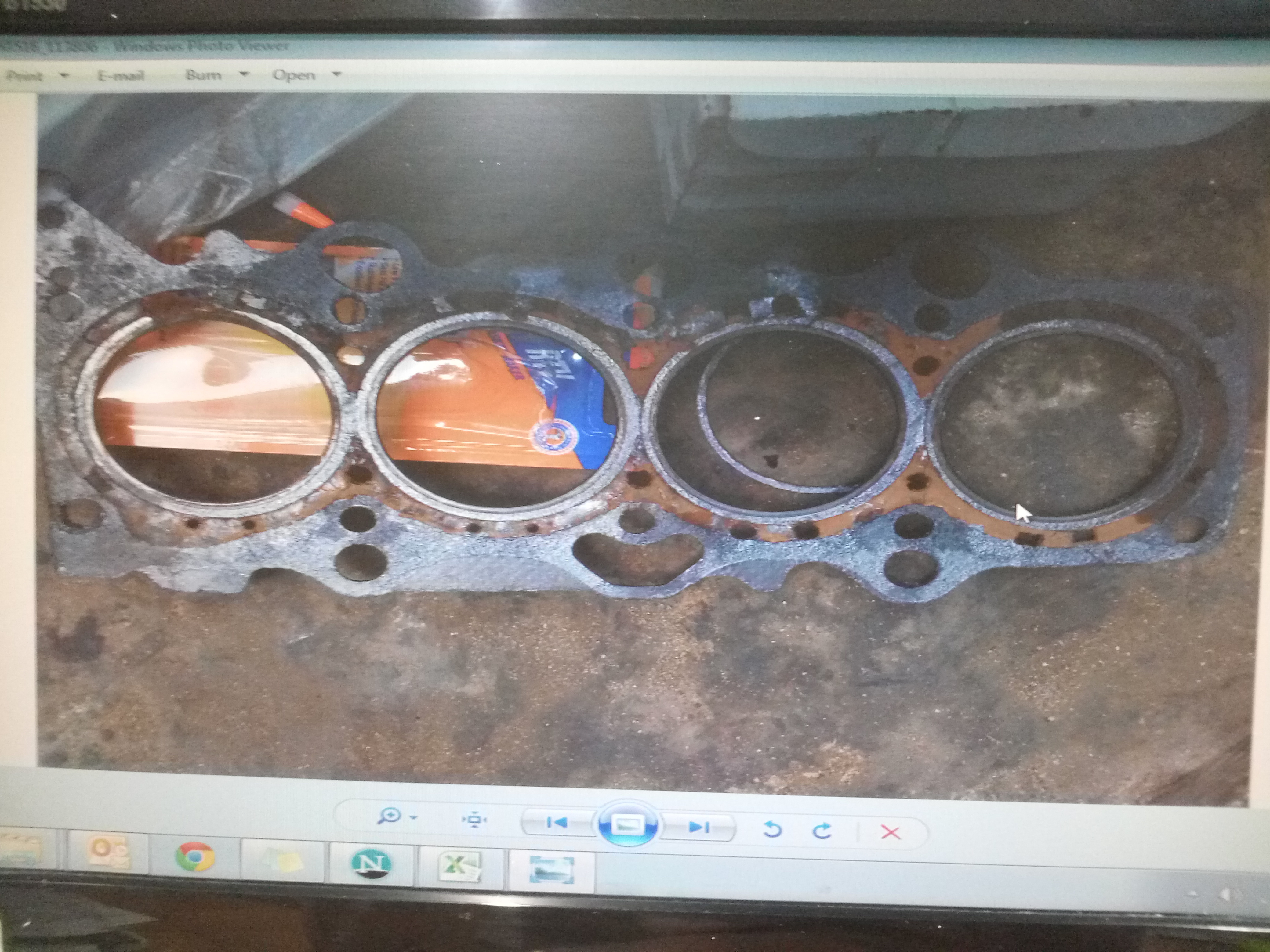

Dear luckycar. Ok check few things first.
- Open engine oil cap and see the color of oil. If it is milky white then surely it's gasket issue.
- Open radiator cap (when engine is cold) if you find oil floating on top of water, it's again confirms the blown gasket.
- If yours car is throwing water from exhaust again confirms blown gasket.
Don't panic . Tow your car(don't drive) to good mechanic. He will charge 1500 Labour for gasket replacement. Make sure you face the head. Your mechanic would also see number of other things like cracked pipes. Water body etc. Follow his advise.
Thanks
[/quote]
Dear @naveedyu
yes I found yellowish inside engine cap.
Radiator throwing out water once race given after start.
tow is necessary if mechanic is at near distance of 1km.
