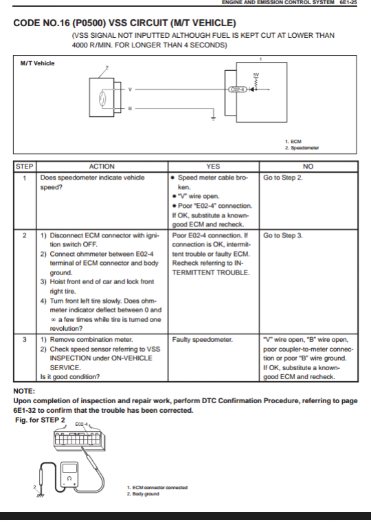

some times Check Engine Light turns on .Scanner told its Speed Sensor Problem.
when I visit Mechanic he said there is no speed sensor in Cultus.
ISSUE has Been Resolved
there is a speed sensor present in Cutus EFi Speedometer .
the duty of this sensor is to send speed of car to Car ECU..
There is a shop in saddar Plaza named "Hafiz Car Meter".
i went there and he checked meter and change faulty sensor with another one.
