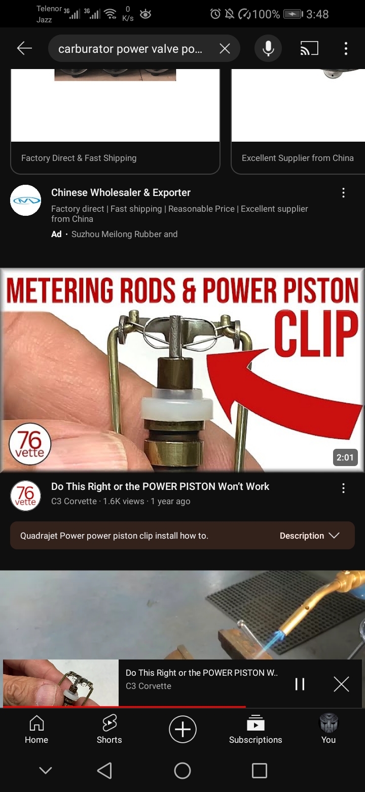

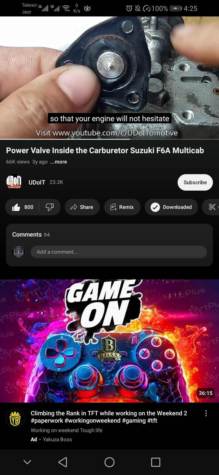

Can you tell which type of power valve mehran use from following pic.
