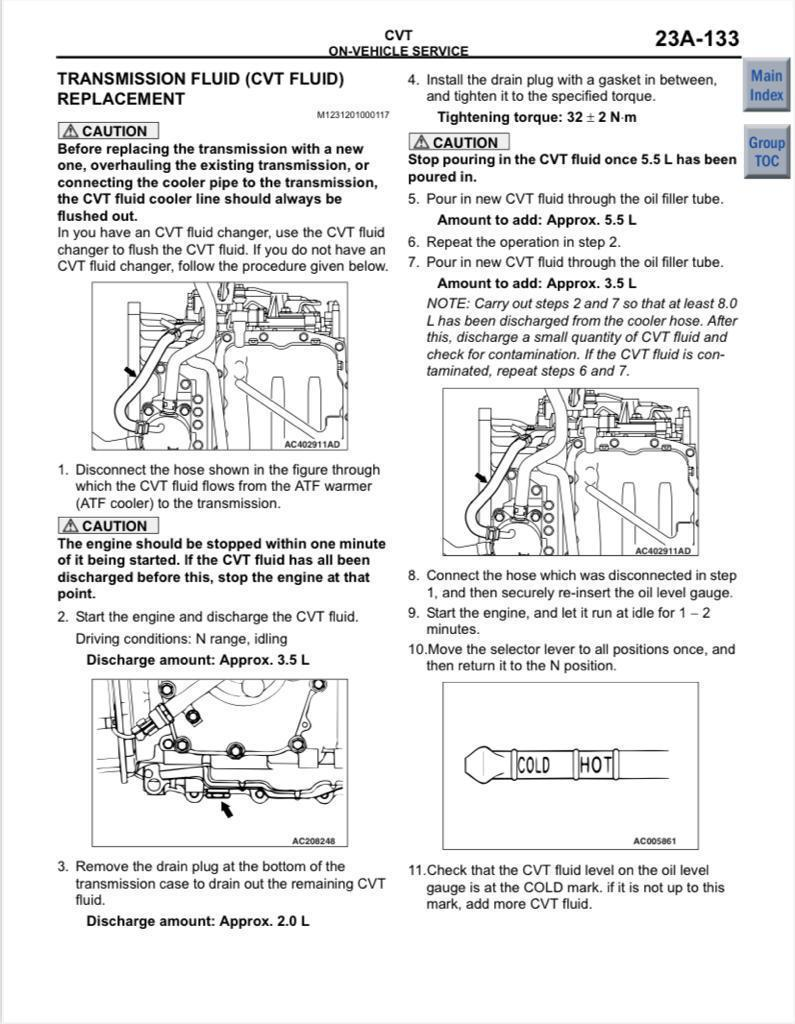

Yeh that's what I said, dnt flush CVT yourself.,
This is just replacement of CVT fluid.
CVT cooler can be flushed as it's a separate part and flushing it doesn't effect the CVT itself.
CVT flush or engine flush means flushing and clearing with high pressure water and than drying with compressed air pressure. That should not be done without proper equipment,
Any ways even dealerships dnt perform CVT flush often , you never know what's gonna be the outcome.
It has no good prognosis, and Should never be done without proper equipment. When ever anyone says that you should flush your CVT, ask them for an after service Warranty.
