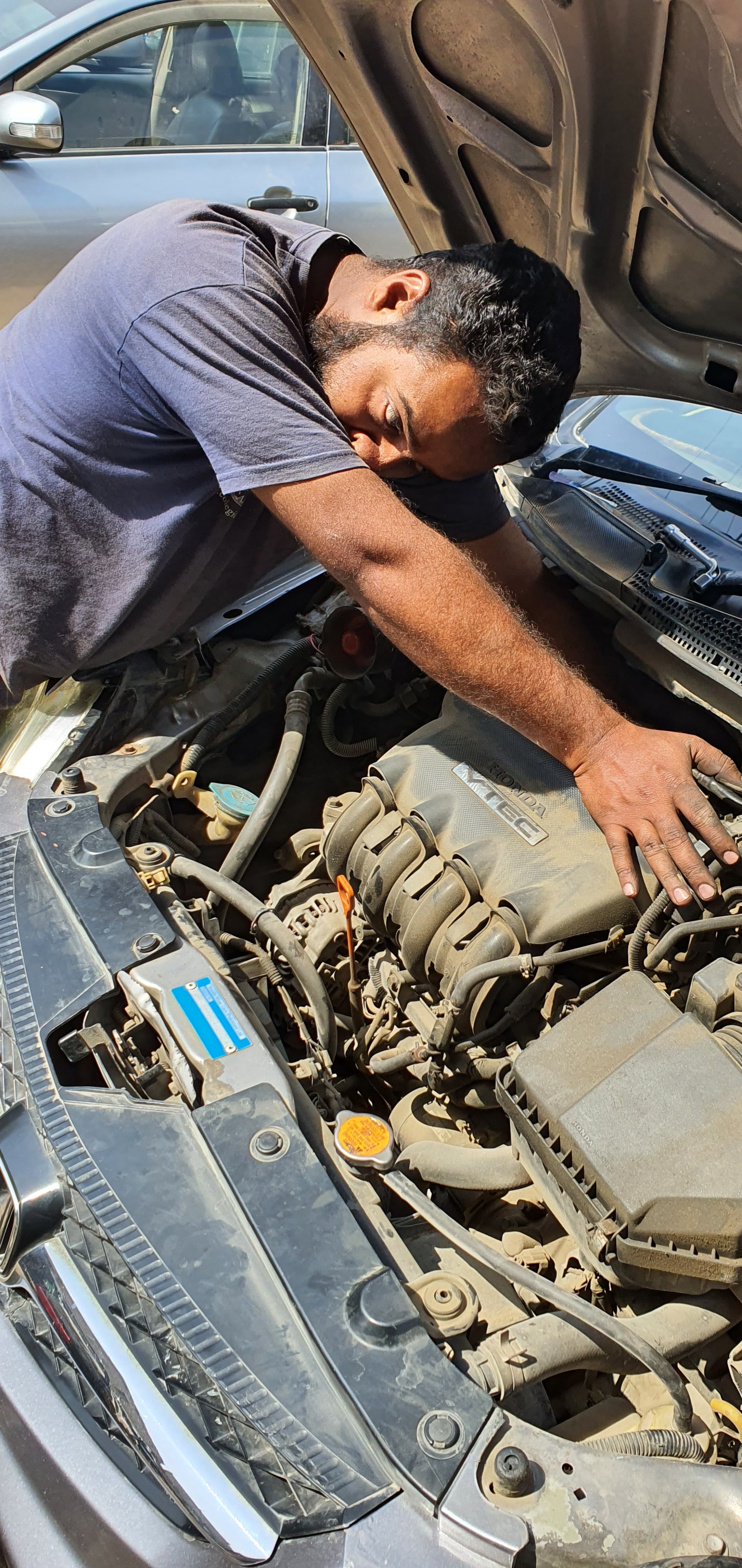

He Drove my car and said the CVT Is fine and its engaging it and not Slipping, if its Slipping then it should Slip on Start , there is Problem with the Engine missing . He told me to go to Mechanic and Resolve the Engine missing issue 1st and Foundation issue Since there was vibration in the car too, Then i called to my Mechanic to check the missing, He checked and said the Coils are having issue.

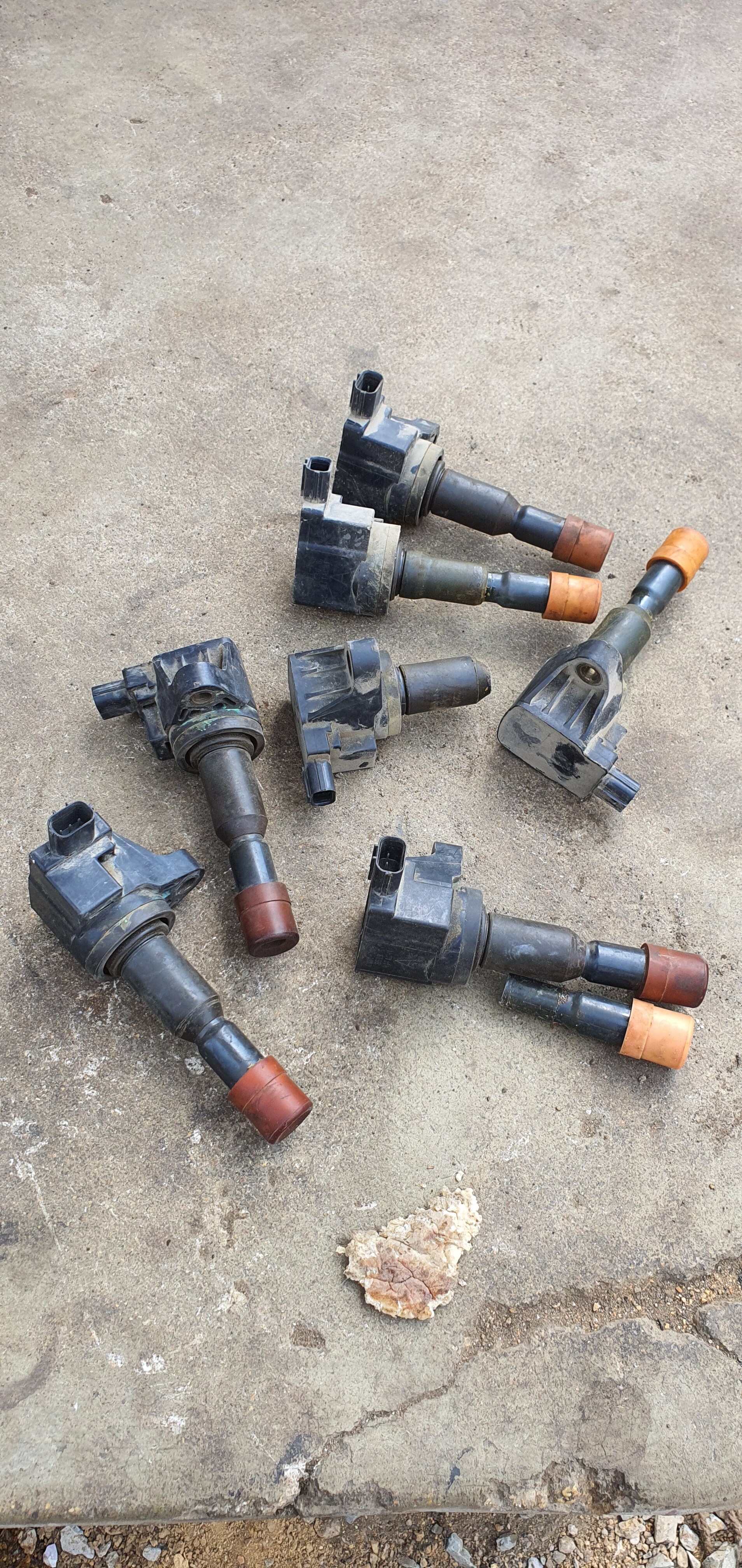

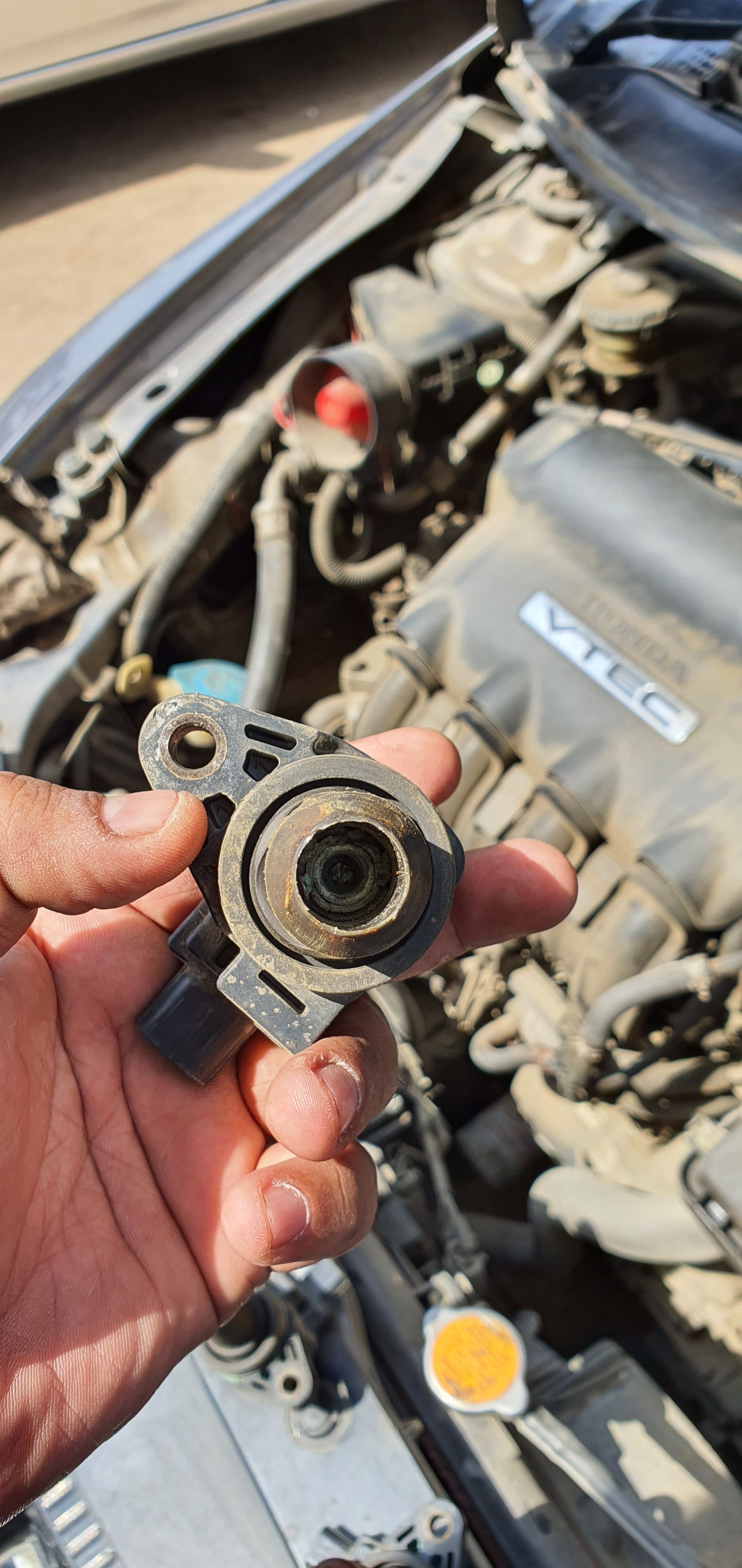

Then after that i went to SHAFIQ MORE Market near Nagan, There is Auto work Shop Danish Autos, he have all Tramissions Engine and parts of this car. He chcked the missing and asked his guy to resolve it, They Checked the Coils one by one and out 4 COils 3 are Dead and SHAAT as per them.
So they Change the Coils put the new CITY Coils in it by granding some points of fitting and issue was Resolve. it was the COILS that Blast Last night on High RPMS or were already on last stage.
