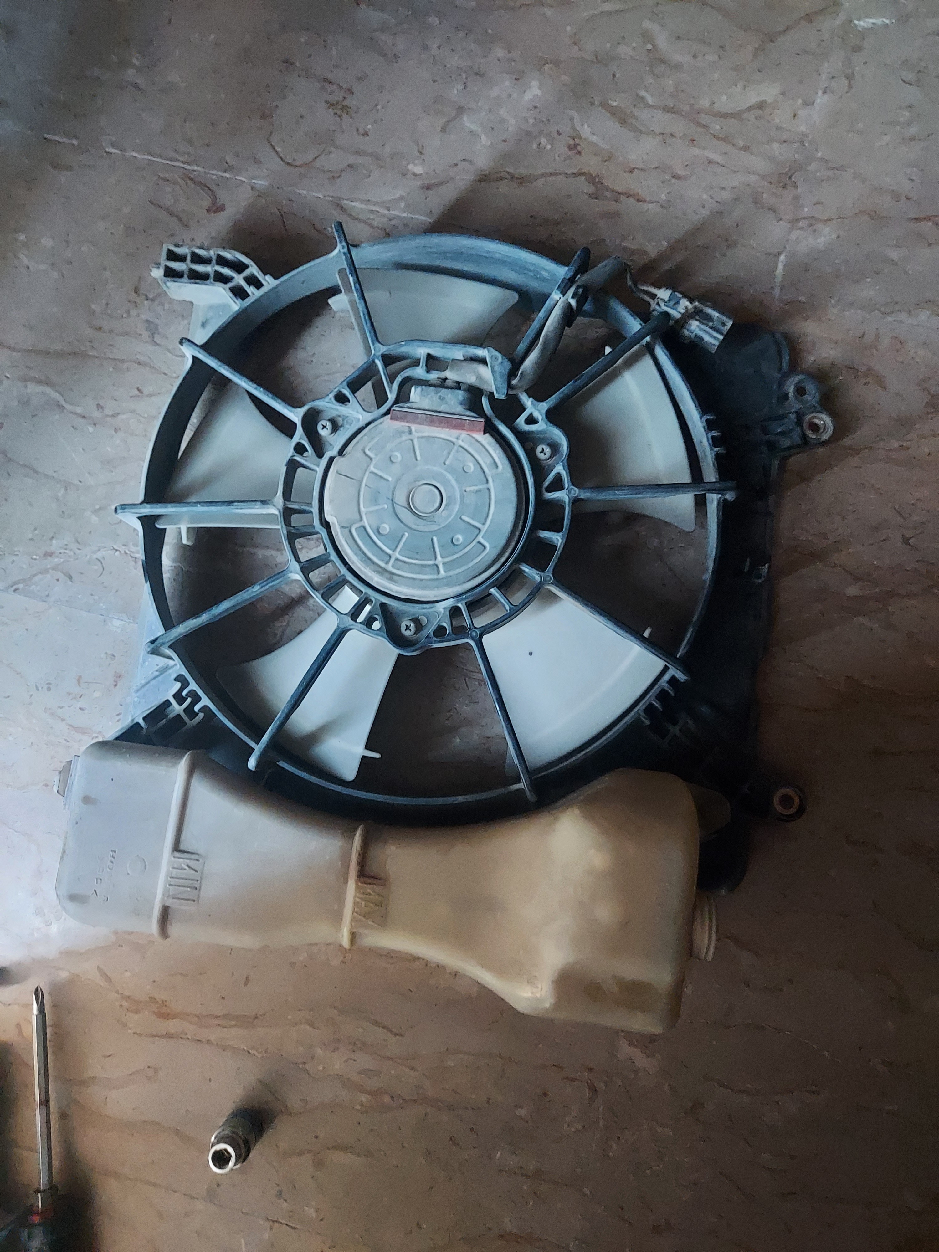

Project

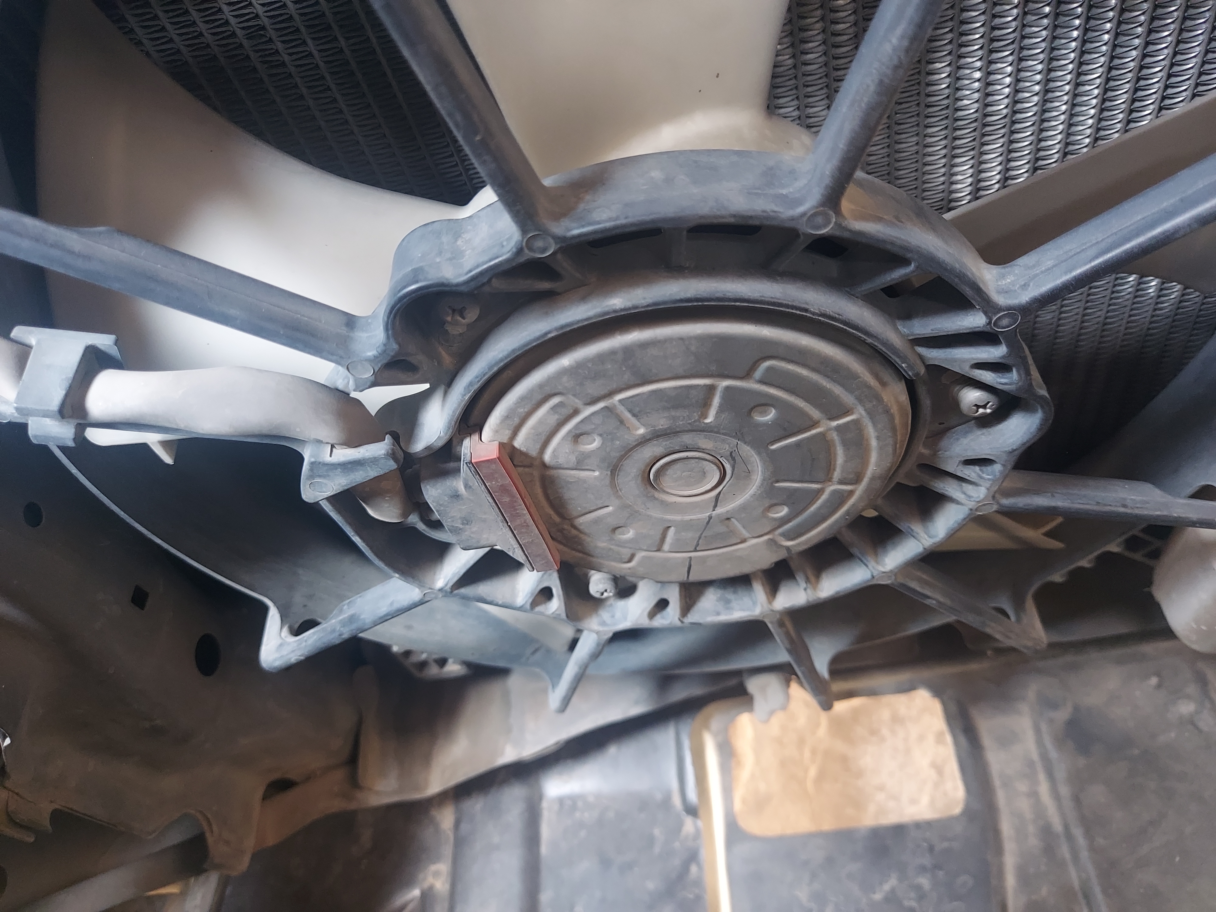

I disconnected the battery terminals,Coolant expansion bottle cap,Radiator fan wire and a small braket of wires on the shroud.
There are 2 10mm bolts holding the shroud to the radiators.Just below the upper radiator core support.
Unscrew those and pull the shroud up to remove it from the brackets in the bottom.
and than slide it infront of the other fan and pull it out of the engine bay.

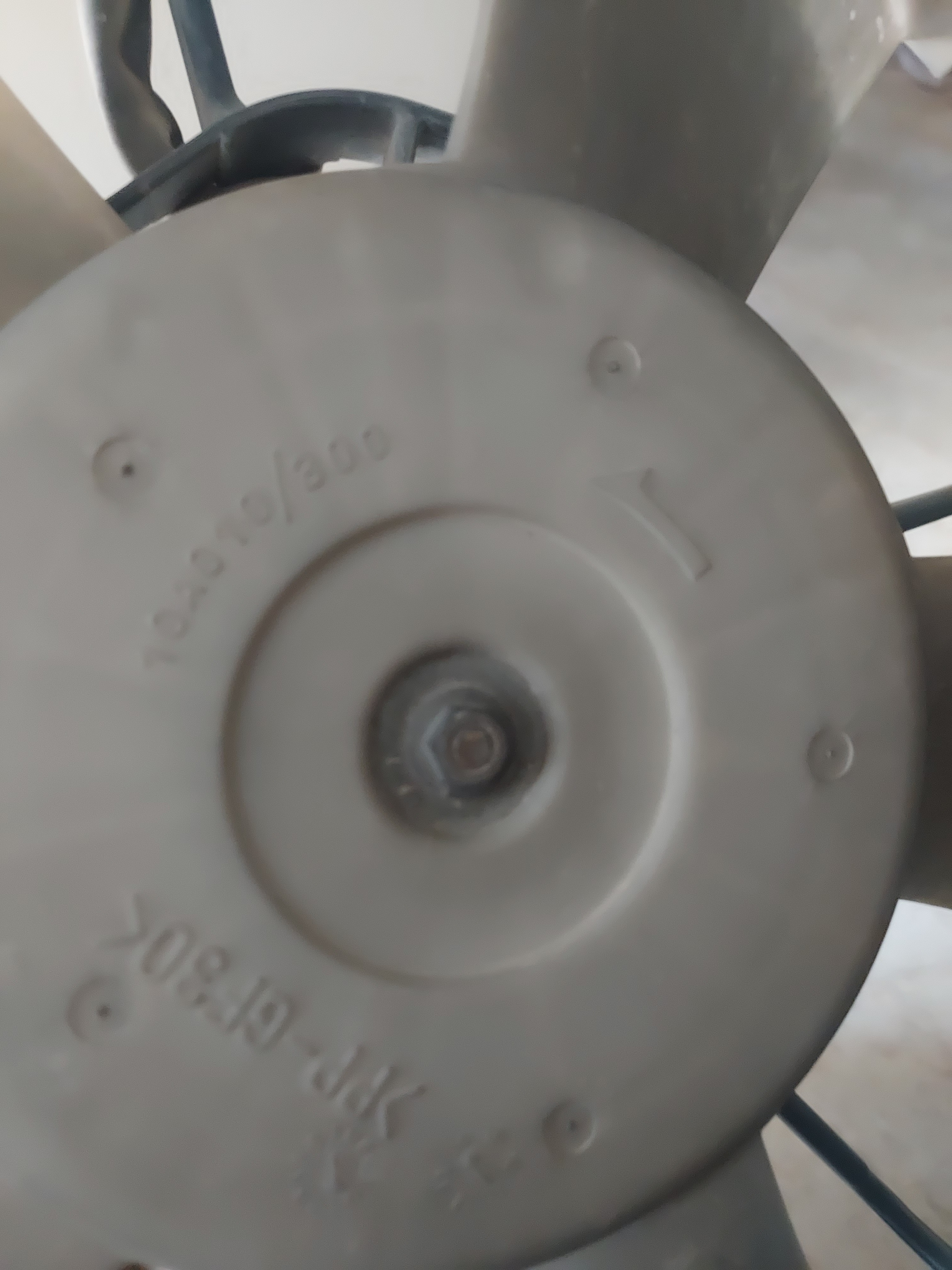

I removed the fan from the motor by unscrewing the 8mm bolt.Removed the motor from the shroud by unscrewing the Philips head screws.cleaned the shroud with degreaser.
i assembled the whole fan and shroud again.
fixed it back in the engine bay in reverse.
checked the fan
it Worked
Pics attached in second post
Edit : Dont forget to use thread lock.Its easily available from Pakwheels or daraz stores.
