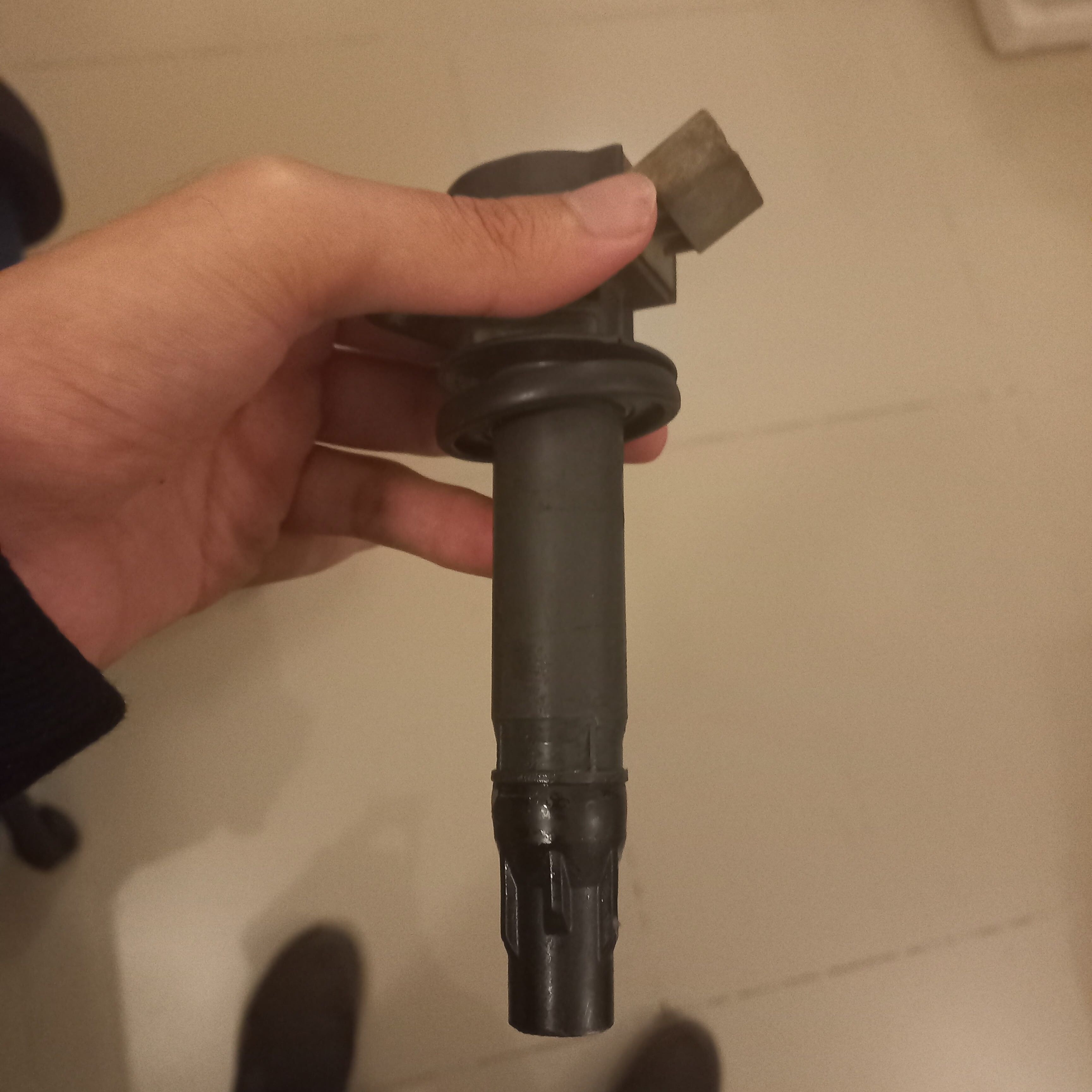

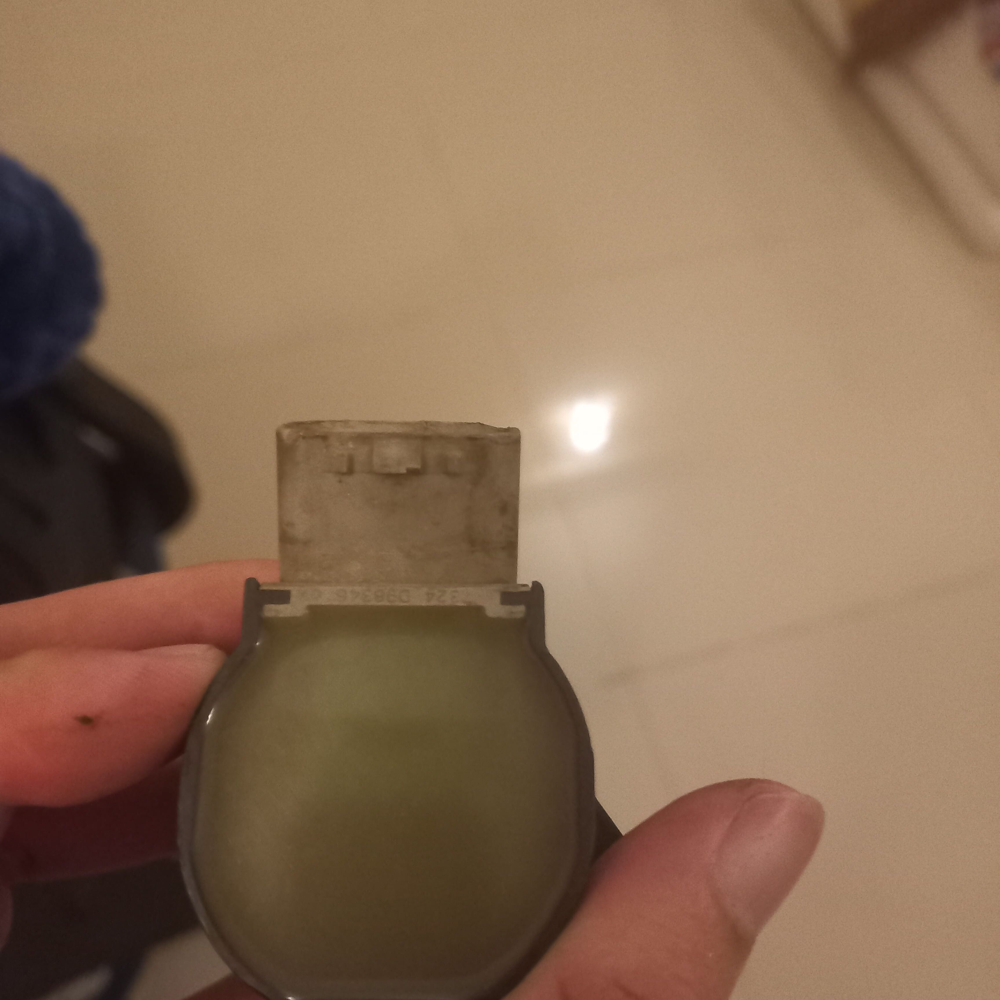

KF-VE and KF-DET (2006- MAY 2010)
Both turbo and non-turbo variants used the first variation of the ignition coil with a clear top that showed the circuitry and are circular in shape which I refer to as the green top coils. DE DIAMOND or Diamond Electrical manufacture these coils in Japan with the part number 19500-B2040.

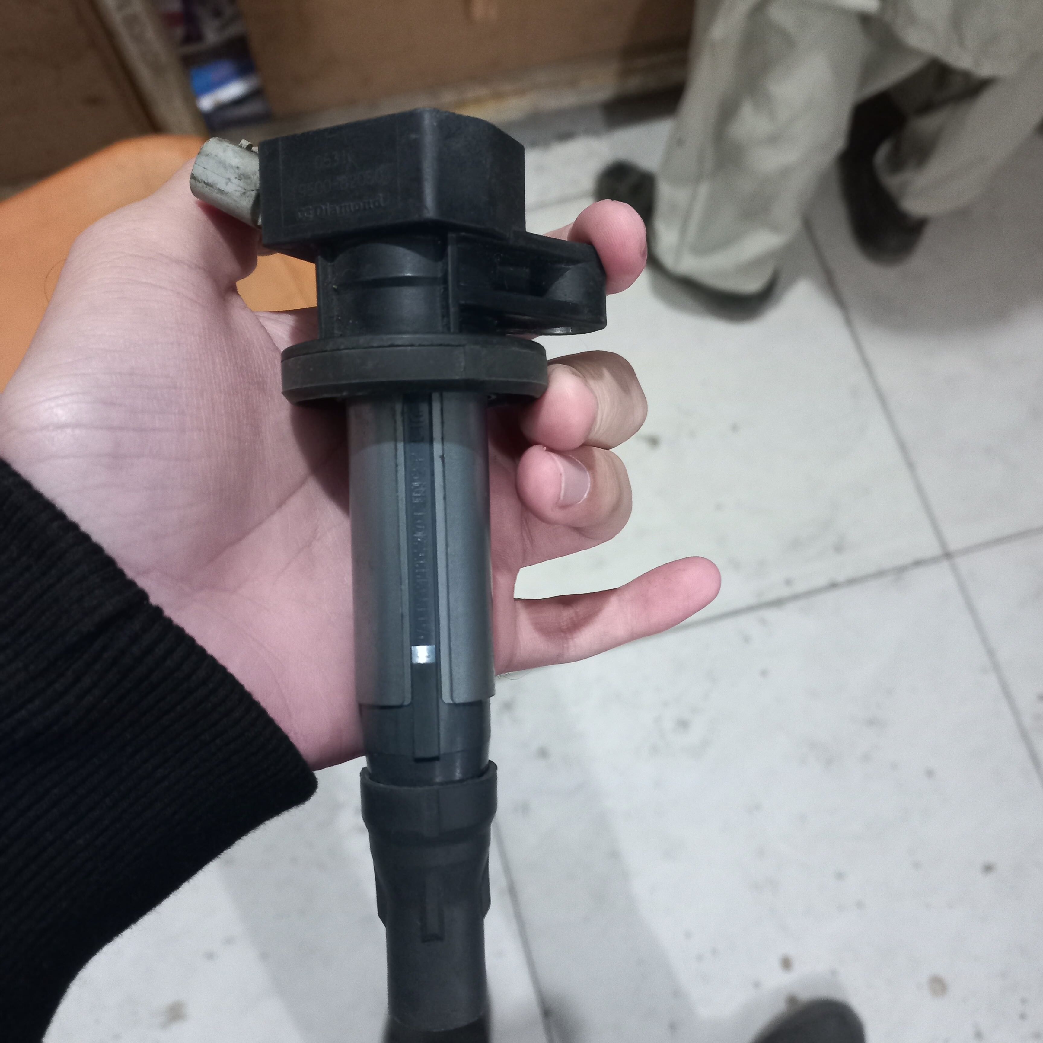

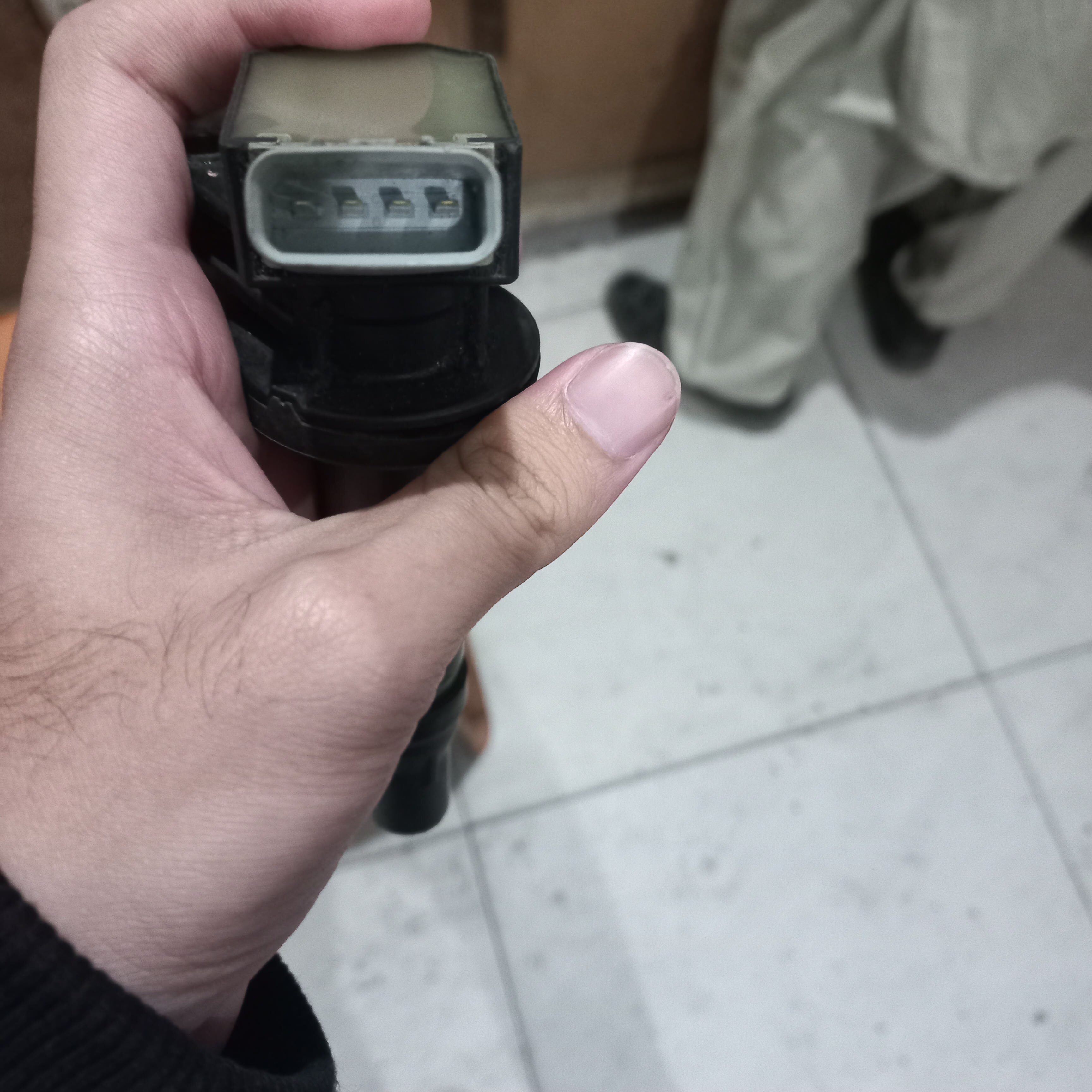

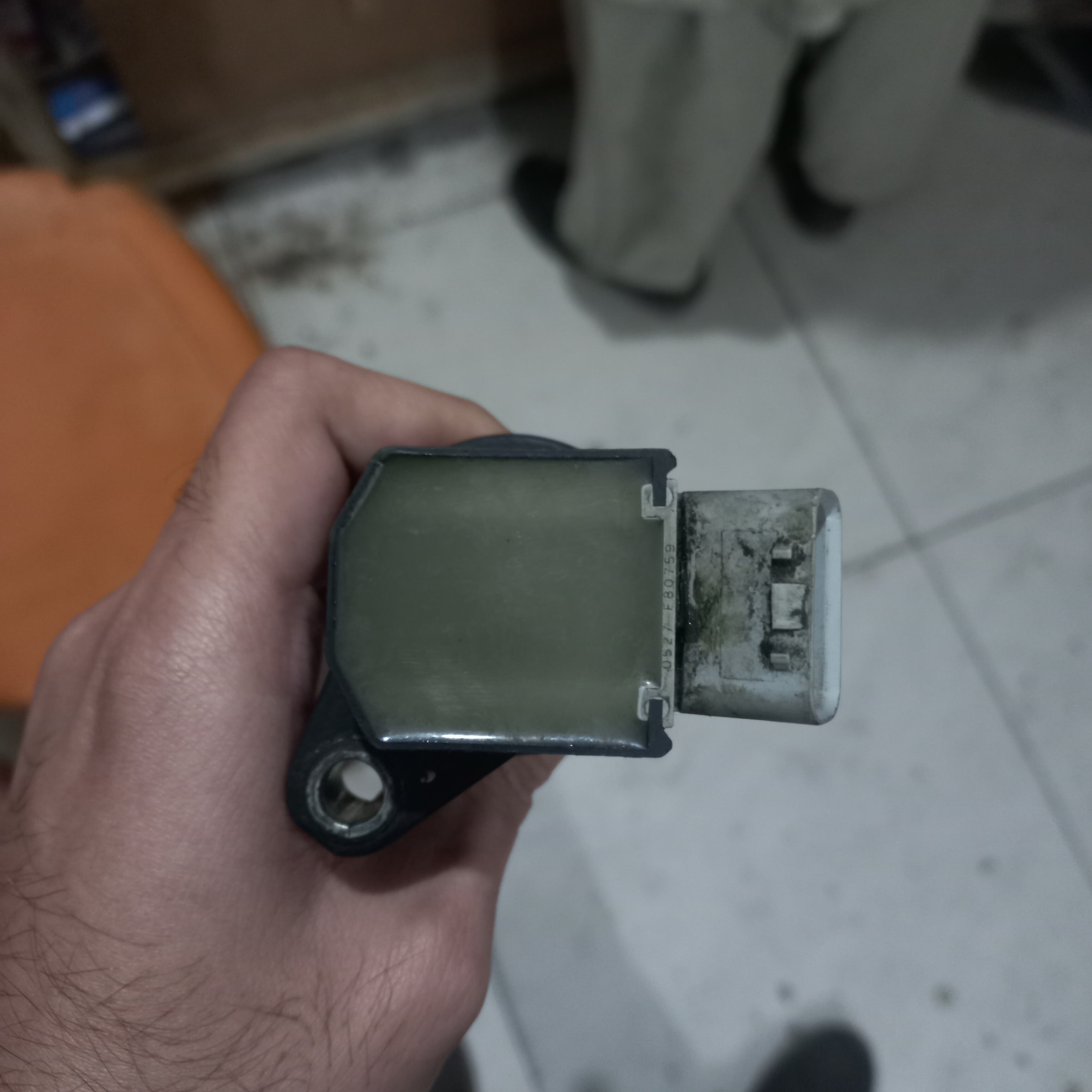

KF-VE and KF-DET (MAY 2010-2011)
Now these ignition coils lasted for a small amount of time and have differences to the earlier ones. They are more angular in shape and have a clear top that shows the circuitry. From the side you can see there is a rib going down to the bottom of the coil and the base is thicker. I presume this was done to combat spark leakage which the earlier coils were more susceptible too and often had to wrapped in electrical tape as a temporary Jugaar. I refer to these coils as the grey top coils. They have the part number 19500-B2050.

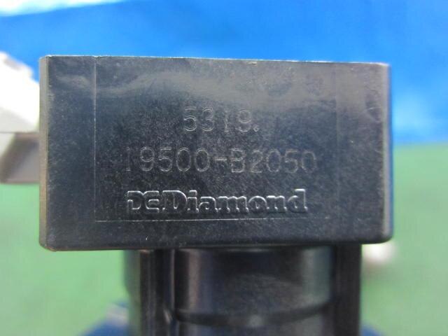

KF-VE and KF-DET (2012-present)
The latest coil as of date. It has no differences other than the blackening of the top. Although info is limited on their internal changes if they have any. It shares the same part number 19500-B2050 as the silver top coils. I named these coils the black top coils.
