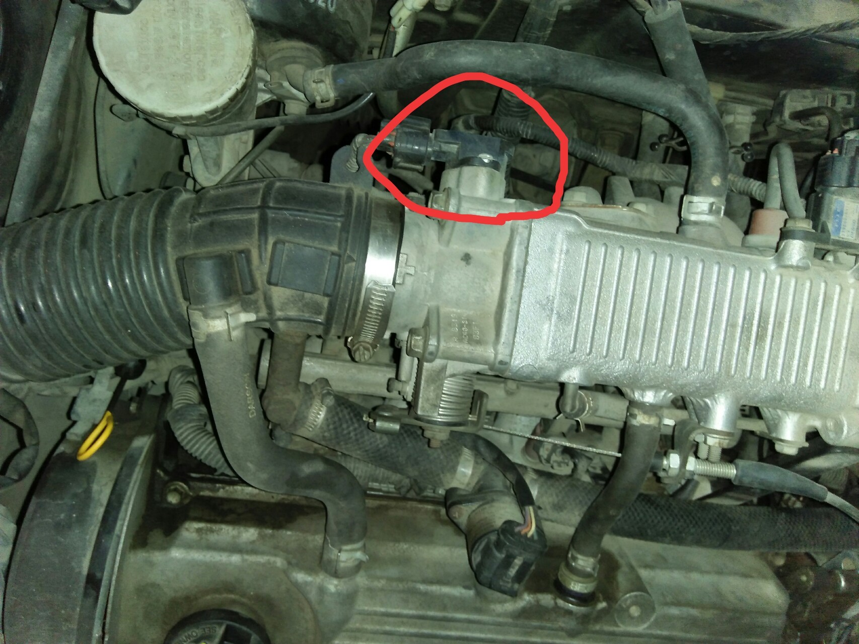

can u pls post the pics of the sensor
can u post the pic of iac valve
Here is the sensor

thats not IAC - its the Throttle Position sensor (as far as i can see from the pic). IAC is also attached to the throttle body and is actually a rotating valve.

Yeah this can be used but my man issue was IAC valve it was not rotating freely so i cleaned it myself with carb spray and now happy to drive
