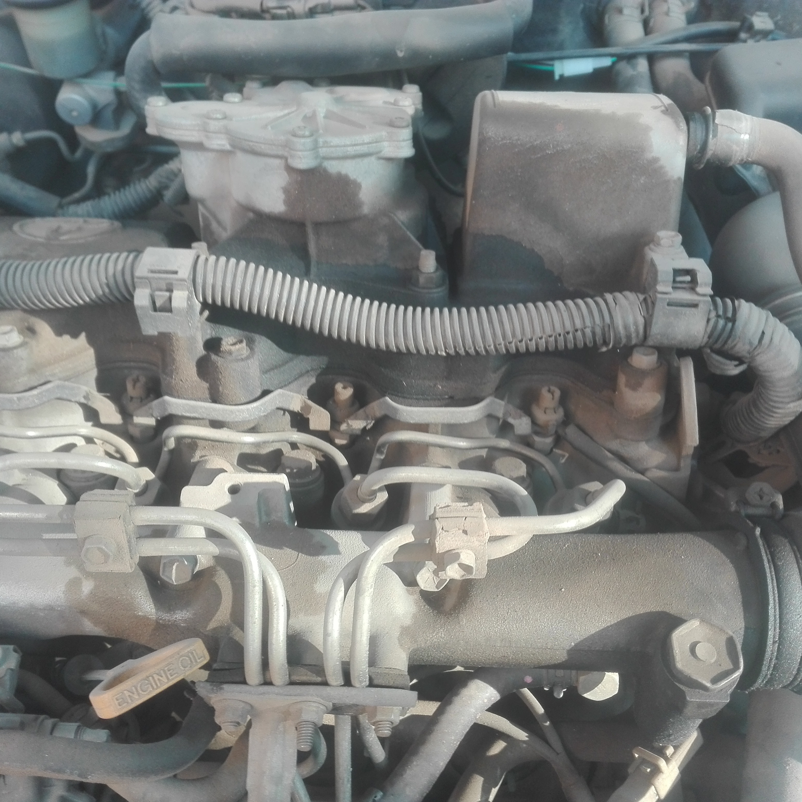

Uploading... Please.guide.me.What.is.this.black.thing
Uploading...
please help
To know the leak first clean it with some degreaser or kerosene oil then check from where its leaking
:faceplam:
So what
Thanks.Please.recommend someone in lhe.who.check.leakage Degreaser wd40 is.fine.for cleaning
Thats fine but find something cheaper like the one i told you and about the guy i have no idea because am not from lahore
