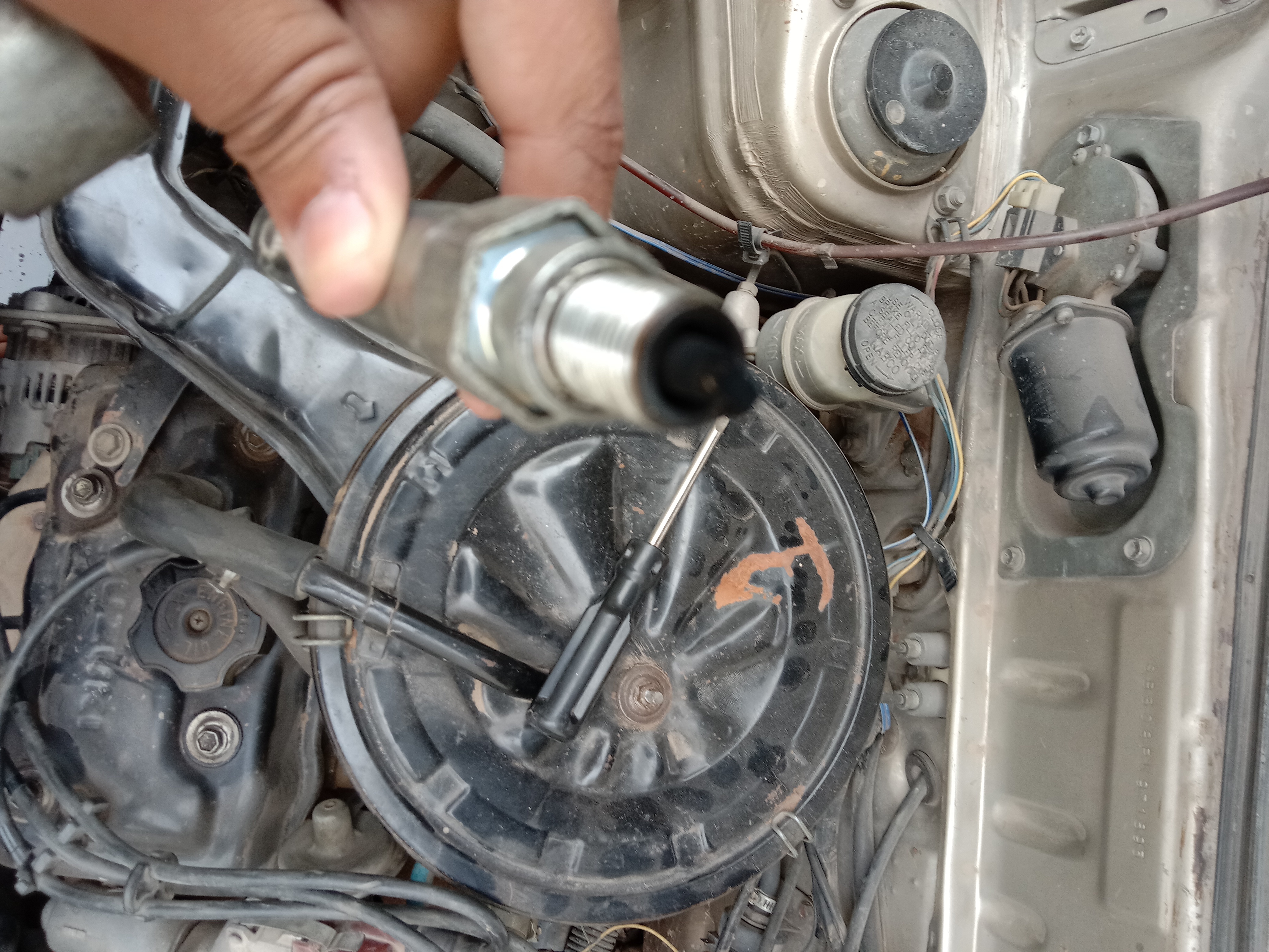

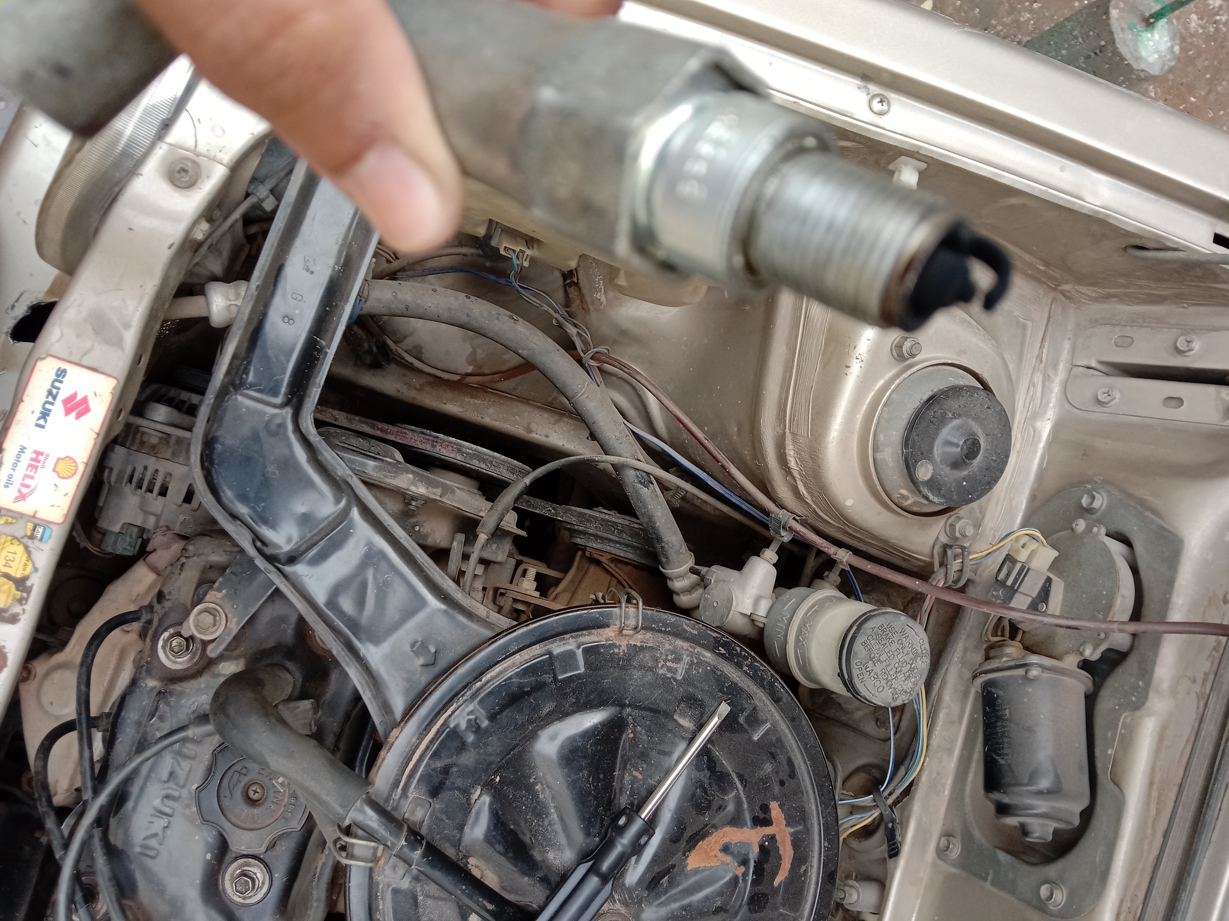

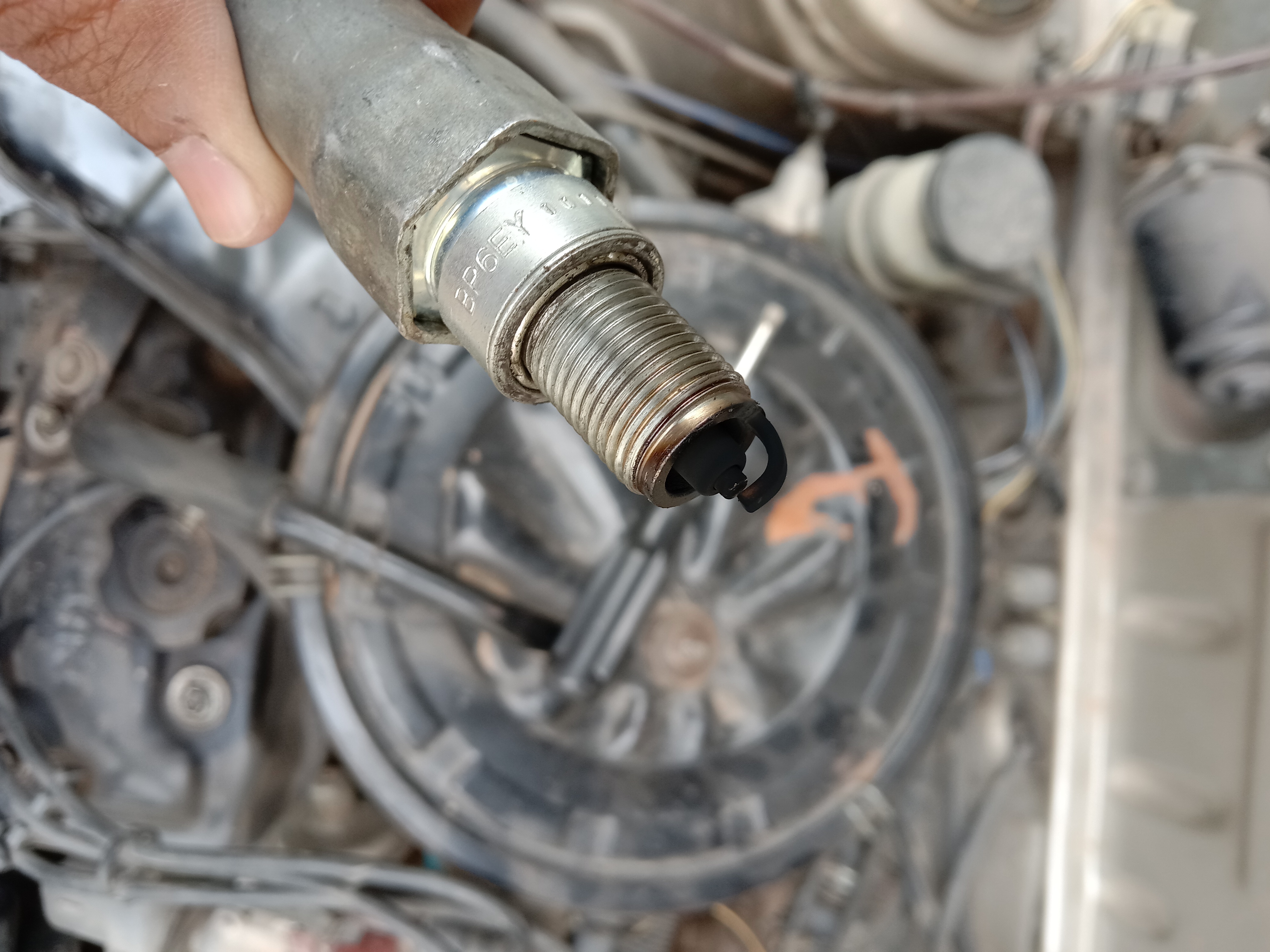

Your compression is on low side.
Set the plug gaps according to manual and use oem plugs. Different heat range plug can cause this.
Also do check the distributor.
That's dry carbon. A sign of rich mixture.
Carburetor should cause all of them to go rich.
