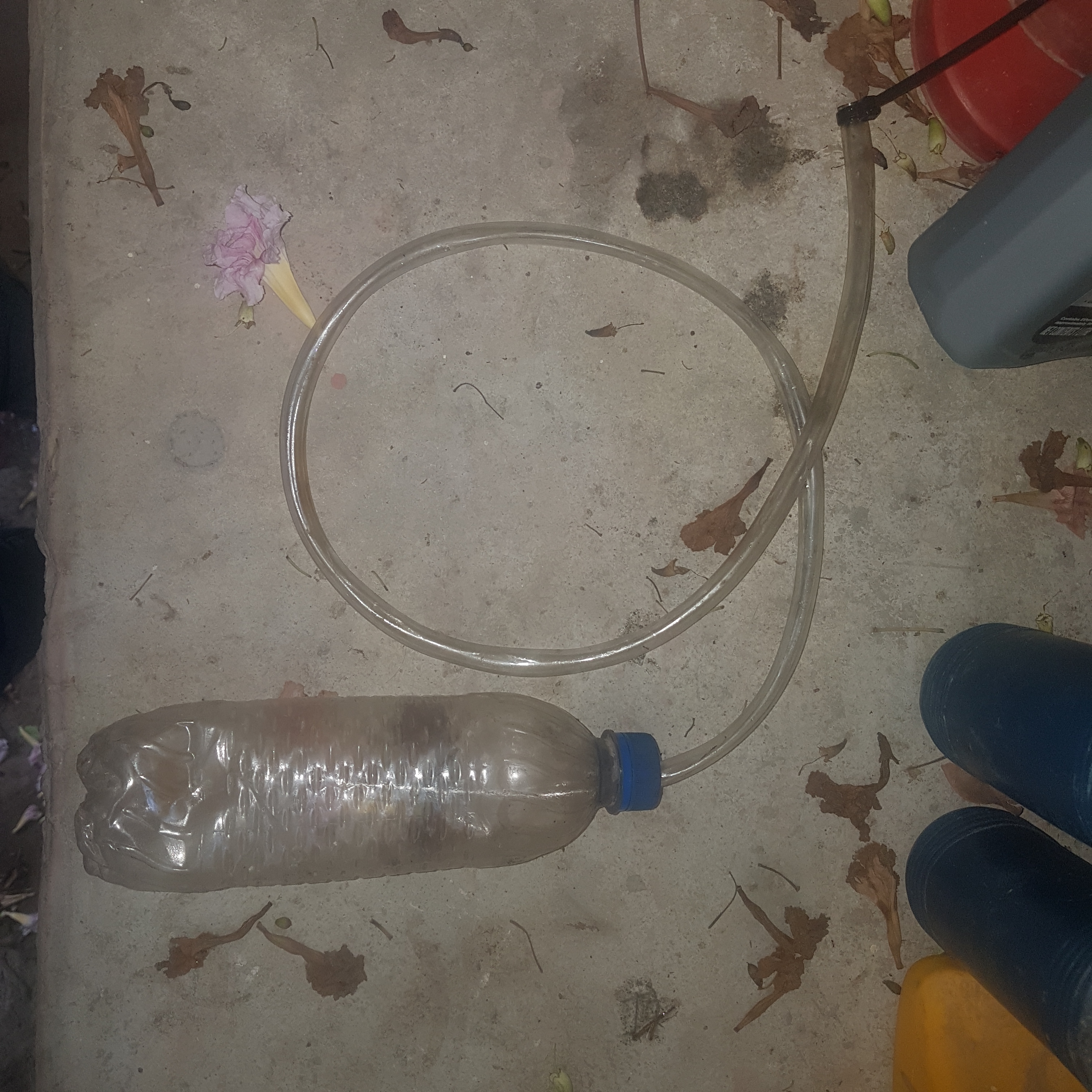

To get started you would need to make your own bleeding kit which can easily be done with 3 foot long aquarium pipe and a 500ml plastic bottle as shown:
You will have to:
Cut a small hole in the cap for the pipe and another small hole next to it for air to pass through. I did this using a knife that was well heated (Be Cautious when using a hot knife as you can burn yourself). Make sure the pipe is till the base of the bottle and pour a little brake fluid from a sealed container till the bottom of the pipe is submerged. This prevents air from being sucked back in and instead brake fluid is sucked. At the other end of the pipe place a Zip tie that tightens the end which will go on the bleeder nipple.

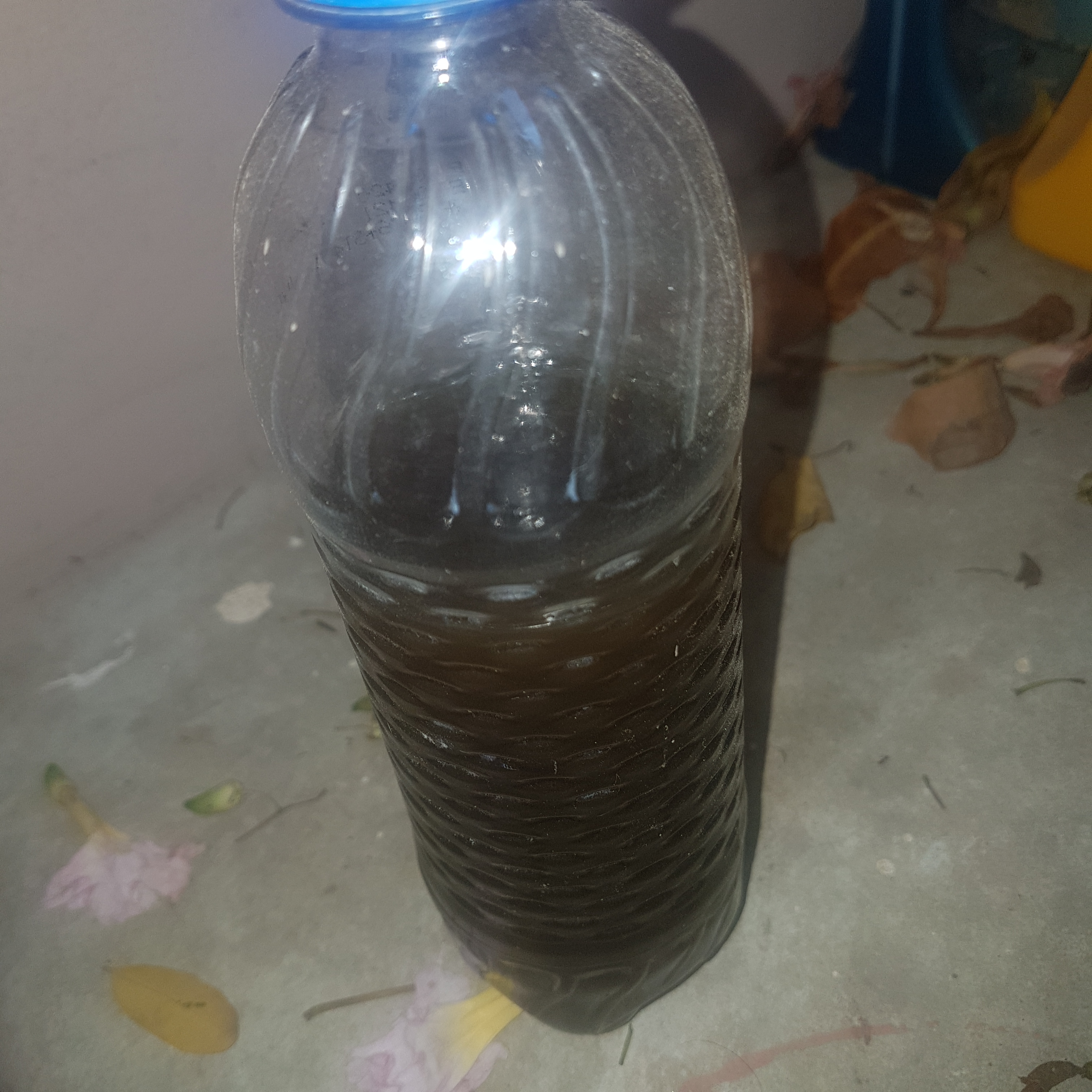

In doing so the braking of my vehicle improved and this was the dirty brake fluid that will come out if it is not changed:
