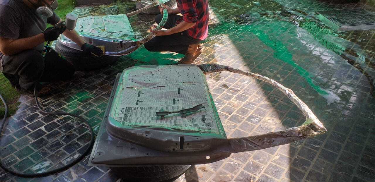

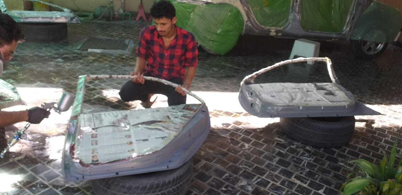

last job ,,,, for tomorrow ,,,,,,,,,

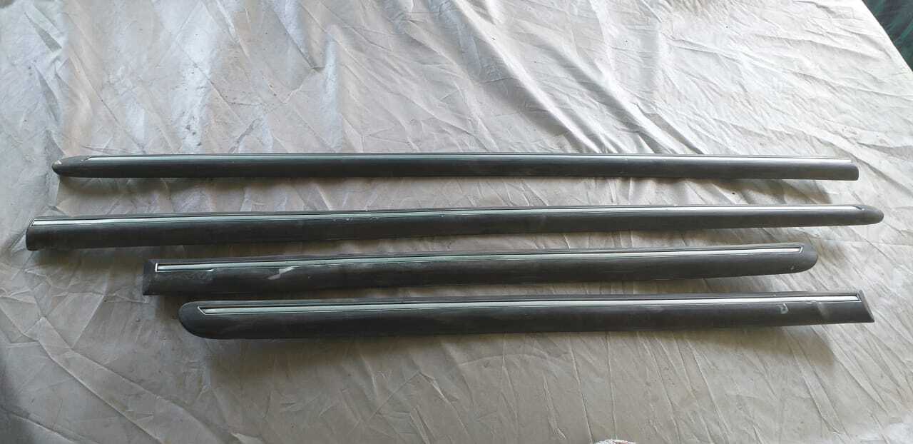

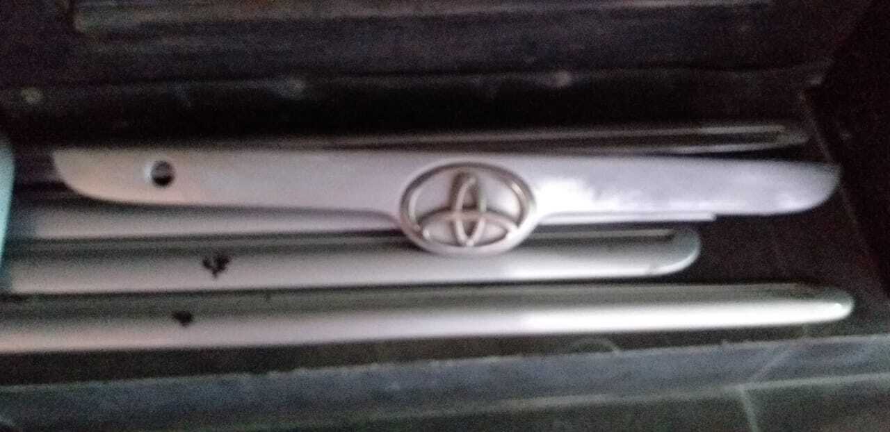

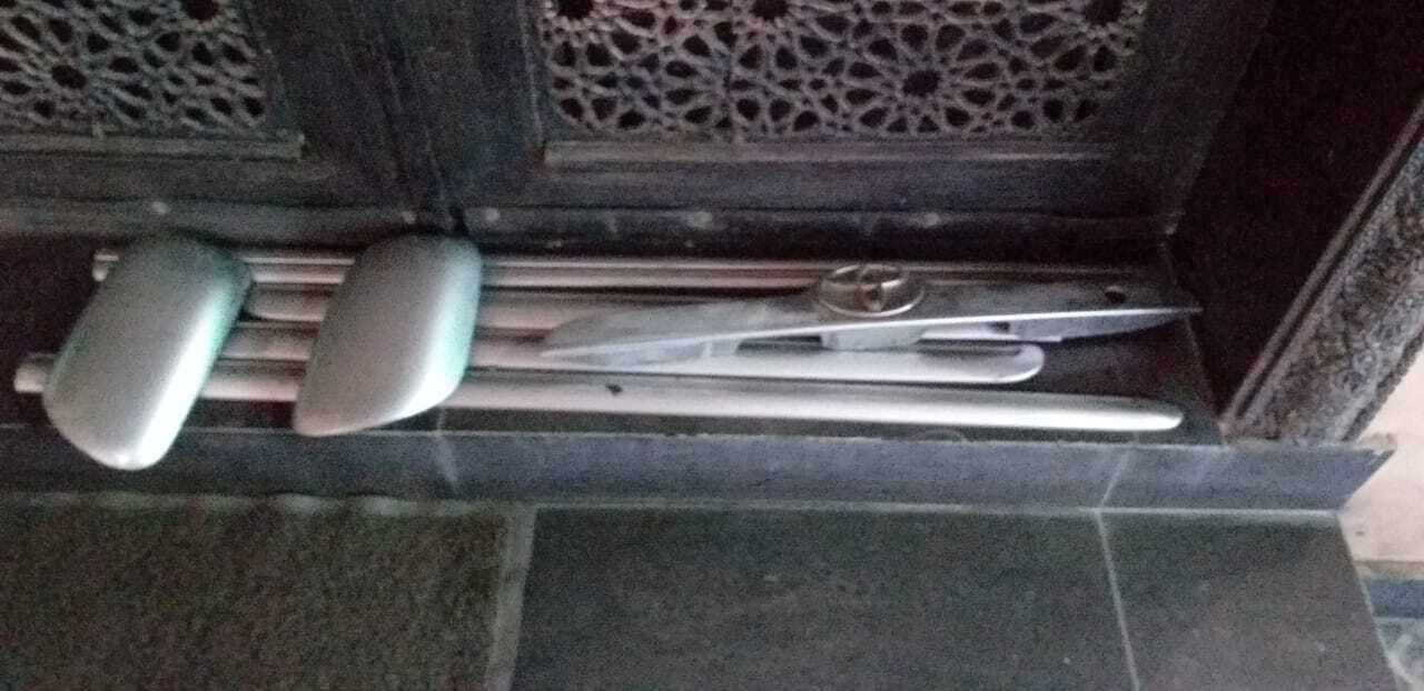

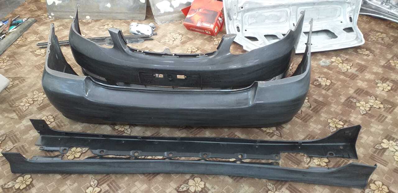

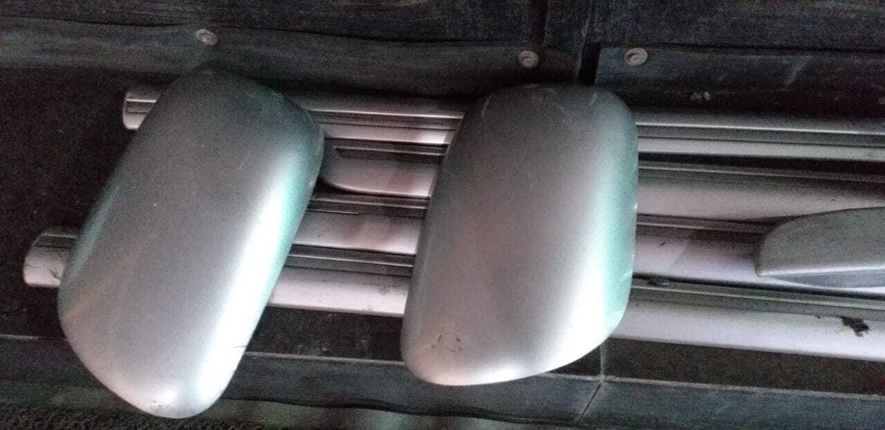

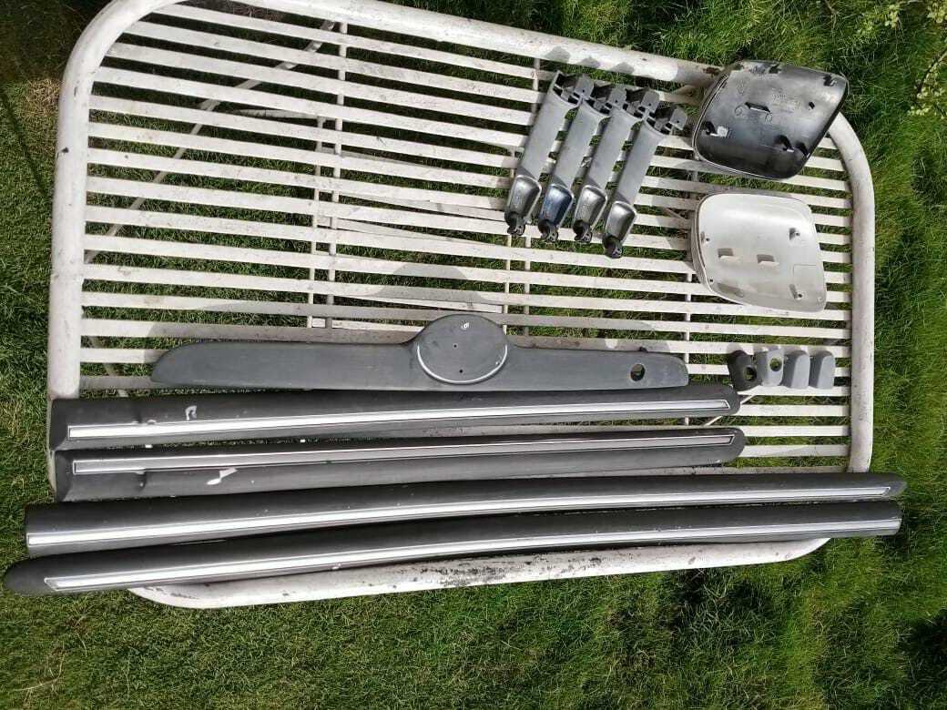

some last parts been scuffed ,,,,,,,,

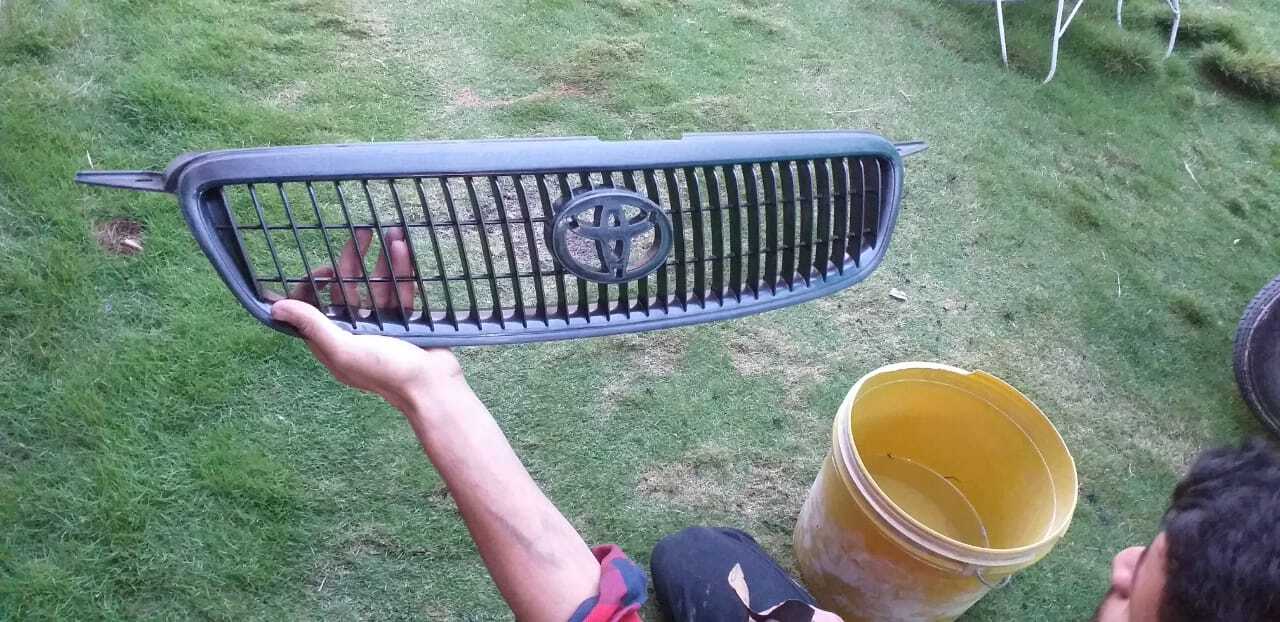

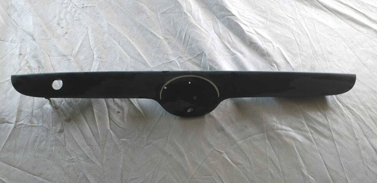

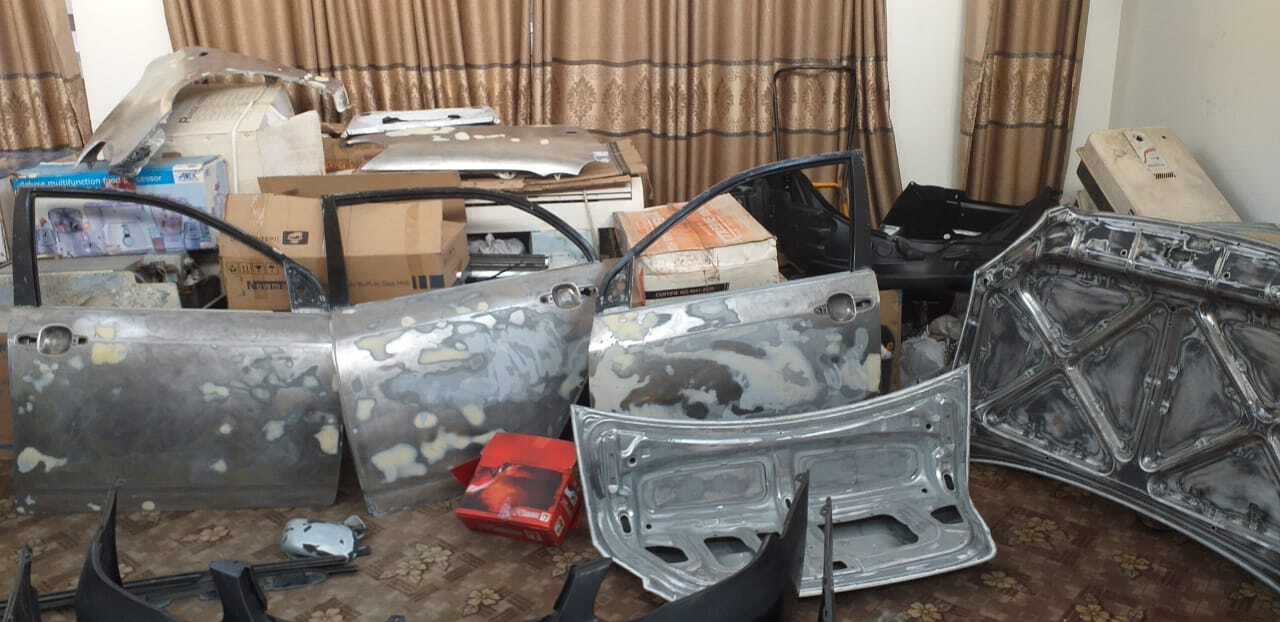

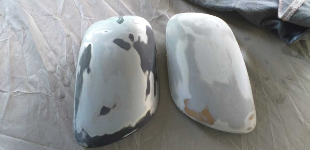

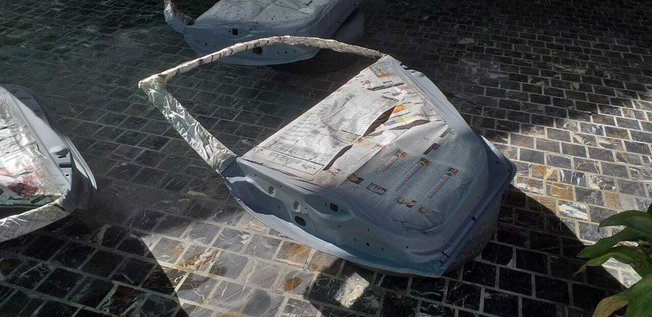

aranged all parts till they are ready for the primer ,,,,,,,,

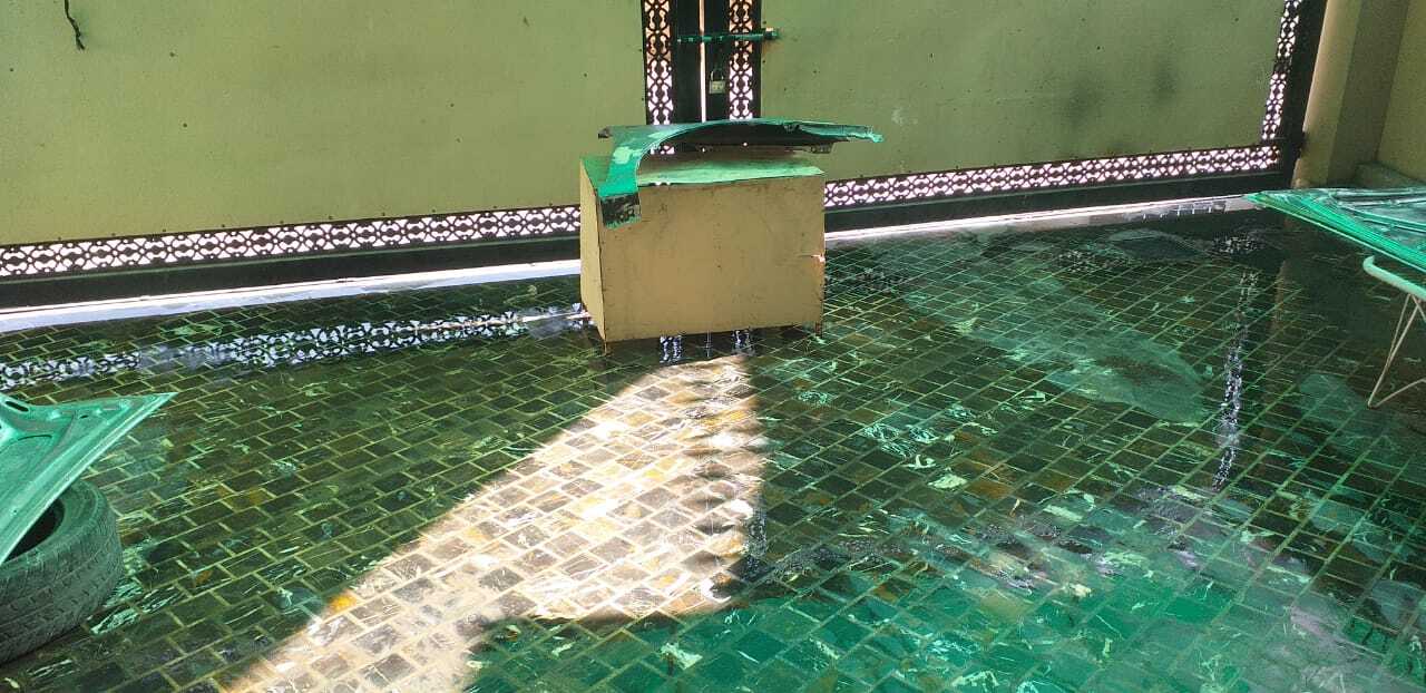

This is how we perfectly use a room....
And forced to sleep inside the car

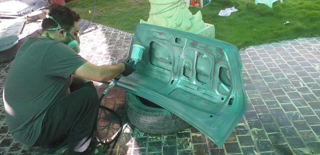

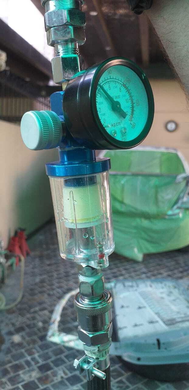

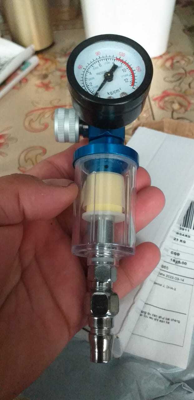

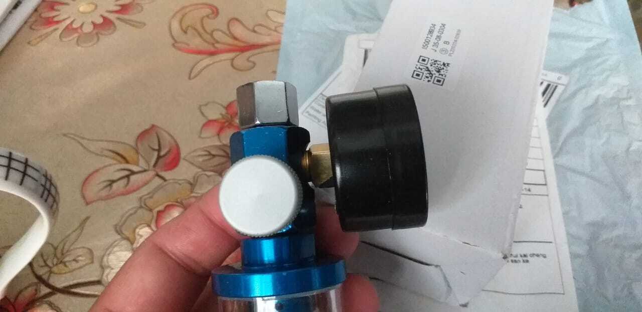

paint gun regulator and filter / water separator..........
Which primer you are going to use as a base?
nexa 2k primer ,,,,,,,,, Alps paint ,,,,, and sikken clear coat ,,,,,,,

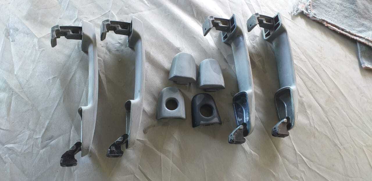

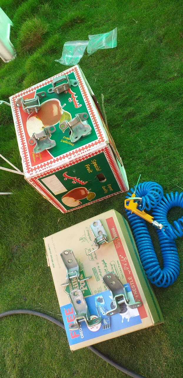

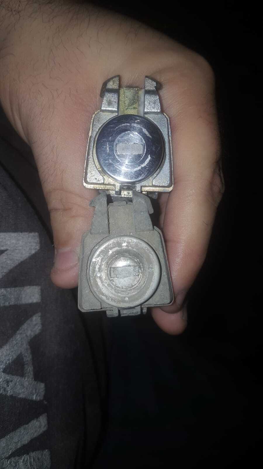

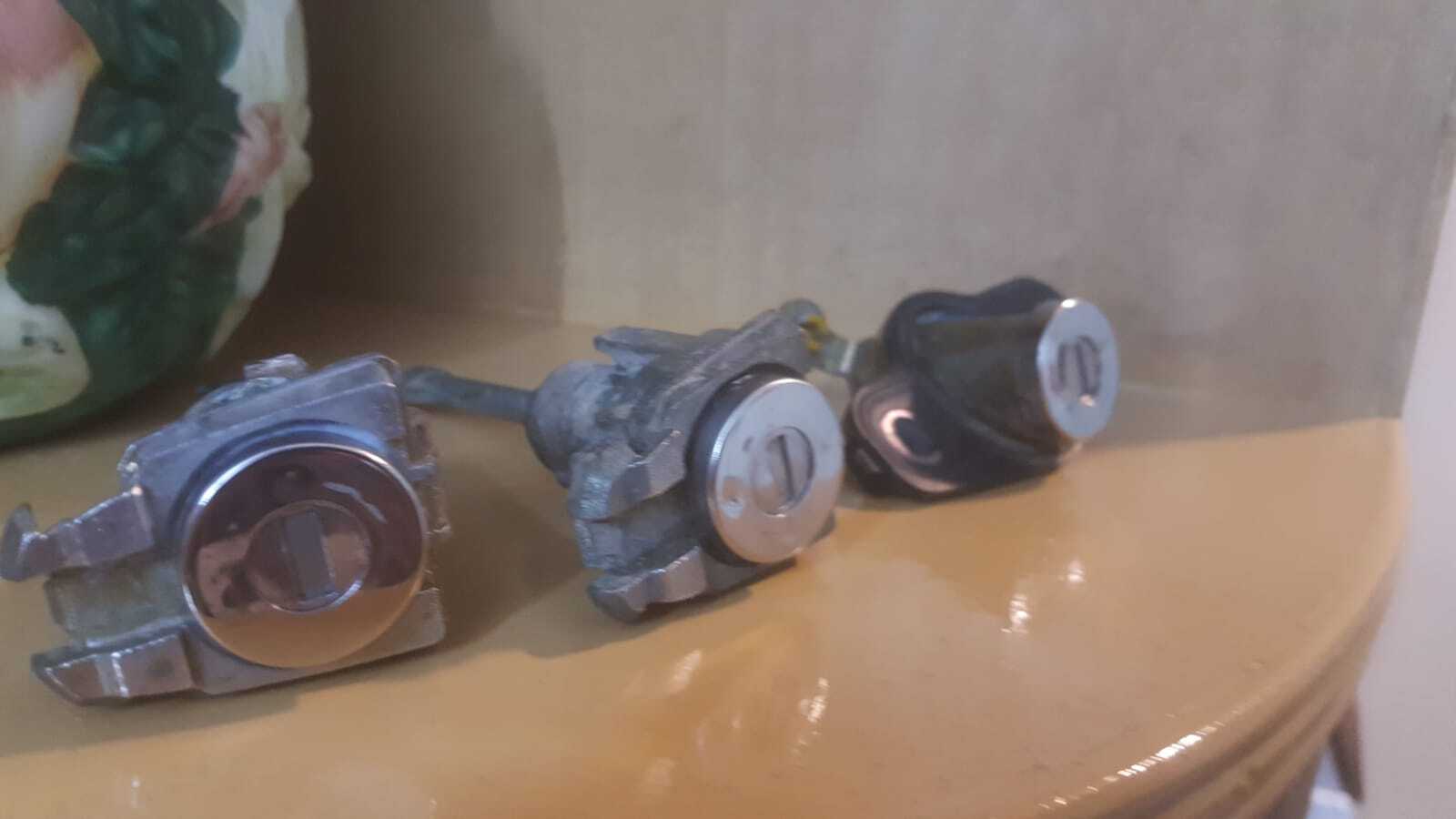

keylocks polished,,,,,,,,,

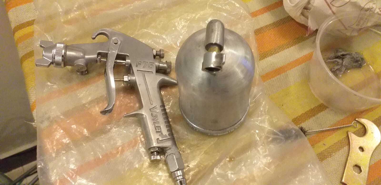

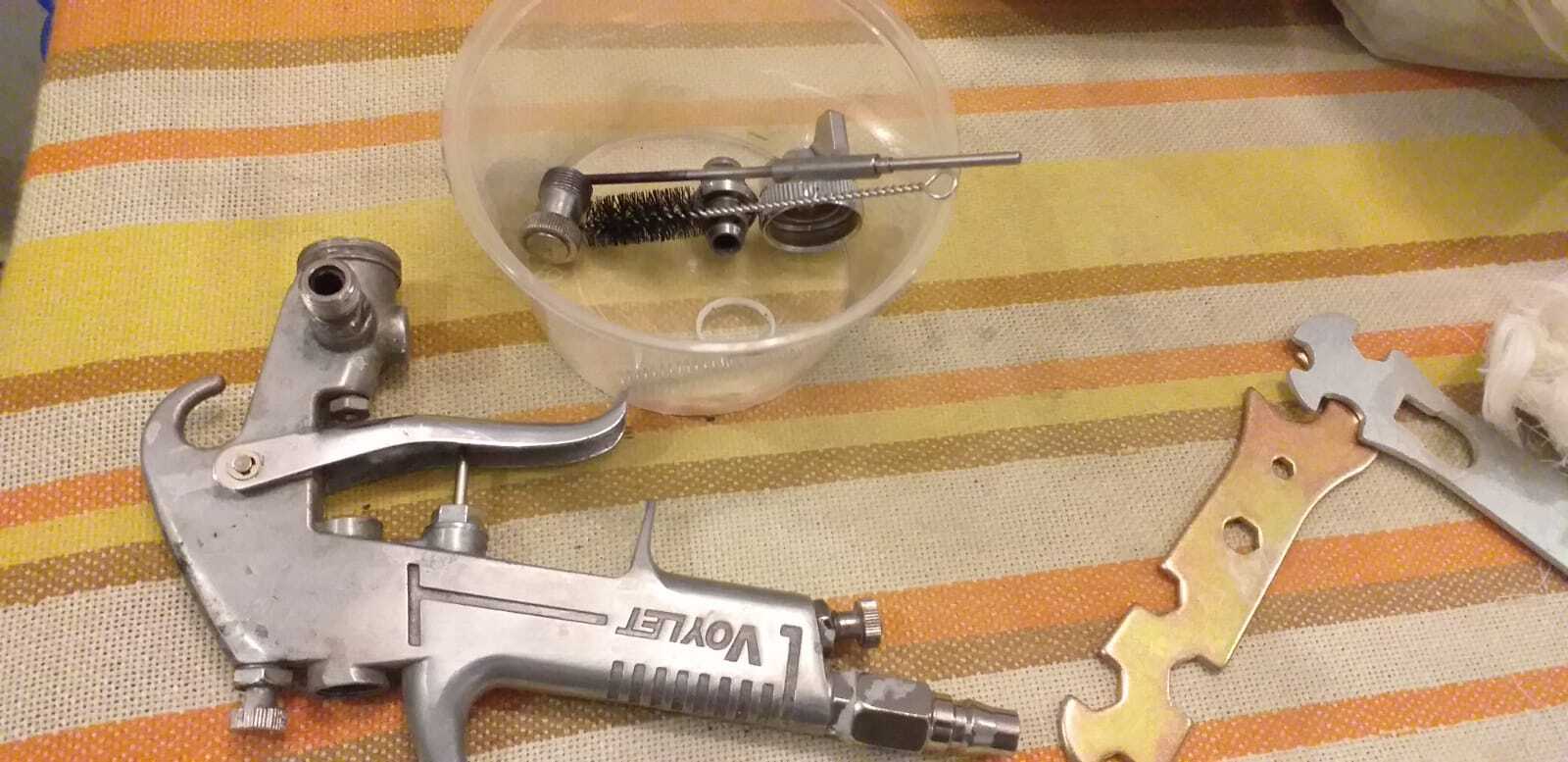

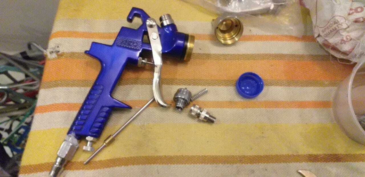

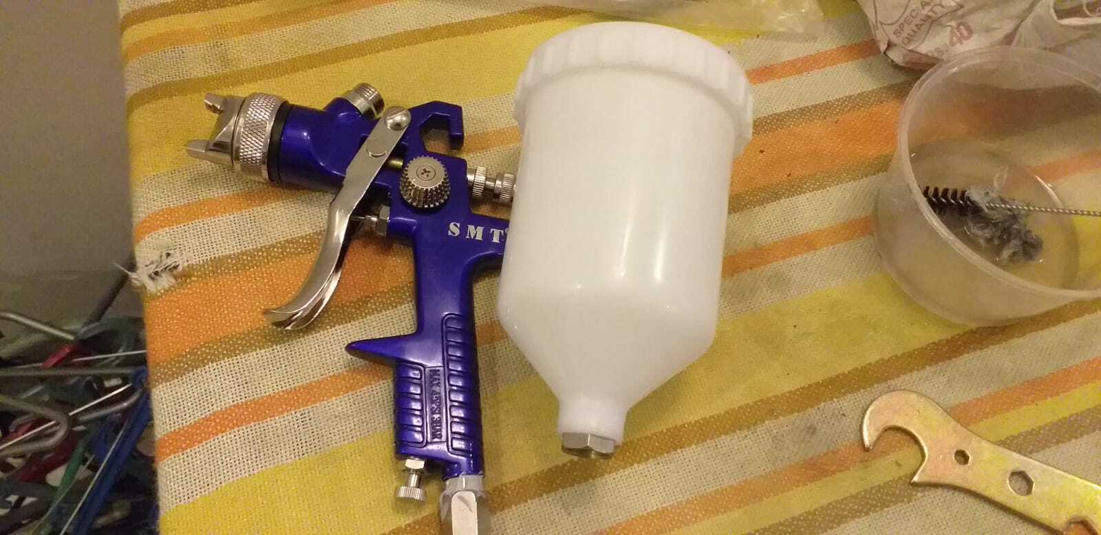

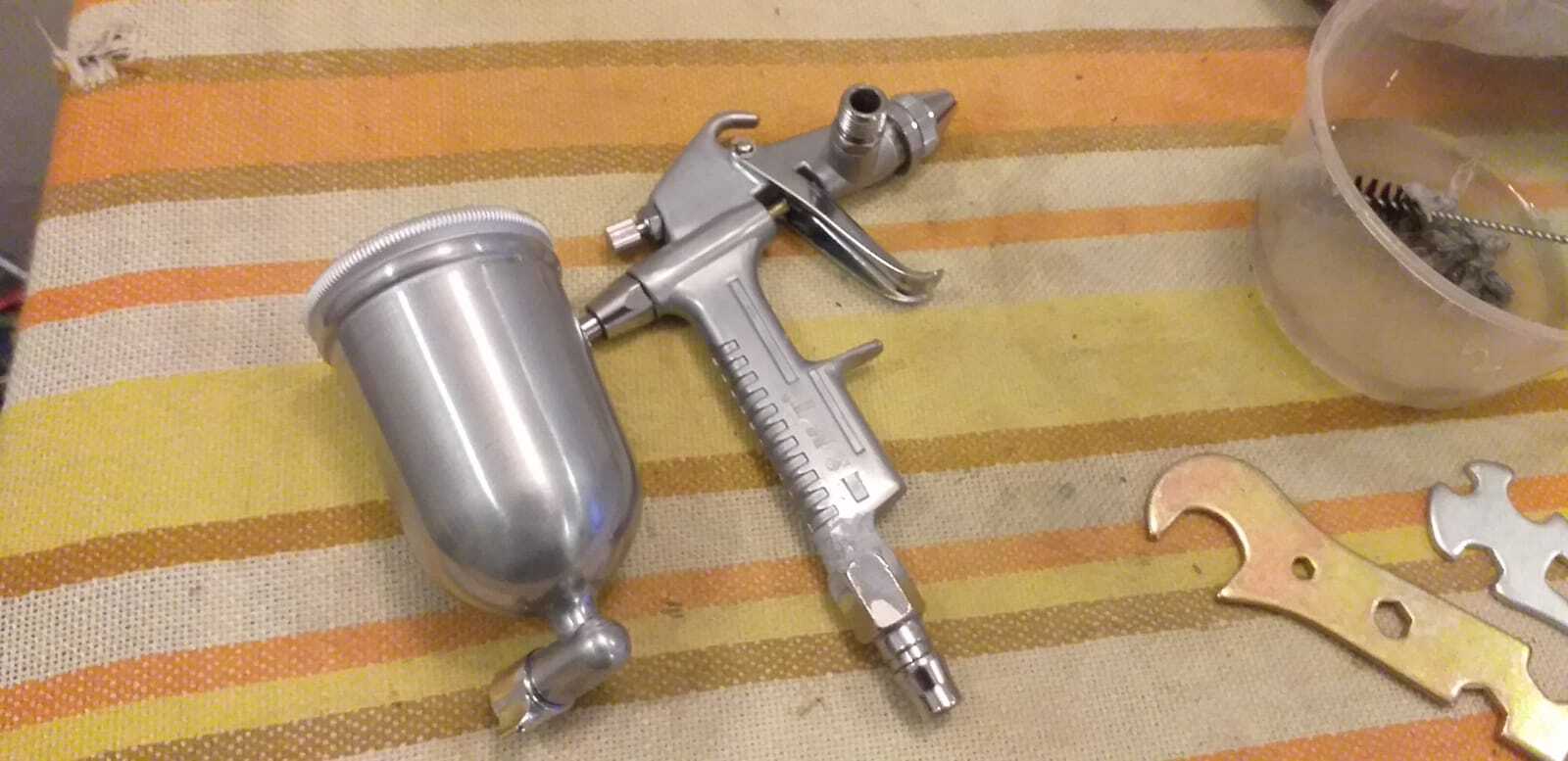

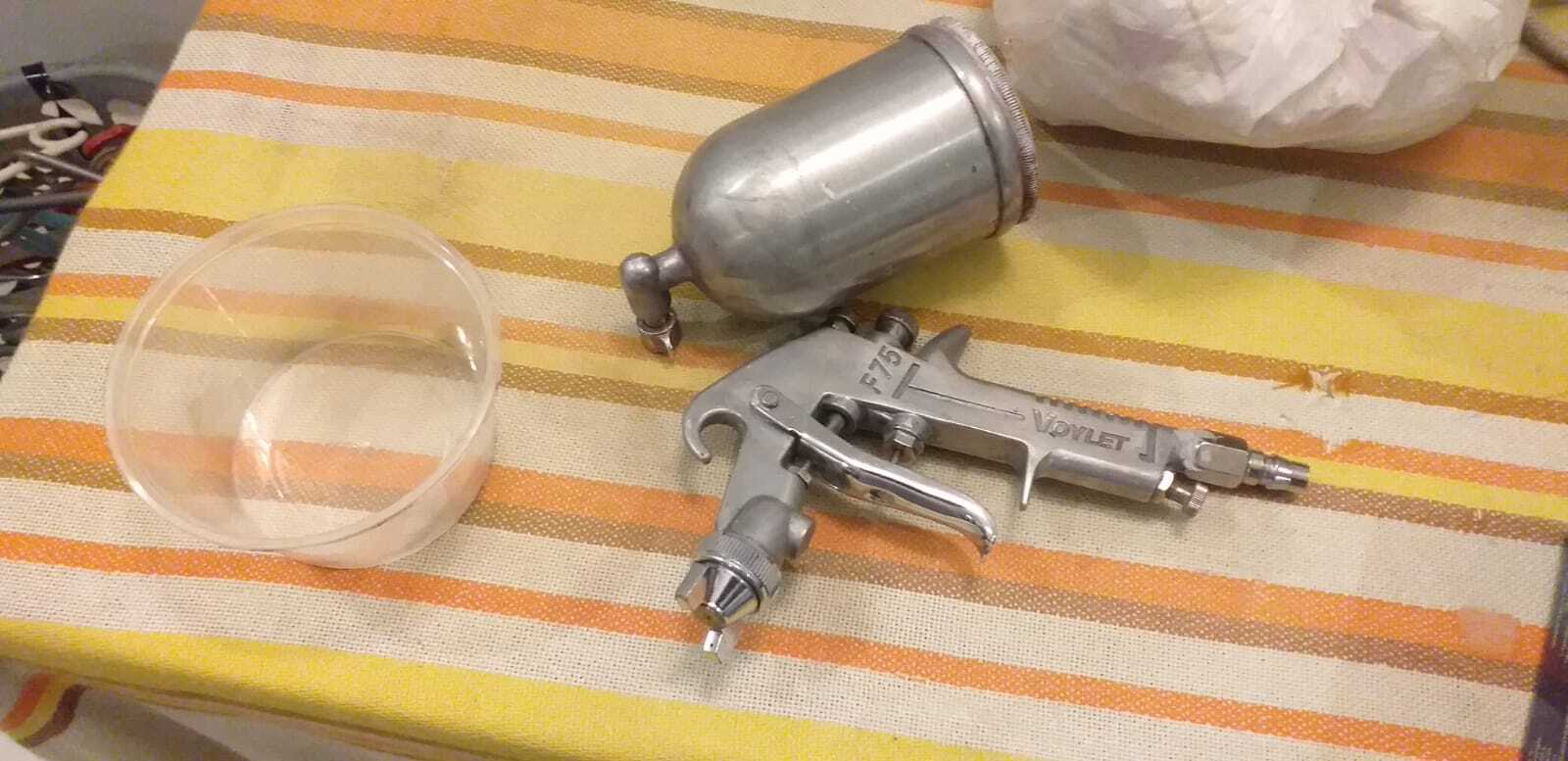

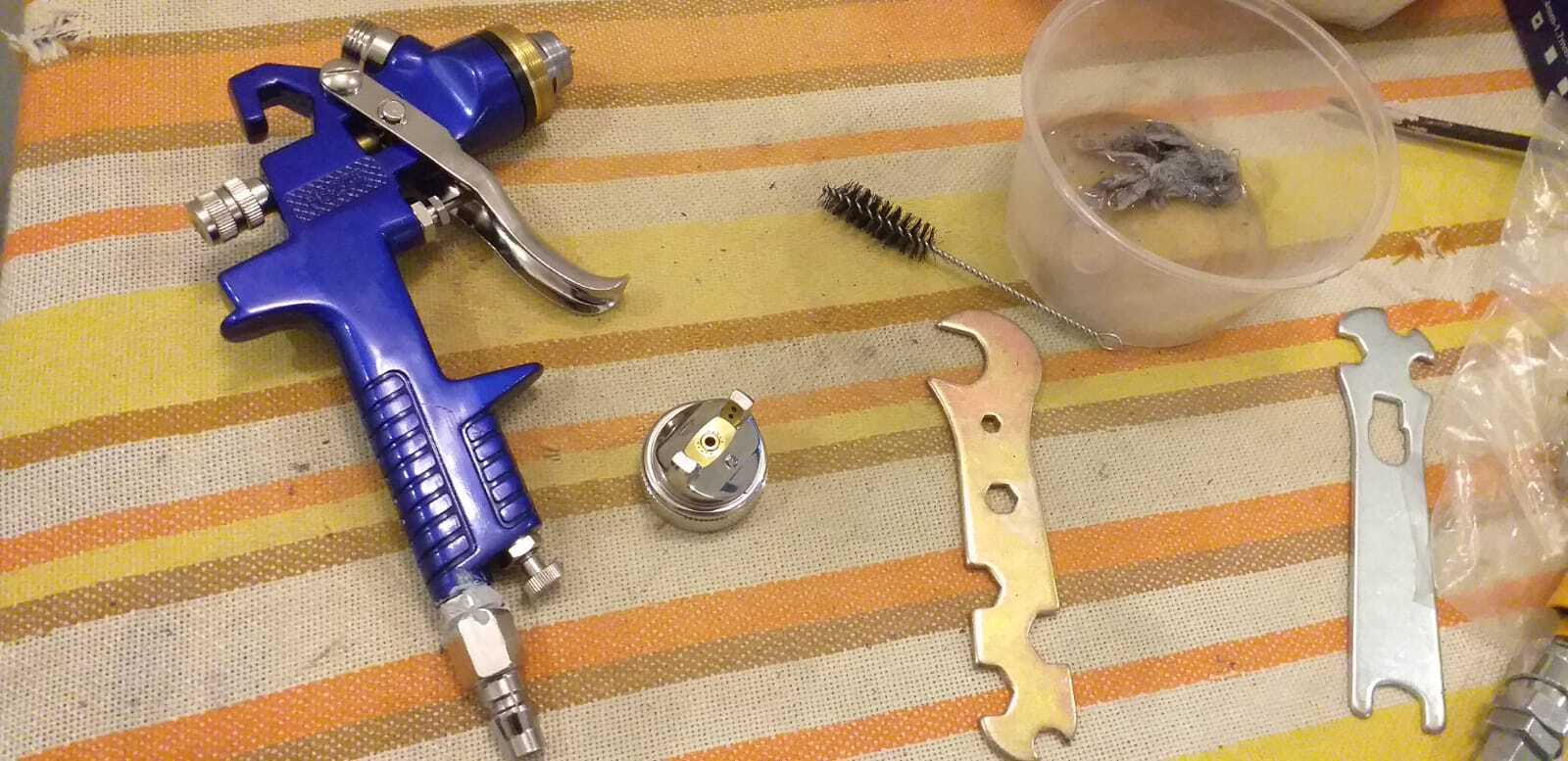

paint guns disassembled, washed from inside ,,,,, new guns do need cleaning as they are coated with assembly lube during assembly process ,,,,,,,

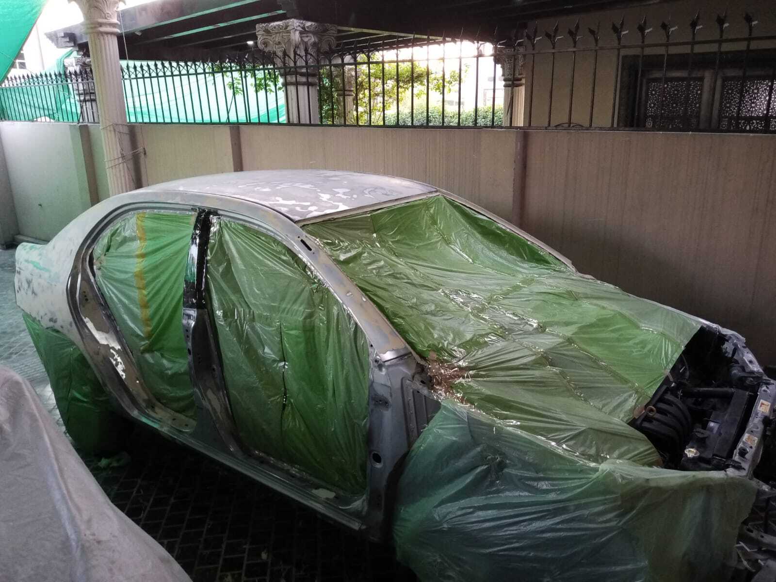

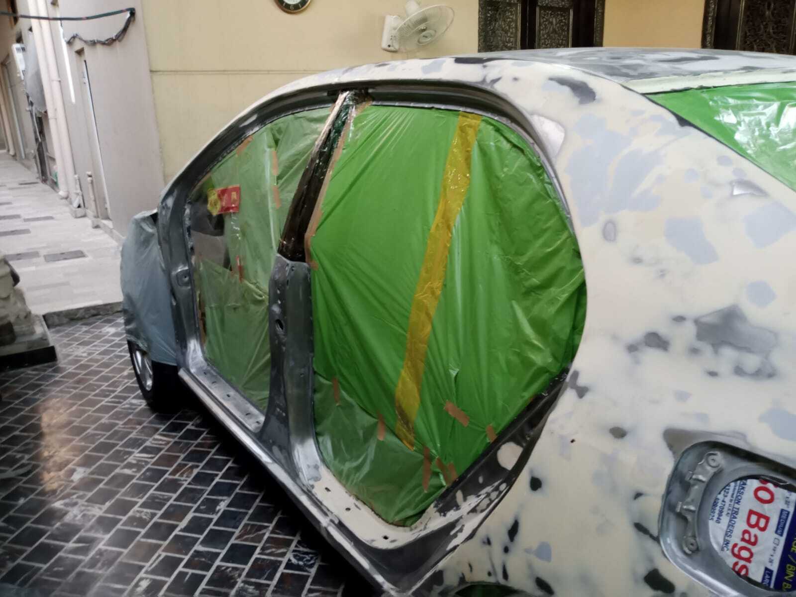

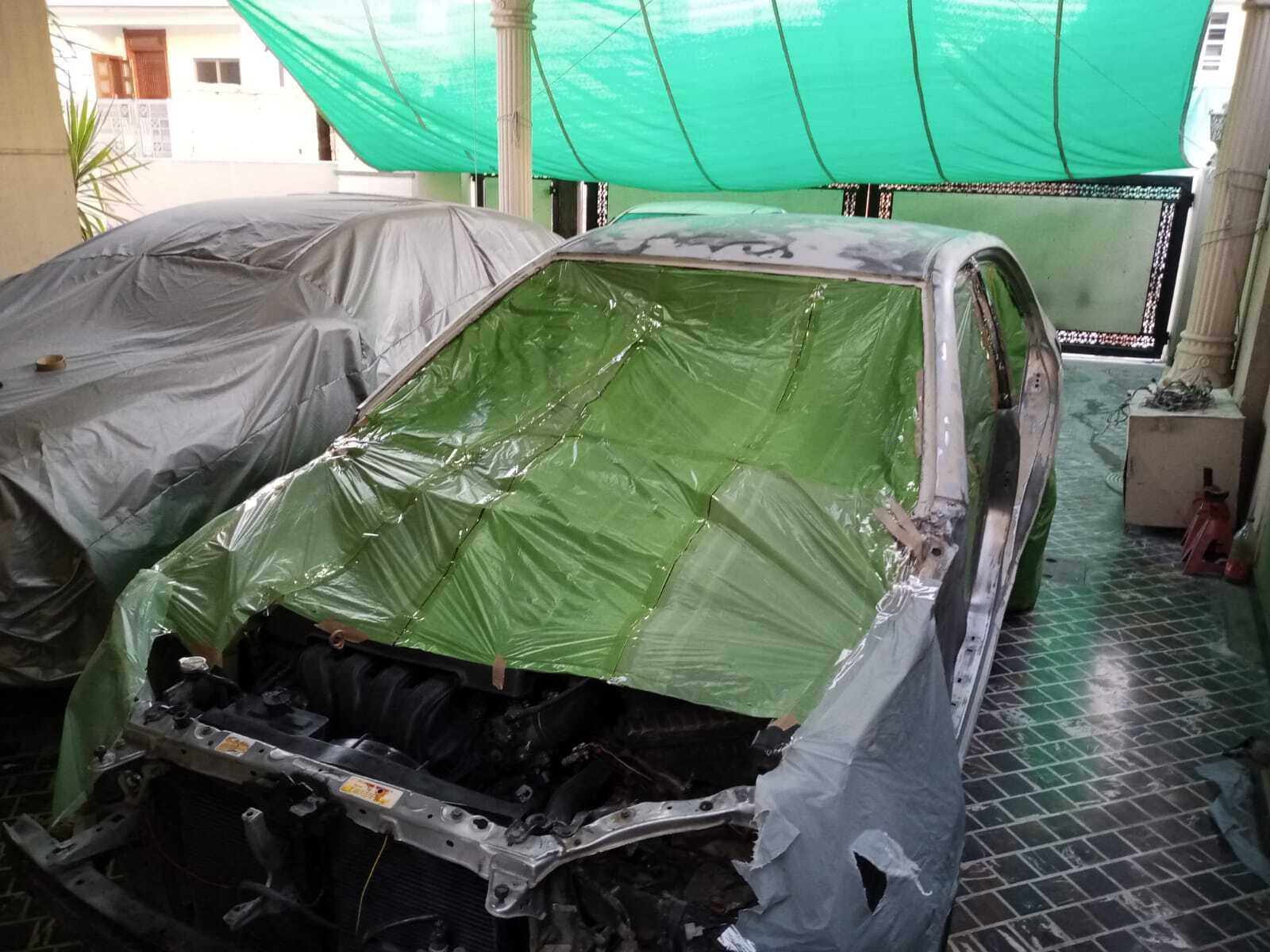

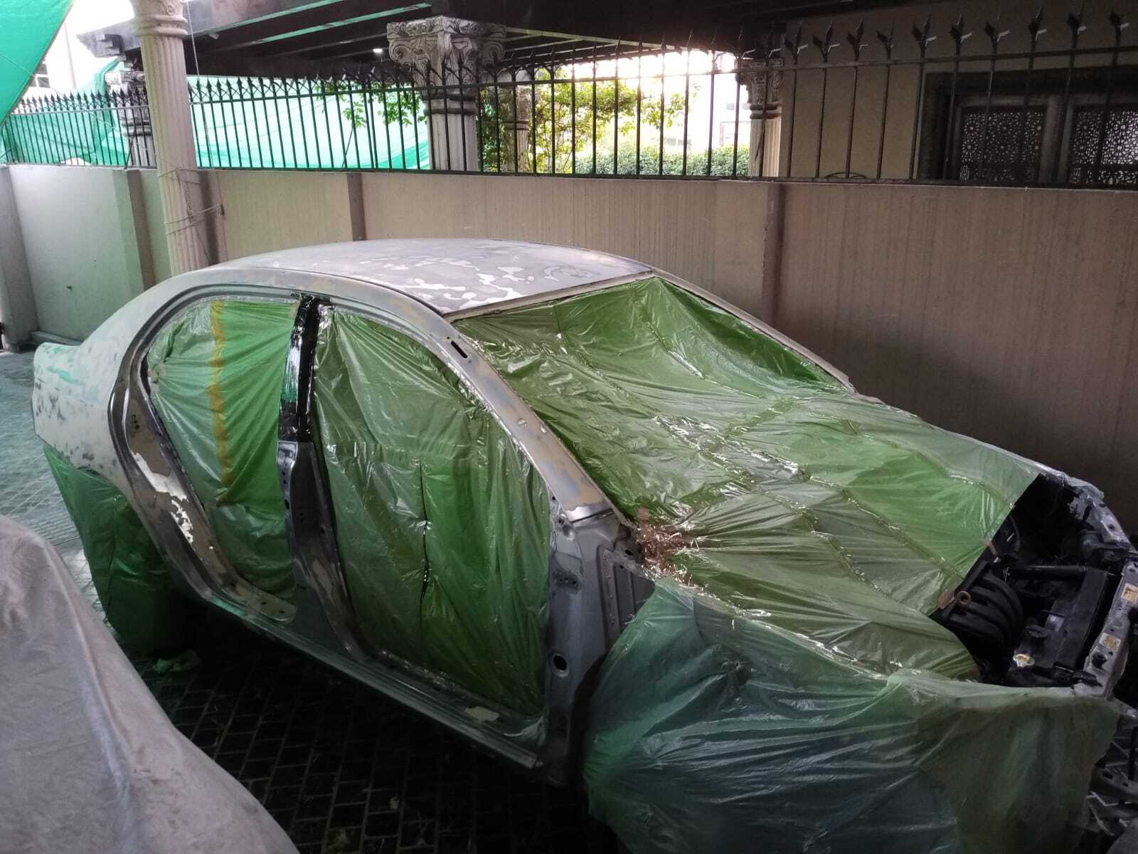

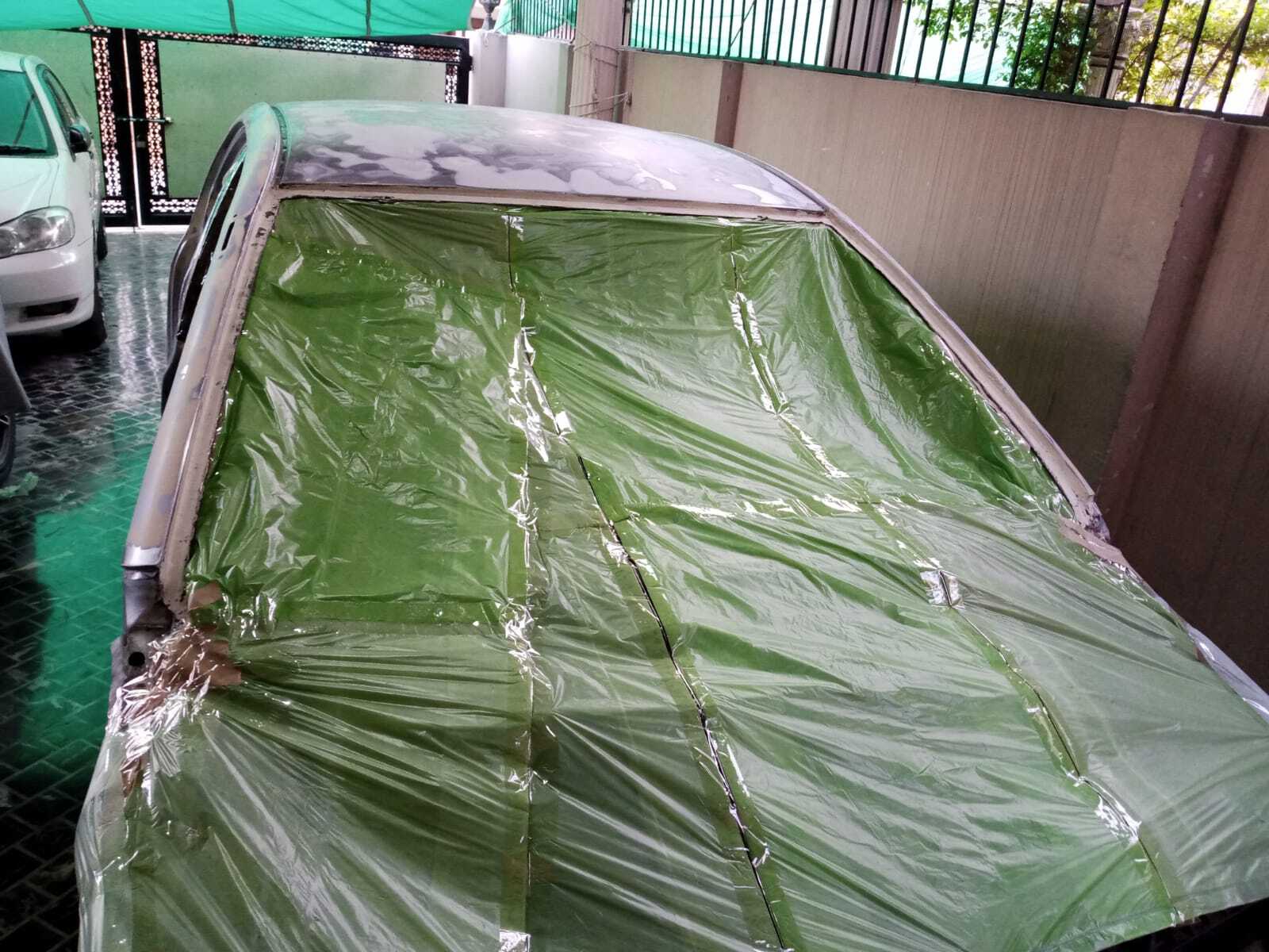

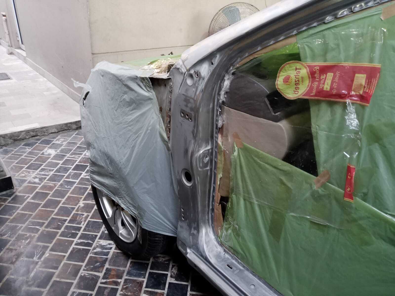

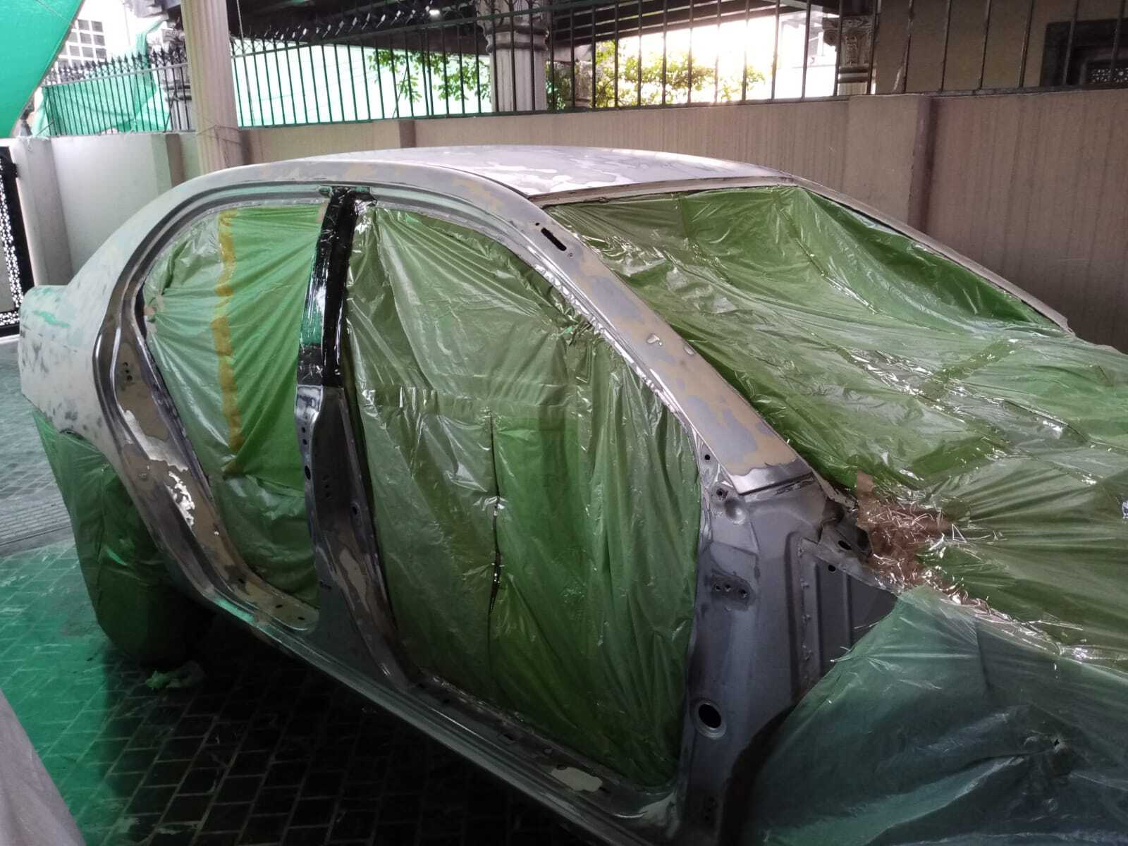

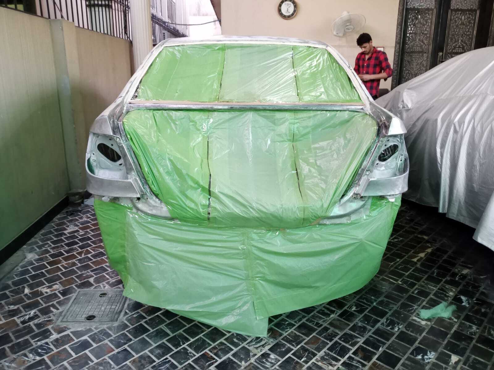

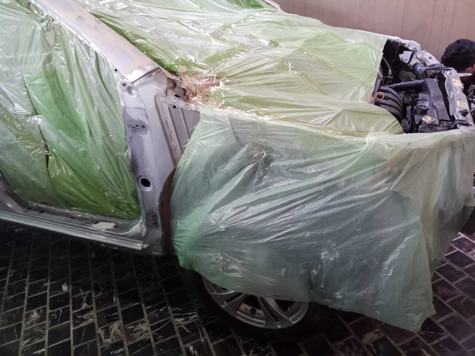

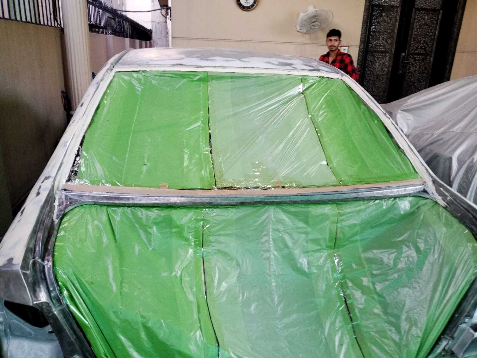

masked up ,,,,,
i hope there is no black car parked at ur neighbours

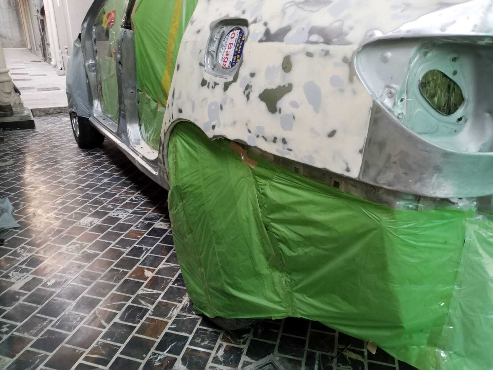

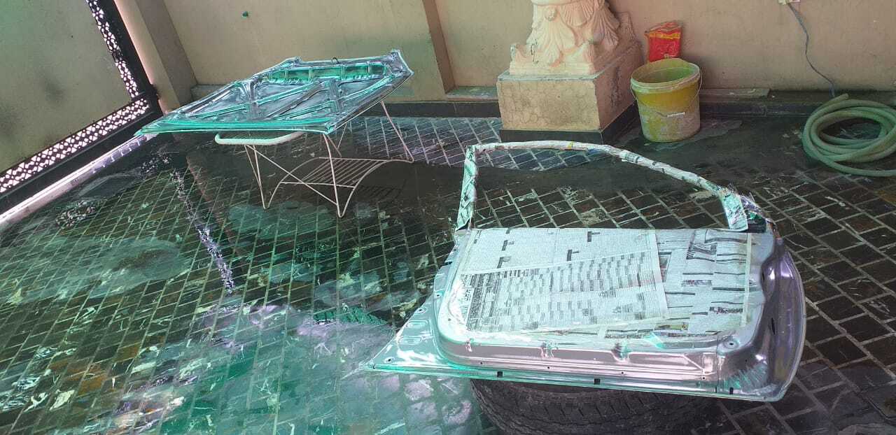

primed all body pannels ,,,,,,, havent done the body shell ,,,,,,
air tank has been drained before starting this job ,,,,, has 2 water inline water separator,,, havent checked the first one but this connected right on paint gun traps some water ,,,,

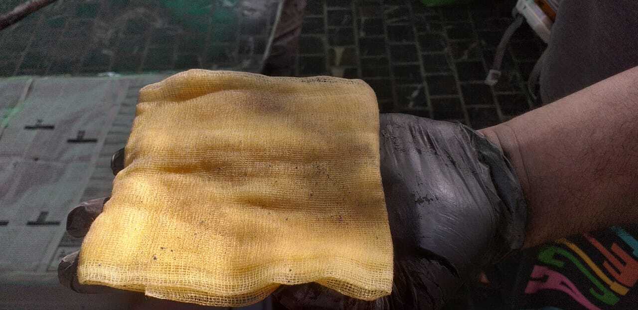

Tack cloth wipes off lot of panel dust , even after cleaning panels with silicon off ,,,,,,,,
