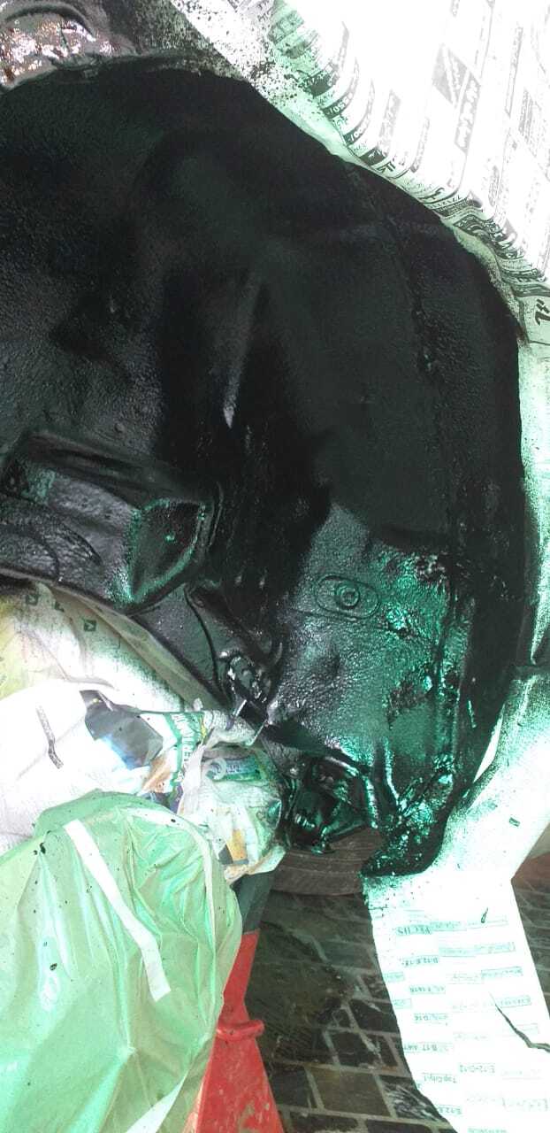

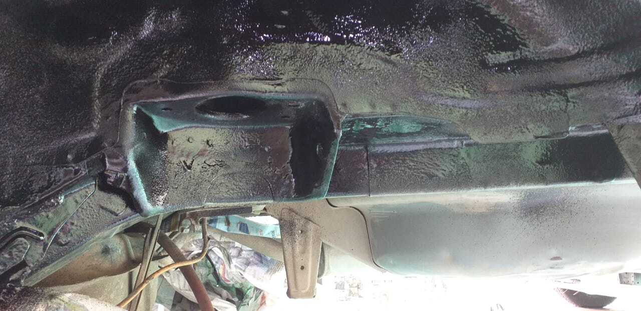

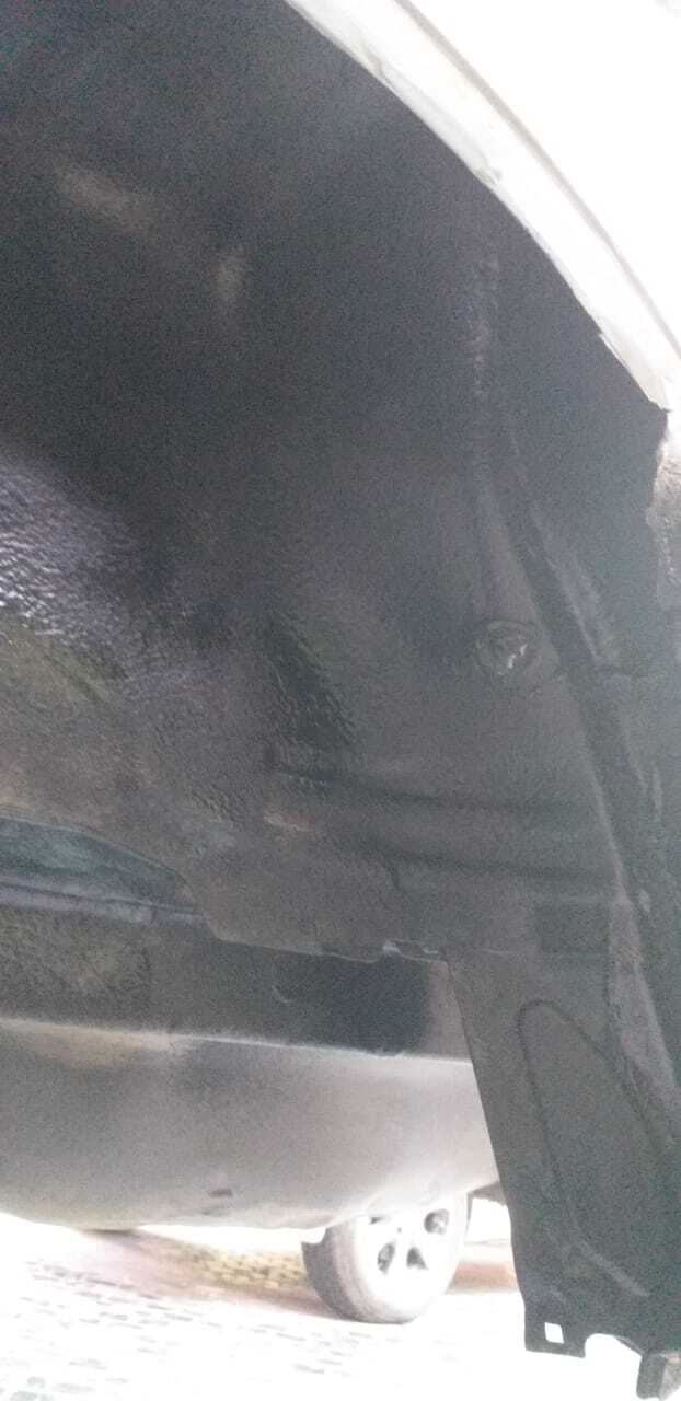

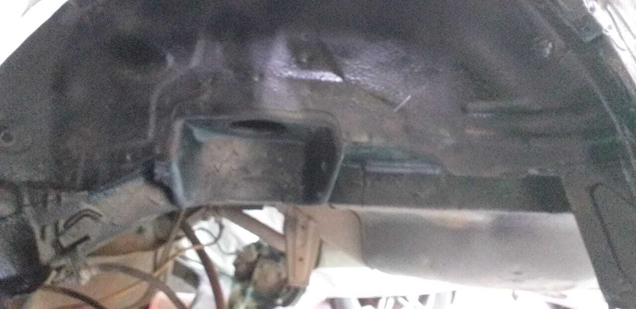

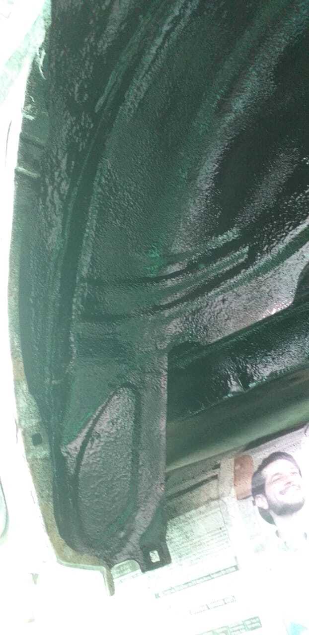

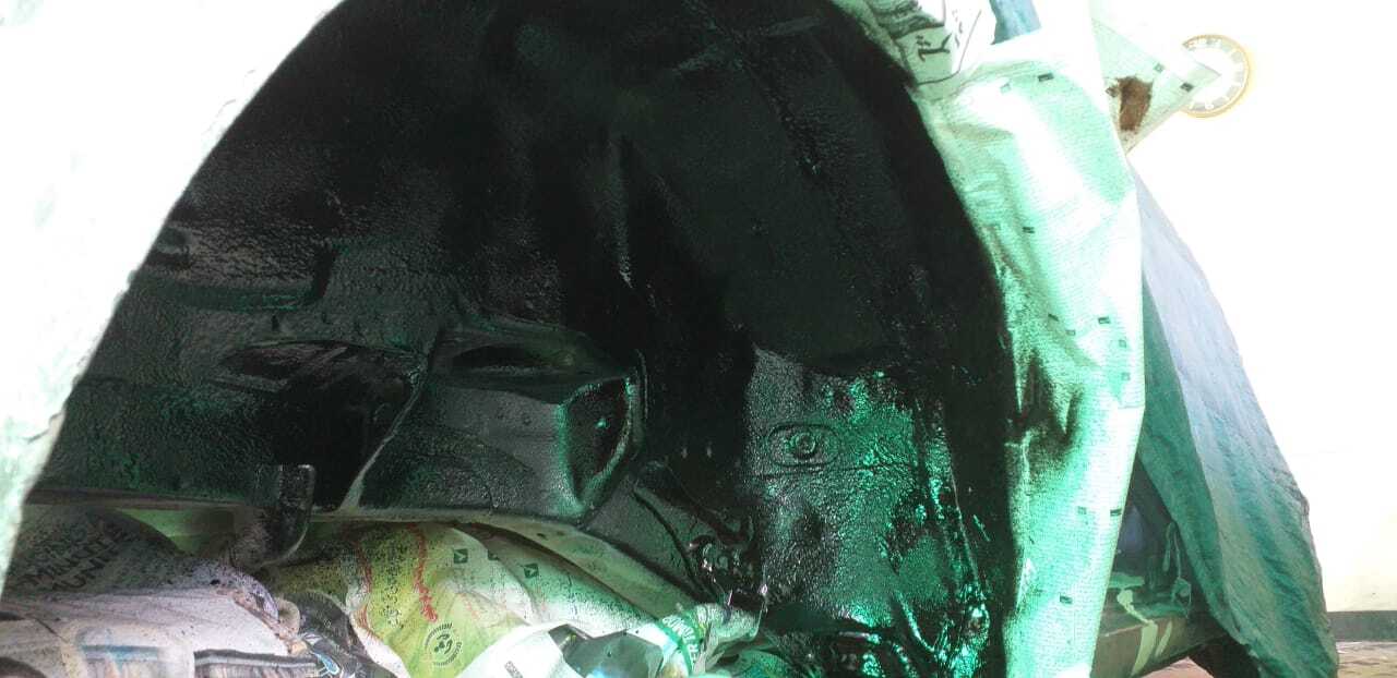

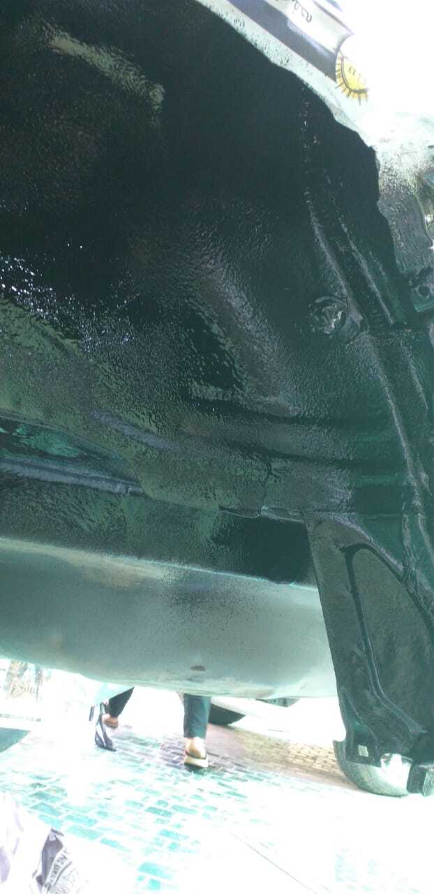

Does it gets hard like seam sealer? Or stay soft like silicone?
its not like silicon ,,,, same as seam sealer which is originally used on door edges ,,,,,,,

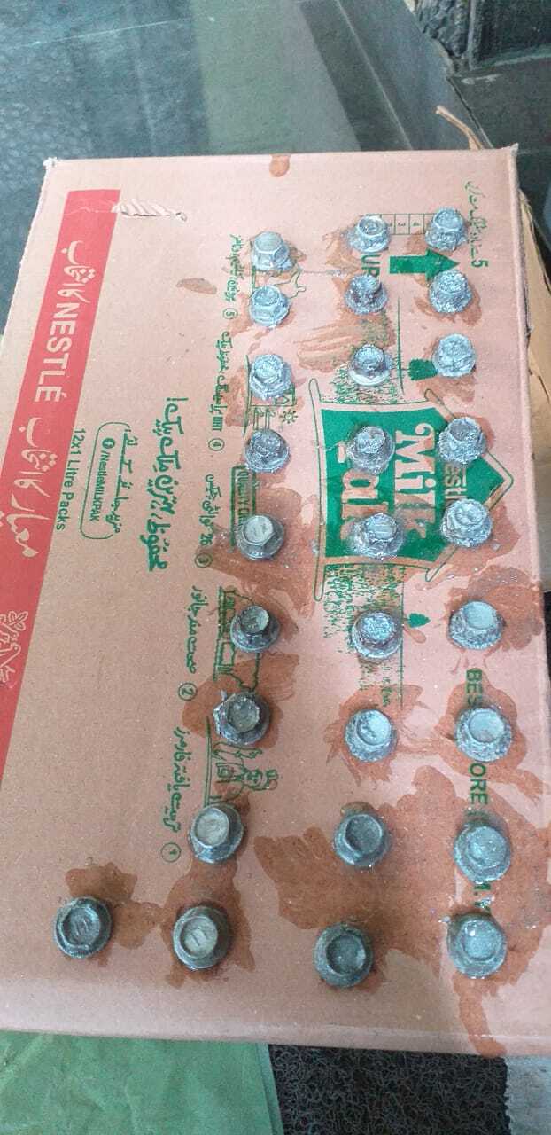

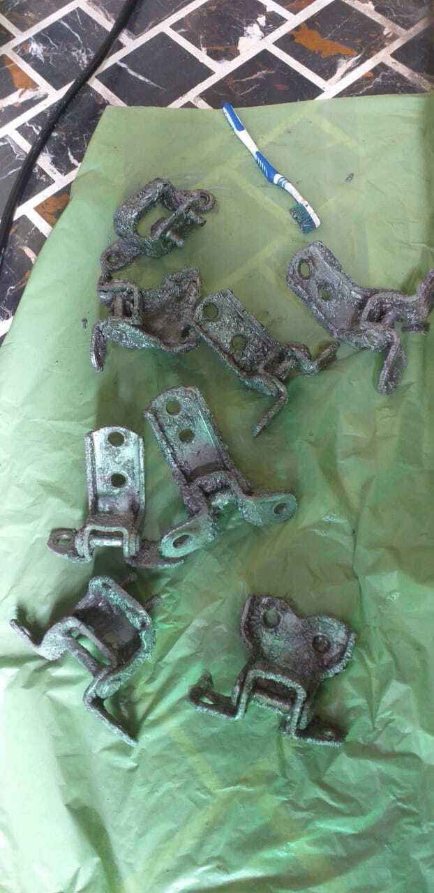

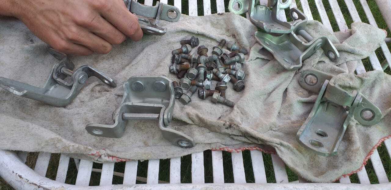

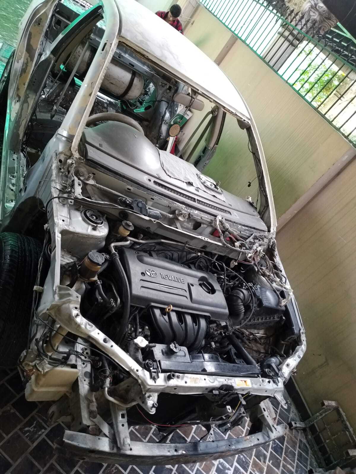

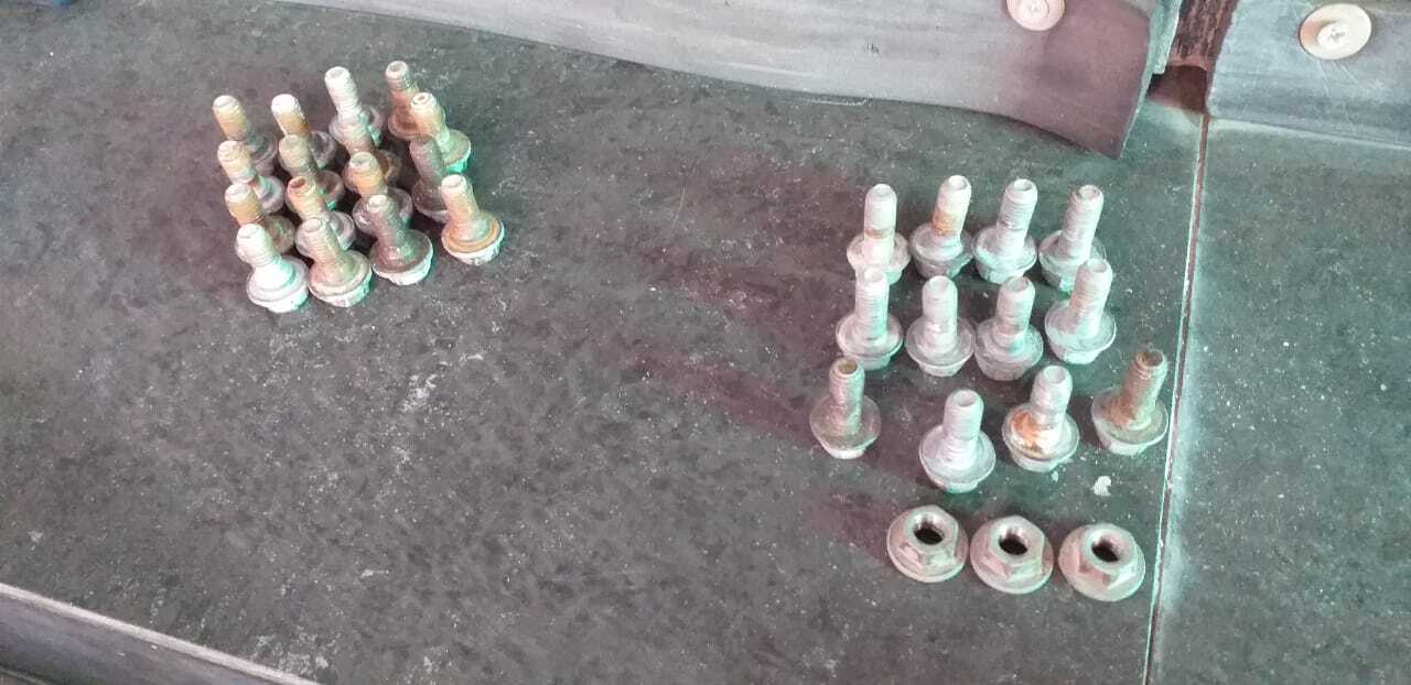

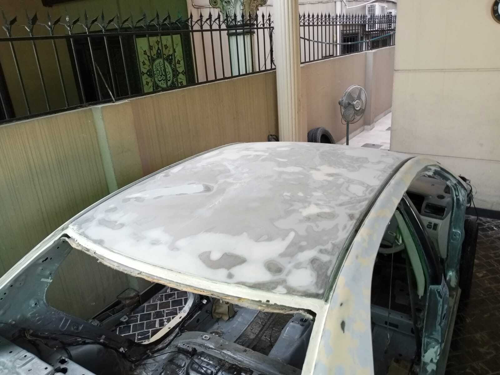

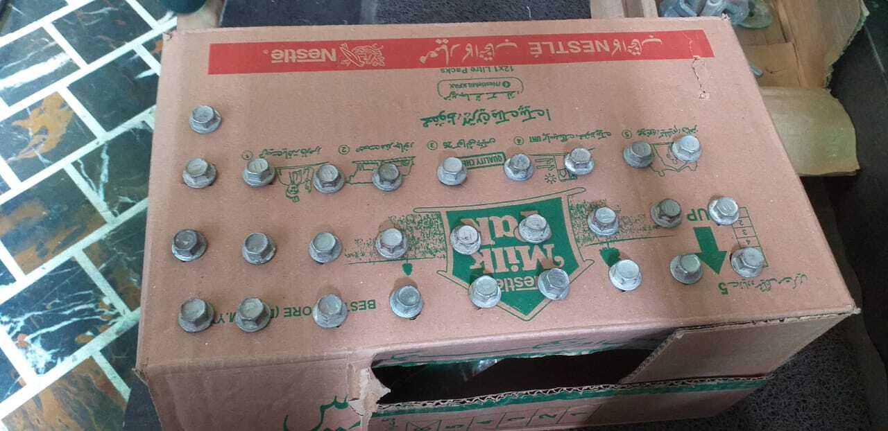

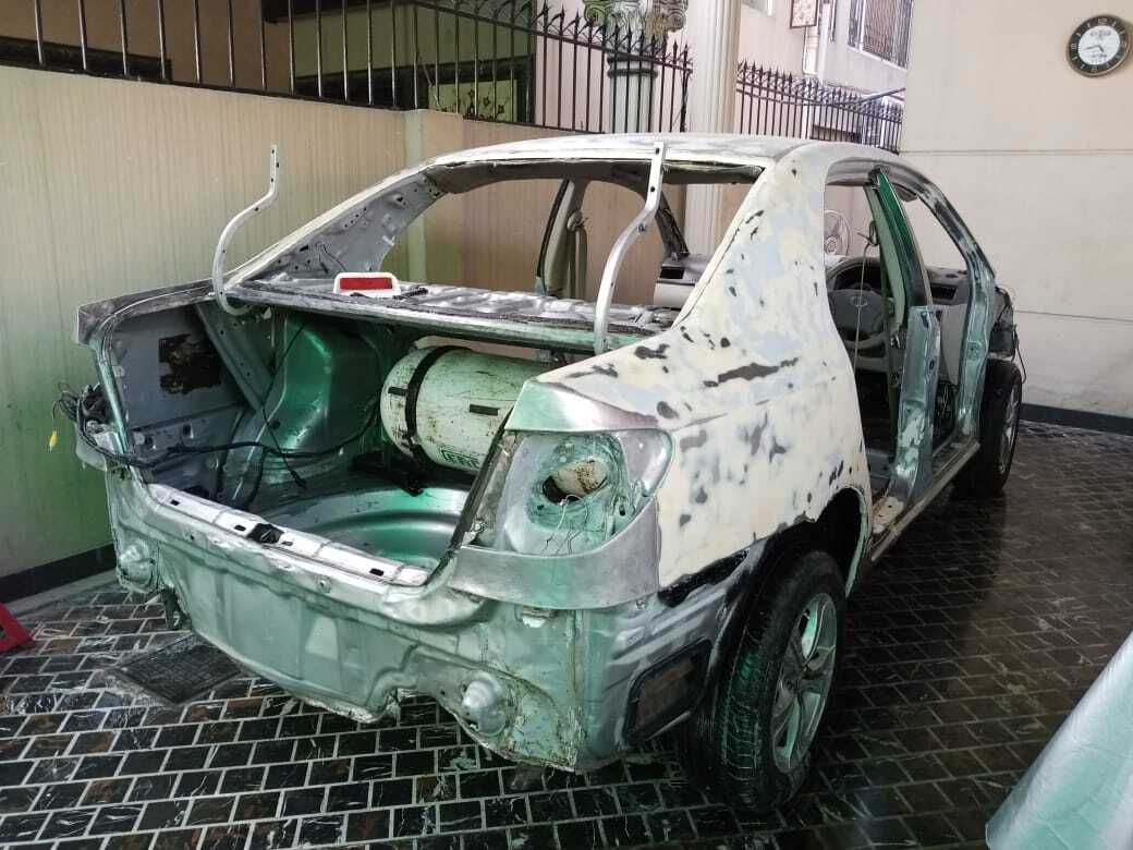

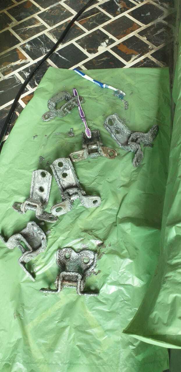

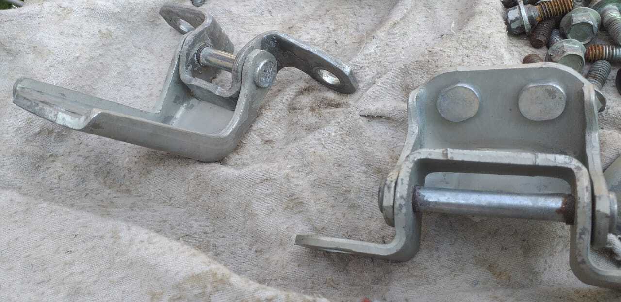

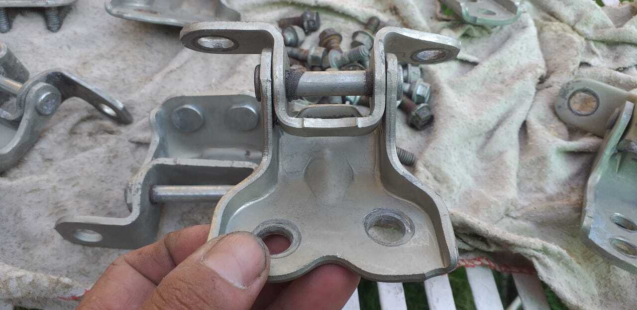

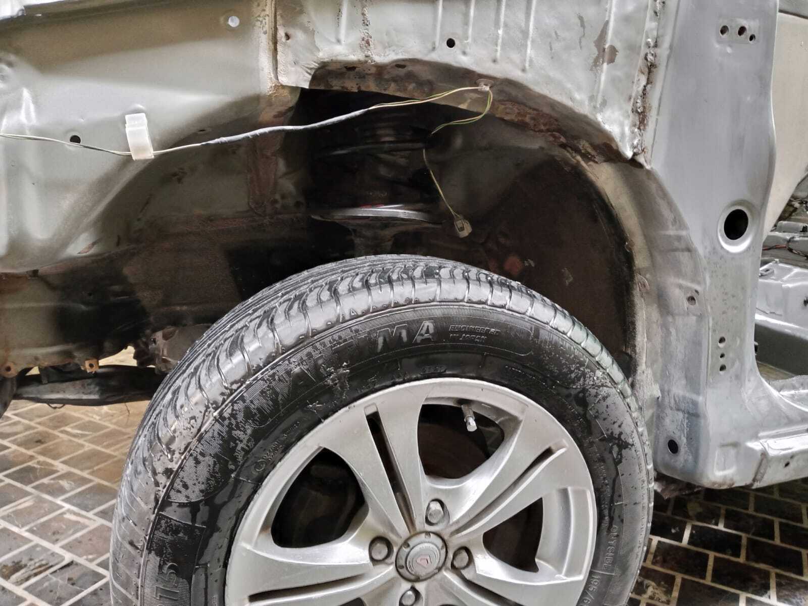

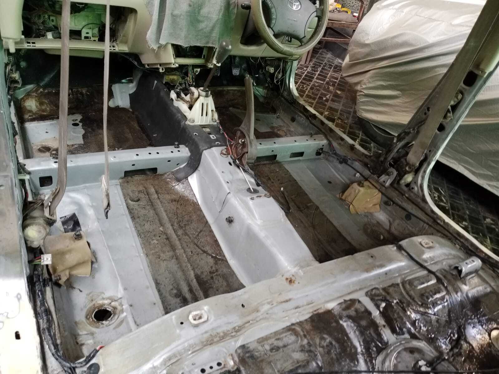

door hinges and bolts have been cleaned with paint stripper ,,,,, i plan to use sand blaster after words but paint stripper has done its job very well ,,,, just pressure washing is enough ,,,,, and they have been plated with zinc ,,,,, sand blasting , wire brush or abrasive paper can cleaned that zinc off and can cause rust in long term ,,,,,,,

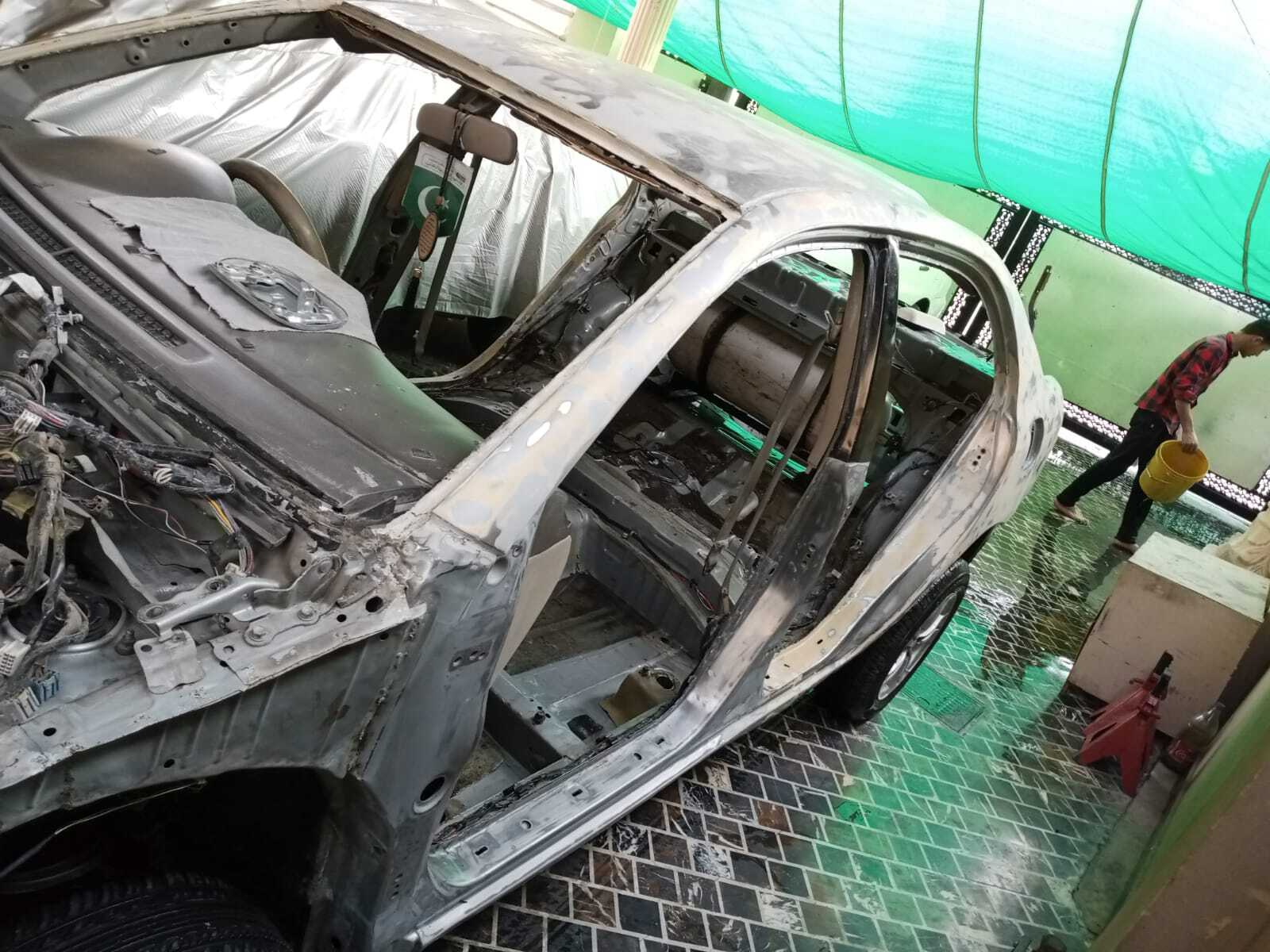

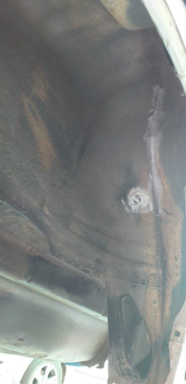

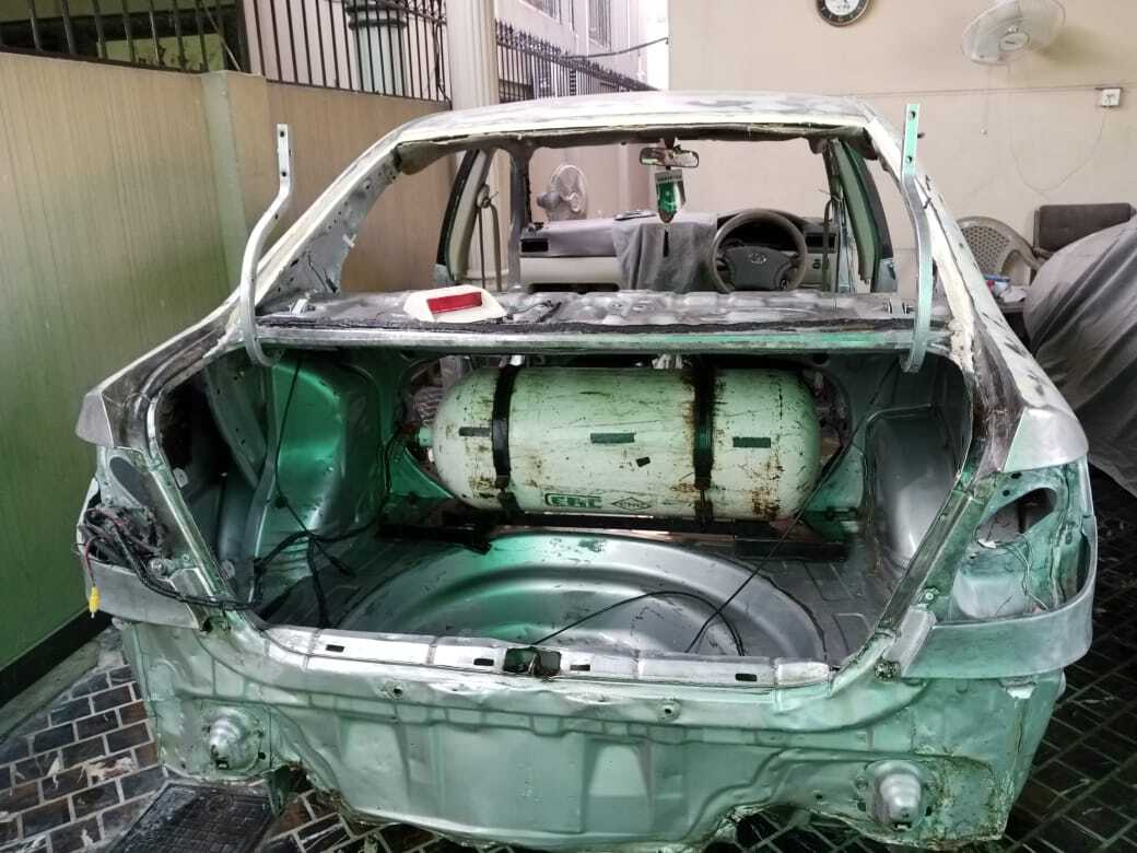

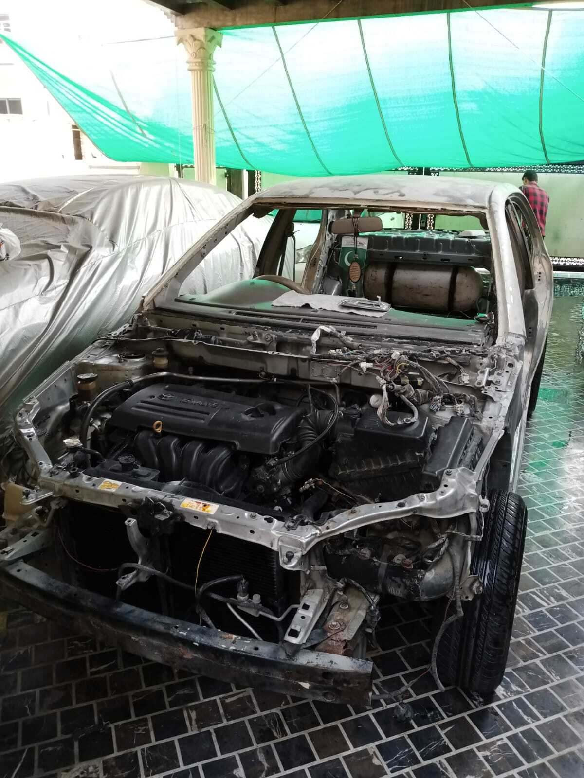

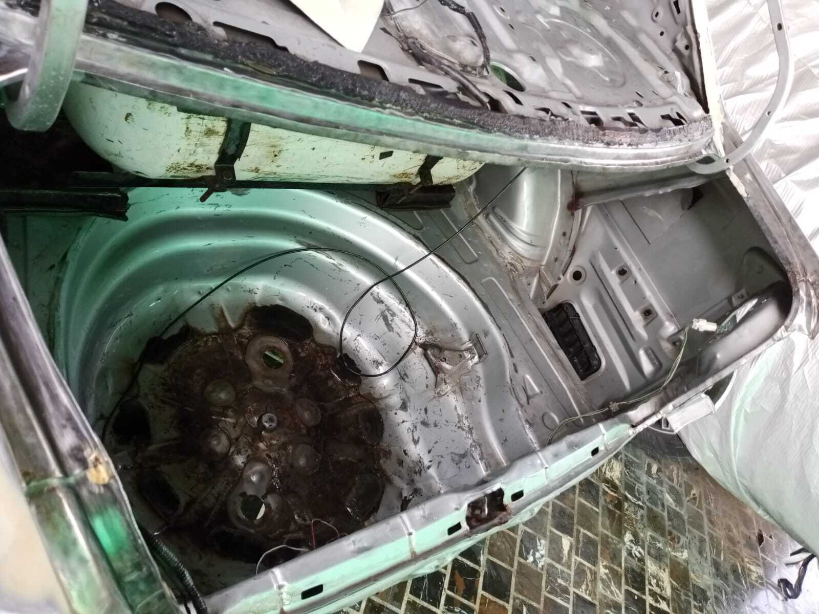

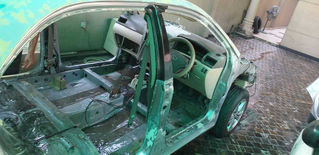

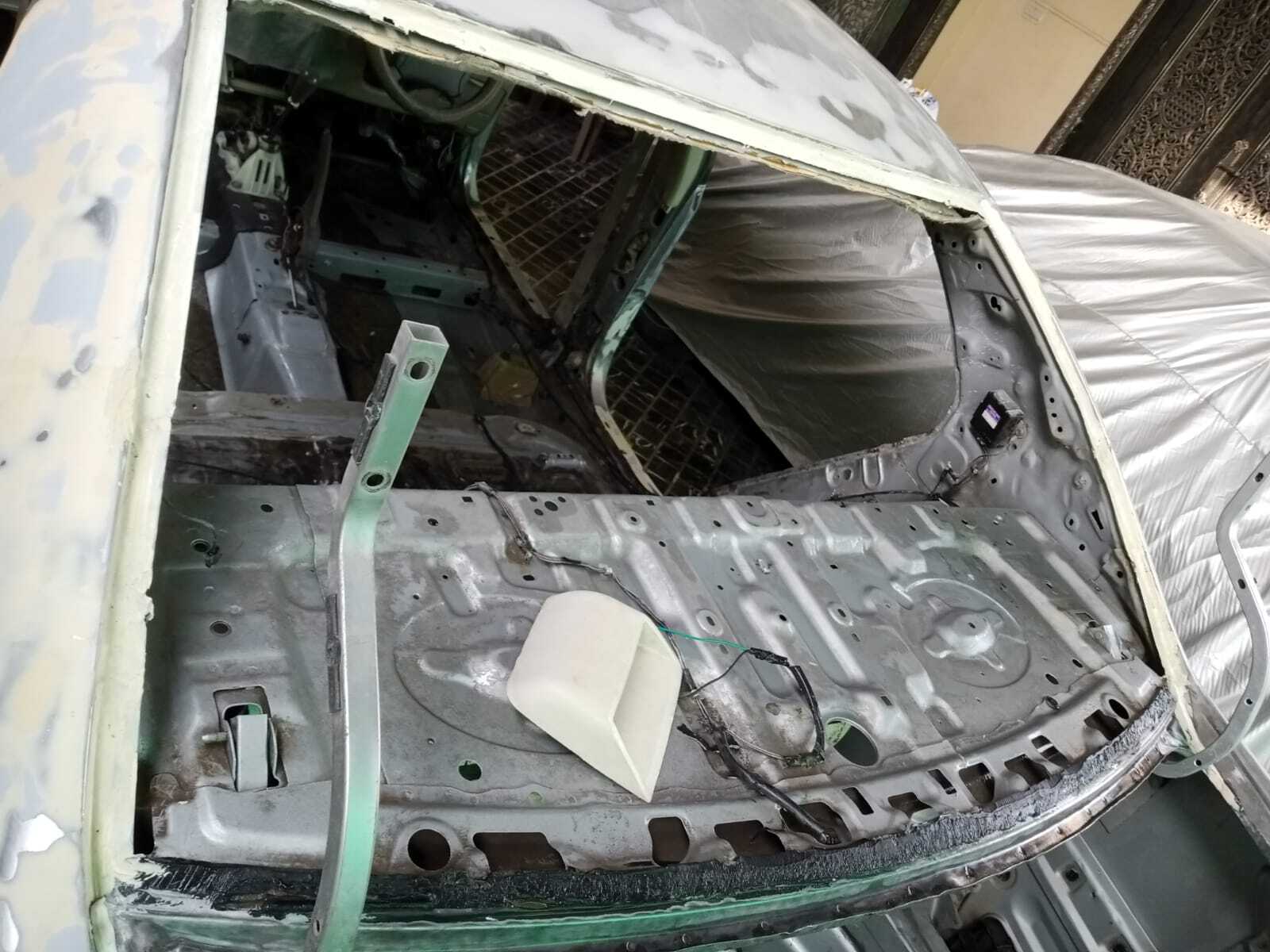

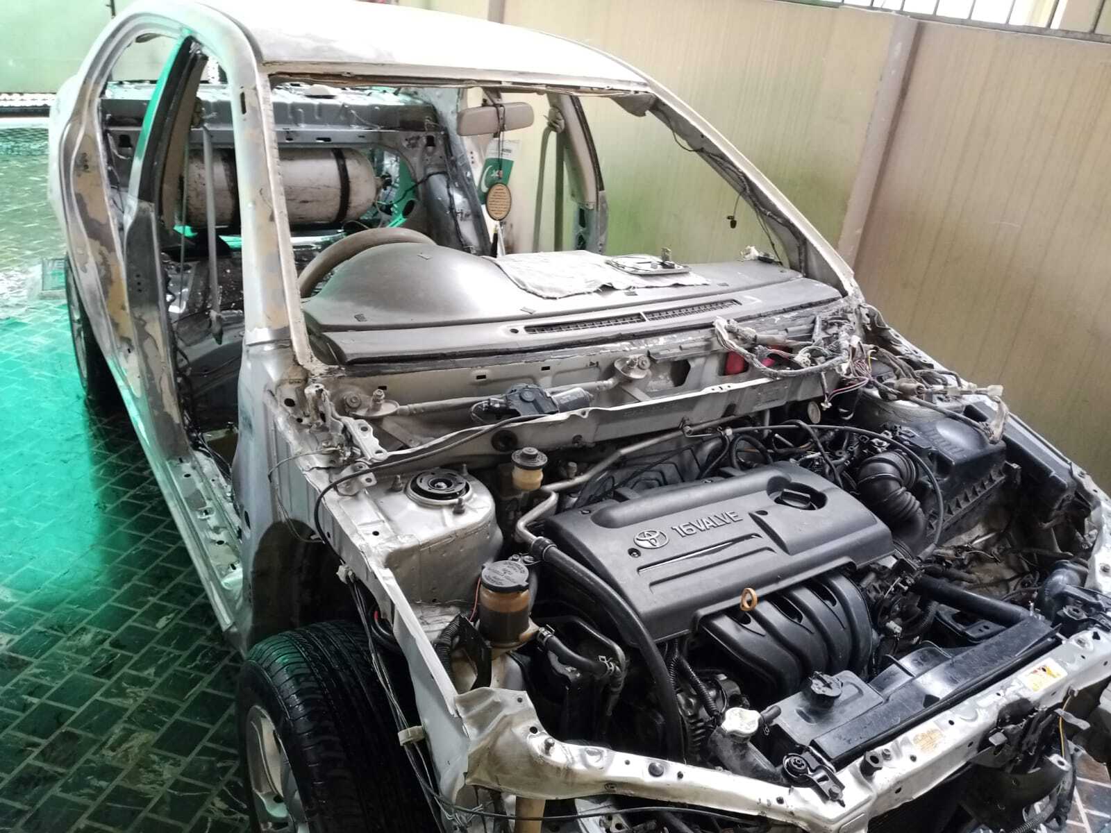

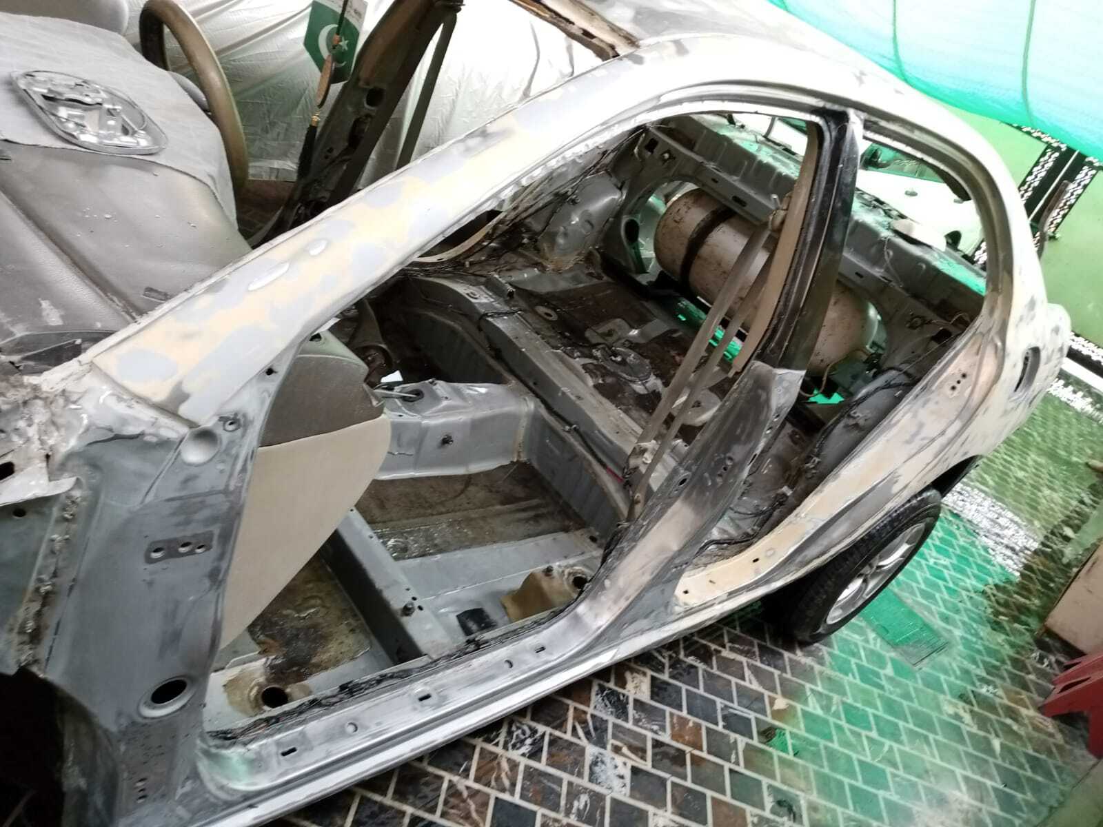

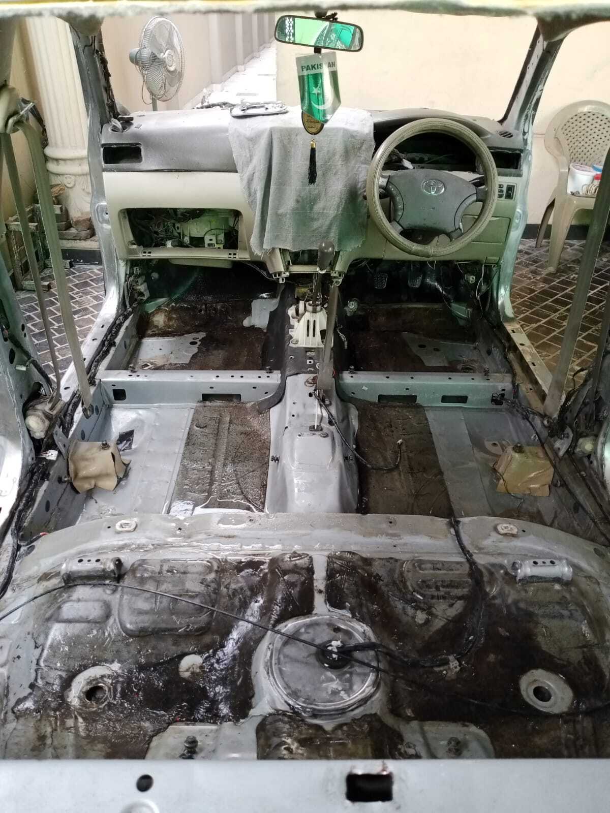

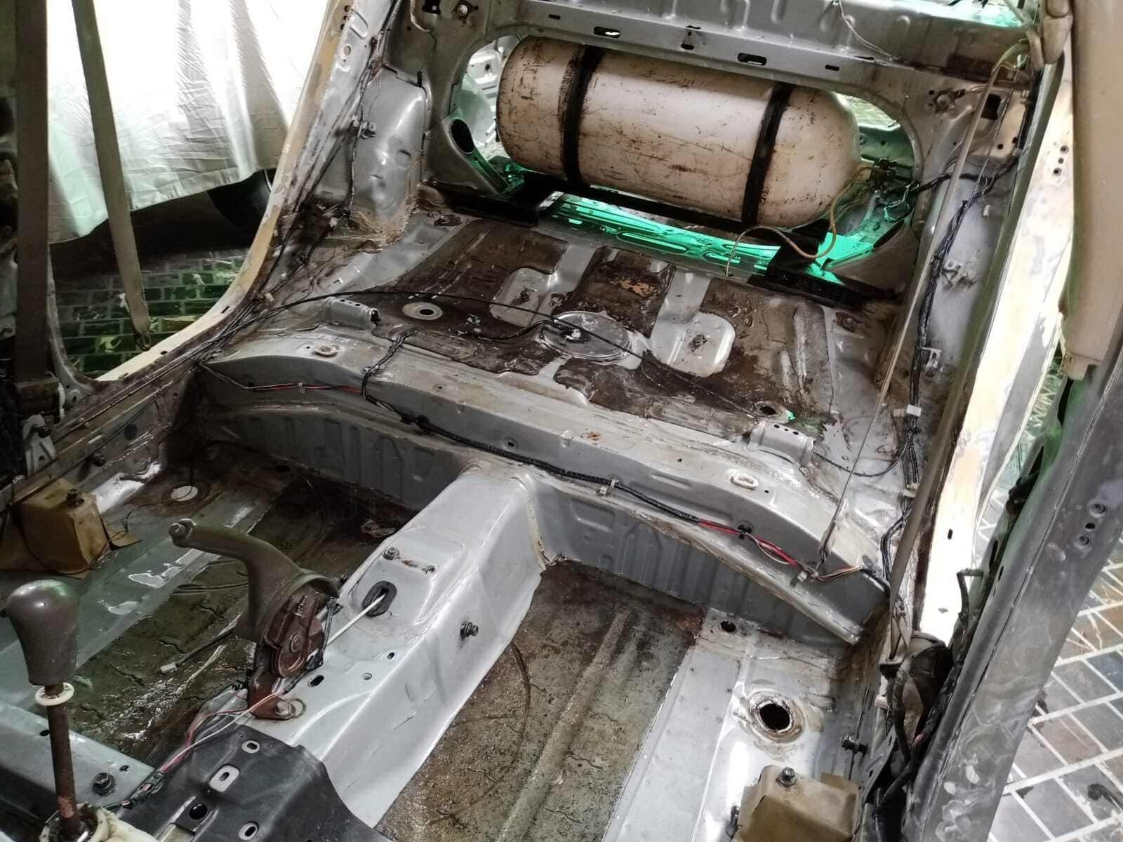

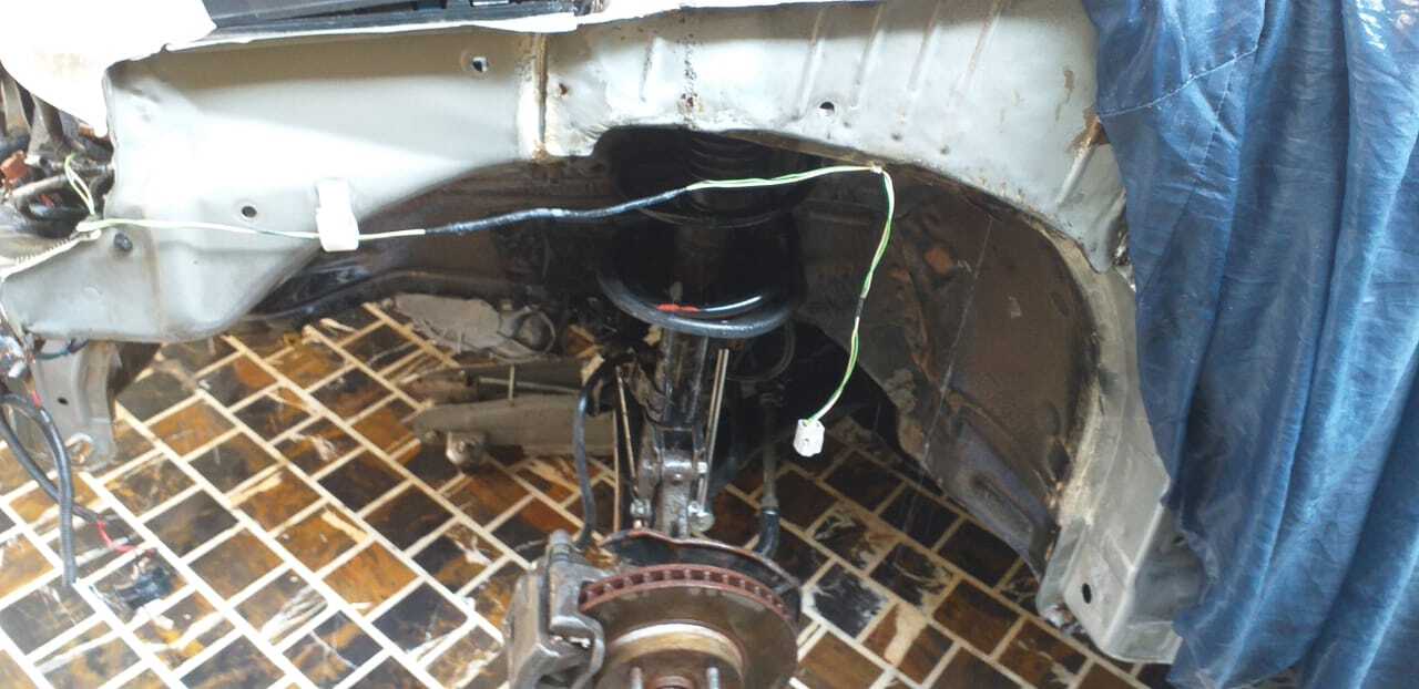

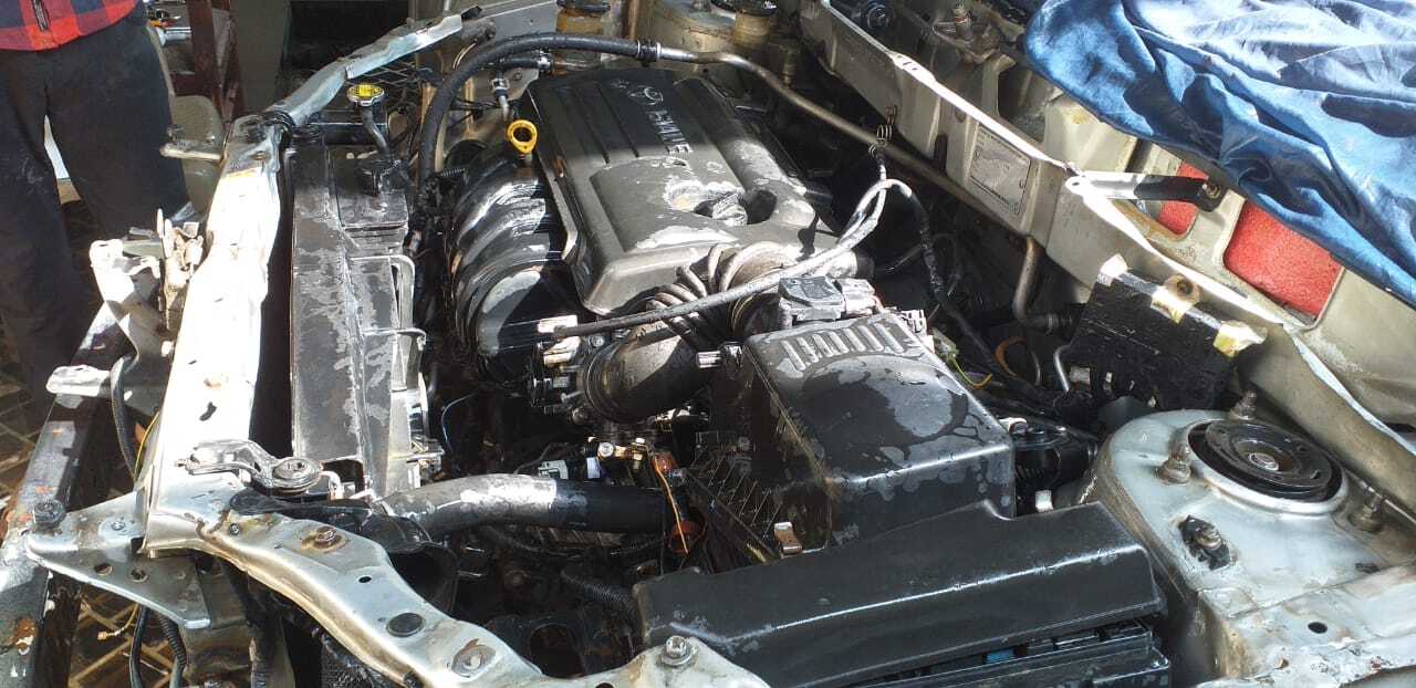

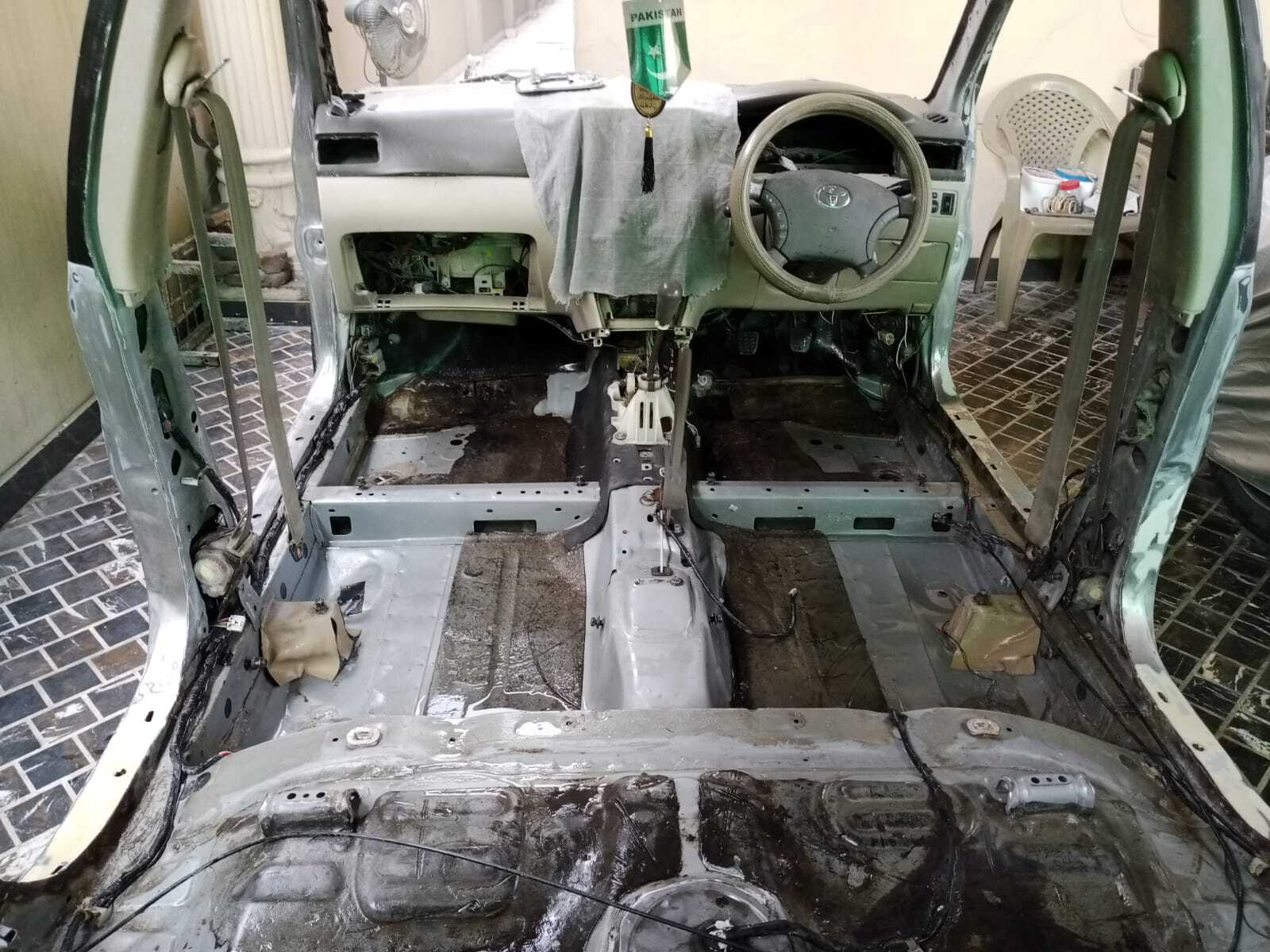

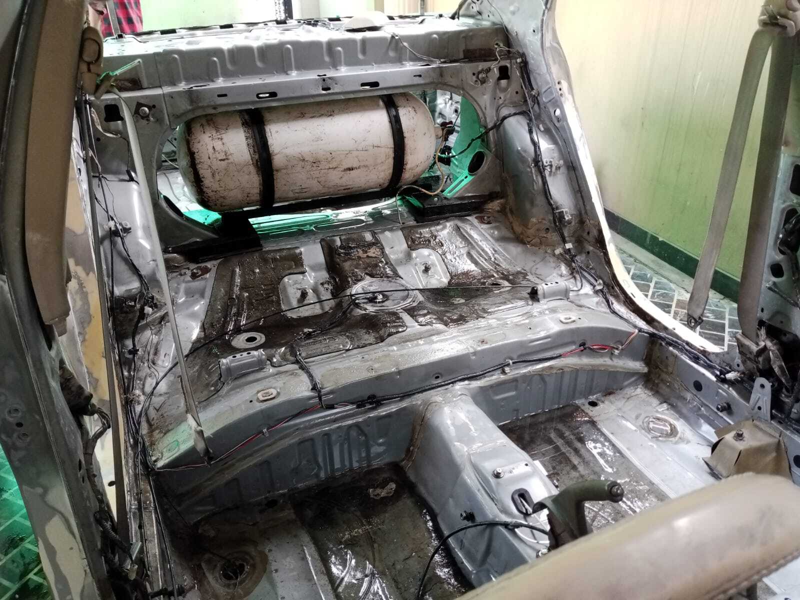

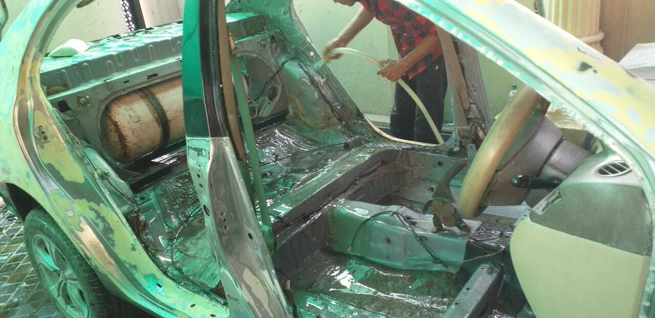

pressure washed the entire vehicle from inside out ,,,,,,,

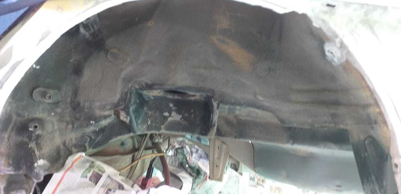

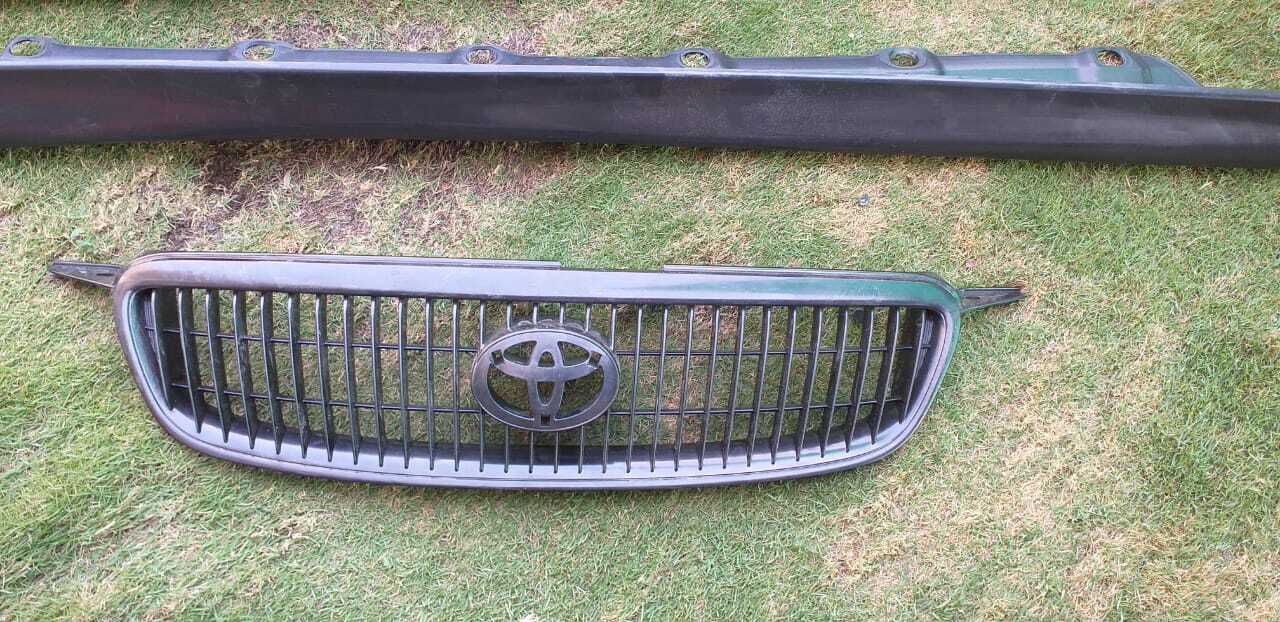

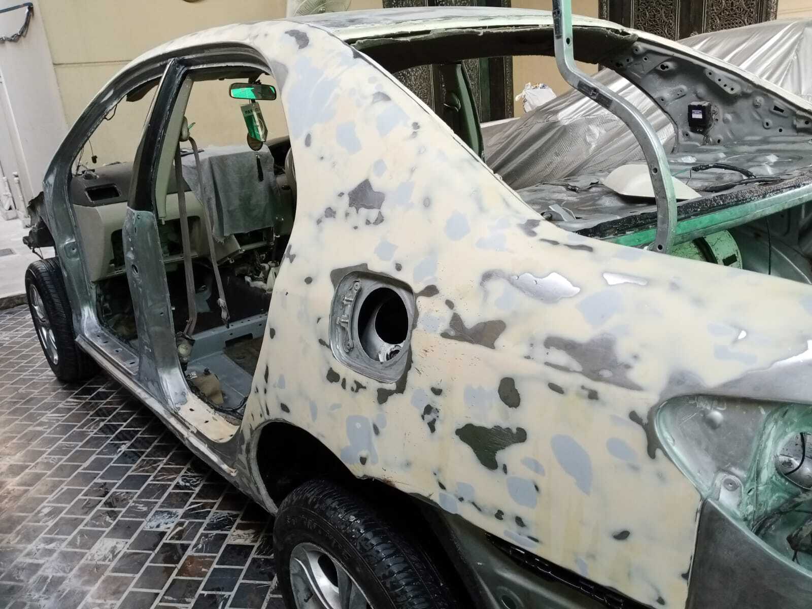

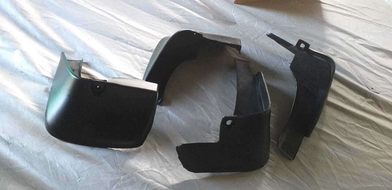

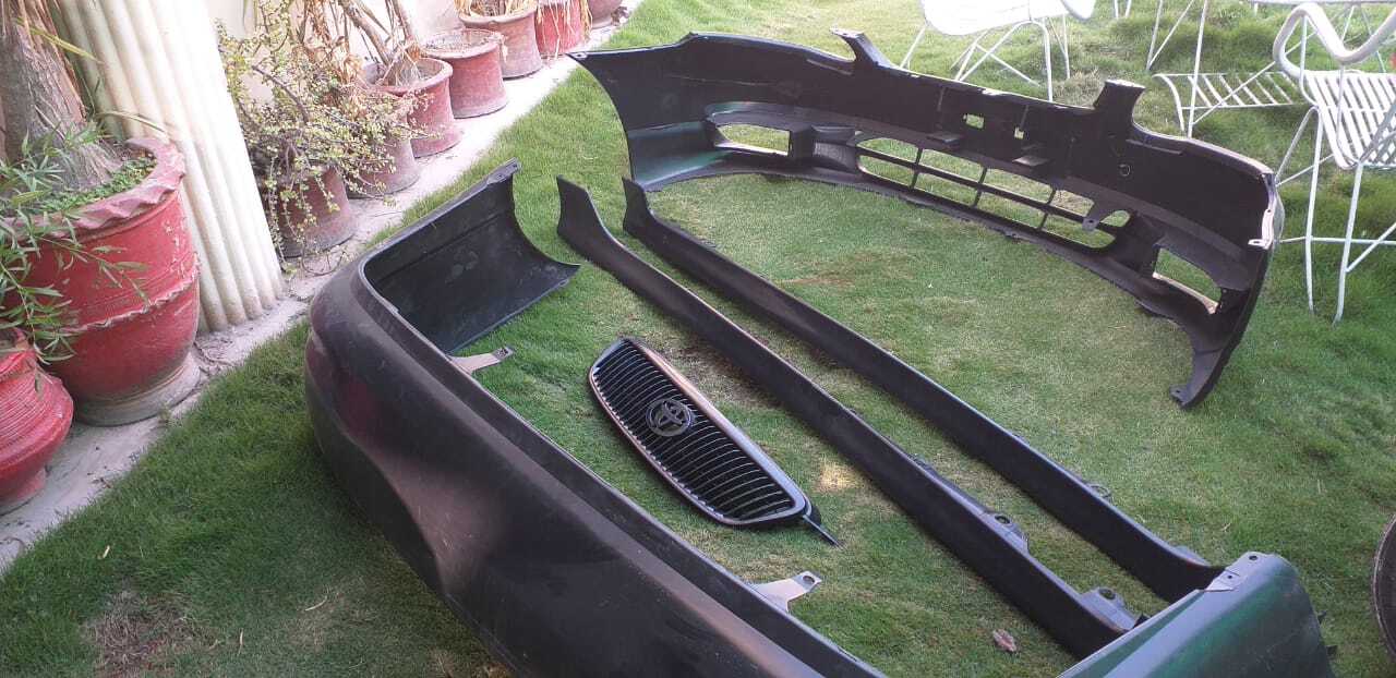

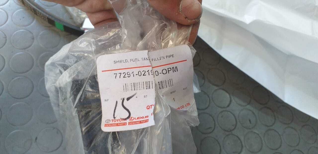

new plastic parts have been scuffed and prepared for plastic primer / adhesion promoter,,,,,,,,
