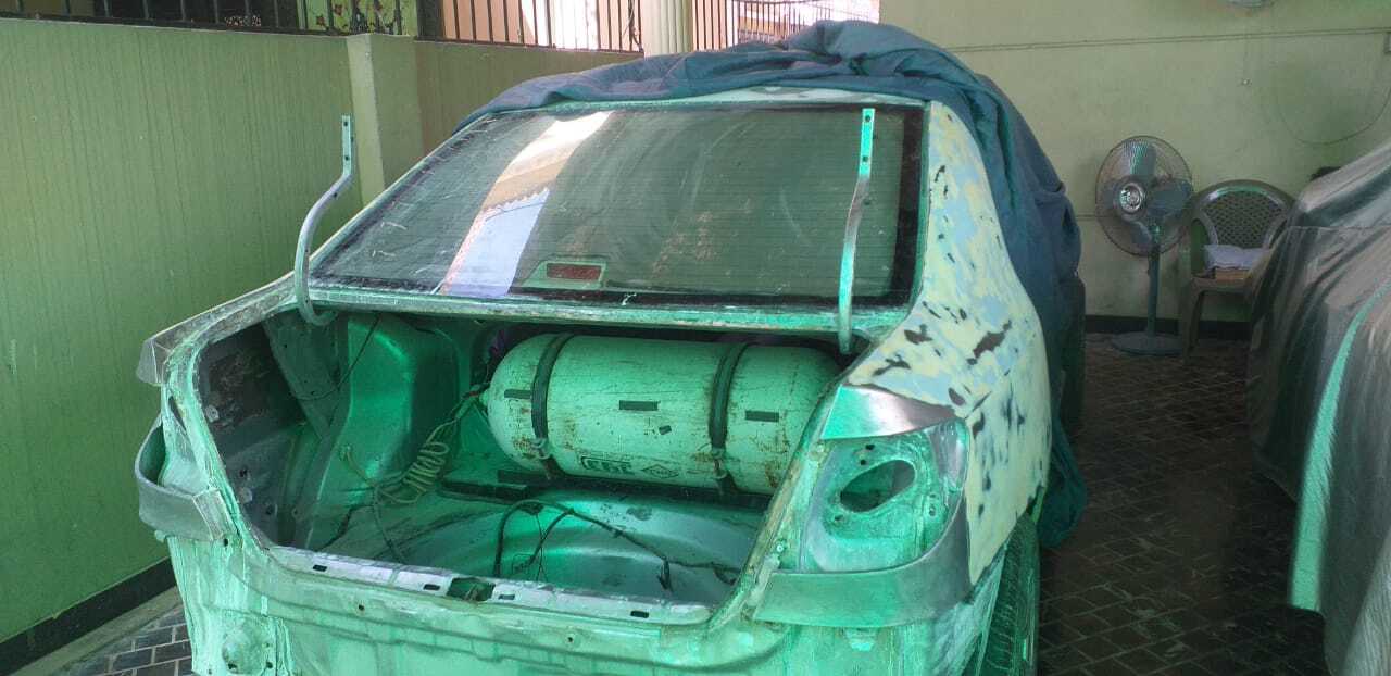

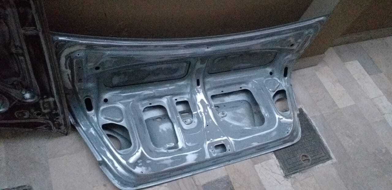

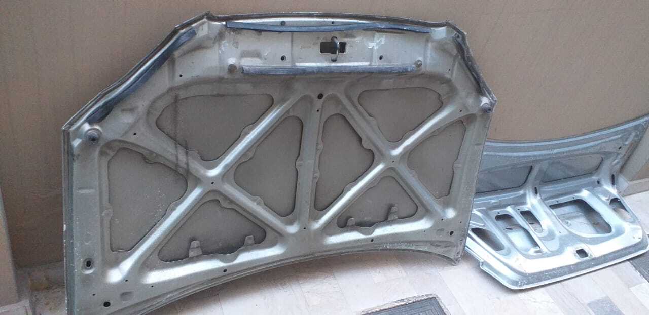

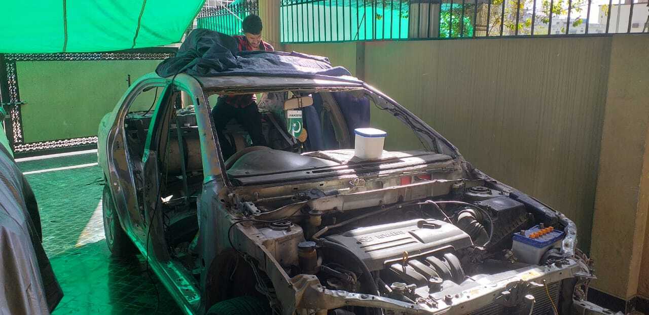

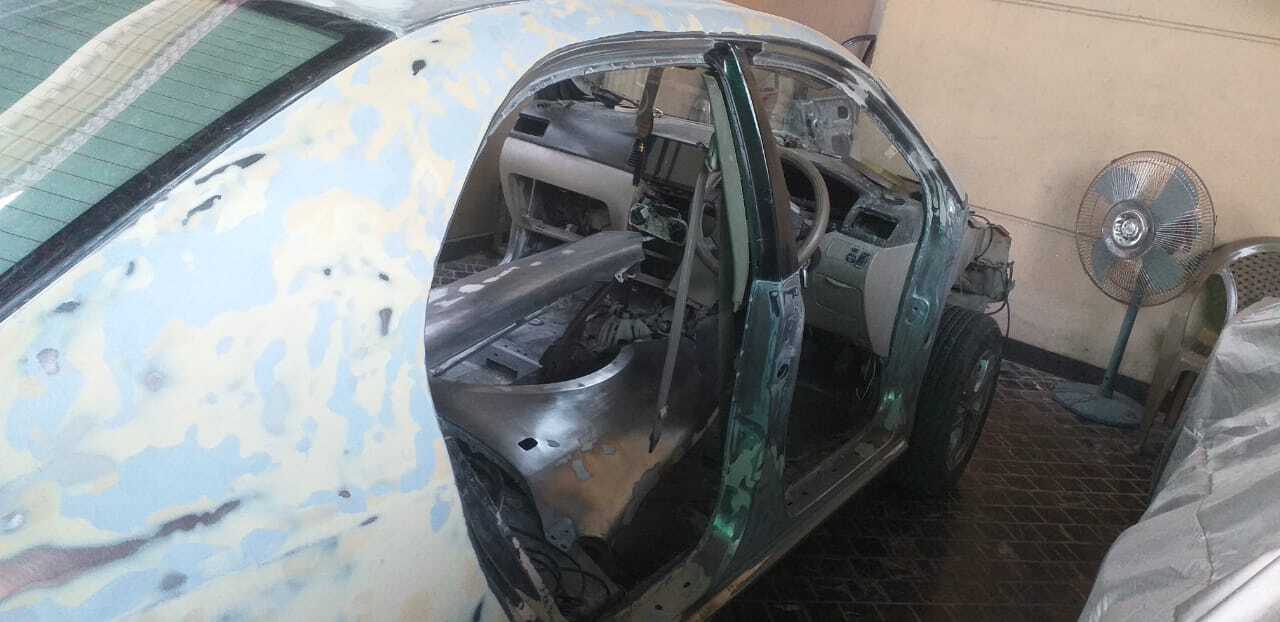

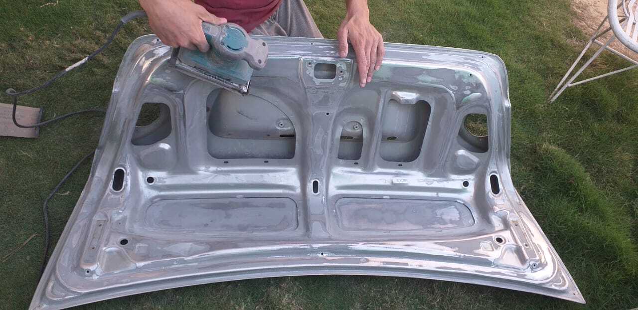

bonnet and trunk removed for tomorrow,,,,,,,
What an awesome DIY and what a gigantic project. Awesome!
a DIY, yet so much attention to detail. @agoodfriend Godspeed

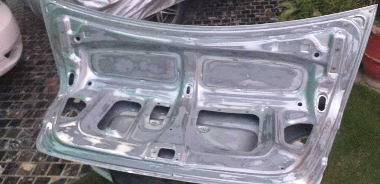

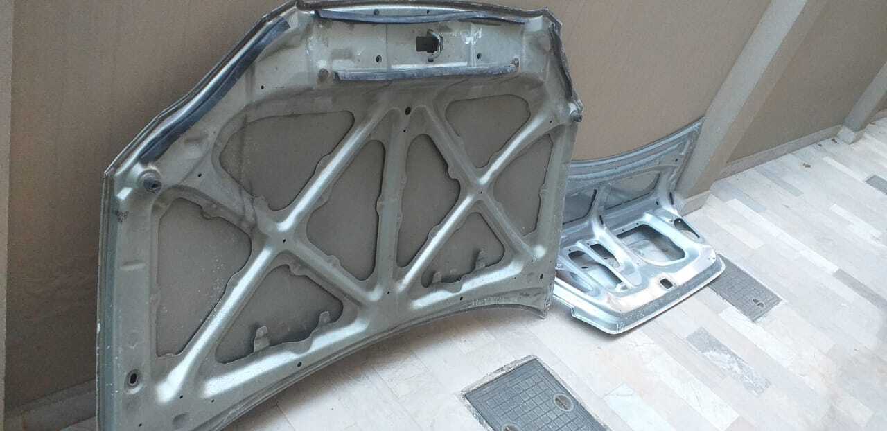

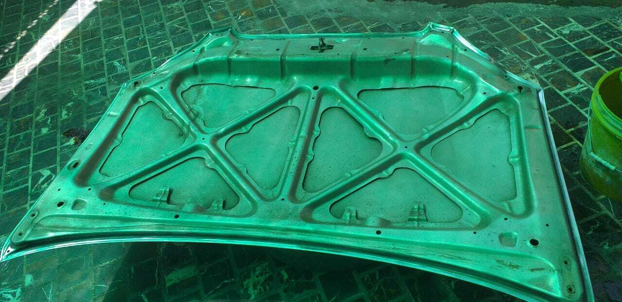

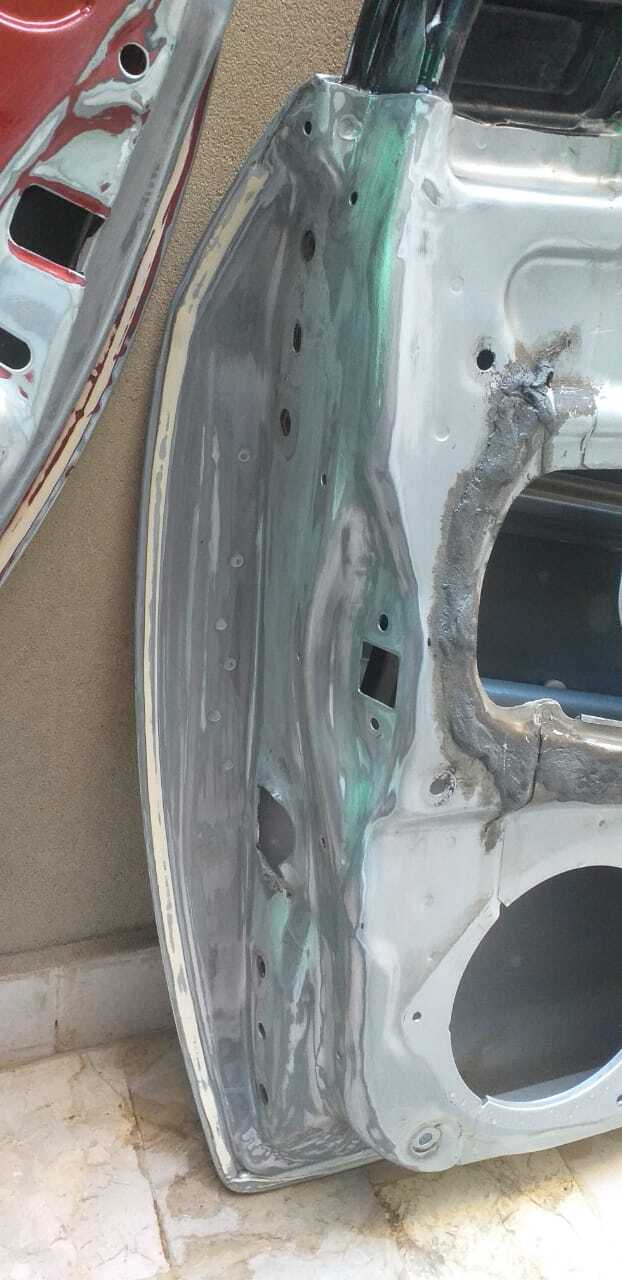

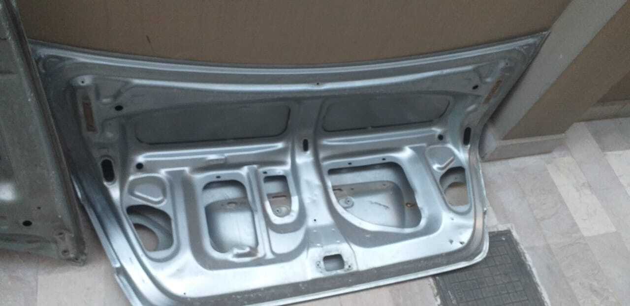

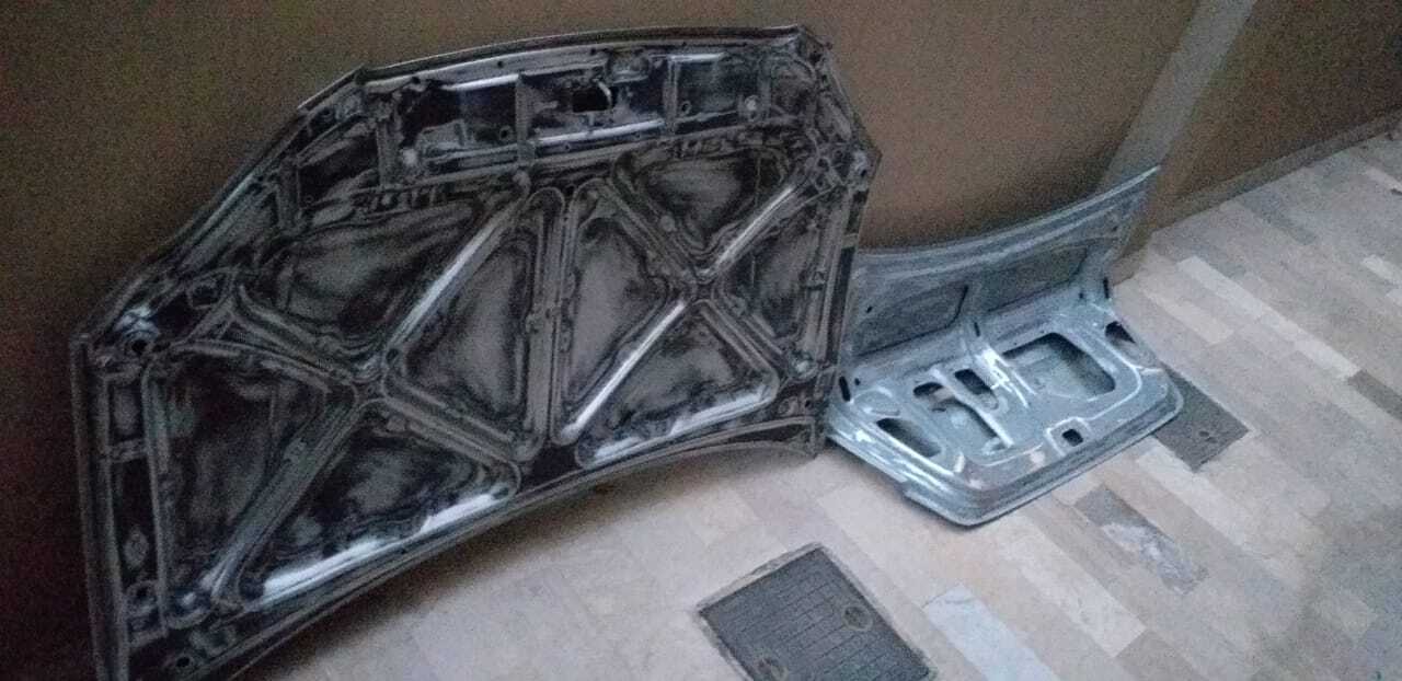

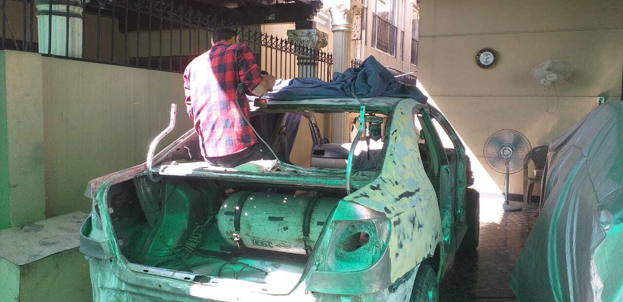

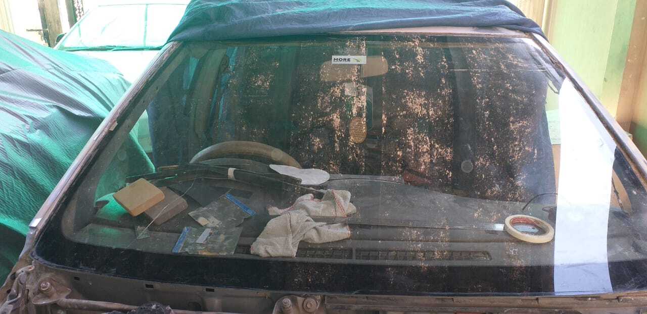

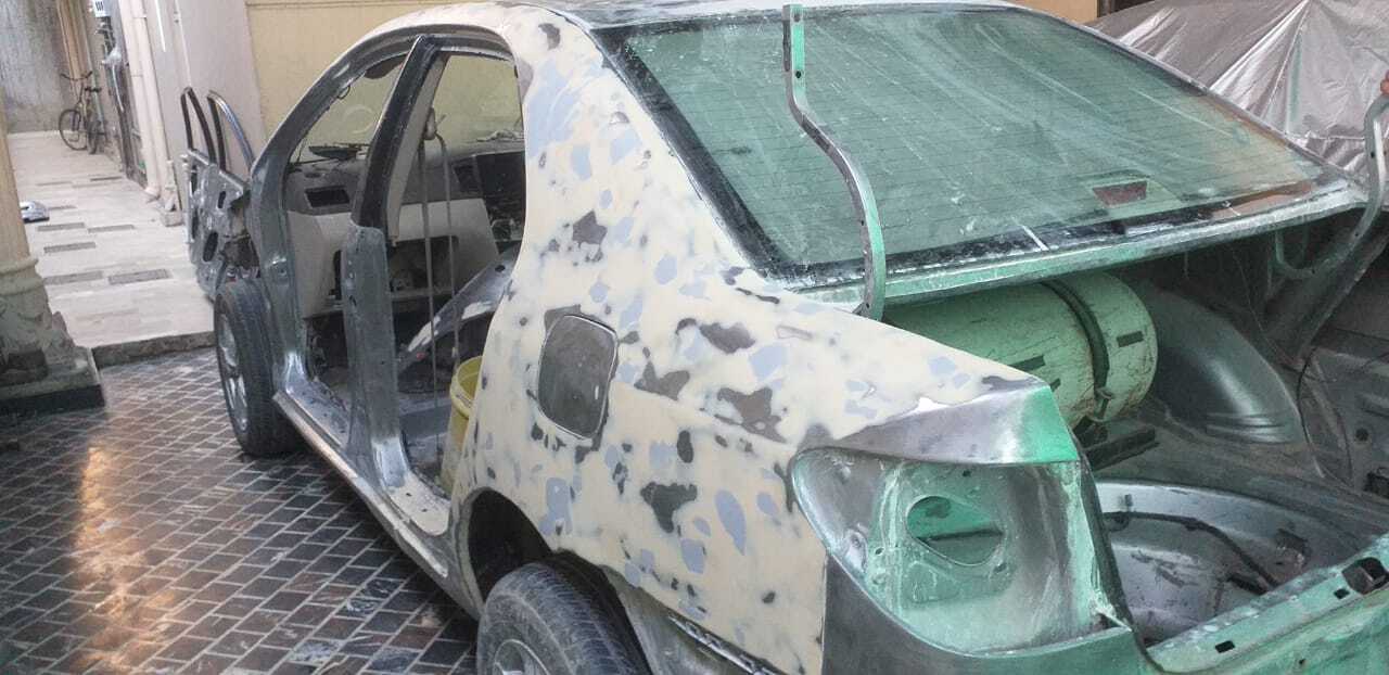

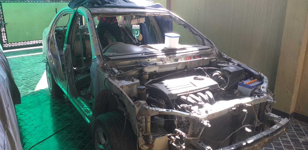

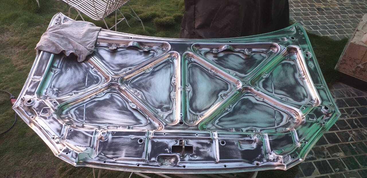

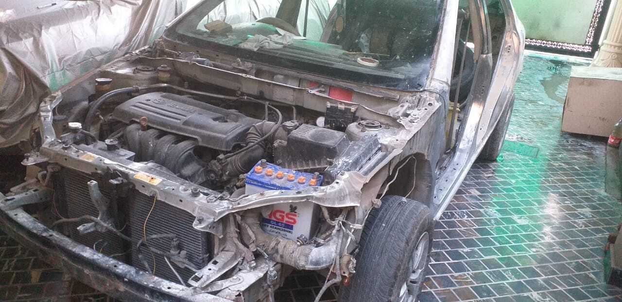

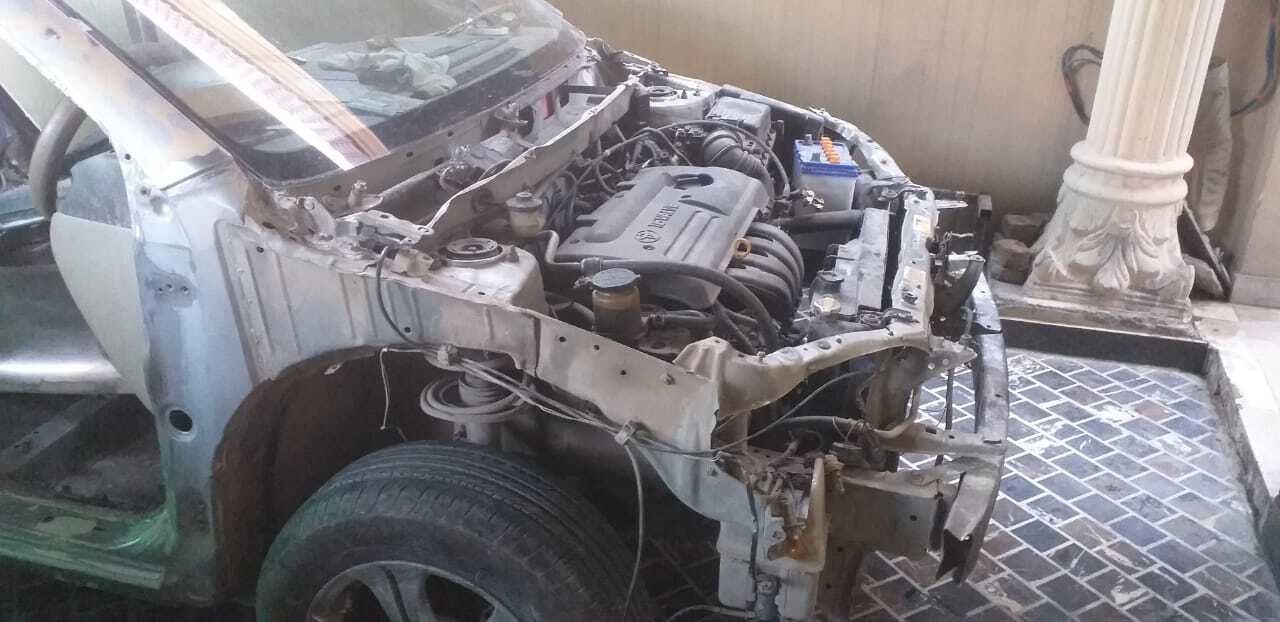

bonnet and trunk lid scuffed from inside ,,, next is to remove windshields ,,,,,,,,

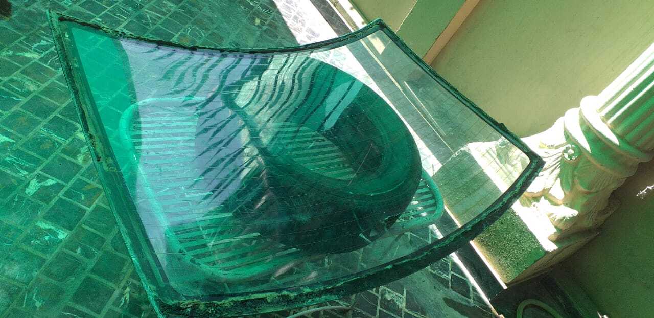

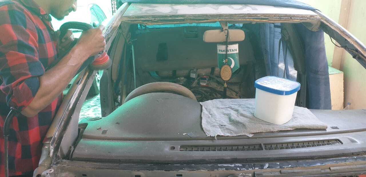

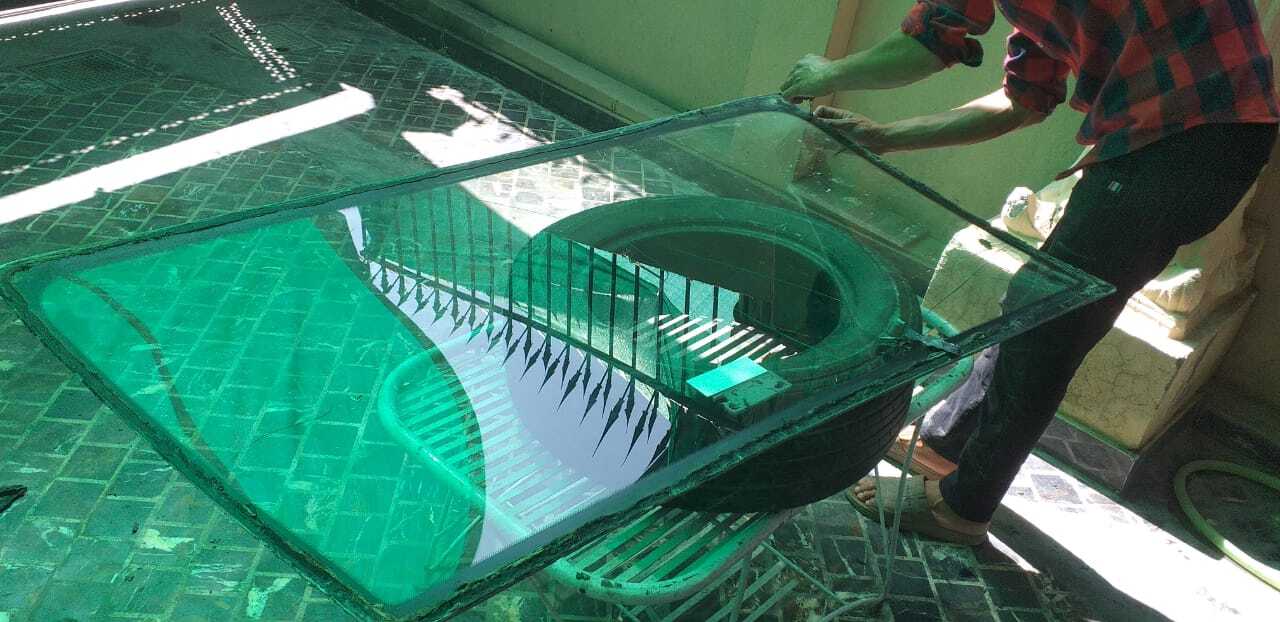

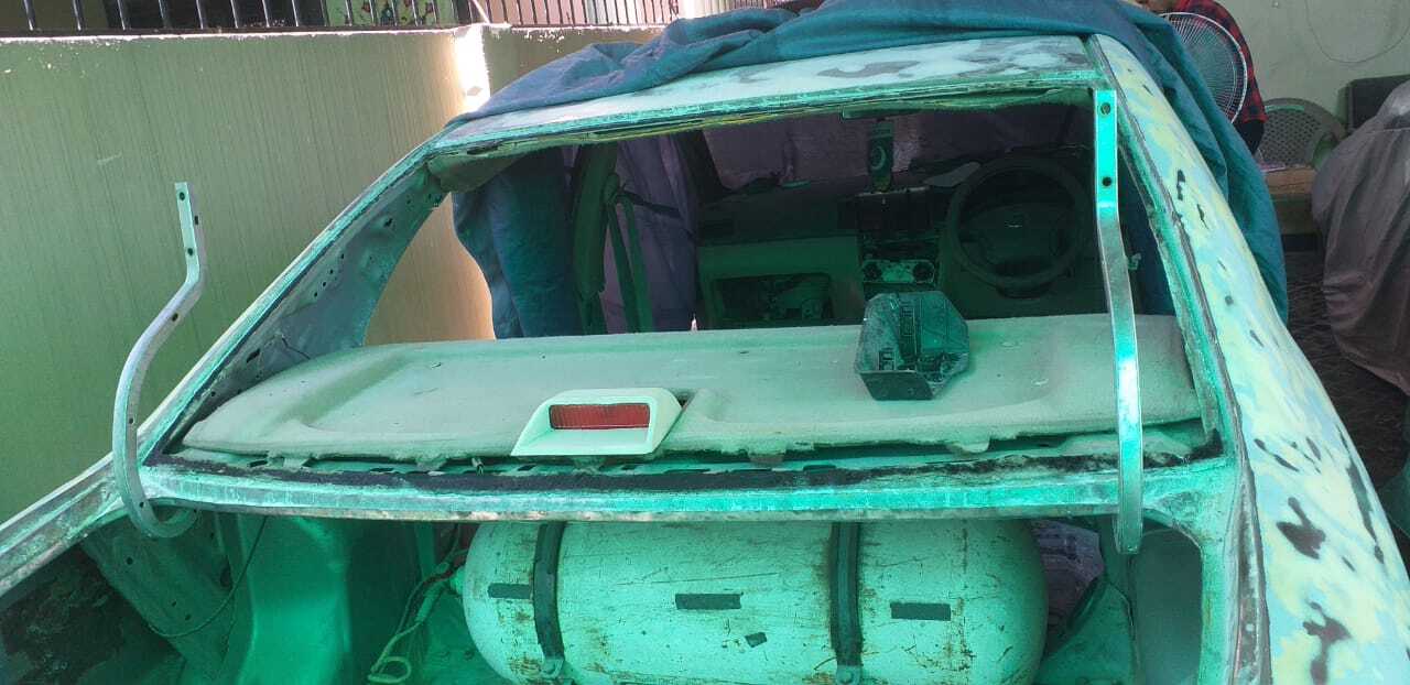

removed both windshields ,,,,,,,,,

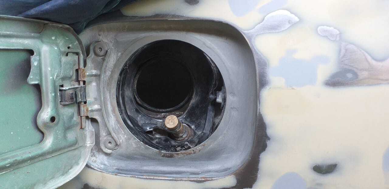

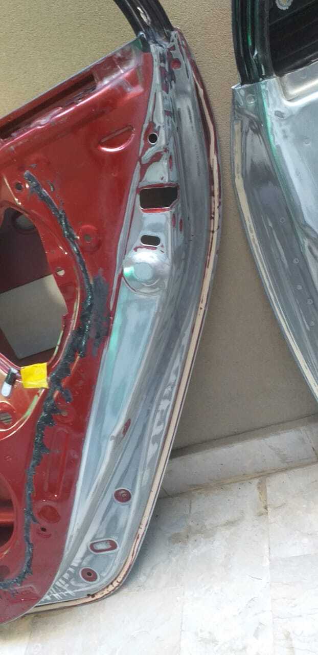

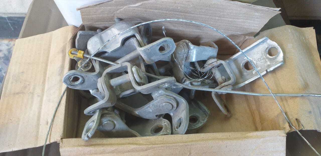

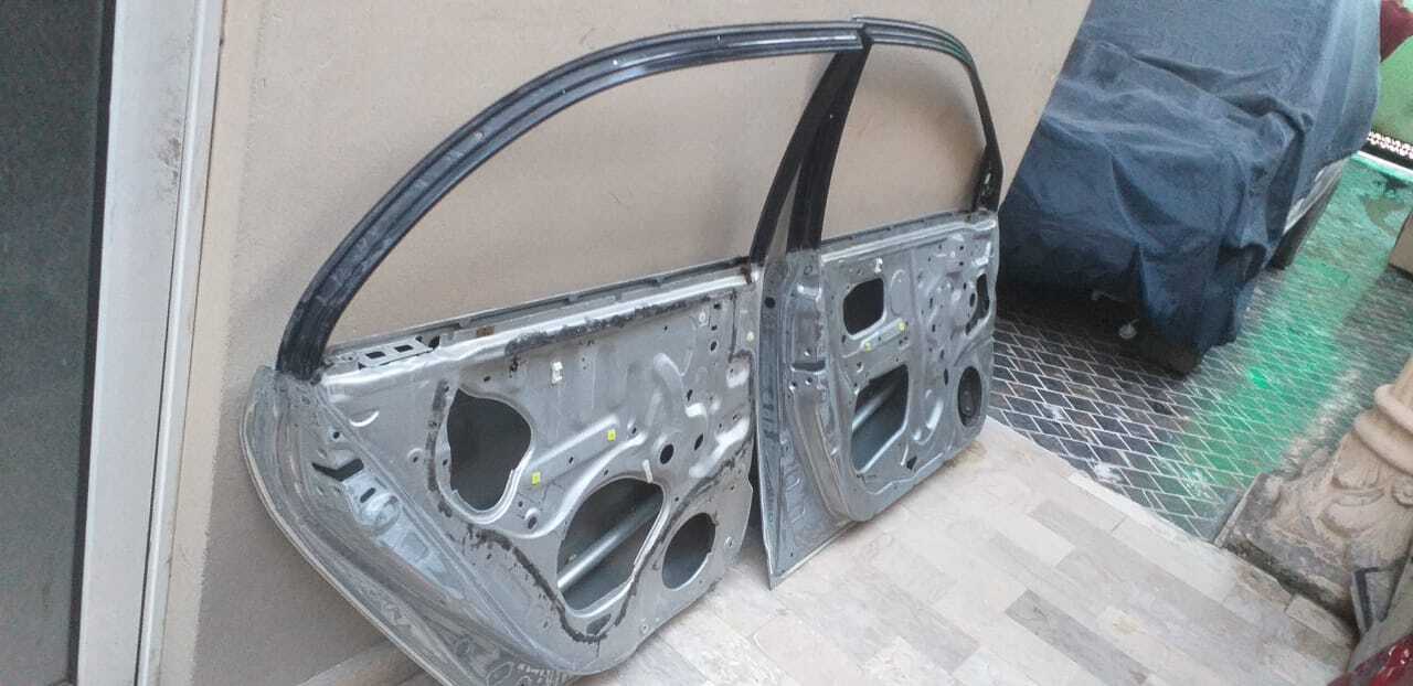

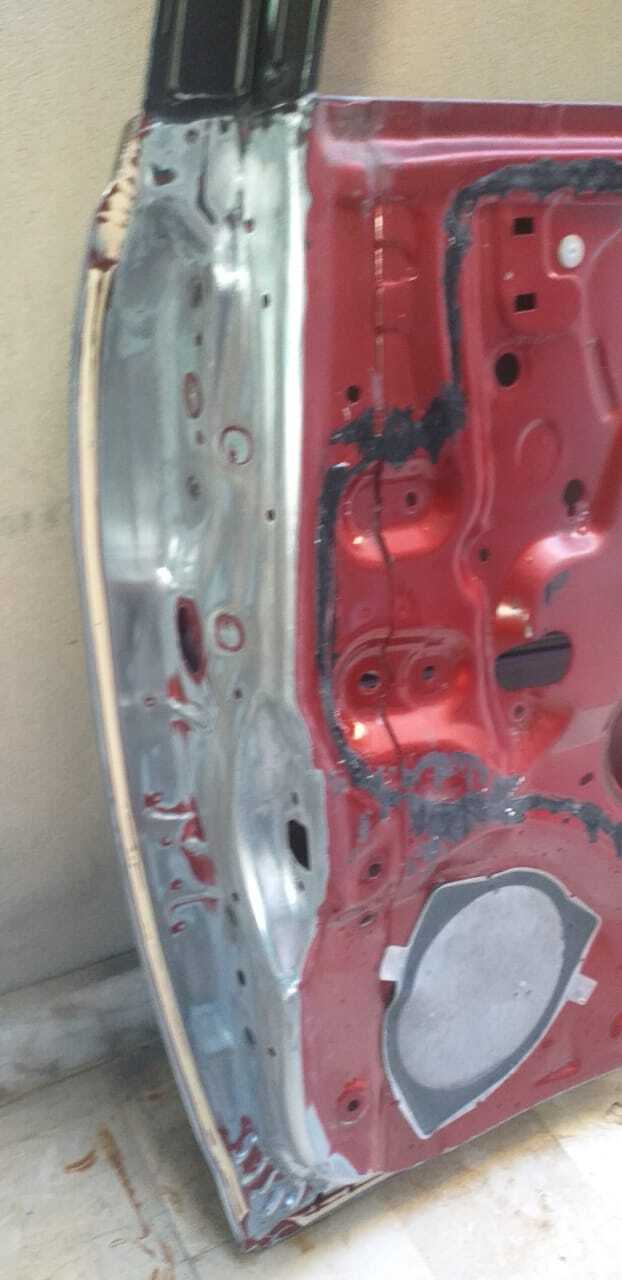

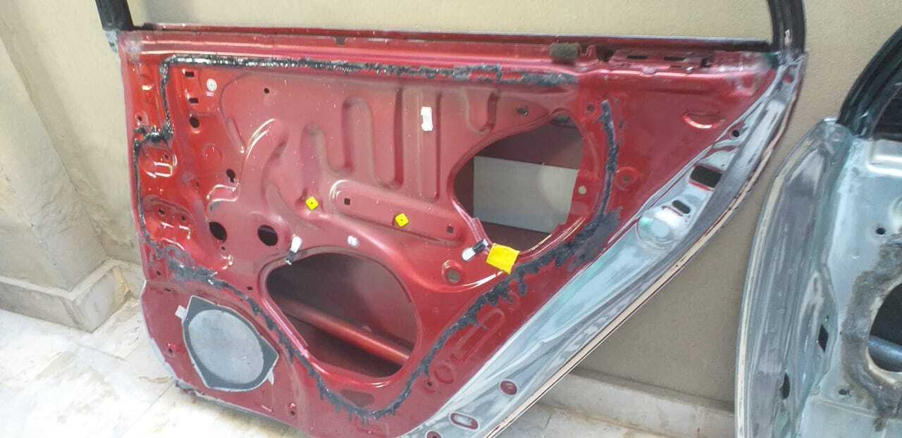

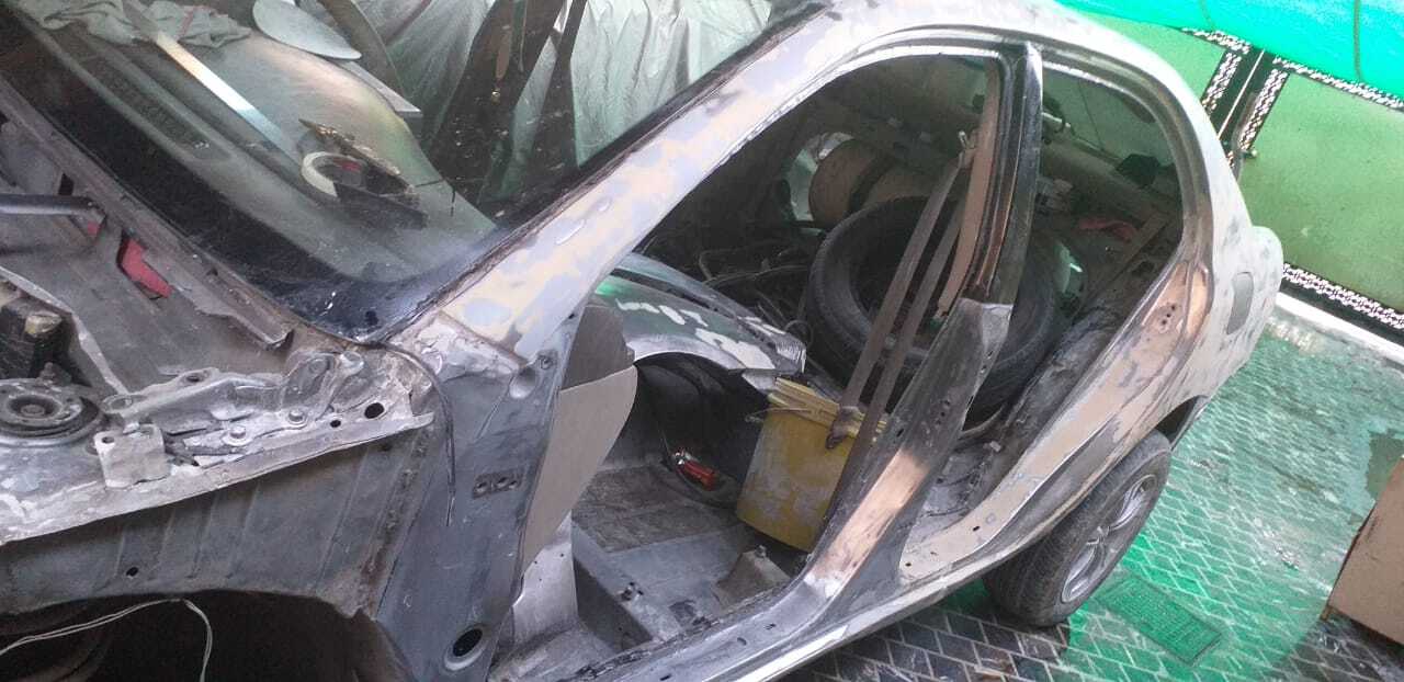

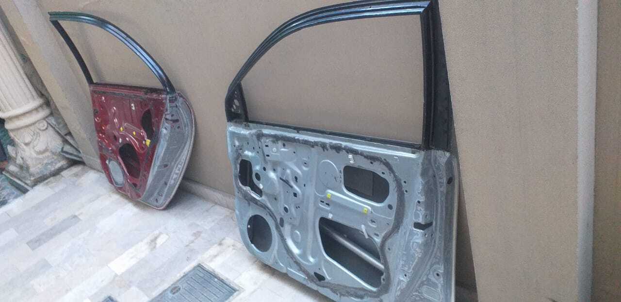

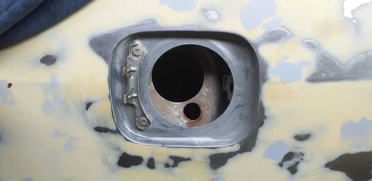

cleaning these door hinges is a big task ,, need paint stripper ,,,,,,

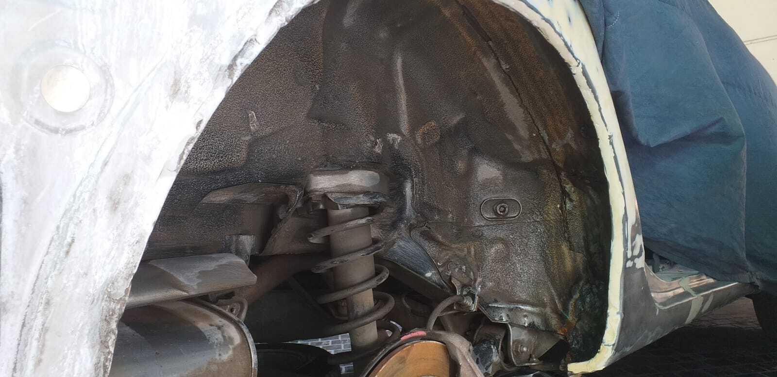

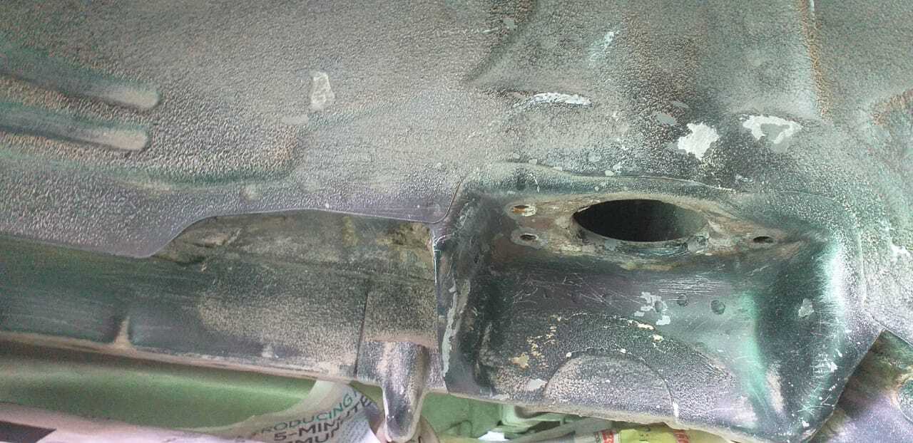

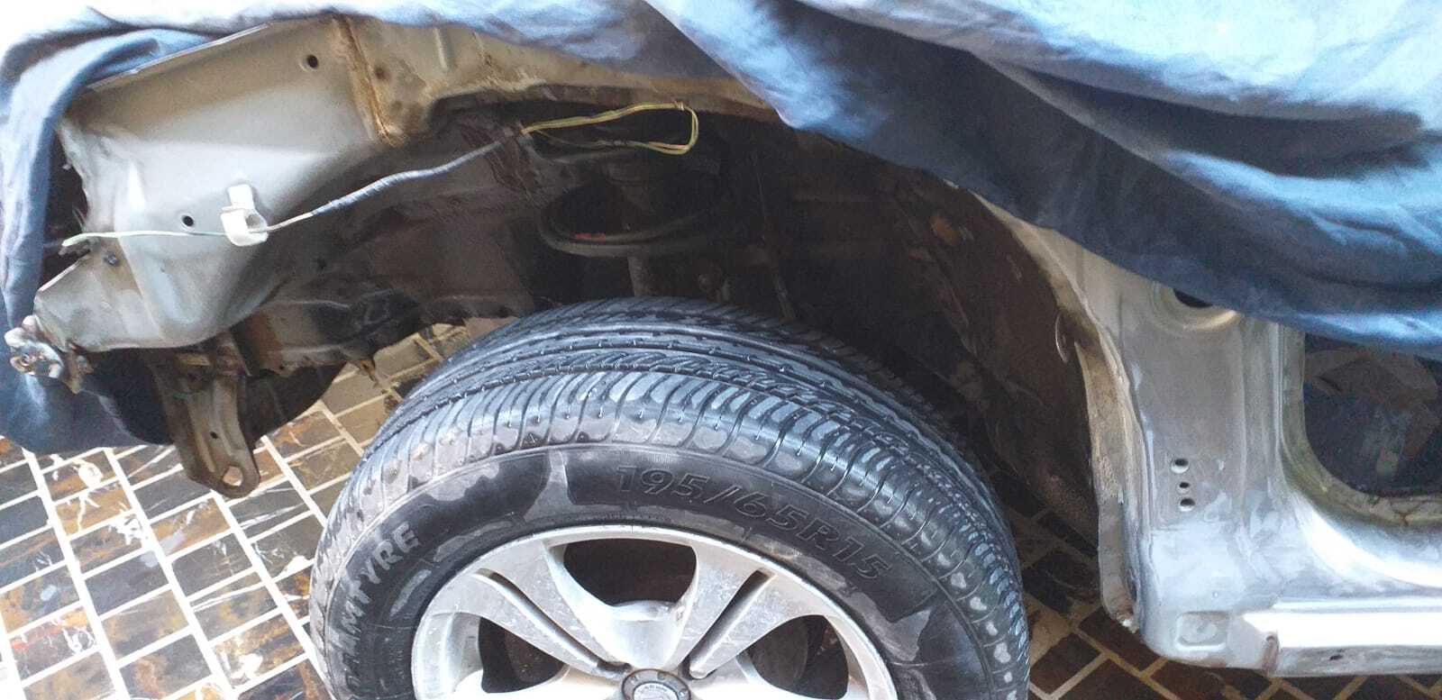

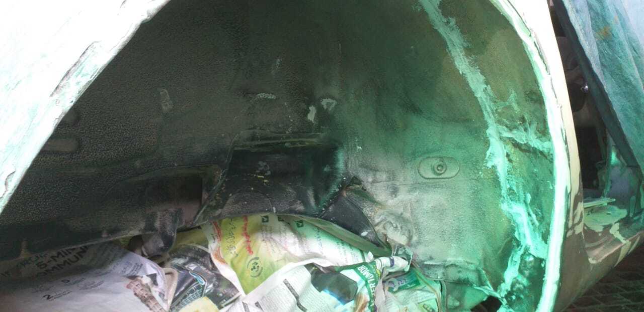

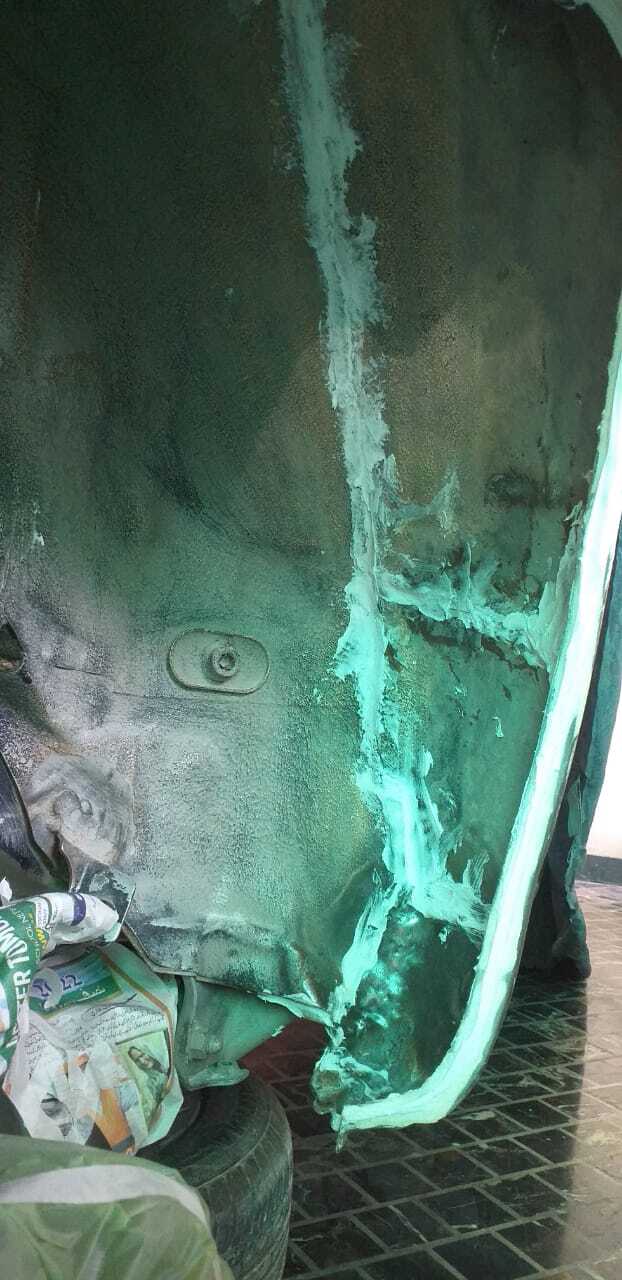

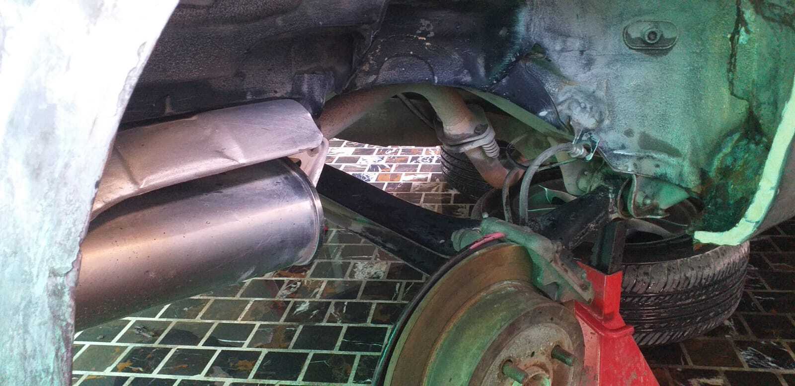

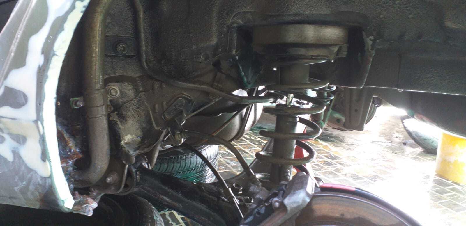

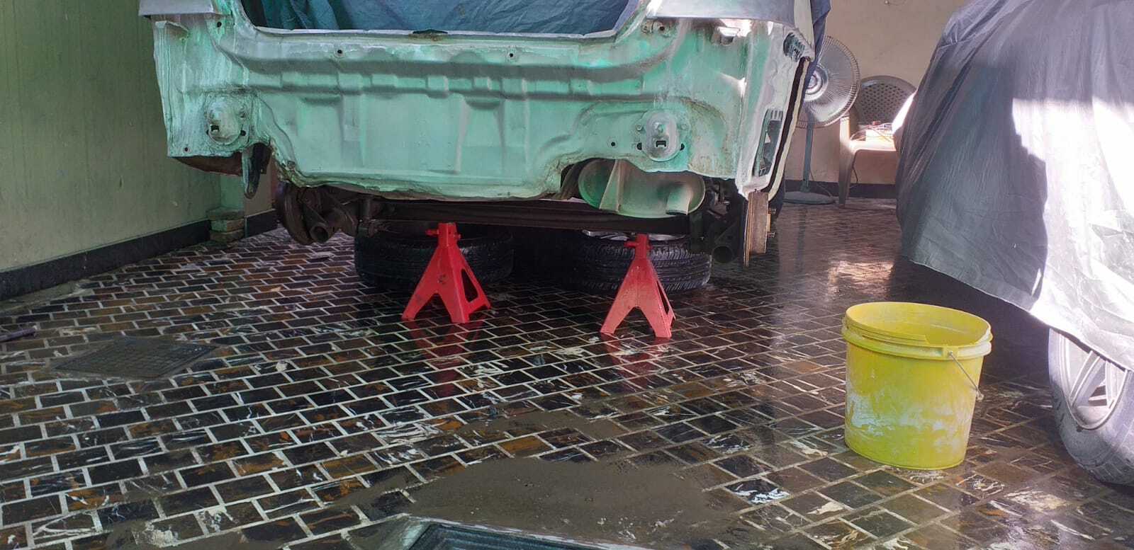

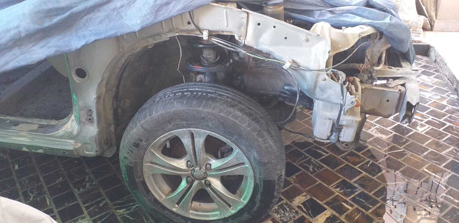

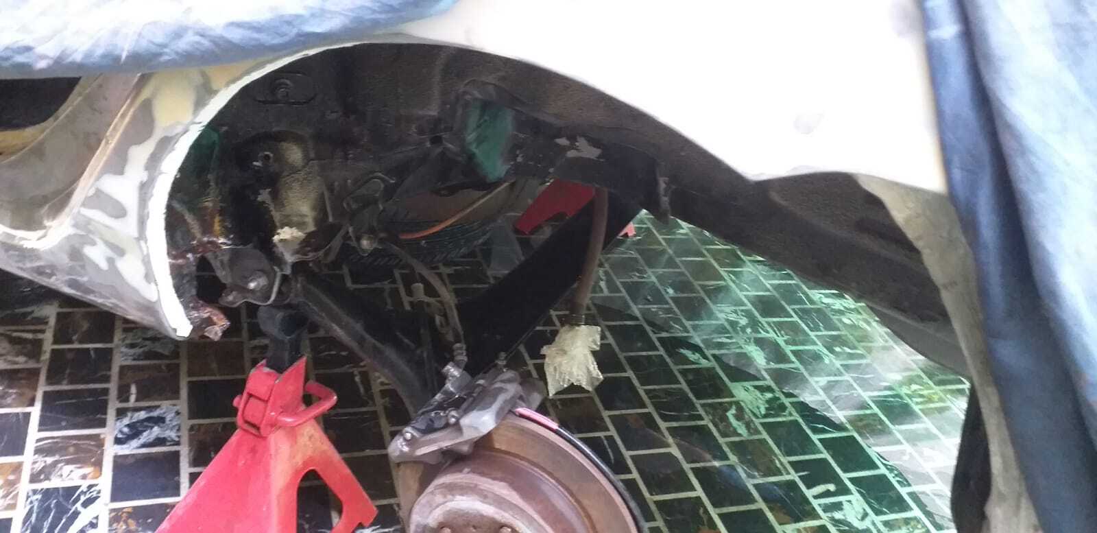

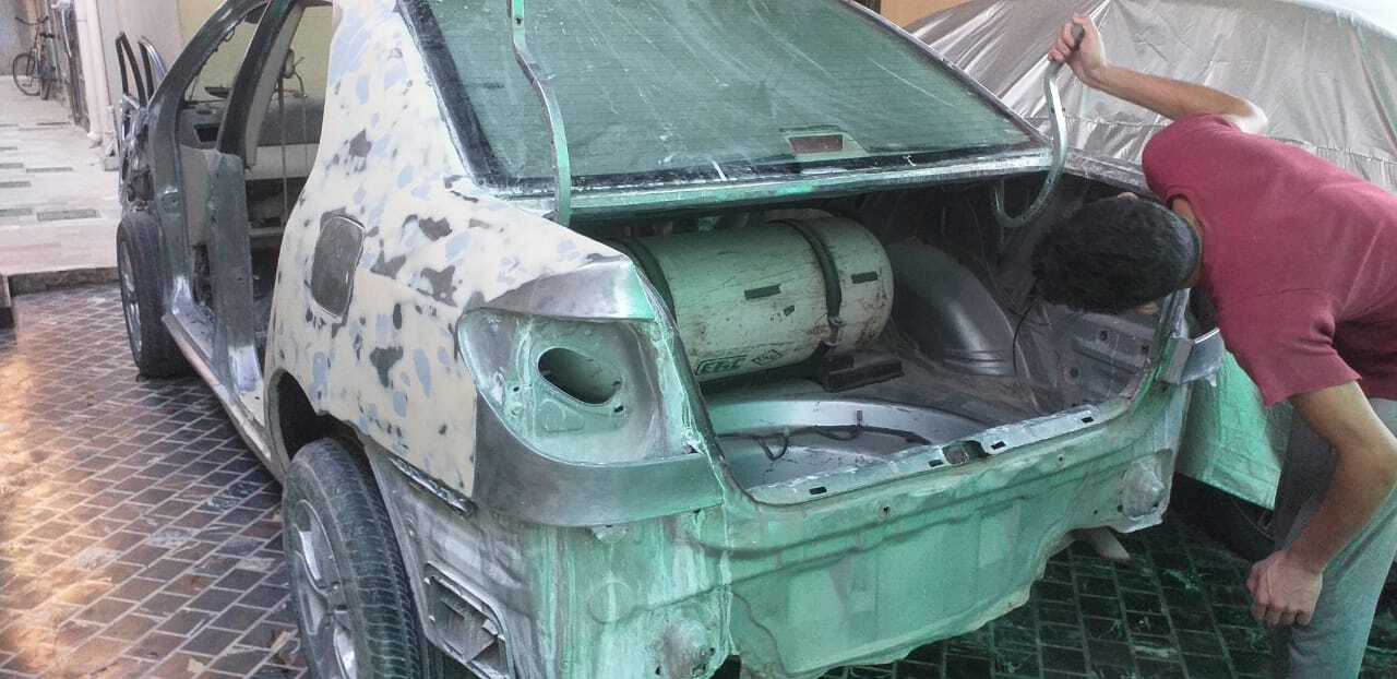

cleaned rear wheel arches ,,, to prepare them for under coating ,,,,,,,,
I cant even think to start this on my own ... very appreciated man
Great effort brother just one thing, have the wheel arch properly fixed using sheet metal. The putty would not stay for long and you'll end up with paint chirping off it in no time. Wish you the best!
Nice work

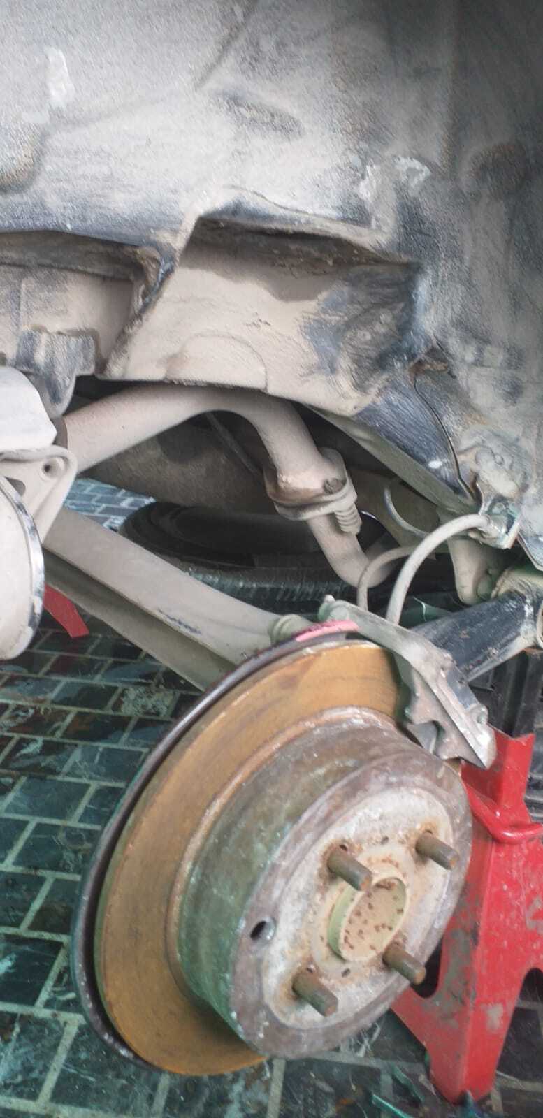

i use acrylic sealer in metal joints and then spray with ABRO under coating ,,,,,,,

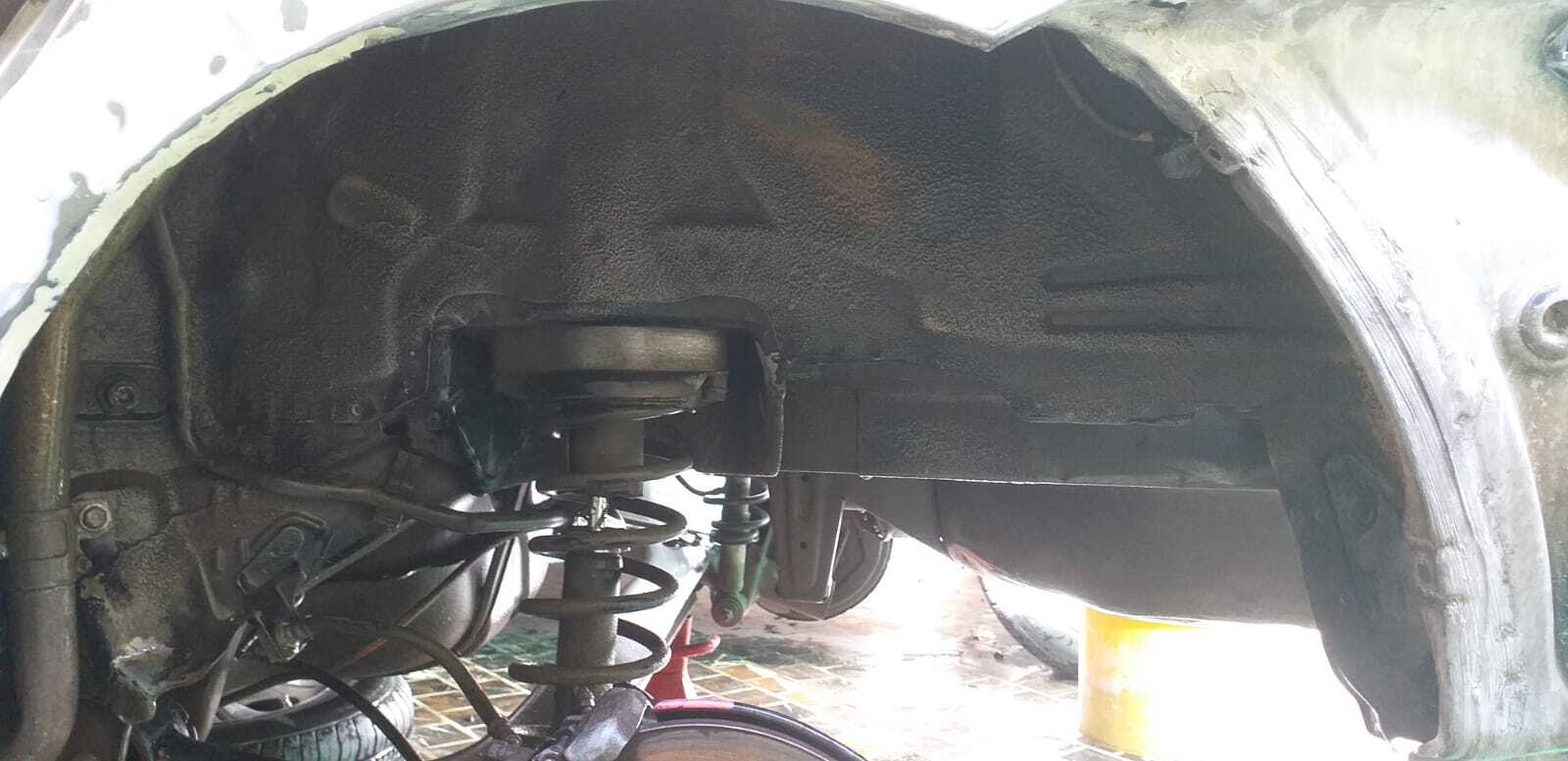

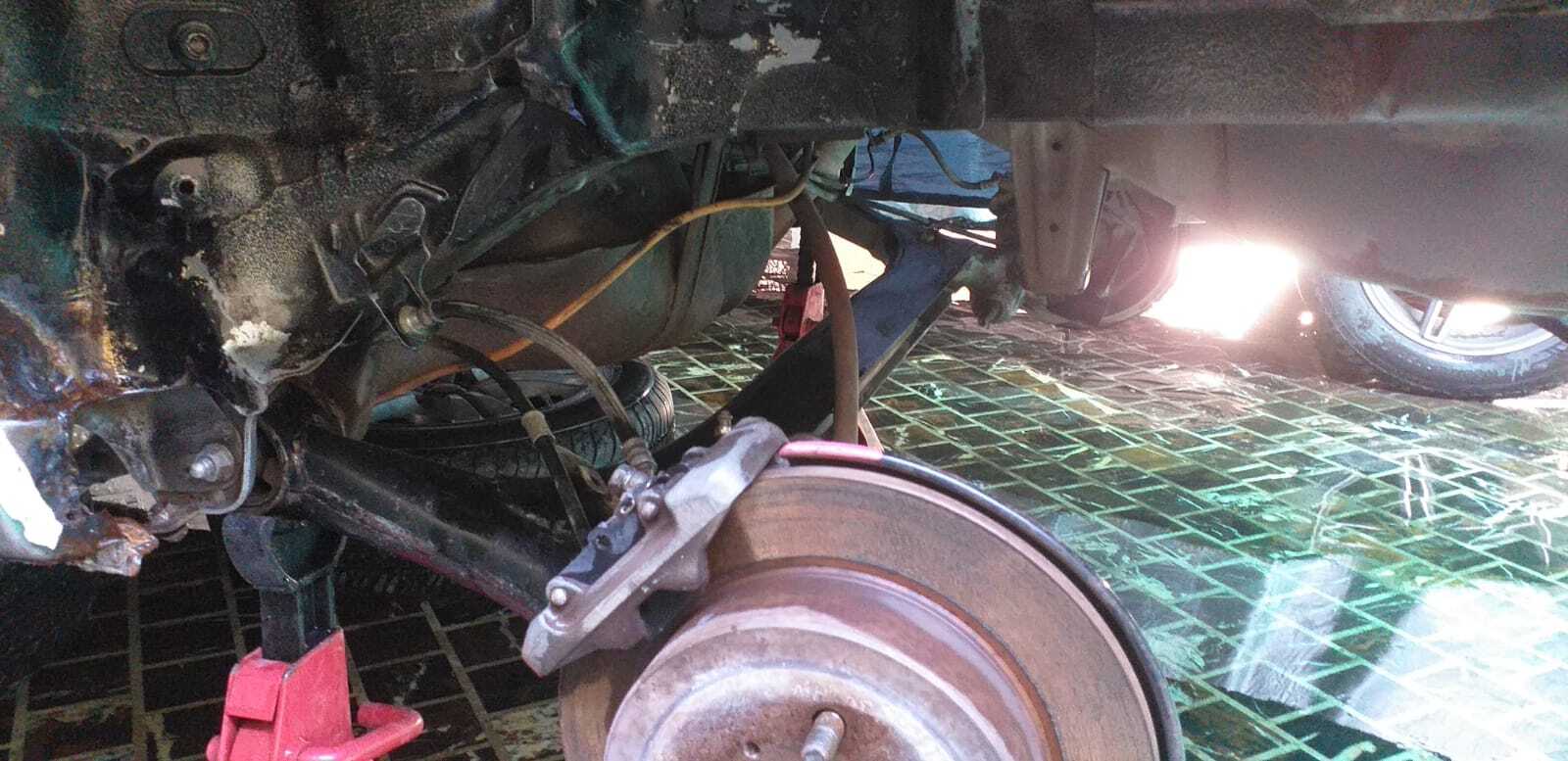

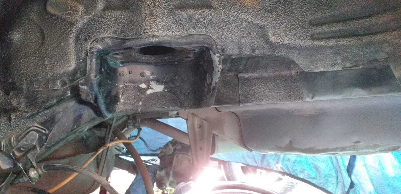

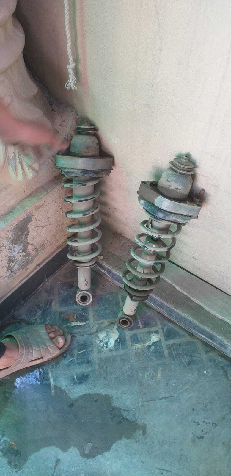

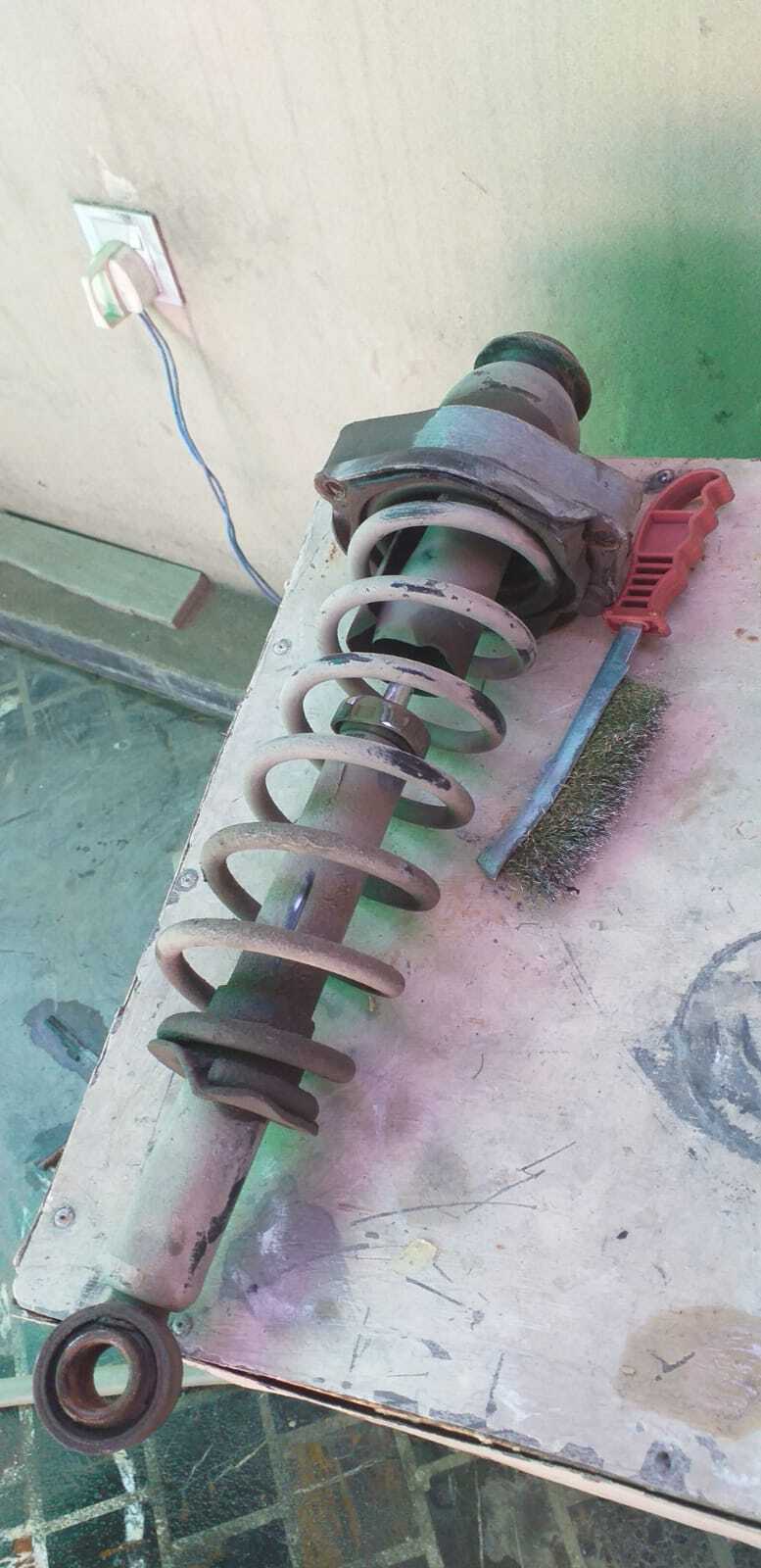

washed rear wheel arches and remove rear shocks so that all area can be spray with under coating ,,,,,,,
