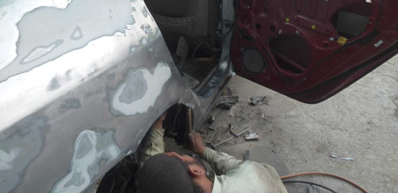

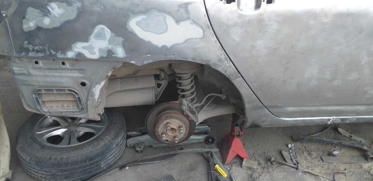

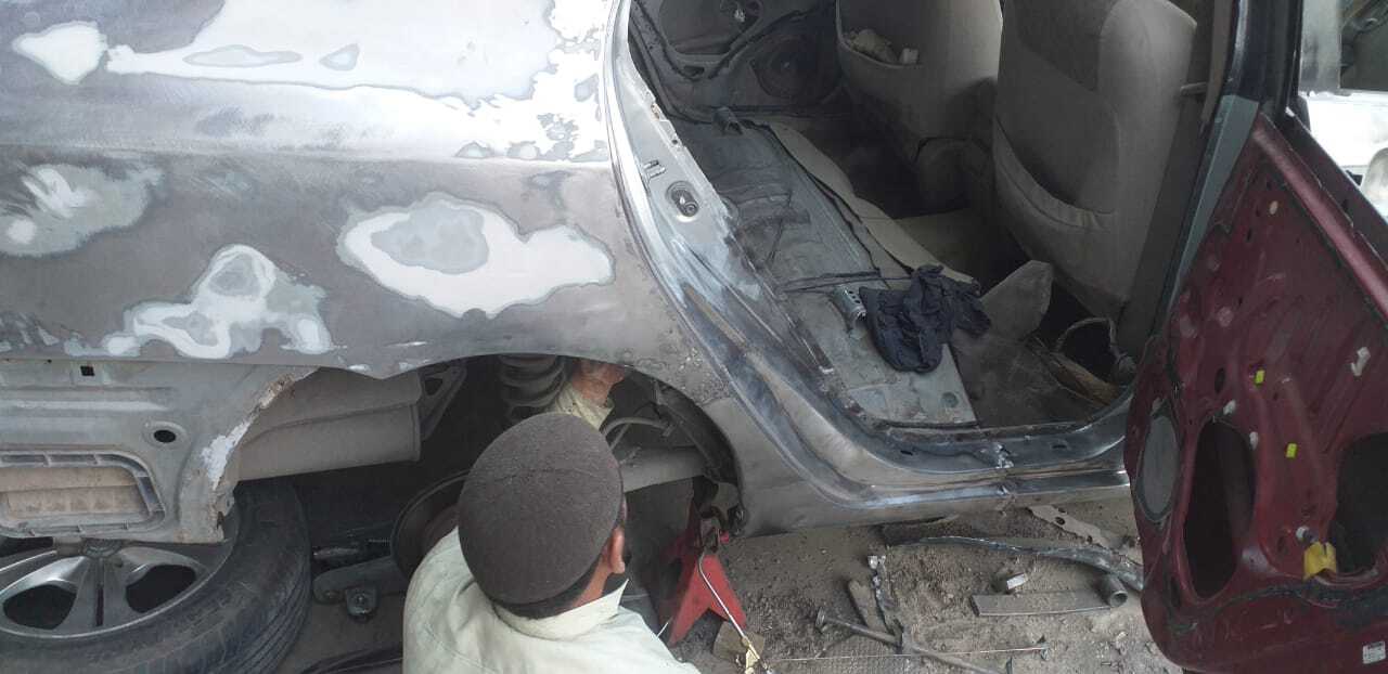

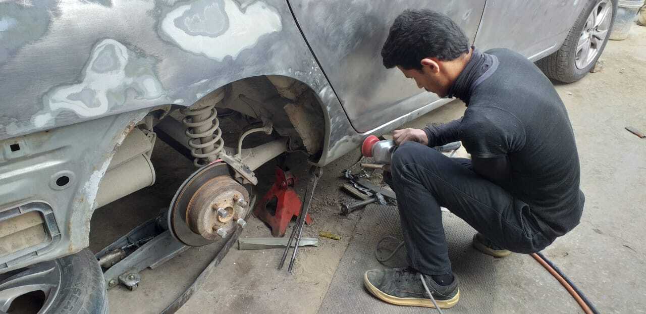

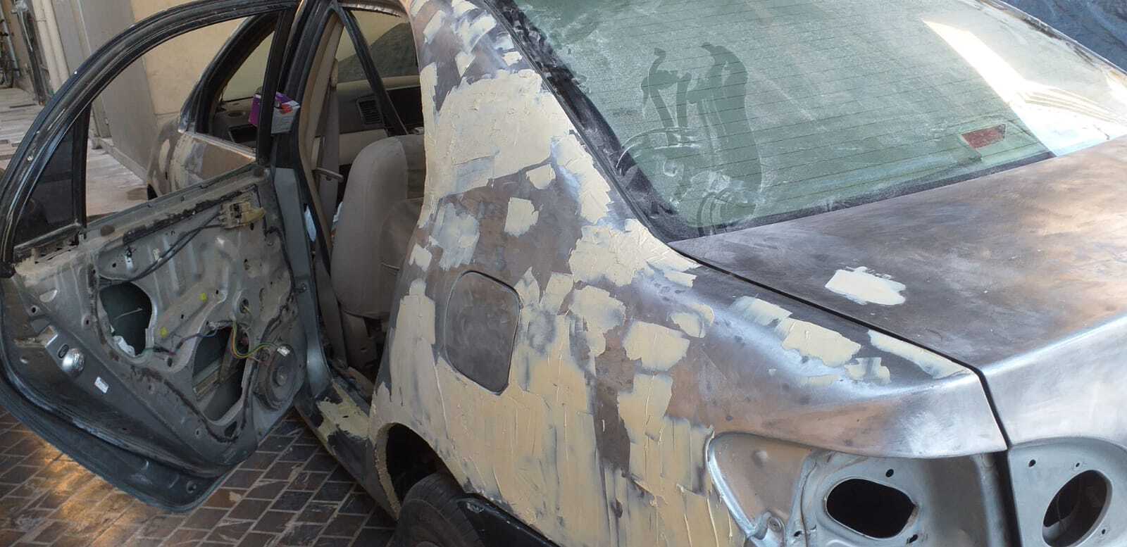

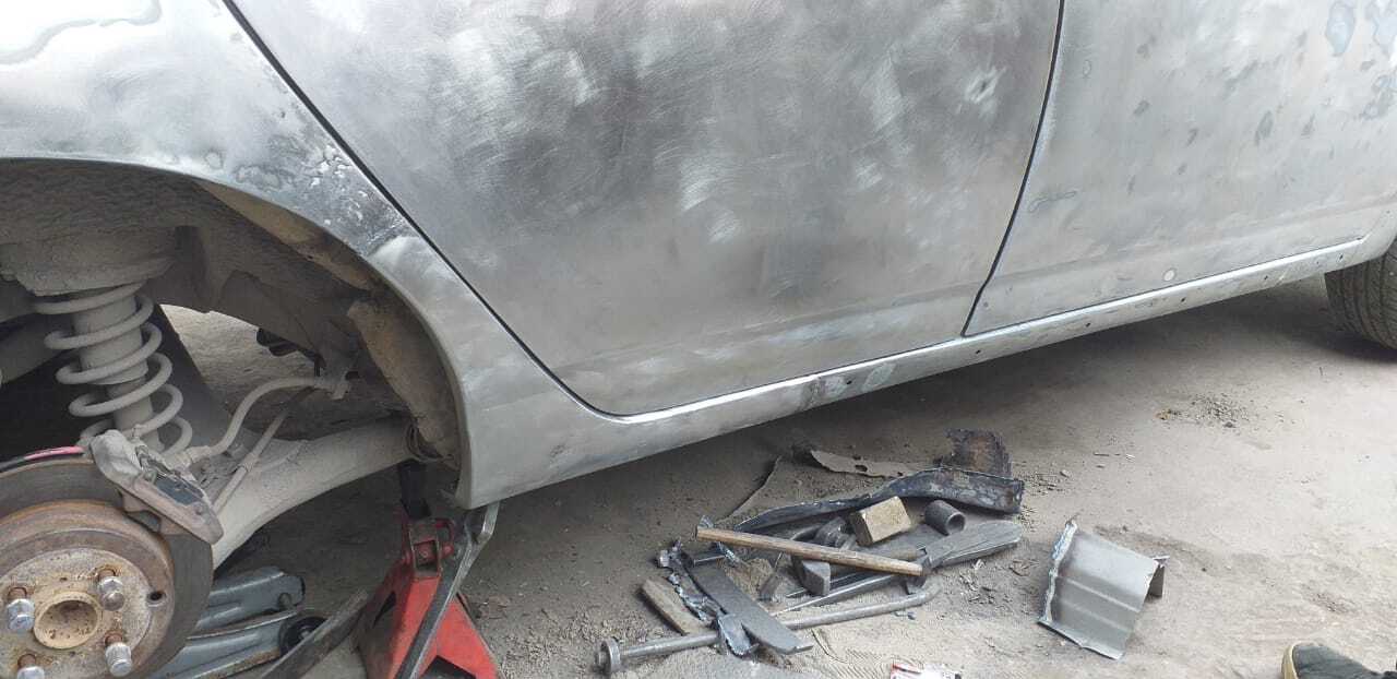

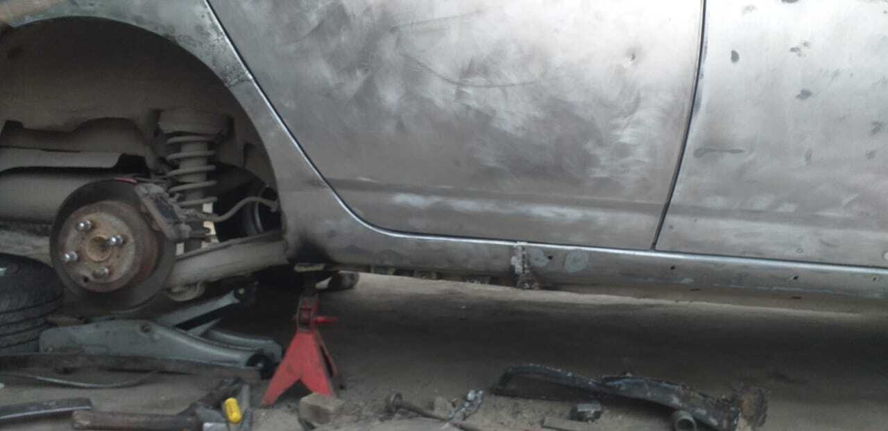

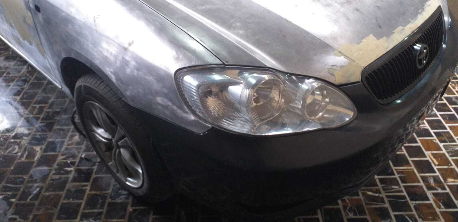

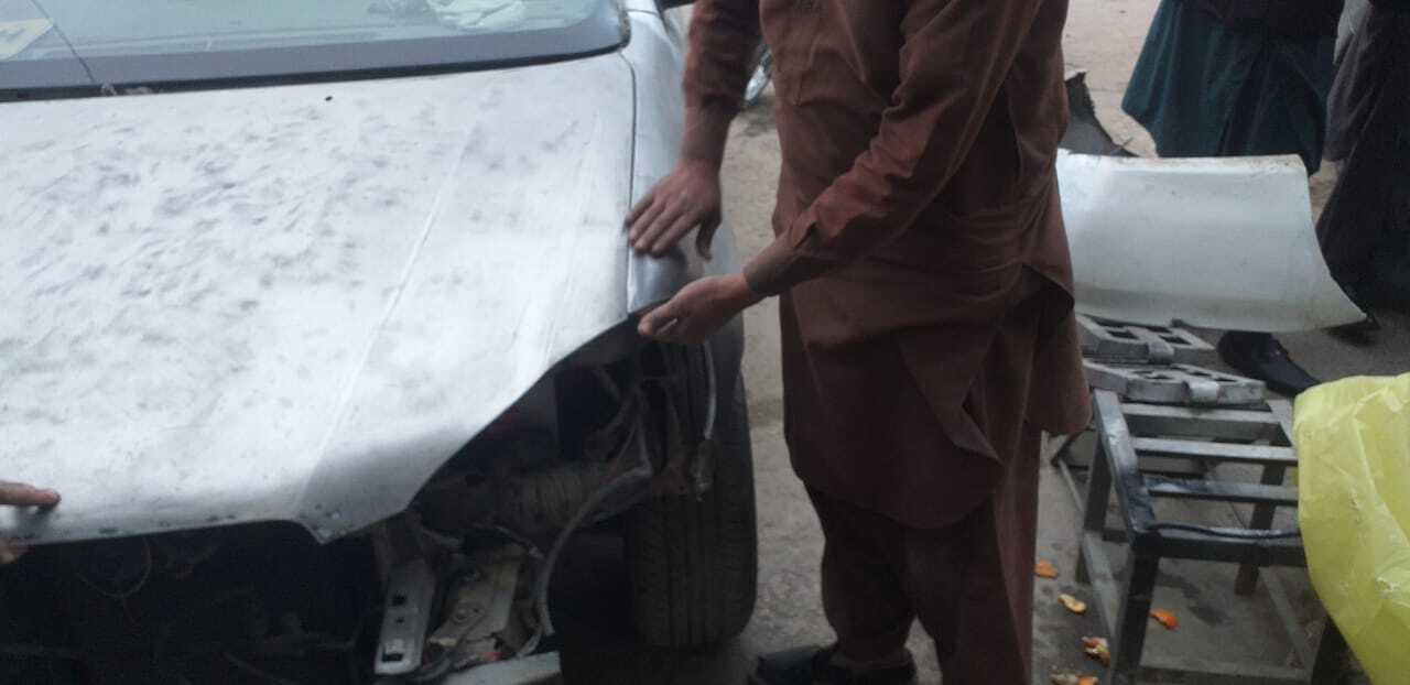

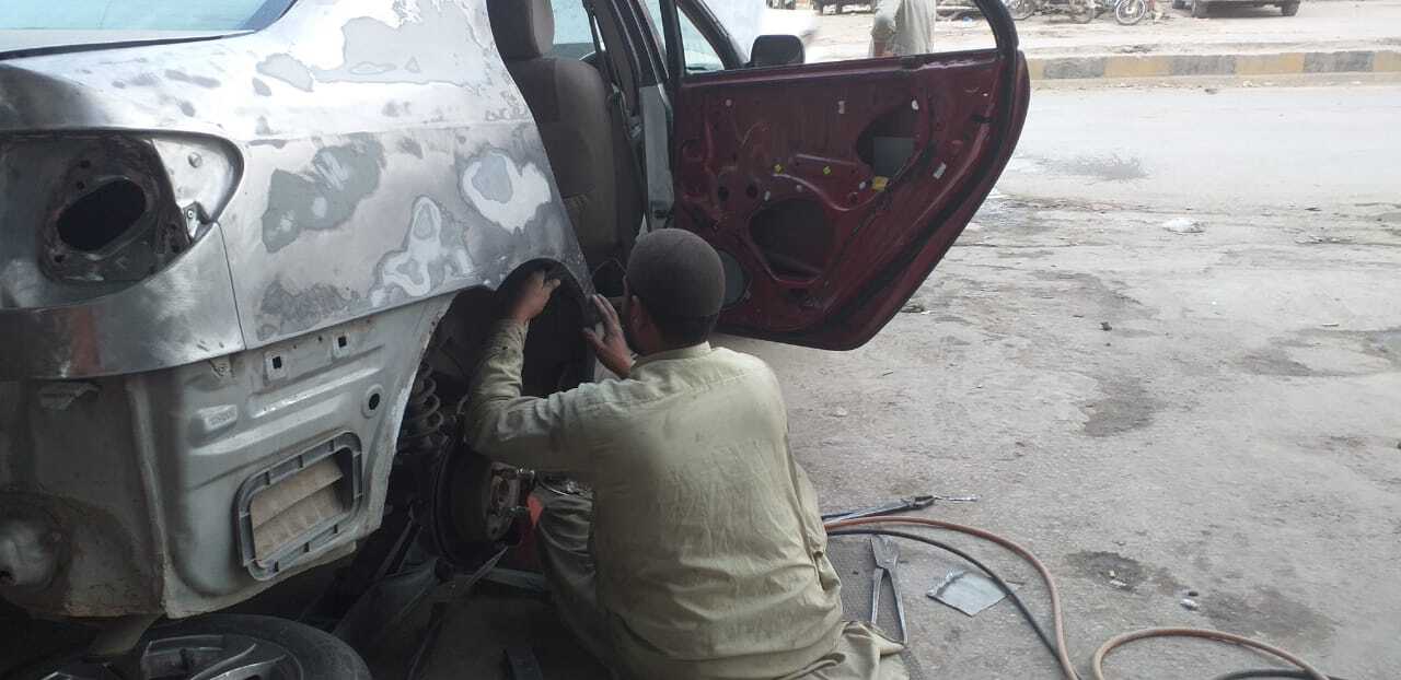

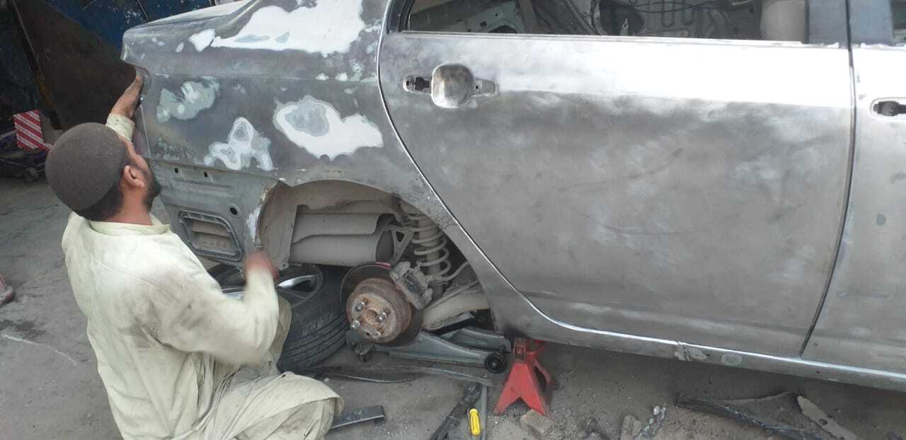

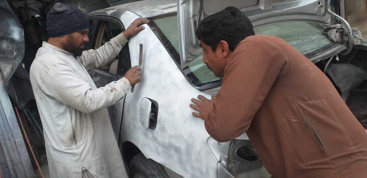

done on one side,,,,,,, very difficult to take work from these people ,,,,,, i take my own tools , grinder , polisher , sander , floor jack and jack stand and also assist him in doing all that ,,,,,,

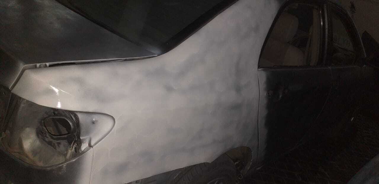

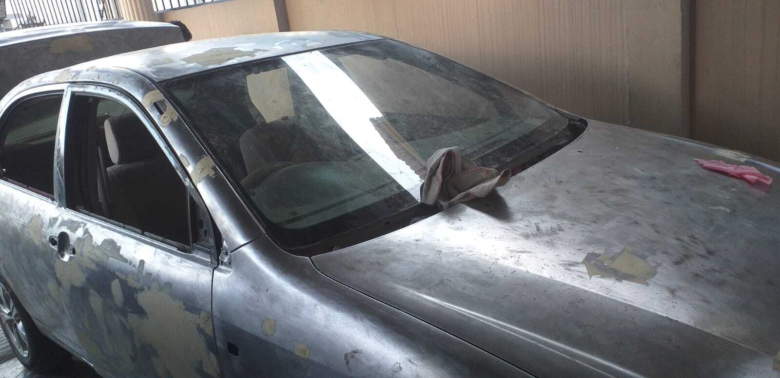

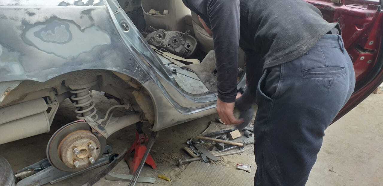

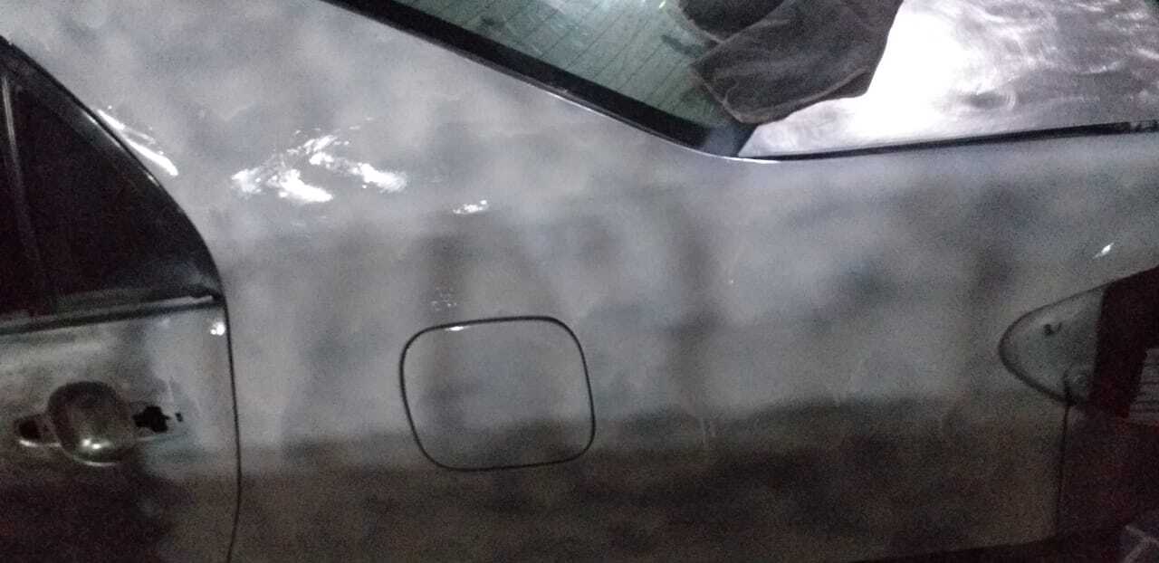

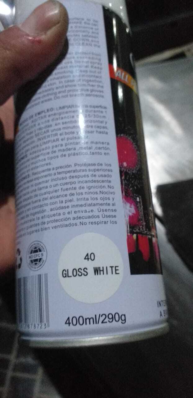

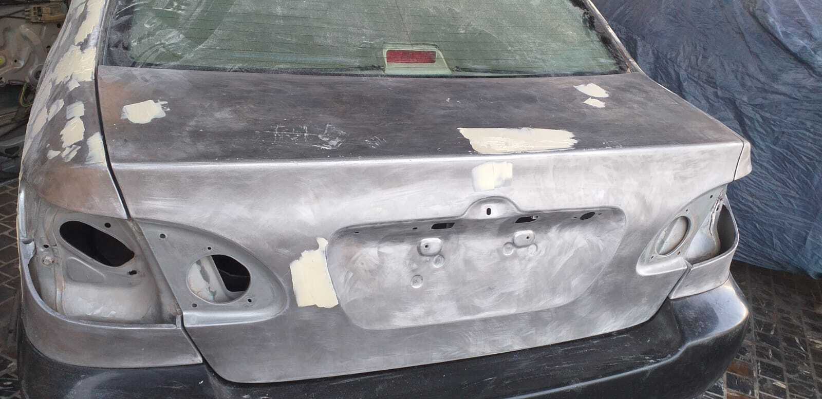

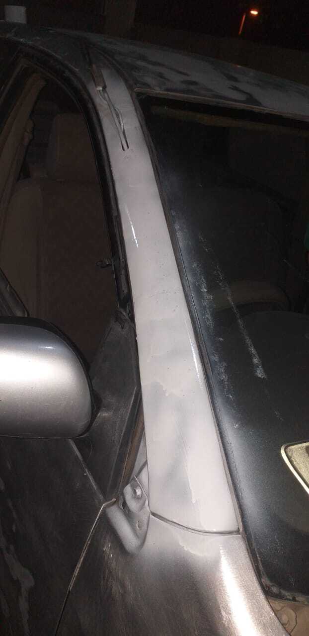

this spray paint will act as a guide coat to see minor ups and downs in pannels ,,,,,,, after giving finish it will be cleaned off ,,,,,,,,,

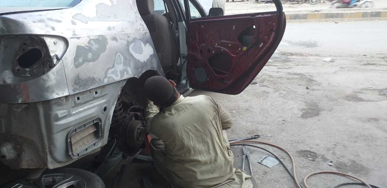

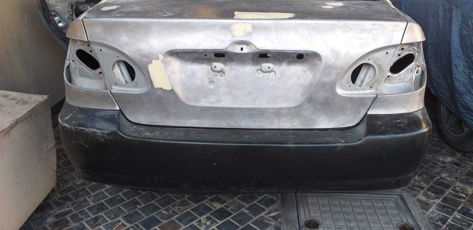

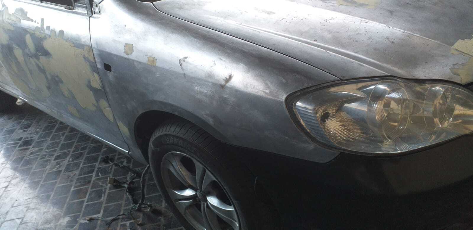

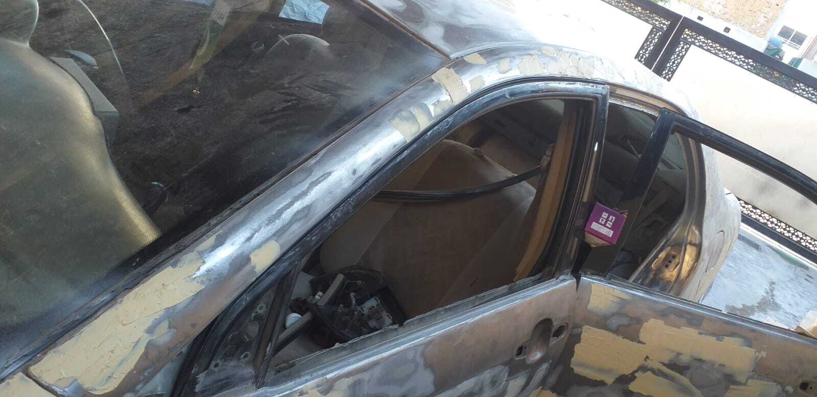

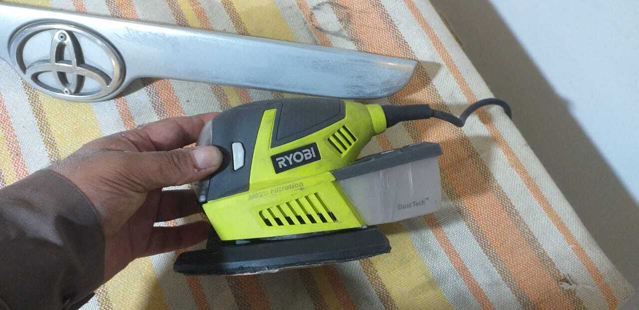

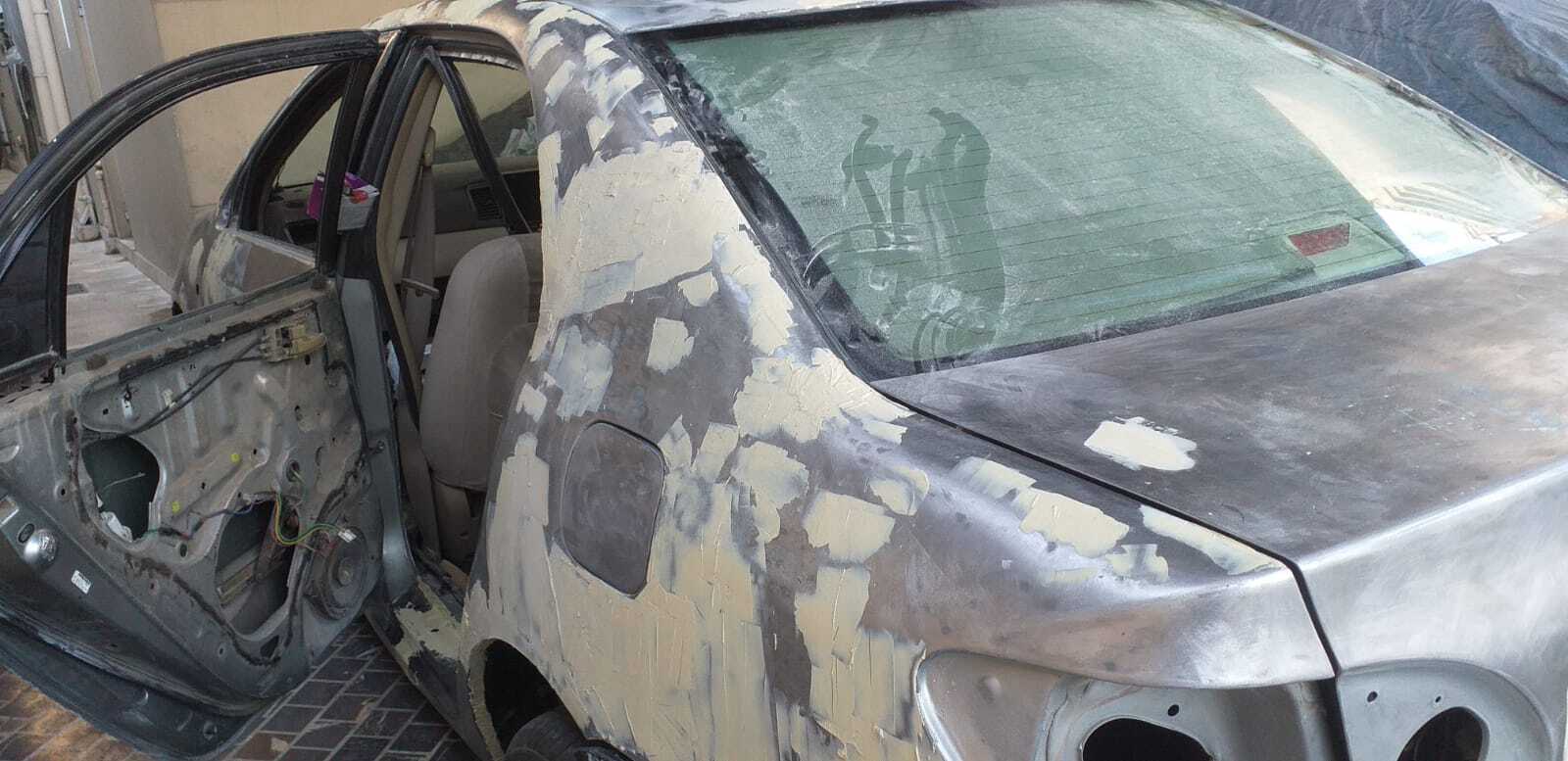

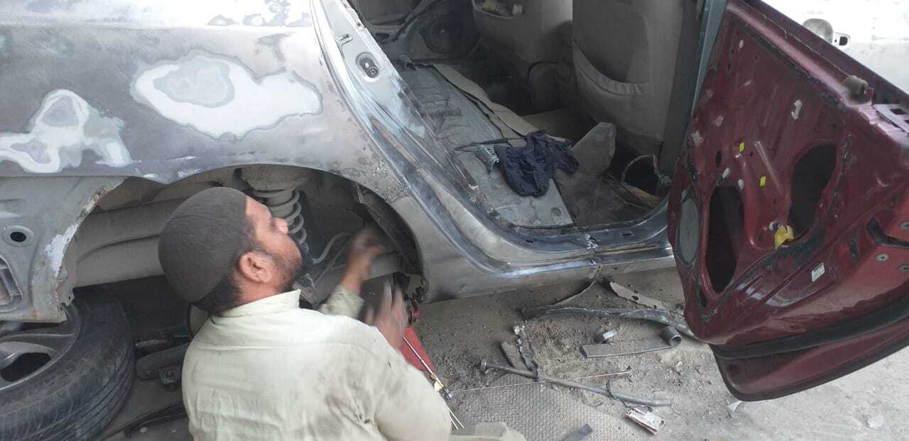

palm sander or mouse sander for cleaning inside doors and A pillars / trunk

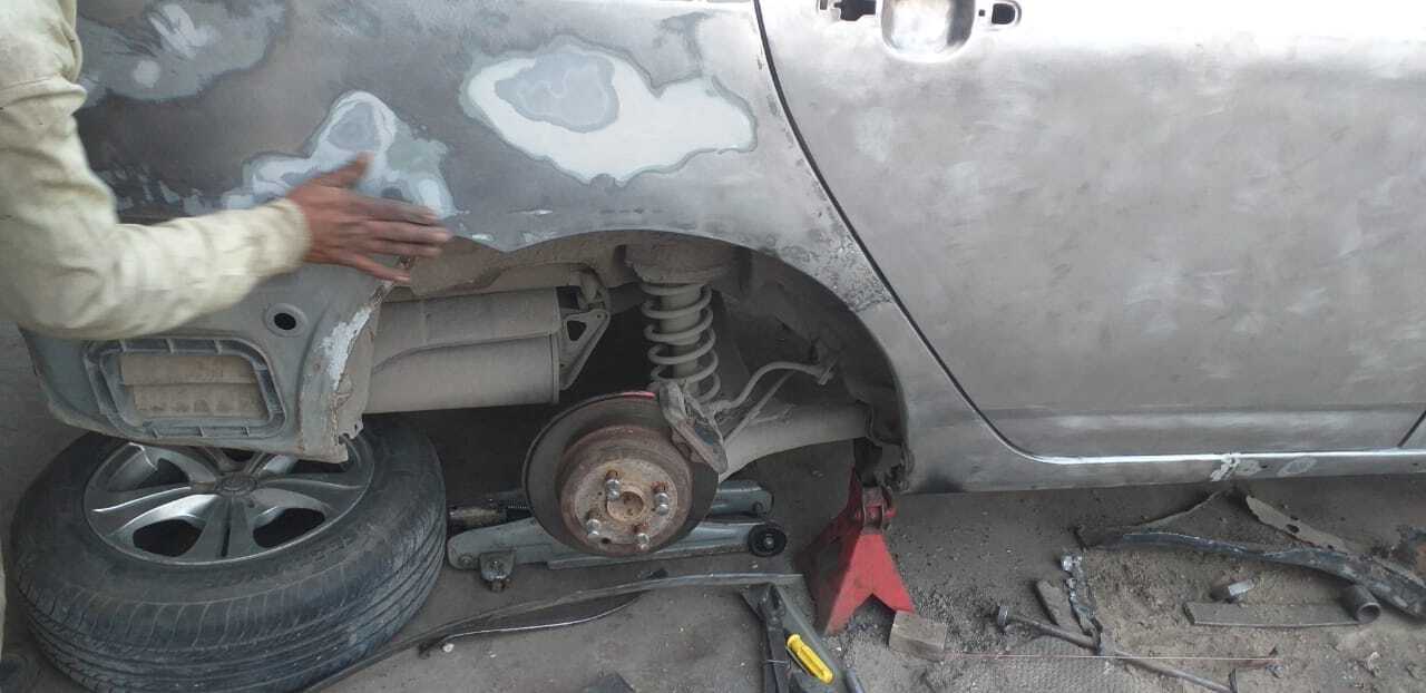

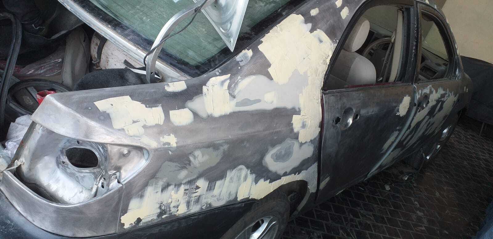

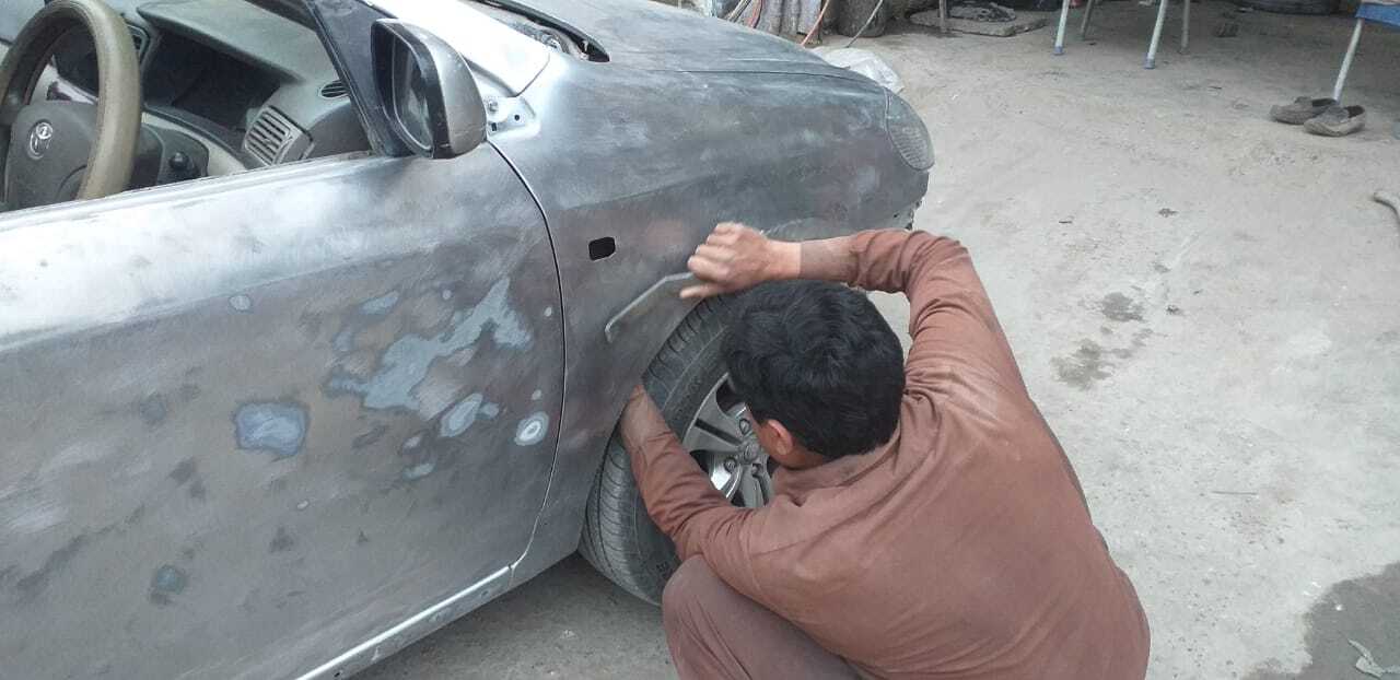

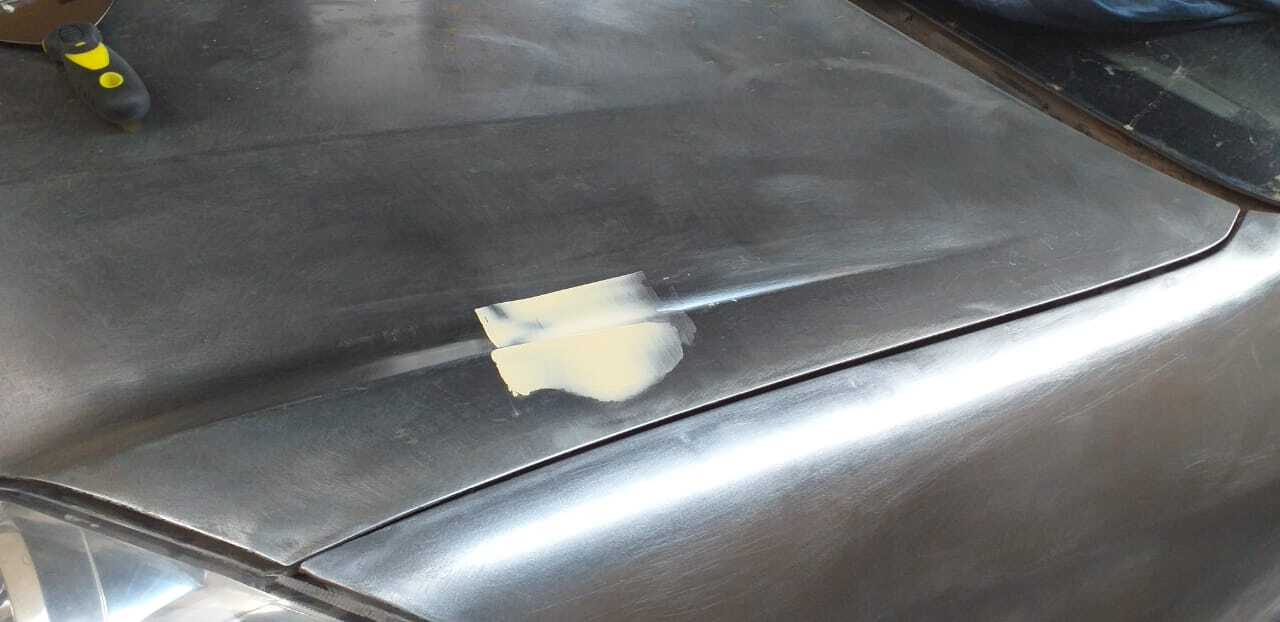

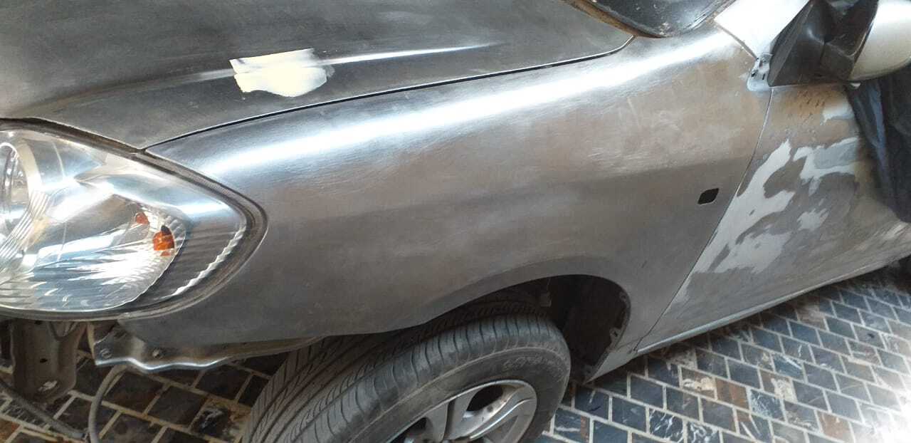

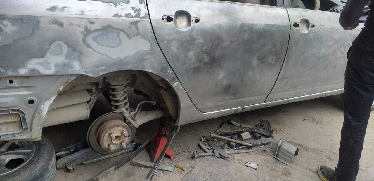

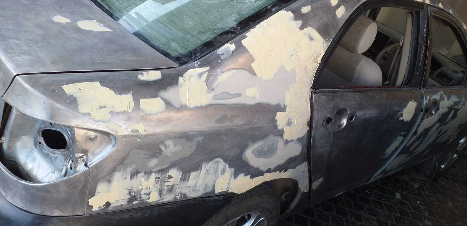

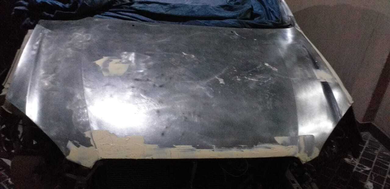

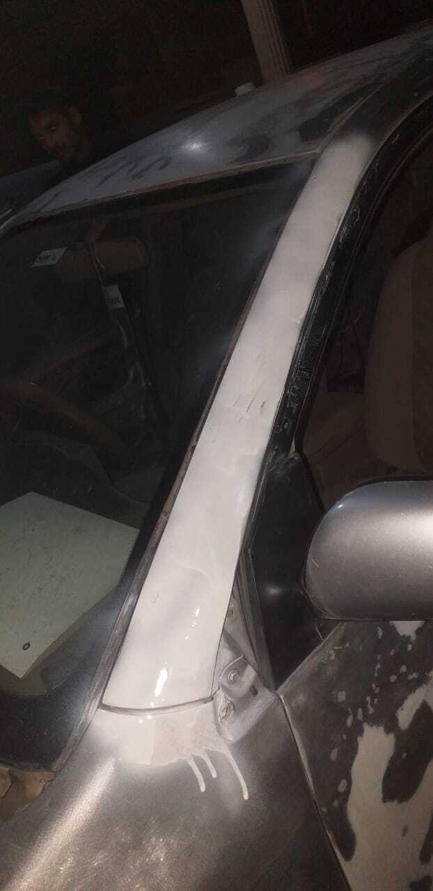

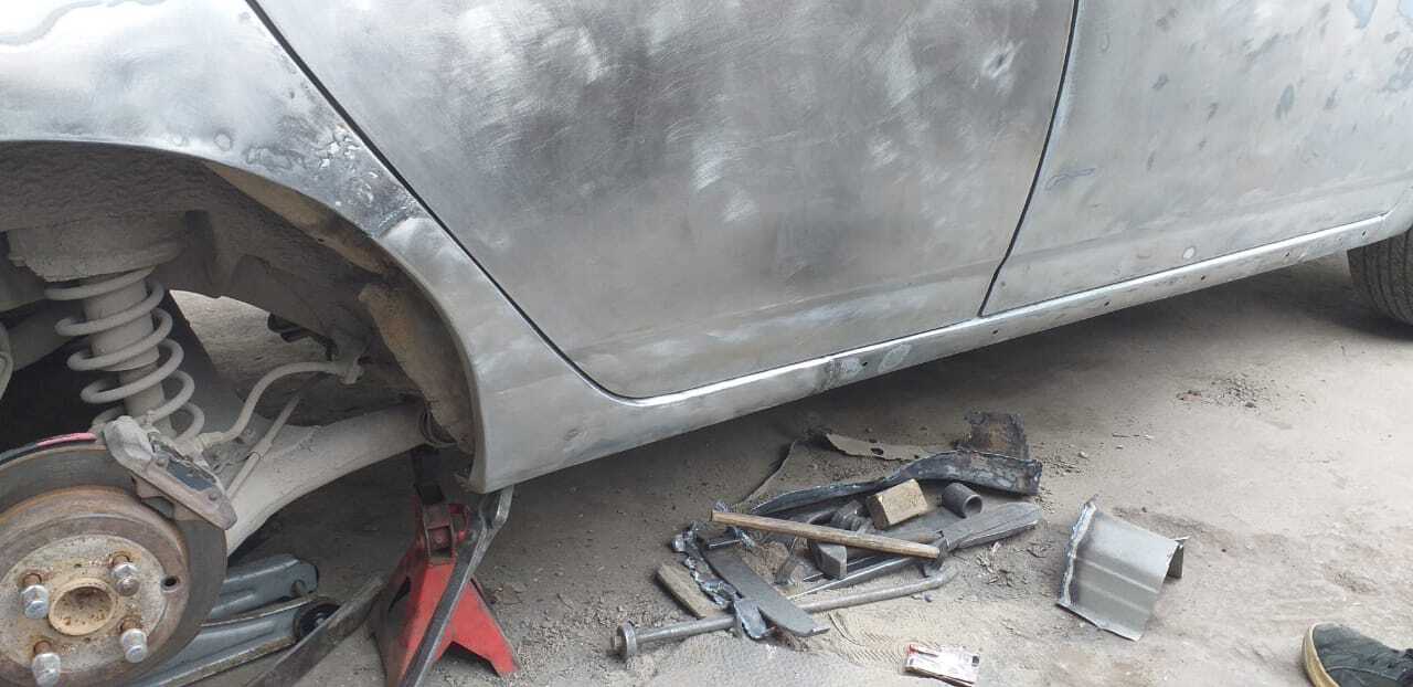

denting finished ,,,,,,,, 2 very very tough days spend at work shop ,,,,,,,,,,,

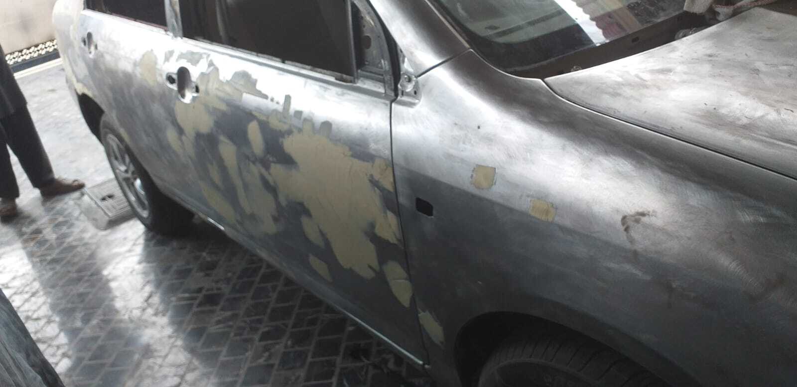

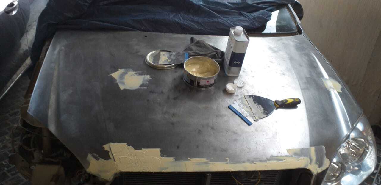

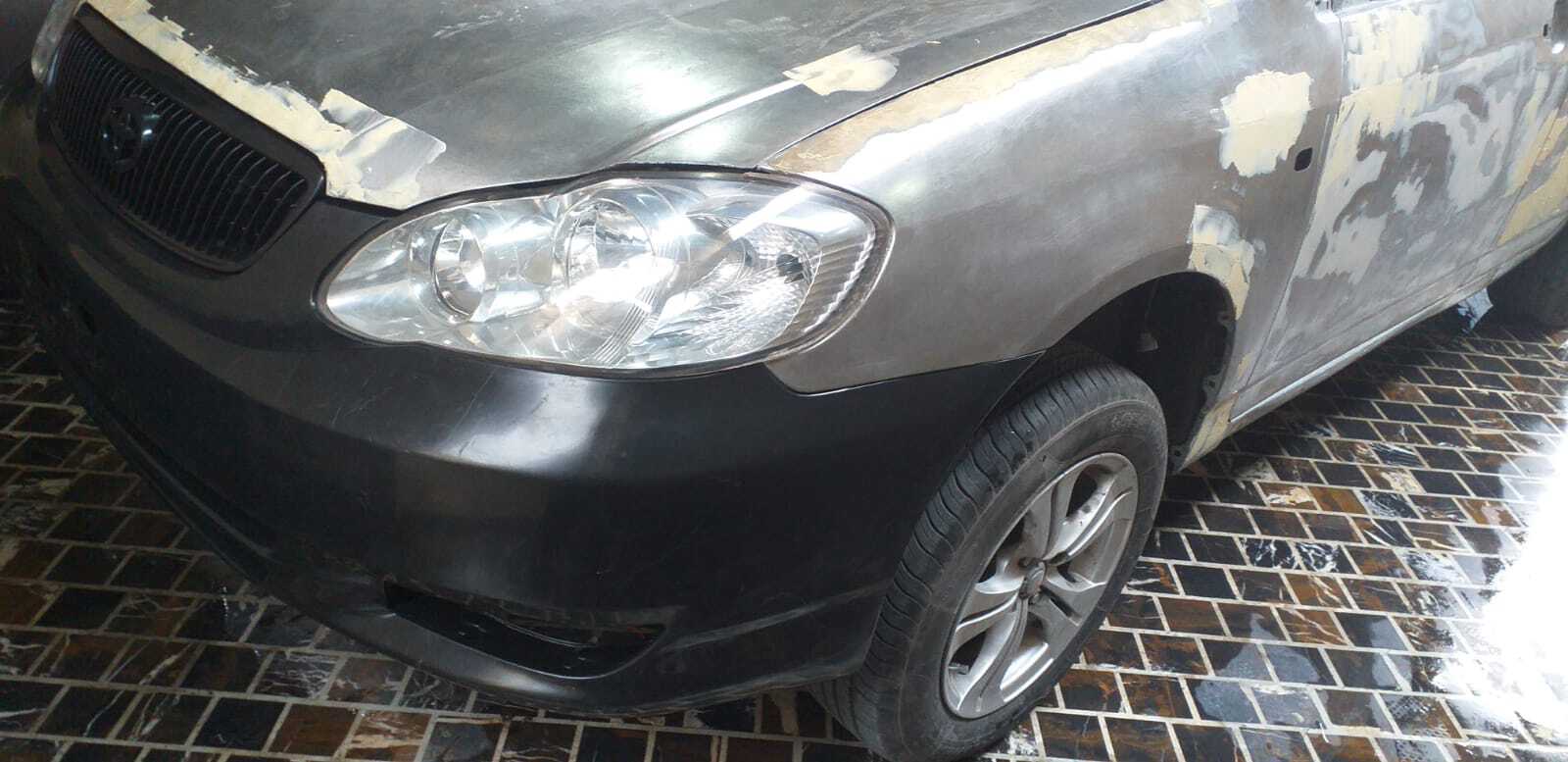

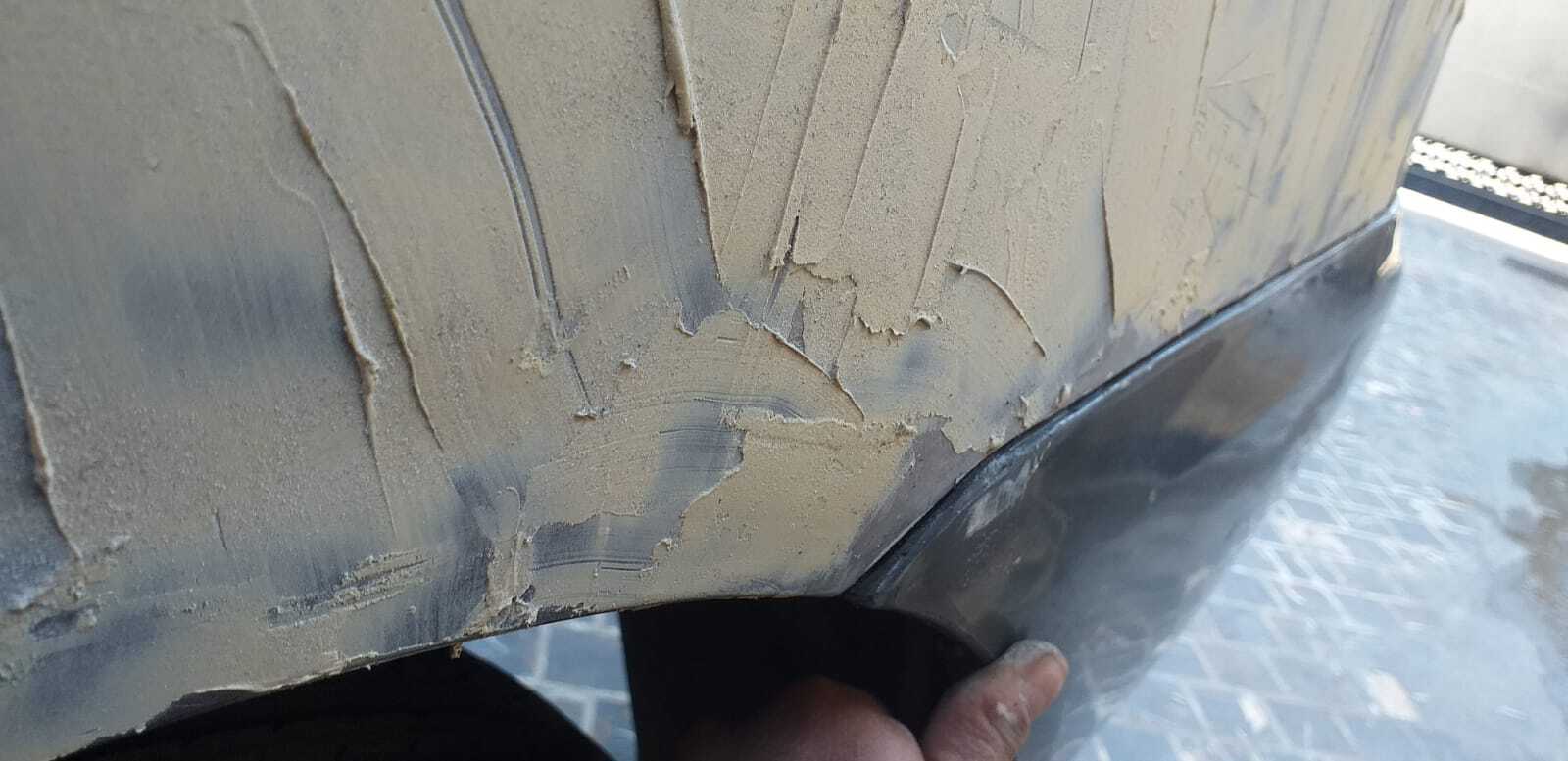

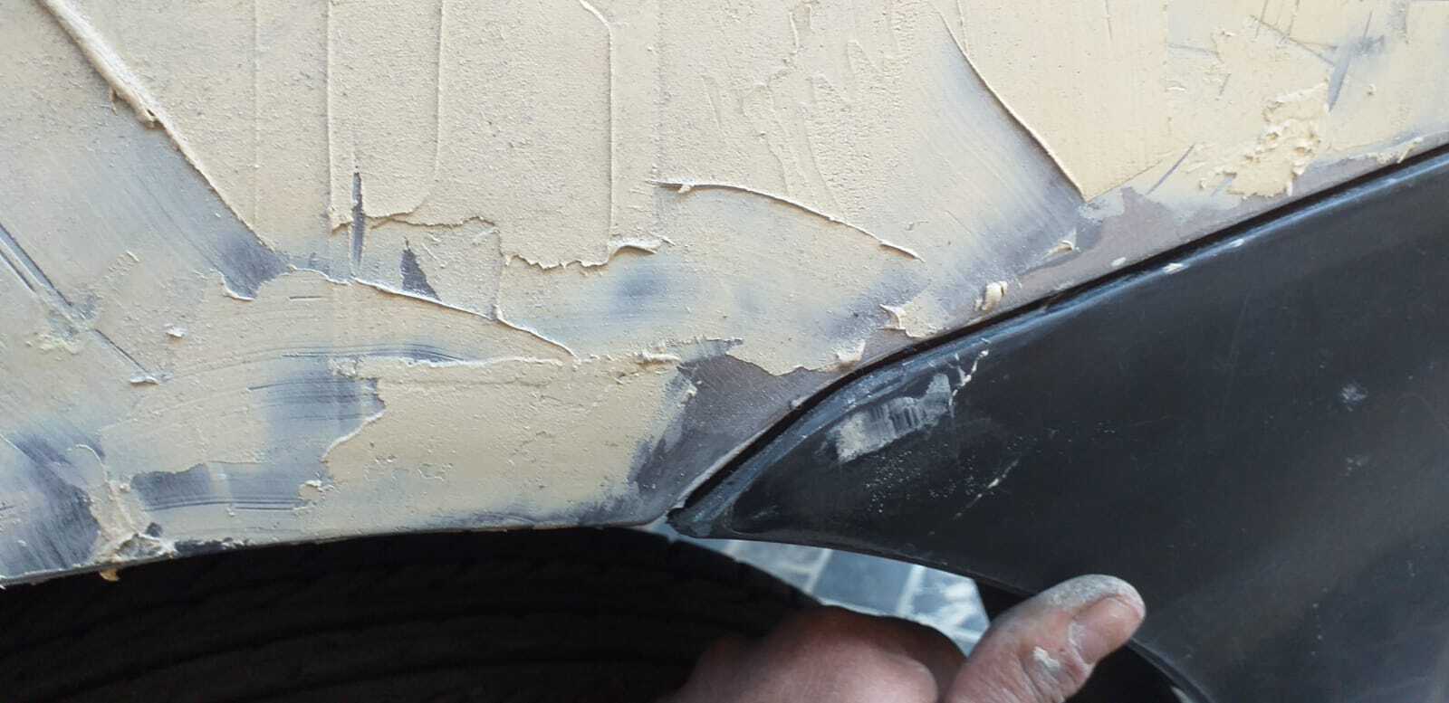

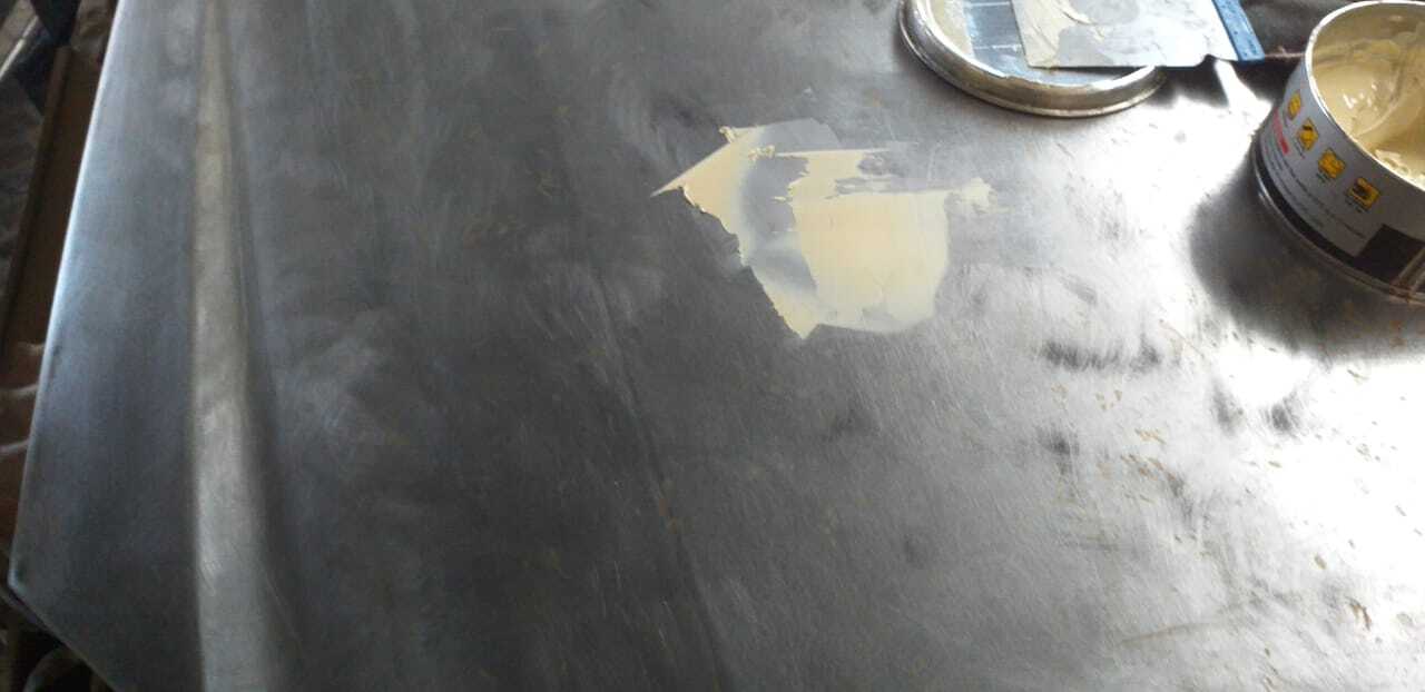

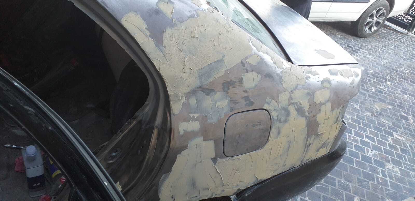

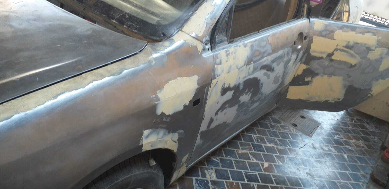

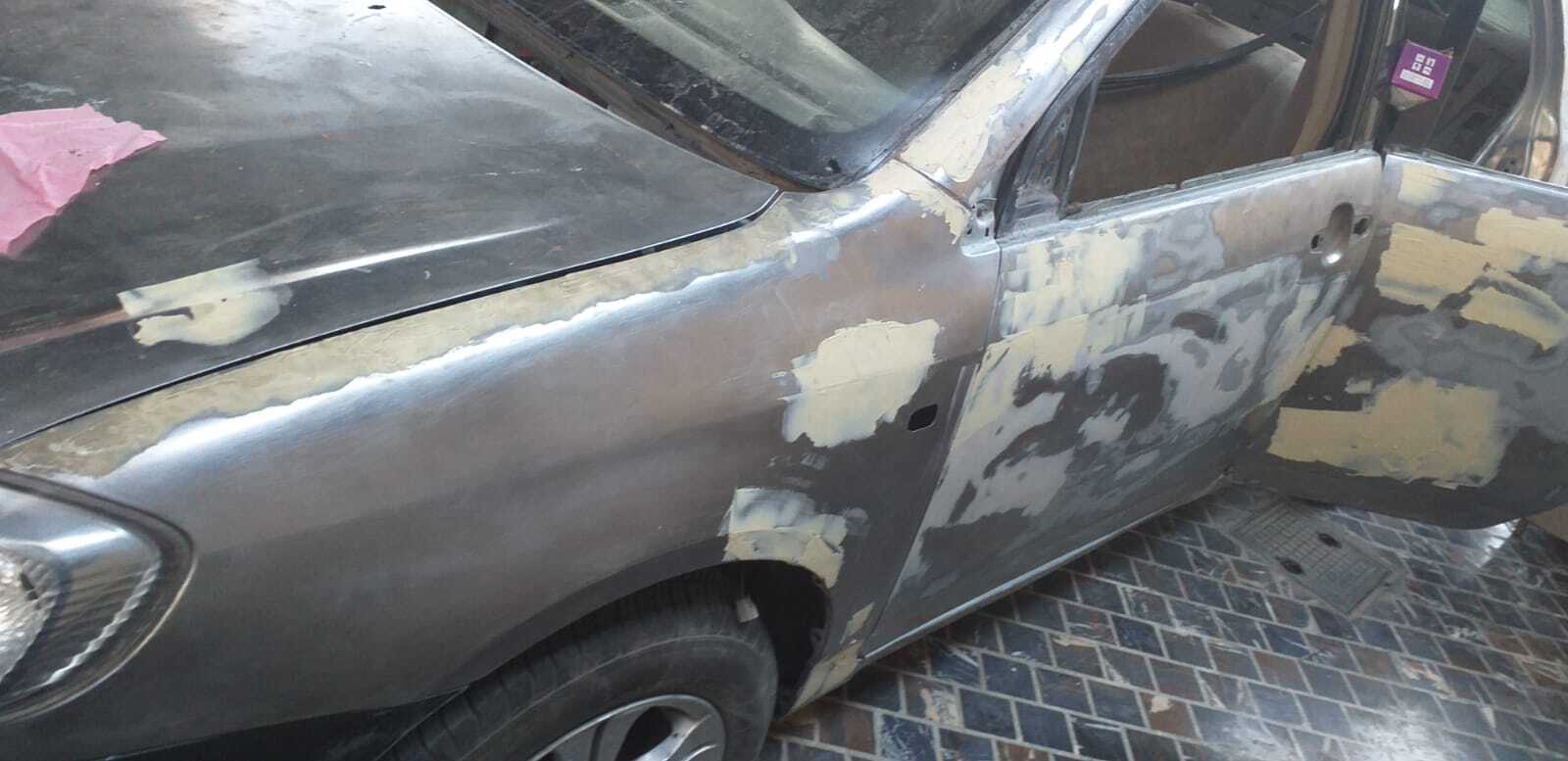

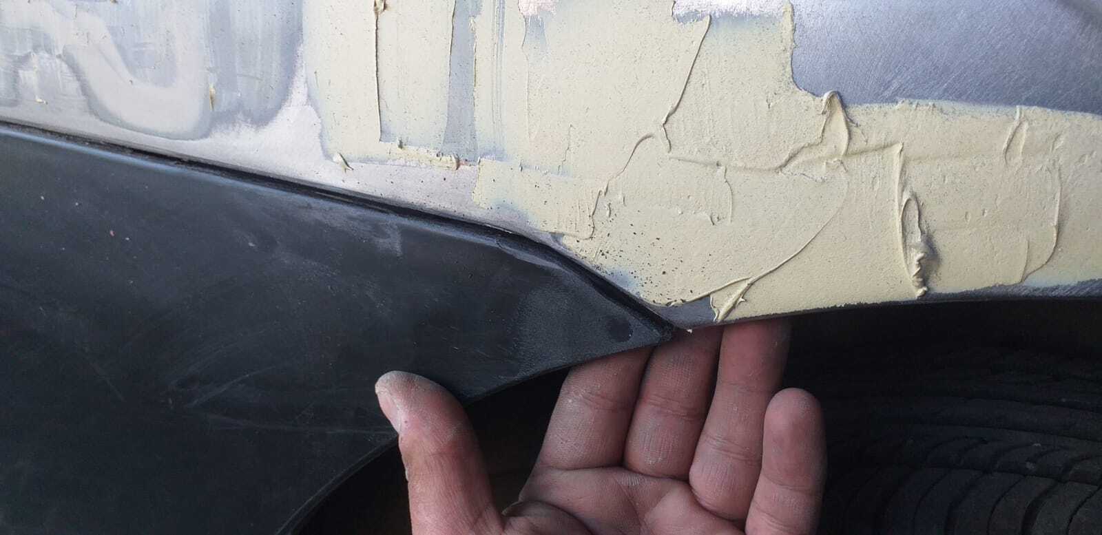

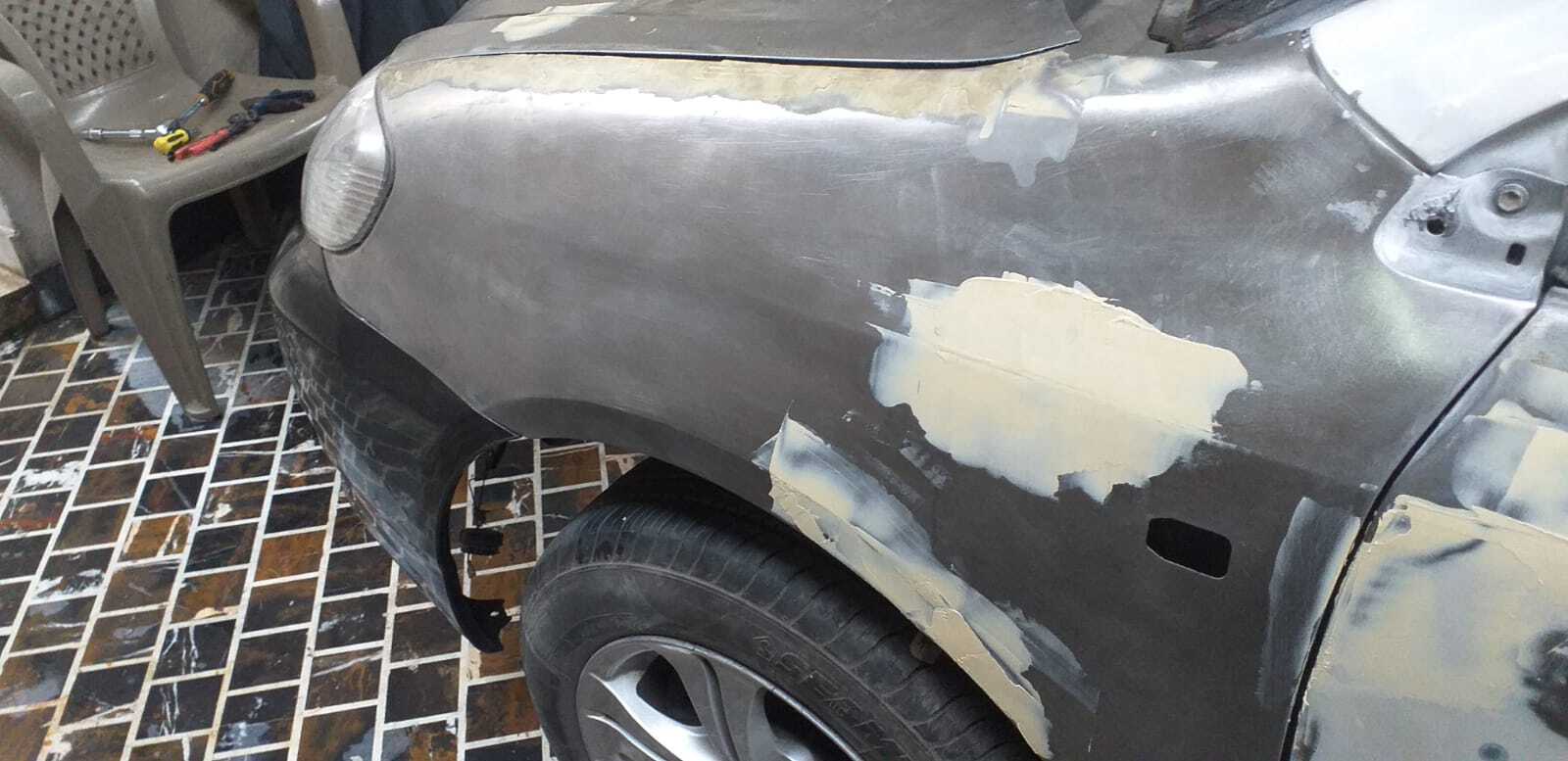

started applying filler ,,,,,,

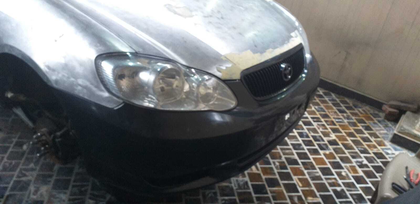

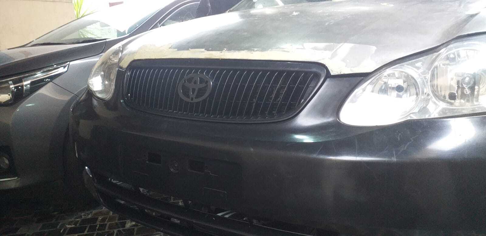

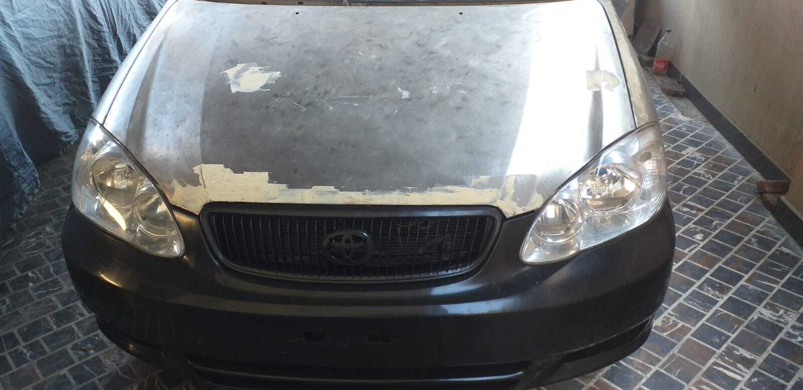

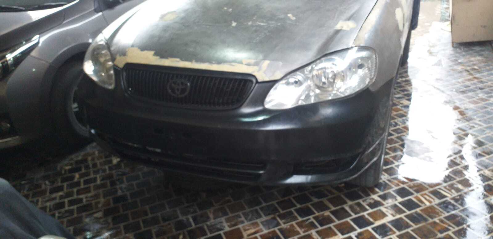

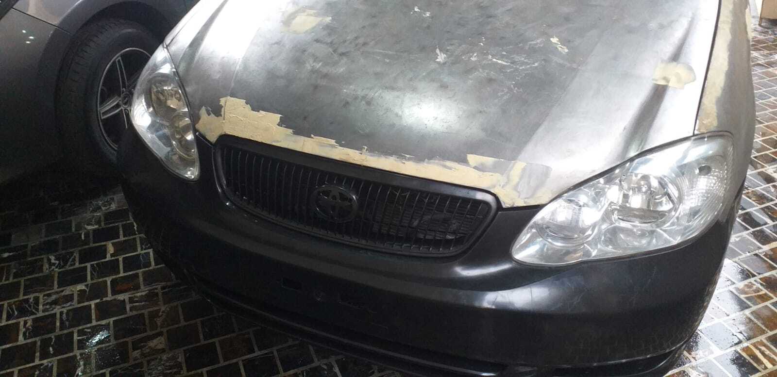

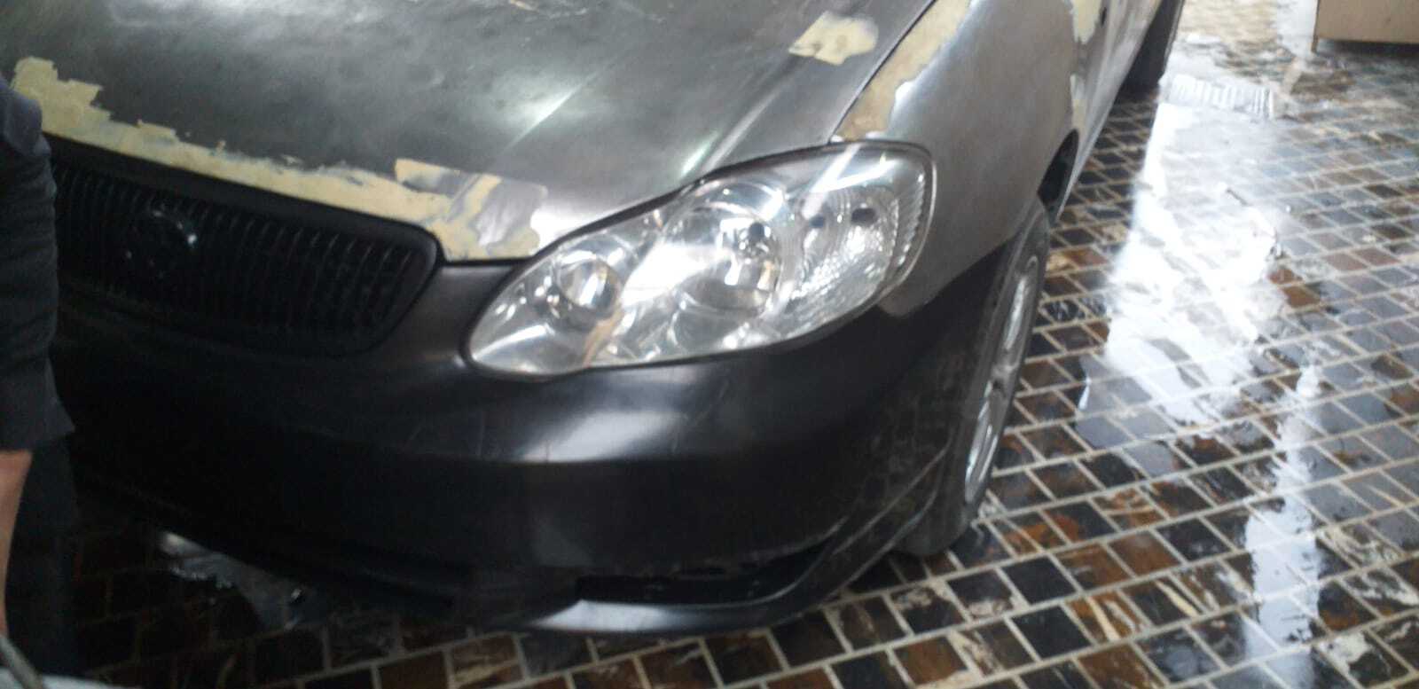

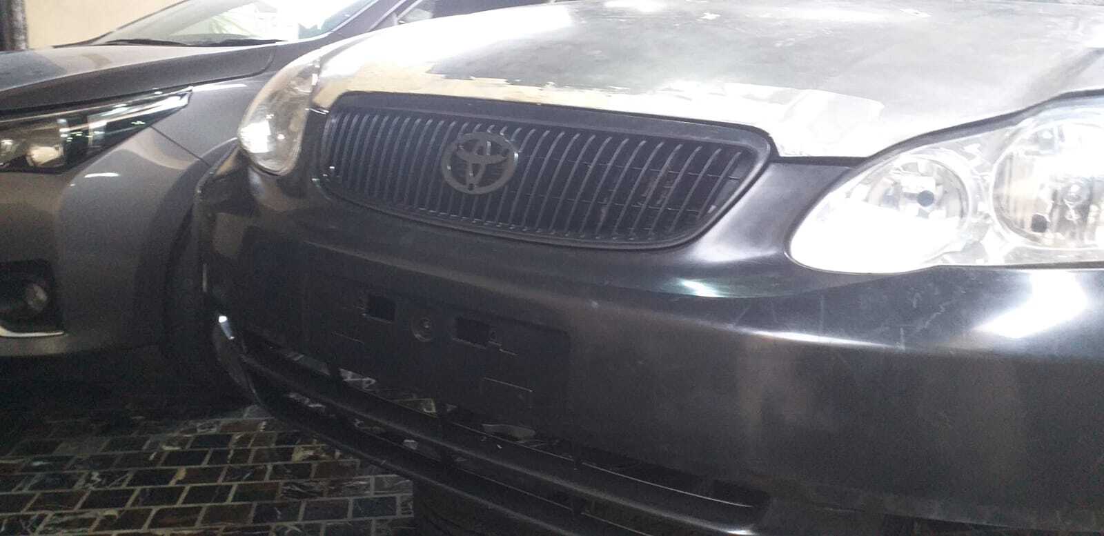

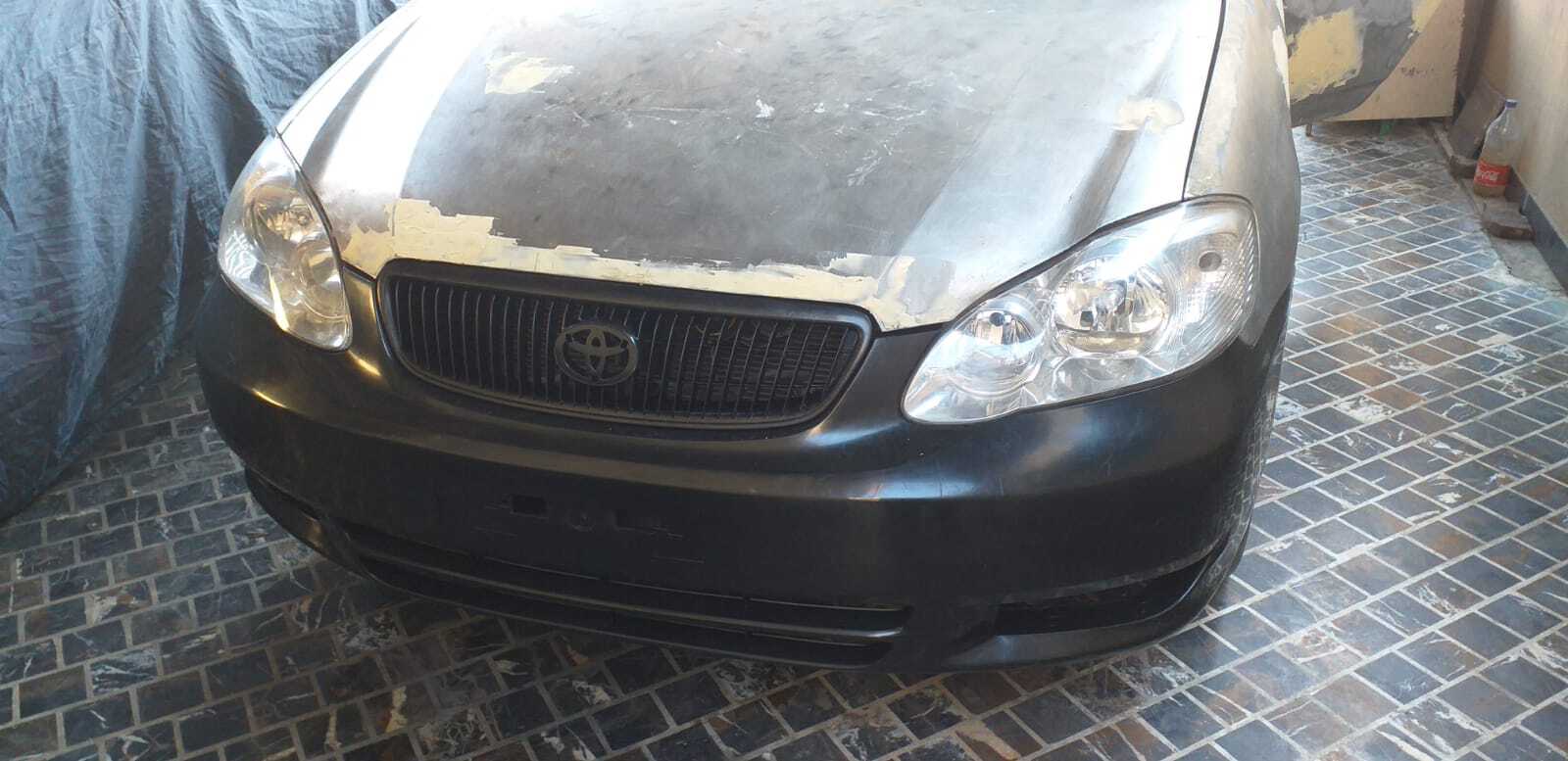

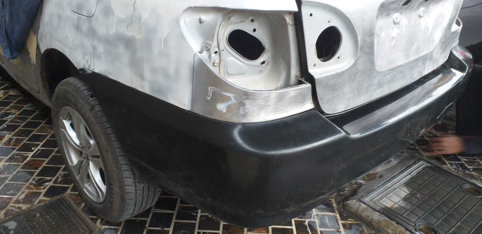

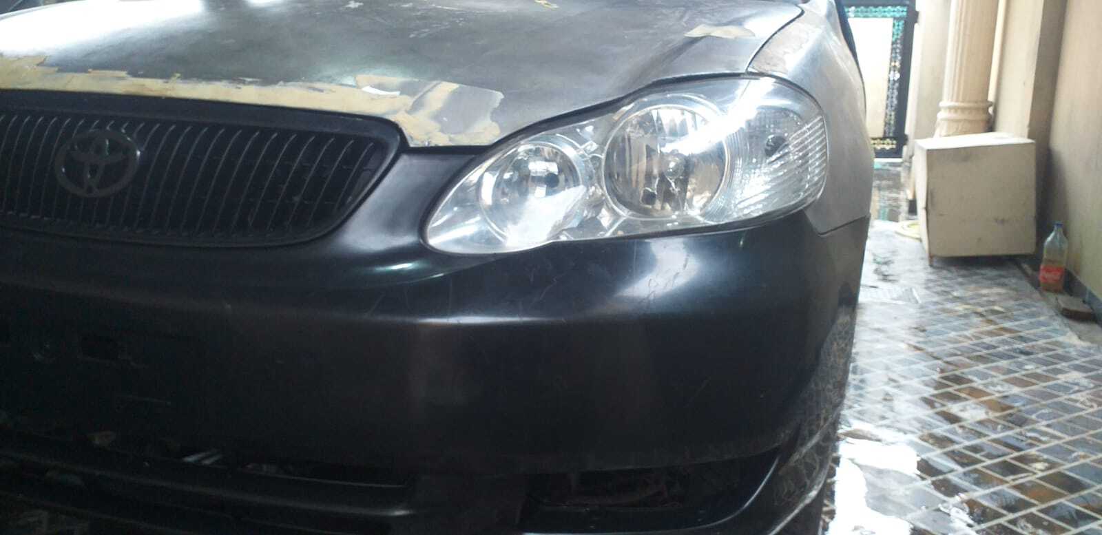

test titted bumpers ,.......

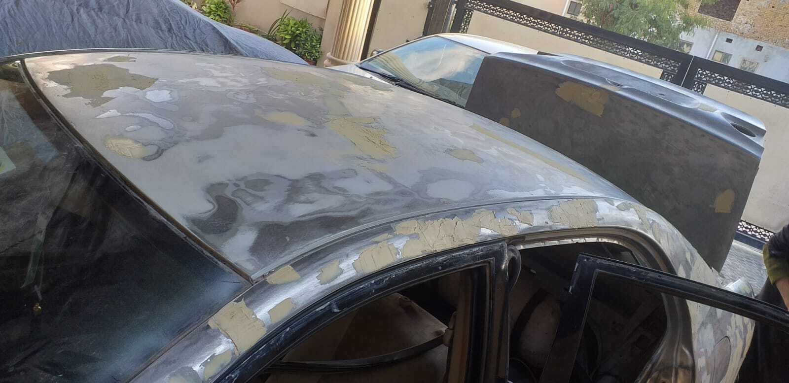

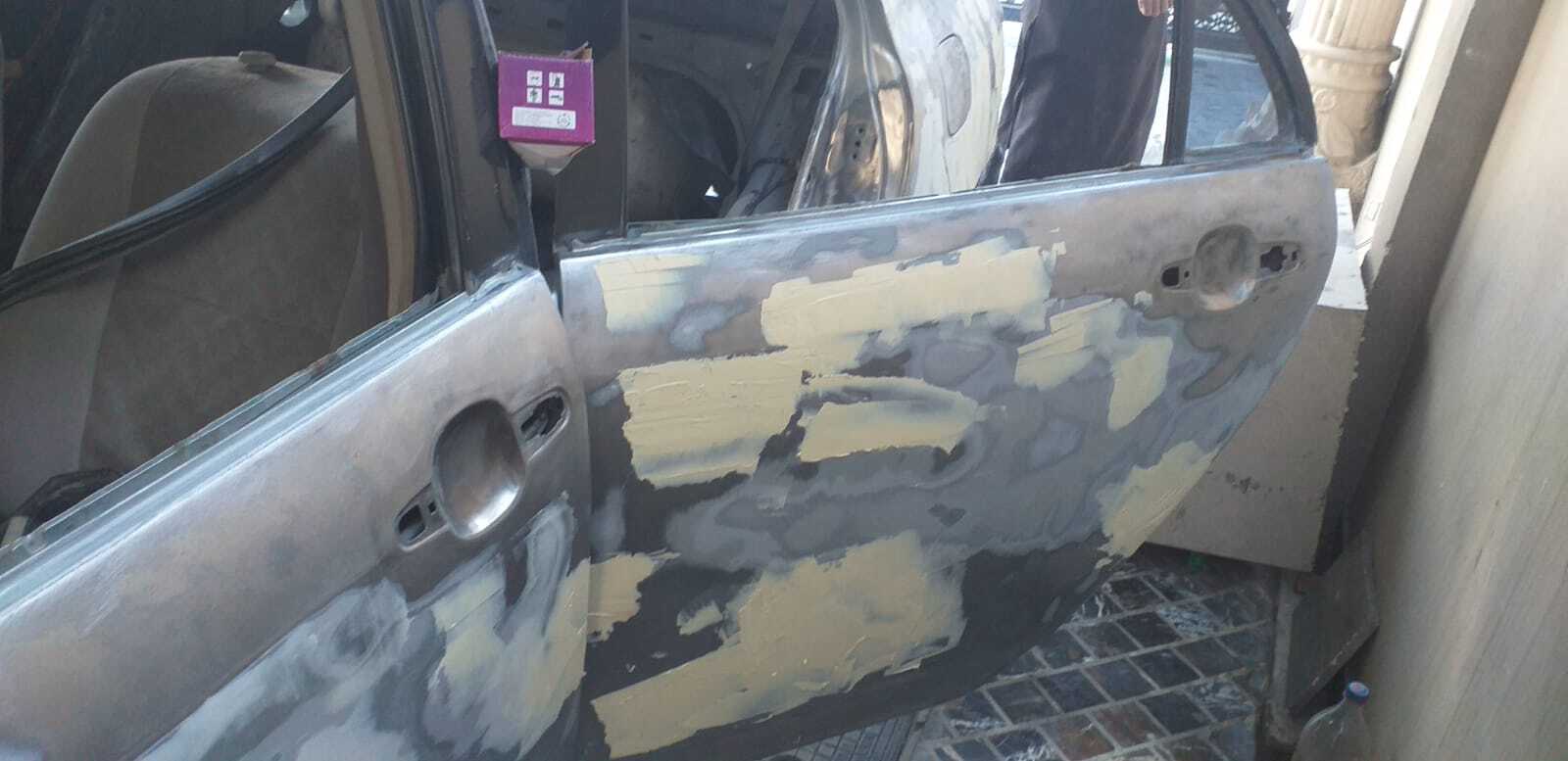

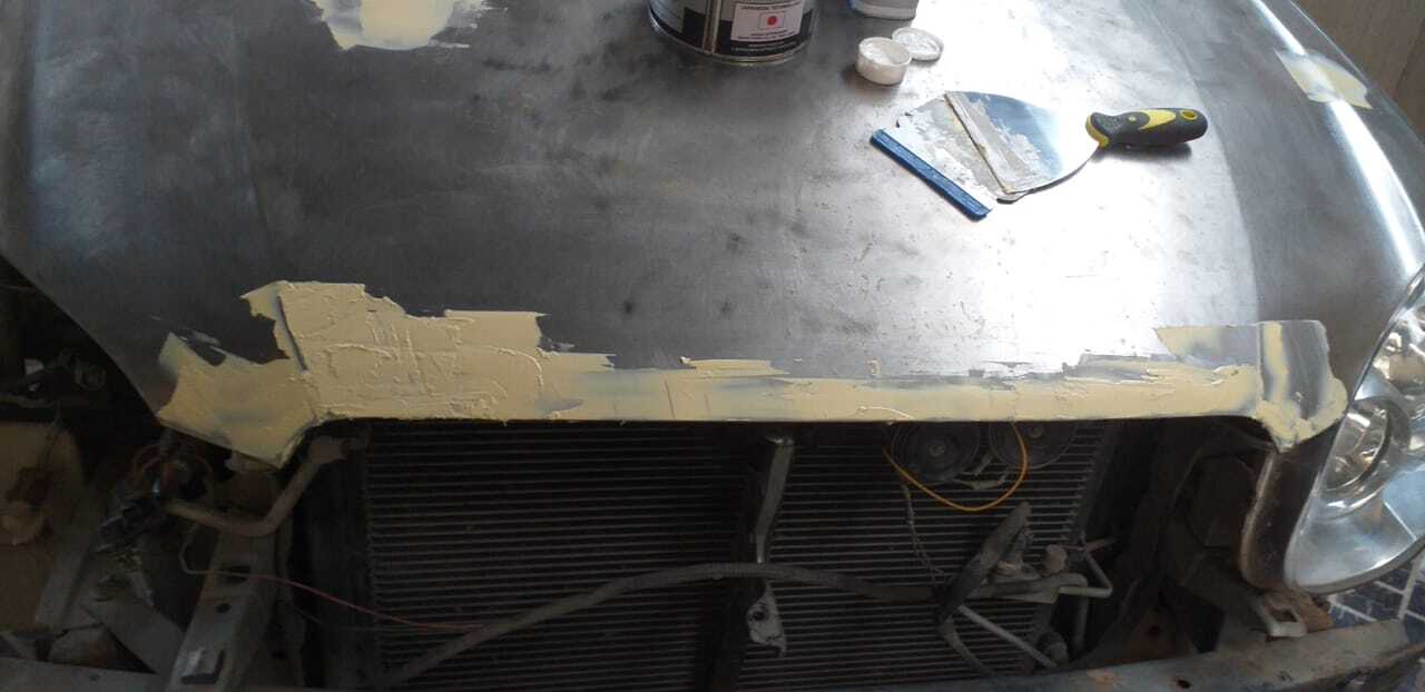

applied putty ,,,,, now leave it for a day and then sand it ,,,,,,,

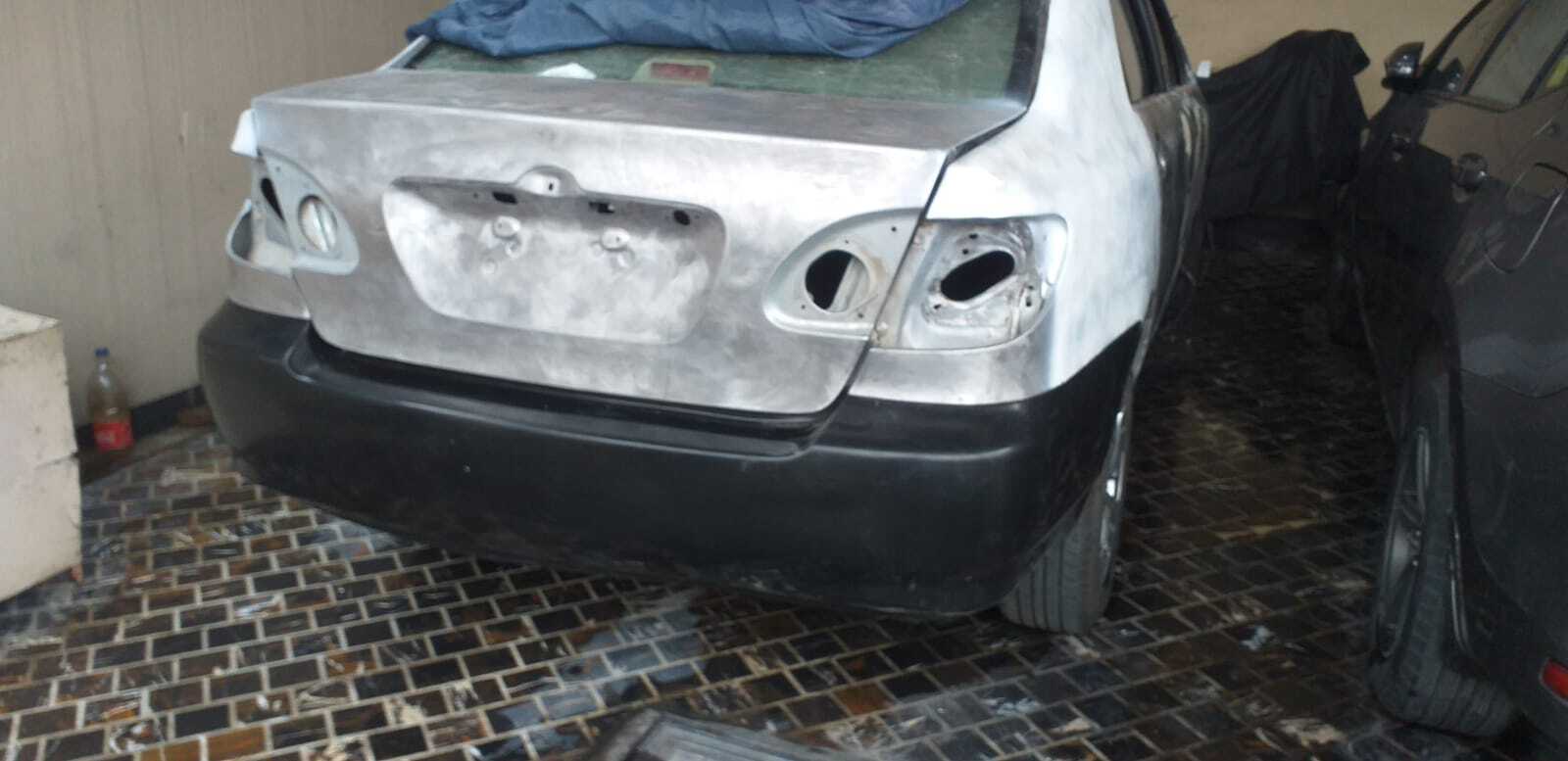

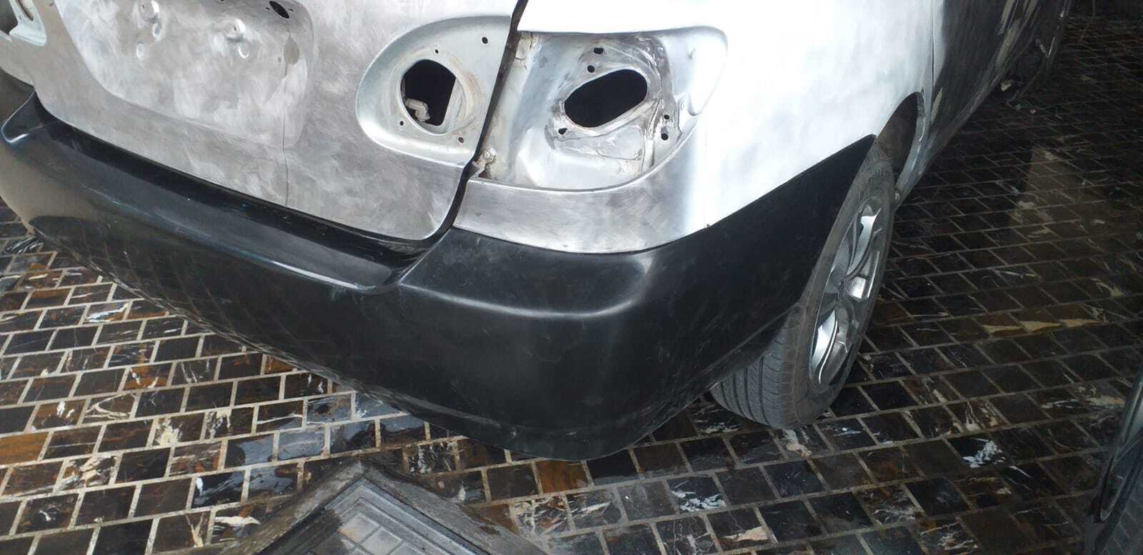

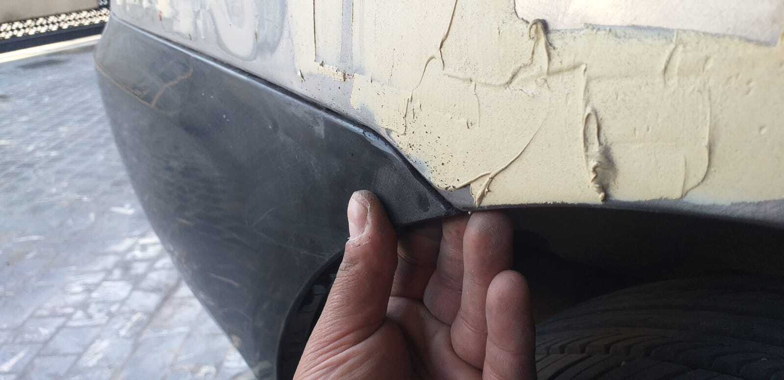

rear bumper edges were offset ,,,,,, i did see same on many vehicles ,,,,, even in my 2004 2D also have same issue ,,,,, just slightly grind and clean the rough edges and left over plastic from molding will solve the problem and fit perfectly ,,,,,
Yes that bumper offset gets very annoying
