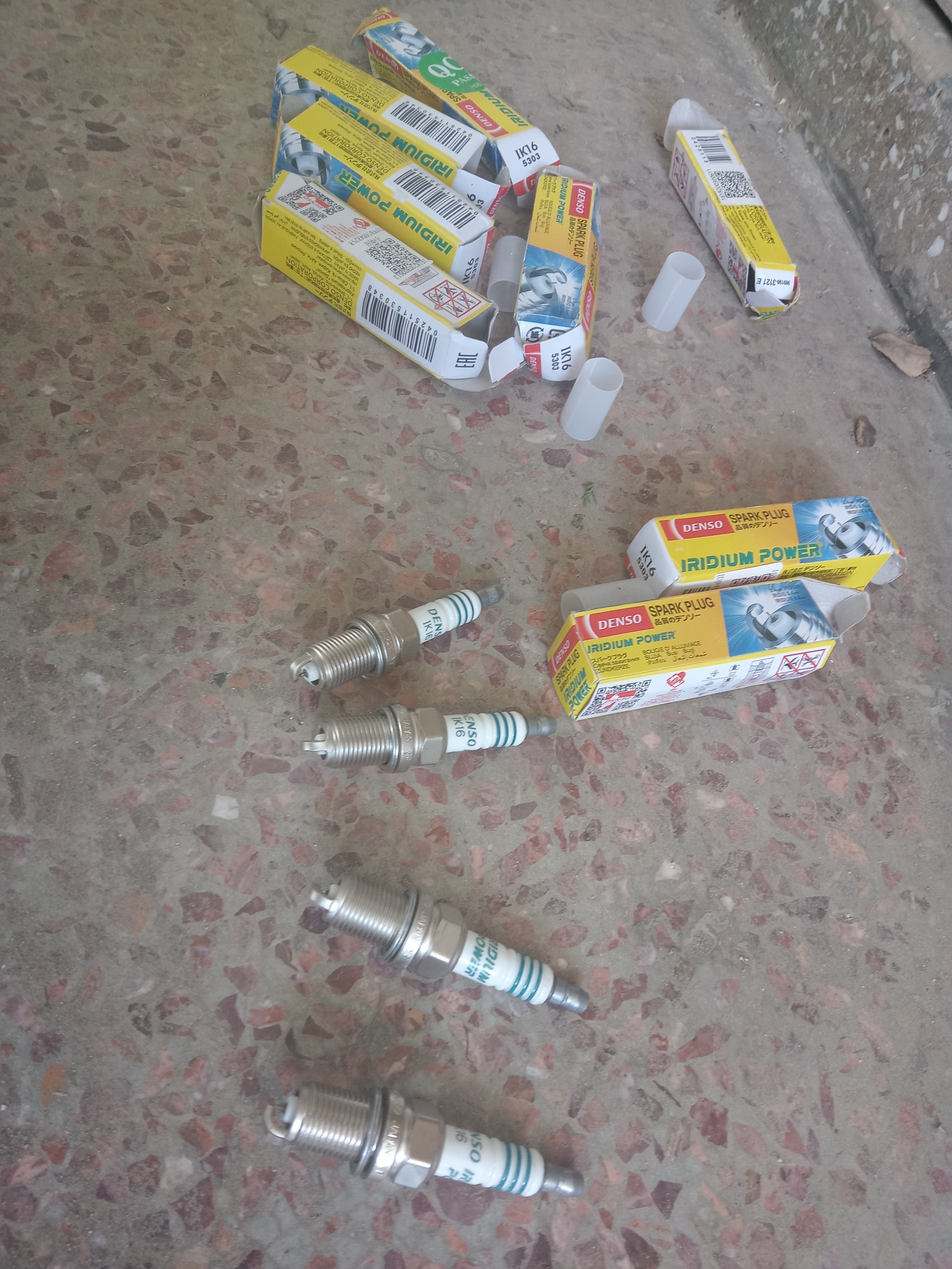

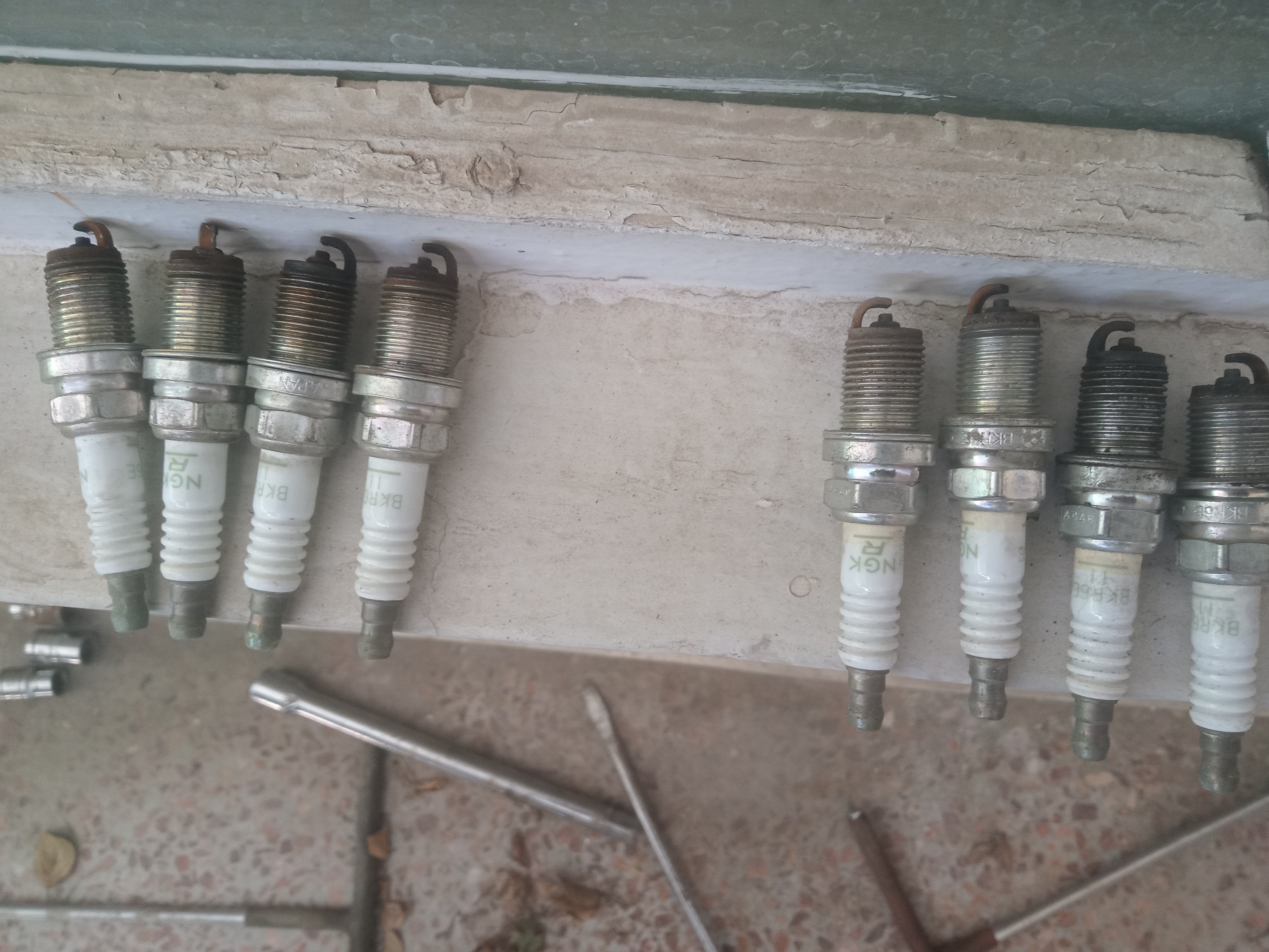

AoA Guyz. Today changed Spark Plugs Of My city Myself Alhamdulillah. Installed denso iridium spark plugs
Cost and part no? What difference you feel in pick and fuel average?
Total cost of these iridium plugs any difference you felt in pic of the car.
Yes of course pickup and idling has improved and hence the fuel economy also improved Alhamdulillah. Though only driven 100kms yet after replacing the plugs.
For the price, it's available in market by denso company for 1500 Rs per plugs. Part No. IK16 5303
I have a stock of these available with me and giving in 1000 Rs per plug
Bro if im not wrong for this engine the recommended ones are IK20 no?
Yeah but Do you know what 20 in IK20 represent? It's heat range. Rest the IK16 plug size is same. 16 is higher heat plug

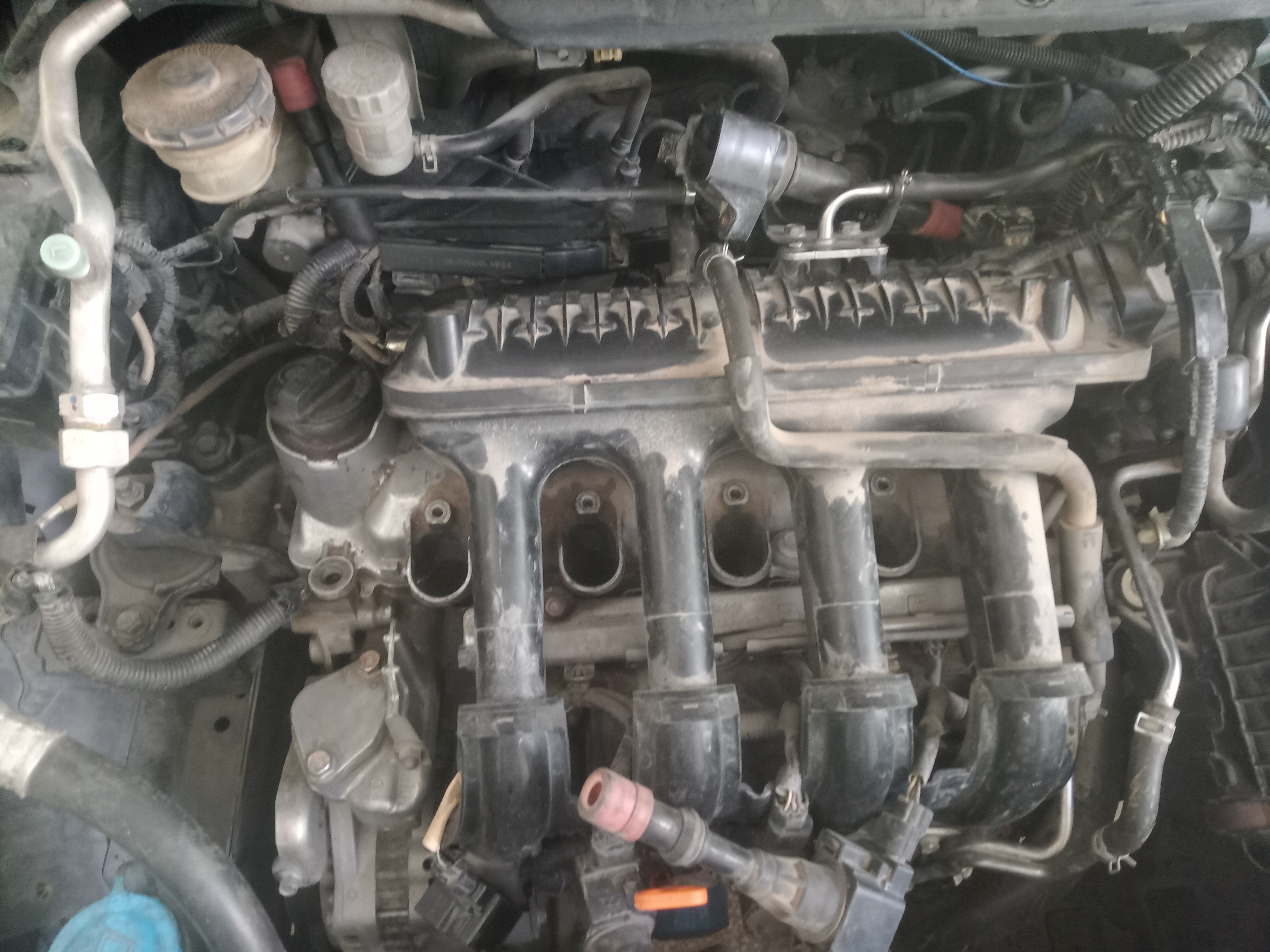

Hello, good DIY job MBBS! Honda are charging 4560rs for a throttle body clean so I may as well do it myself! Which carb cleaner do you recommend or will any work fine? Any things to watch out for? TIA
This car originally came equipped with copper spark plugs.
Why do you need to clean the throttle?
