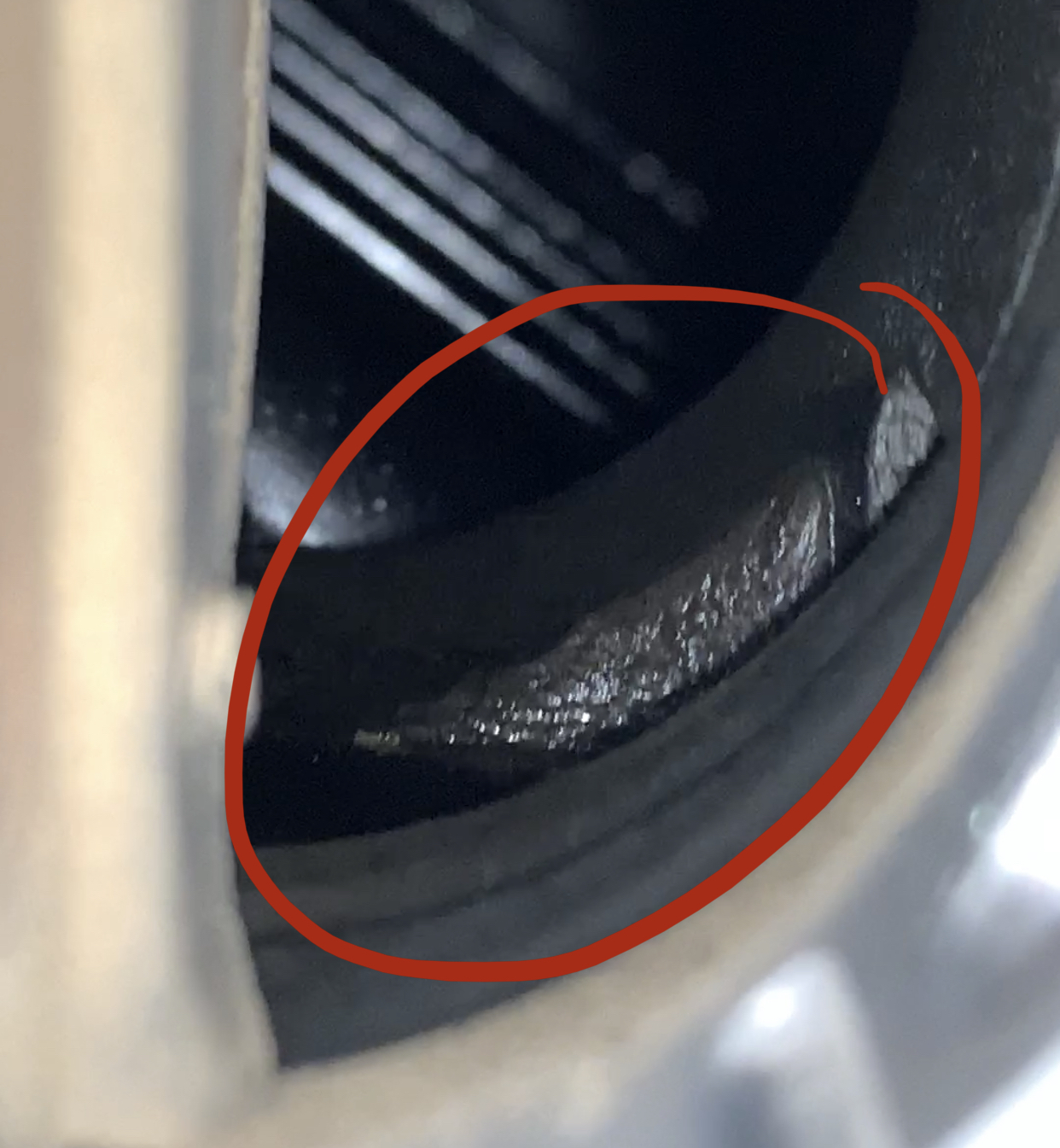

Throttle cleaning is only done when its actively causing issues - like its literally caked with coal a few millimeters thick, What you see is probably just a dusting of oil which is completely normal.
Be very careful cleaning it as you can ruin the throttle blade axle bushings with too much solvent. I doubt you will have results you want.
Its better to have equipment to check the health of the engine rather than go by ear and feel. The equipment is not just a scan tool.
