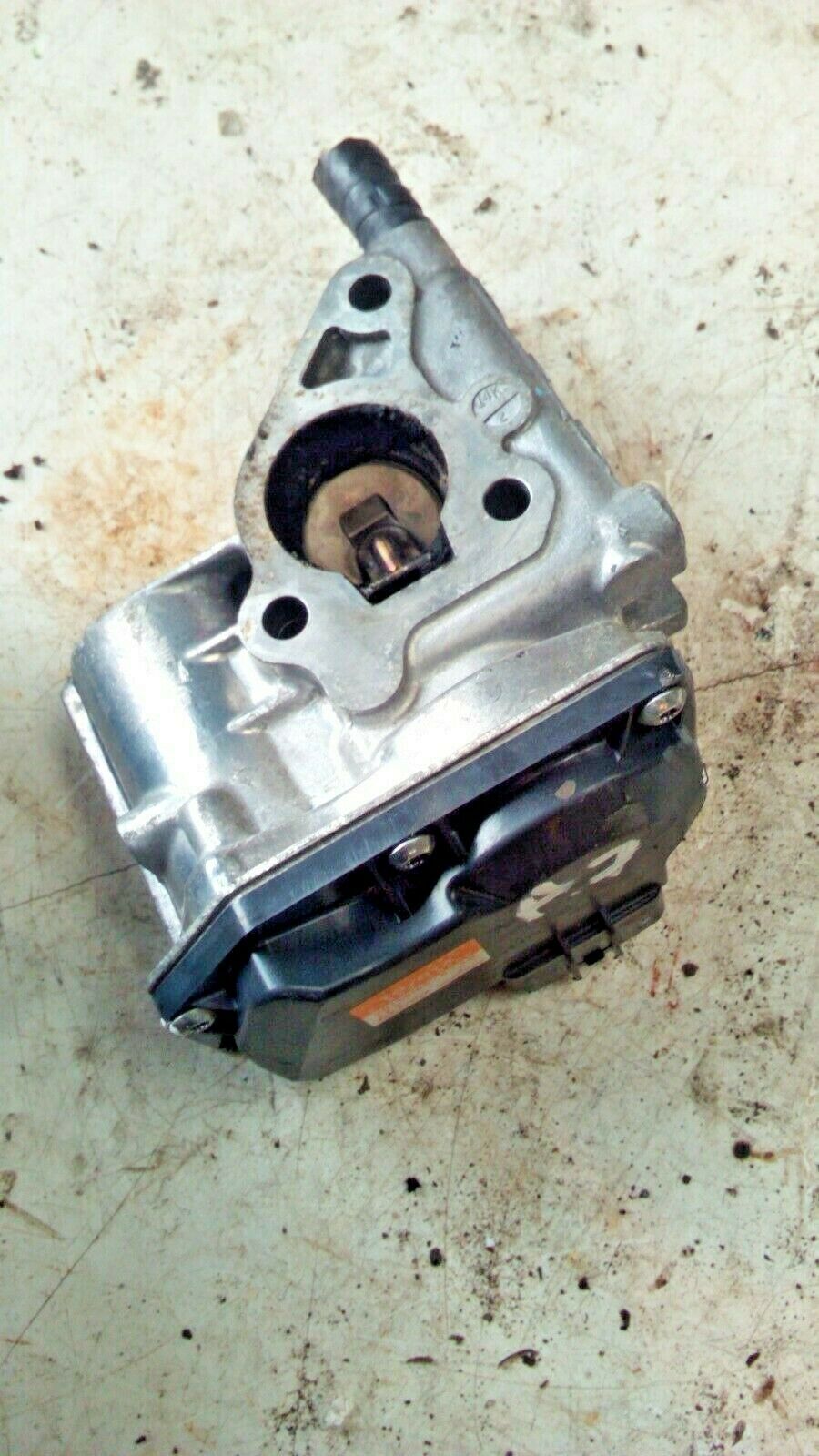

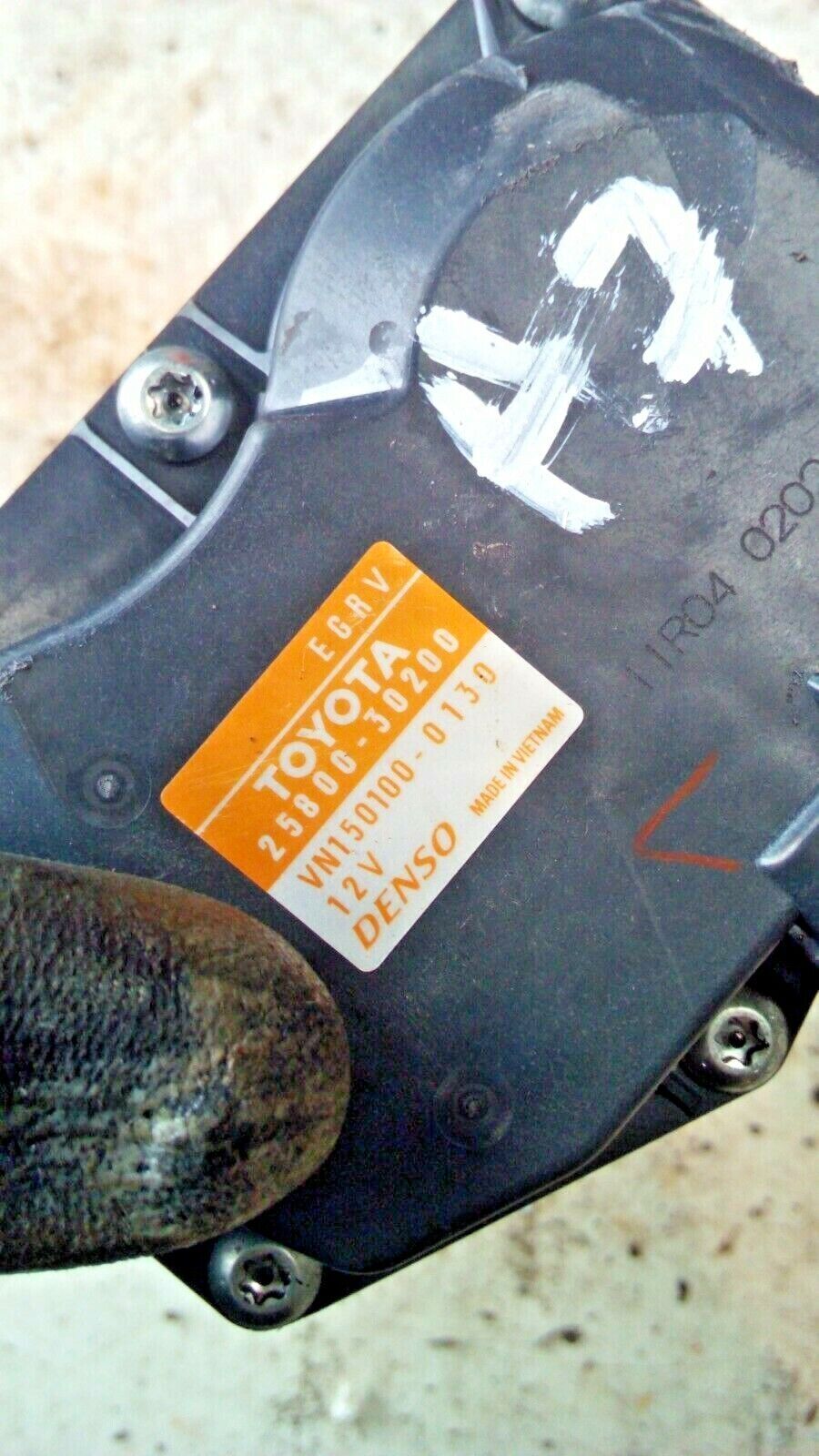

here is image of 3L EGR valve locate it in your vehicle please
it is connected from intake manifold around firewall to exhaust manifold.
