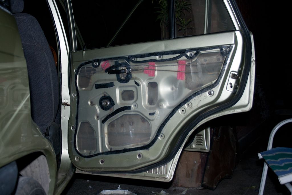

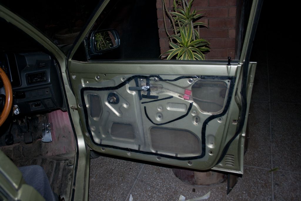

So finally on 17th nov, I did this:
used the "kachi rubber" tape also known as kork cape among the AC parts shops.
only shot two pics, it was getting late and I had one "trouble" door on which I experimented a few months ago using a HOT GLUE GUN! It didn't work for keeping the plastic sheet in place, instead the sheet came and the glue was now happily married to the door. I knew this is going to be messy and damn it was. It still is actually, I haven't got time to remove the from the door to apply the kork tape and paste the plastic sheet.
Anyways, after I was done with the three remaining doors, I used a powerful hair dryer which helped in seating the plastic sheet with the tape well and also made it more "flexible" in the "pockets" or whatever they should be called.
Things to consider before you're up for this job:
1 - the surface where you're going to stick the kork tape should be clean, CLEAAAANNNN. both the door and the plastic sheet
2 - if you don't want to work too hard on the project, get a "thinner / lighter" plastic sheet. I used quite a thick one and it was a trouble setting it up on the kork tape and keeping it stuck there. But the hair dryer trick helped a lot
3 - For mehran specially, get better door clips before you start removing the door card, the tape is thick and the old clips if already bad will not work when seating the door card again
And now I need tips on how to remove the silicone adhesive from my front left door! I'm guessing its going to be a lot of elbow grease but some solvent that can loosen up that stuff would be helpful. Also I'm using a plastic scrapper, would that be enough?
