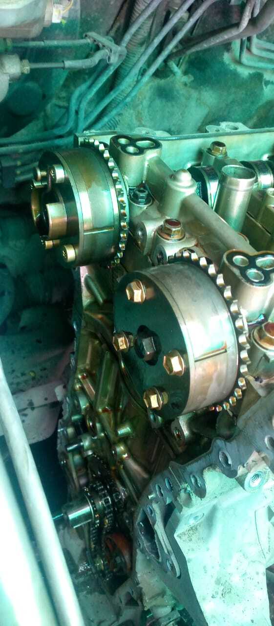

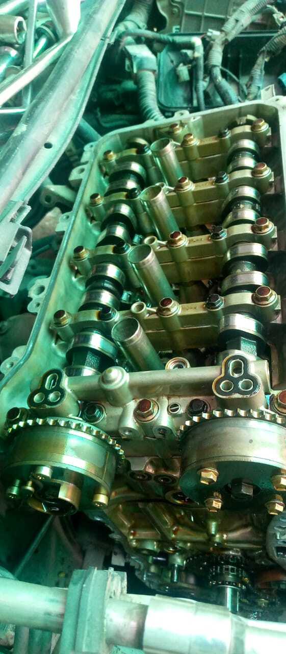

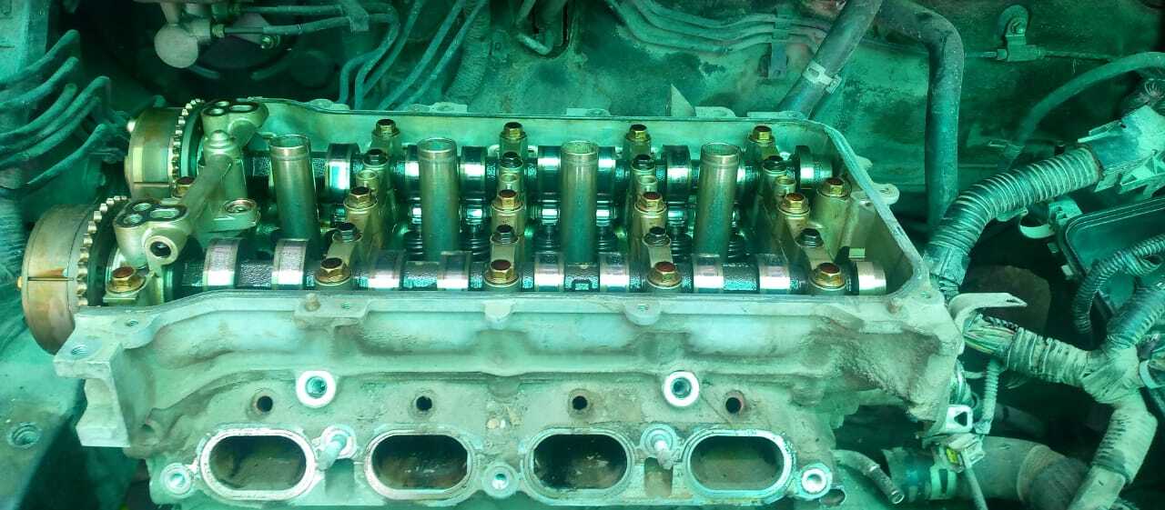

here you go, look at the pics where Im applying the sealer and then the squished out sealer. Its GM 1207G, which I prefer because
1 - its cheaper and GM dealer is literally 5 mins away from my house
2 - its cleaner because its gray and I can buy it in tubes or caulking gun cartridge too (which I like)
3 - sticks with same tenacious force as toyota sealant.
I have still yet to see a seep or drop of oil from the areas I sealed up - its been years and more than 150K kms.
