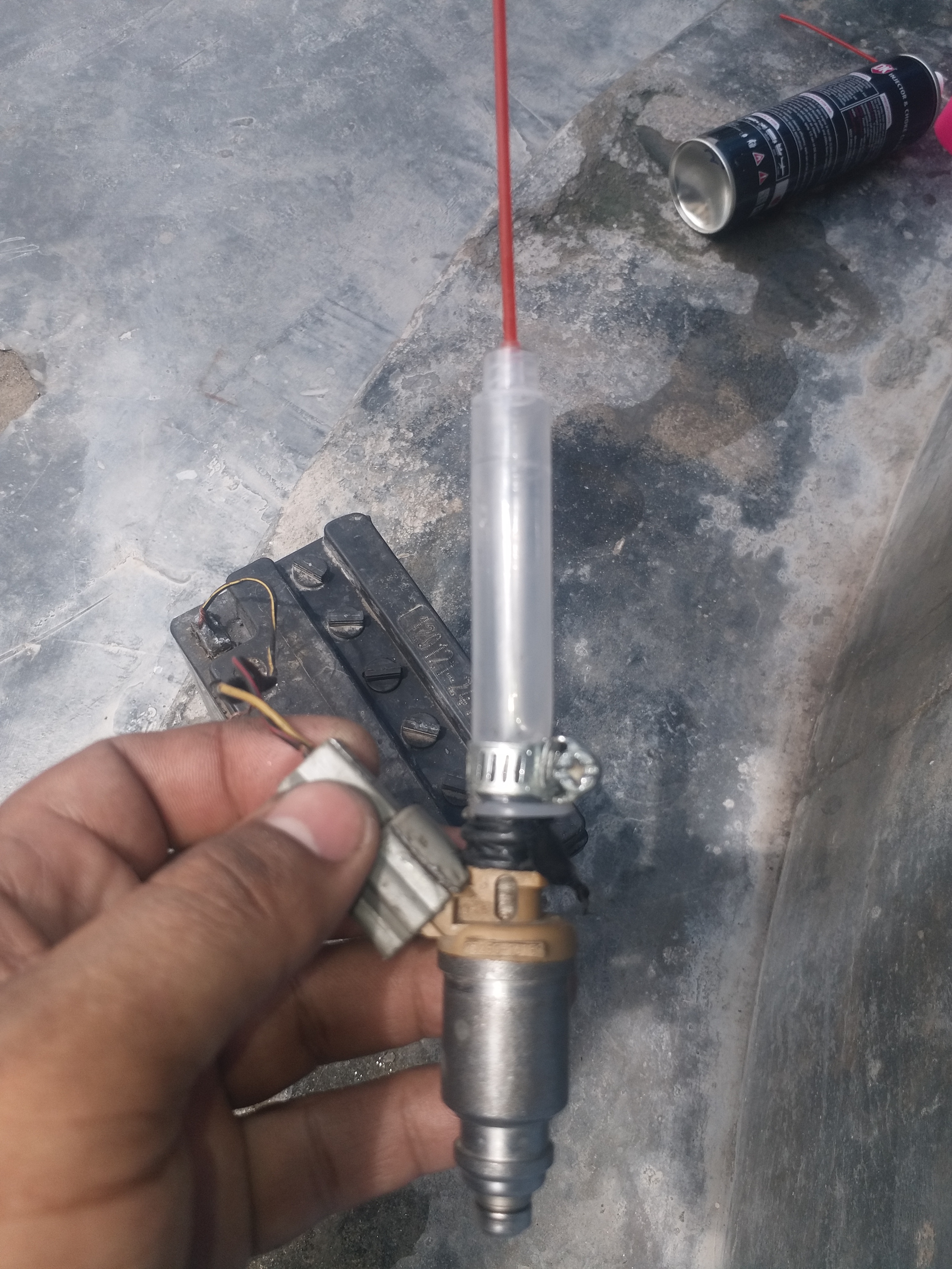

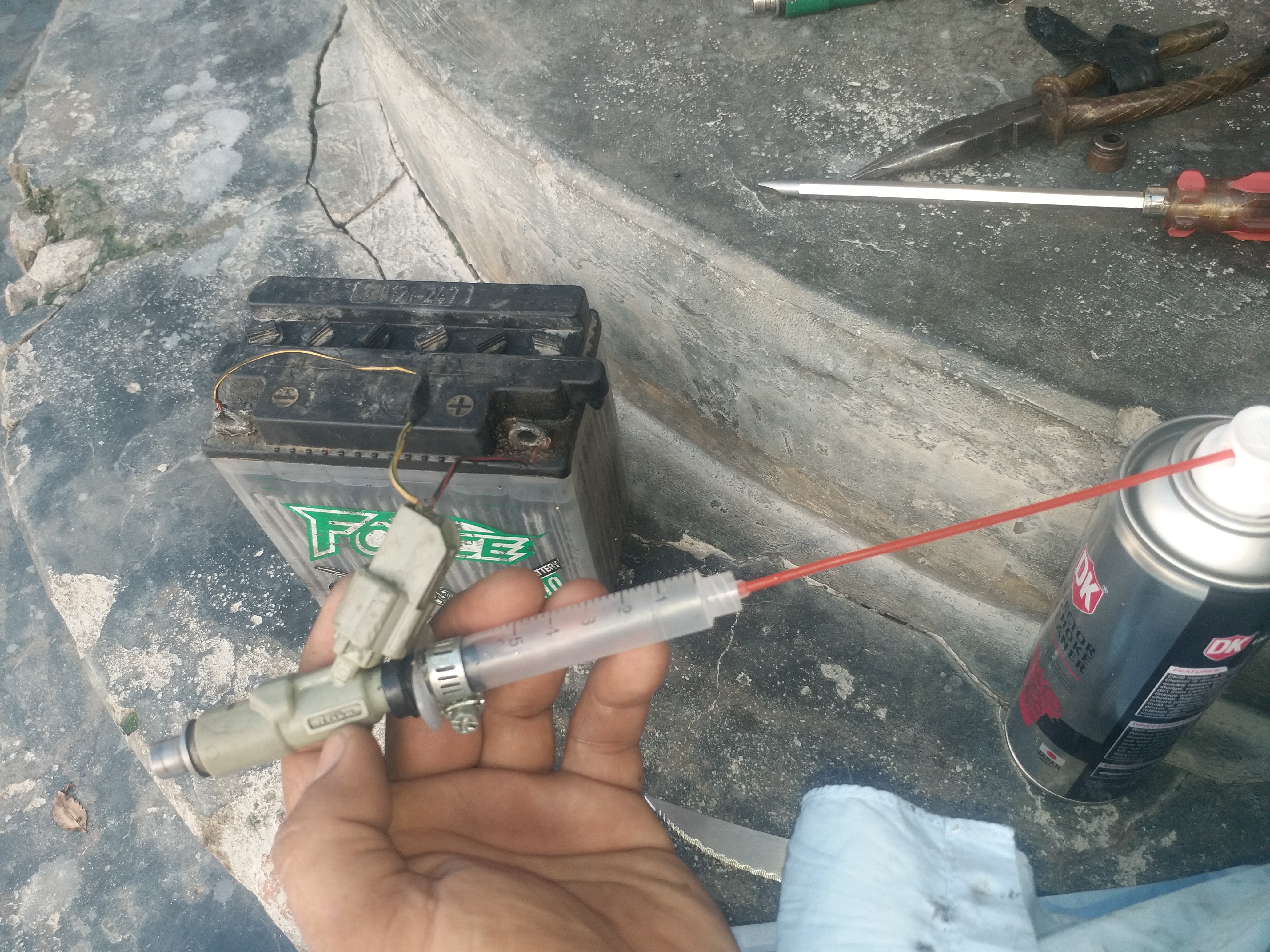

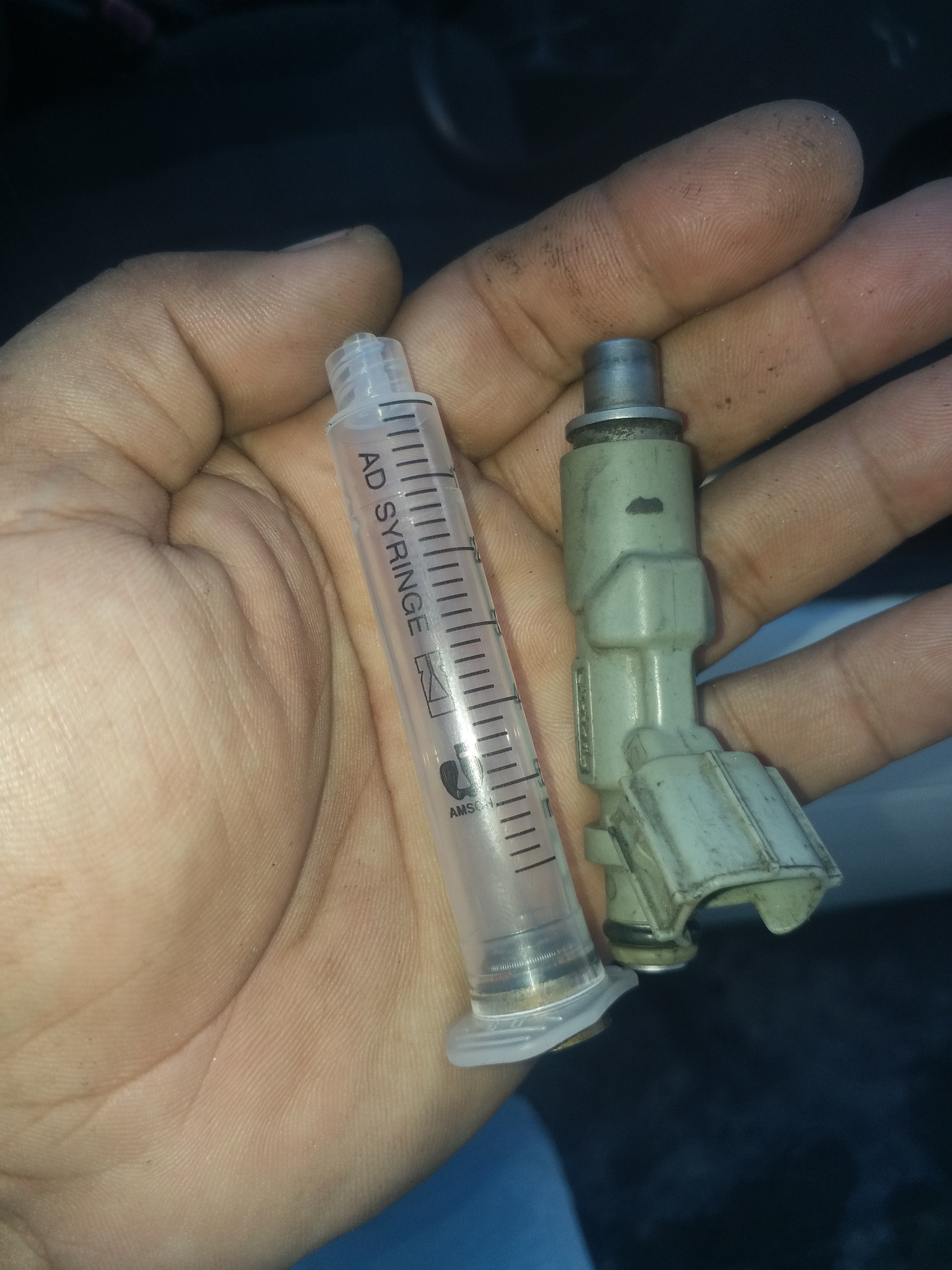

A simple and easy tool as DIY for cleaning the injectors got 5ML syringe and a clip in 30 rupeesAnd made this daisi took but it worked for me
